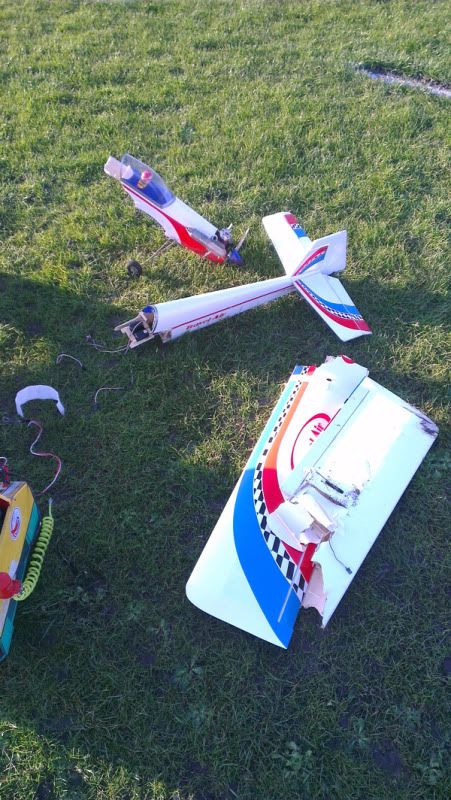

So I just posted a thread of me repairing it after buying a damaged plane.
During test flight the plane lost all control and fell from the sky in a downward spin. The plane was for a friend so I used his battery and receiver. It turns out the battery he gave me had previously been in a very bad crash in which a concrete wall was involved. Anyway I think the previous crash pulled the power lead loose from the battery on impact. Its hard to tell as it could of been this impact but its the only clear reason.
So here are the bits:
I'll add another post shortly with details of the rebuild. The fuse it a case of patching together and refitting the servo tray but the wing has suffered massive trauma in several areas where I will need to strip back and rebuild some parts.

You don't say what brand radio you were using or the voltage of the battery. If everything worked then I doubt it was a battery connection at the cells. Did you check the battery under load? I don't think I'd be so quick to accept the bad connection theory

It was 35mhz Sanwa radio gear.
what makes you think it wasn't the battery connection if the battery was in a previous crash?
After stripping the the battery down id say it was the battery which resulted in total loss of control.

Because if it had been a connection at the cells I think you would have noticed the battery being intermittent. Hard to believe that you could mount the battery and keep a loose connection intact. If you didn't check your battery voltage under load then my money would be on a depleted battery

Sometimes we can stall a plane put it into a spin and it seems like we have lost all control.. What were you doing at the time when you lost control ? There is a difference between lost control and loss of connection . Is it possible that you lost control and not connection ? I know that I have done that . Some planes will stall at a fairly high speed . If you are turning and pulling up elevator and suddenly the plane drops a wing and you cant get it to respond to any control inputs that is likely a high speed stall .
