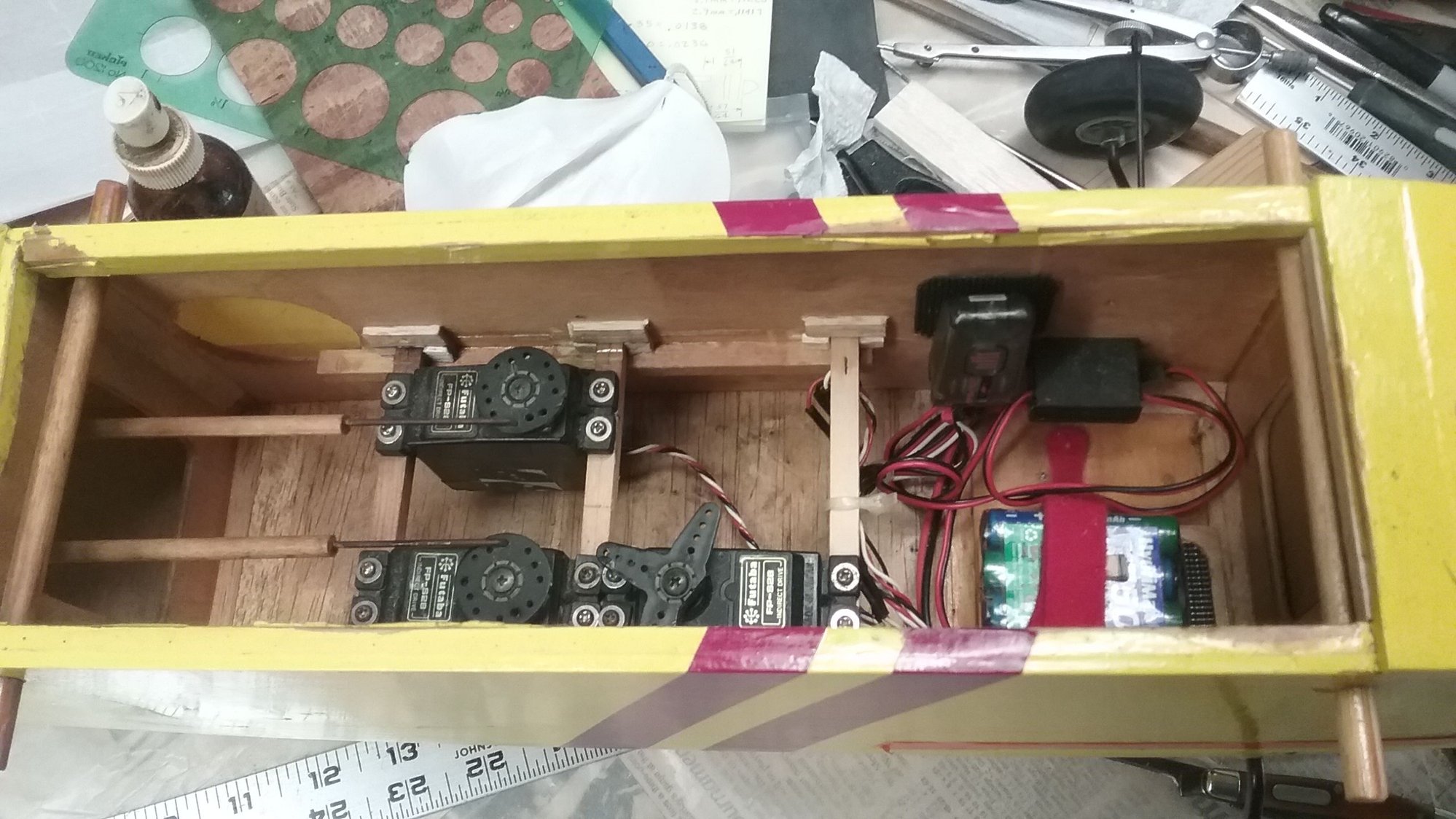

I purchased the new tx a DX9 . I've had it 4weeks now. I also bound it to an other plane . A flying wing. It to crashed after a few flights. It had a orange rx in it so I changed both planes to a ar410 rx with telemetry. Flew both again both had a lot of frame losses and a couple of holds. Not bad enough to crash. That's not acceptable . Both planes have been flown with a DX7s for several years without any problems . Tomorrow the tx will be sent back for service.

Post a picture of your radio install. We may be able to find a thing or two that may cause an issue. With 2.4 GHZ antenna placement is a bit critical. Doing a thorough range check on a new install is also a must.

Here's the radio installation of the balsa plane. I'll try a different location with receiver. I purchased a 8010T with the dx9. I'll try it also it has two antennas plus I can add a satellite. If I have to I'll go to a different rx with satellite.

There are two things there that make me uncomfortable, I don't like having a RX that close to a switch, it's a minor thing and by itself not a big issue at all. The other thing is the use of a 4.8V enloop battery. First off I don't run anything less then 6V on any 2.4 system but Spektrum is even worse with a brownout voltage of just over 4V. The enloop cells have been proven to not be capable of delivering the nessesary current. When a demand for a certain amount of current happens the voltage is going to dip. IMO that could very well be your smoking gun.
