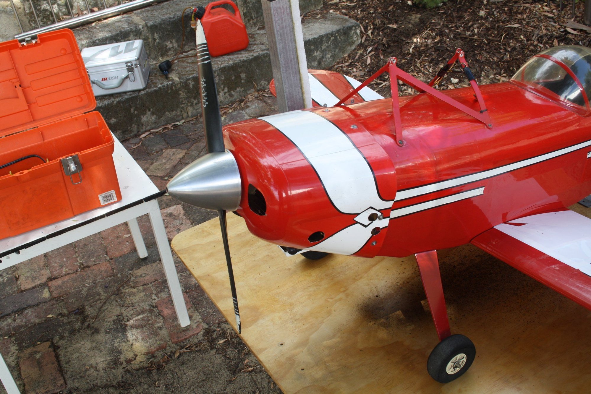

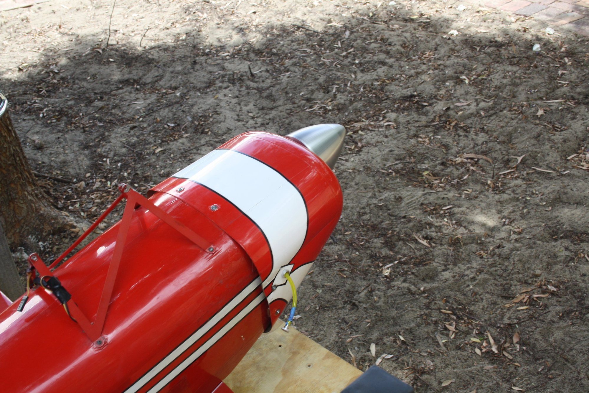

With the spinner fitted, it was time to check the engine again on the stand. This was done without the cowl first to check for air in the fuel lines, and then with the cowl on for final tuning (none was actually needed).
This run was much better, and I have contacted the Heavy Model Inspector for tentative inspection on Sunday. All I need to do is to check the CG and fill the inspection form.

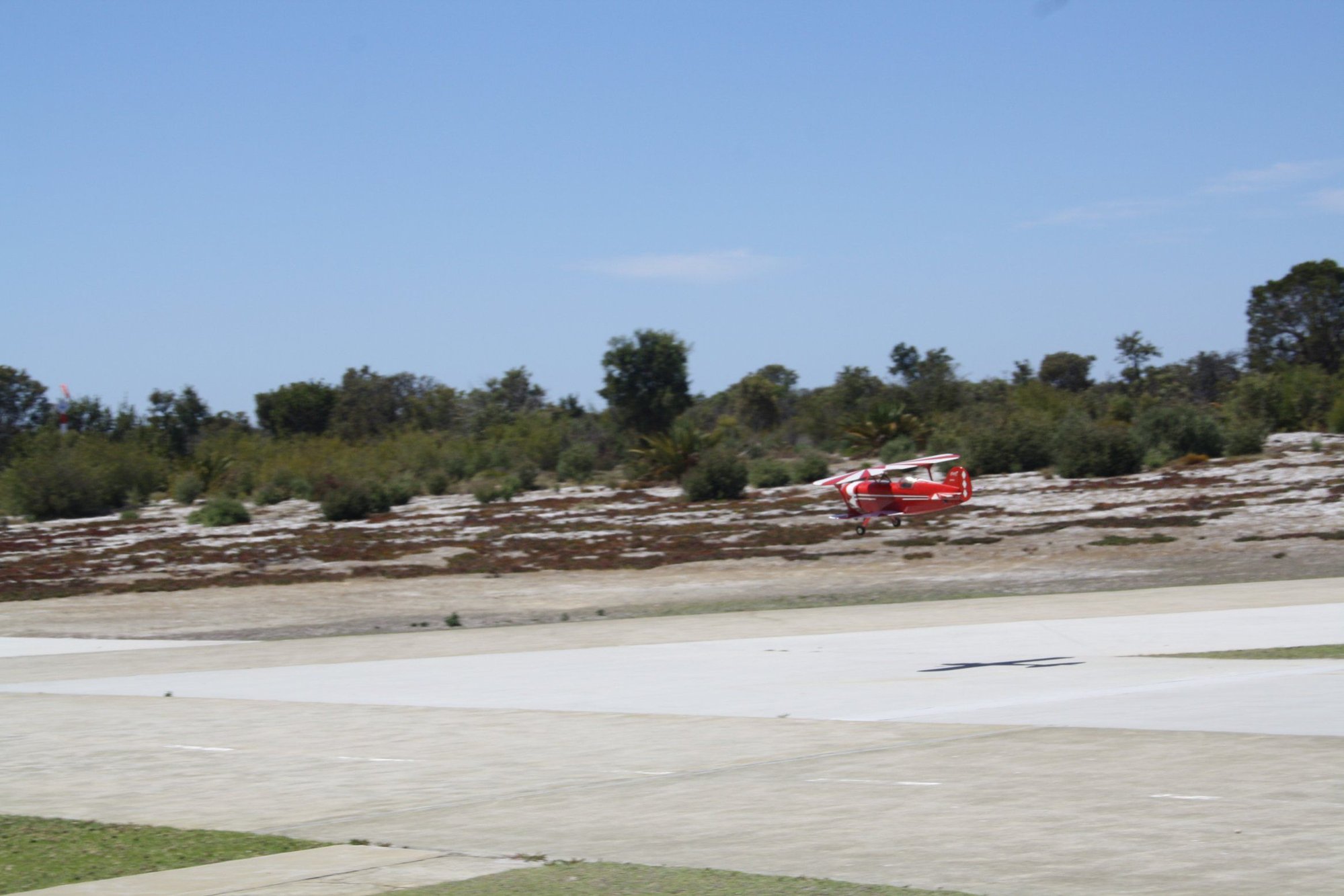

Good news. The Pitts had its heavy model certification completed successfully.
On the test flight using the recommended throws for low rates, it was very sensitive on ailerons and sluggish on elevator, but still good enough to complete the "unrestricted aerobatics" certification.
Subsequent flight with minor travel and expo changes made it more pleasant to fly.
This is the wrap then, a successful resurrection.
