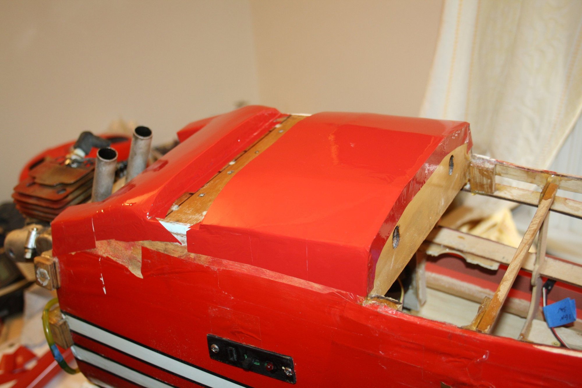

I received the fuselage only at this stage. It was immediately noted that at the very least it had a landing which damaged the landing gear, as is obvious by the crude repair.
I went ahead and assessed the required work by removing some of the covering where I suspected to find damage.
Also in the photos below you can see a square hardwood "fix" that was done to the former where the wing saddle is, a hole in the horizontal stabiliser and covering held by clear tape all the way to the back of the aeroplane.

I started assessing the required work on the obvious section at the front. Removing the covering, it is not a pretty sight...

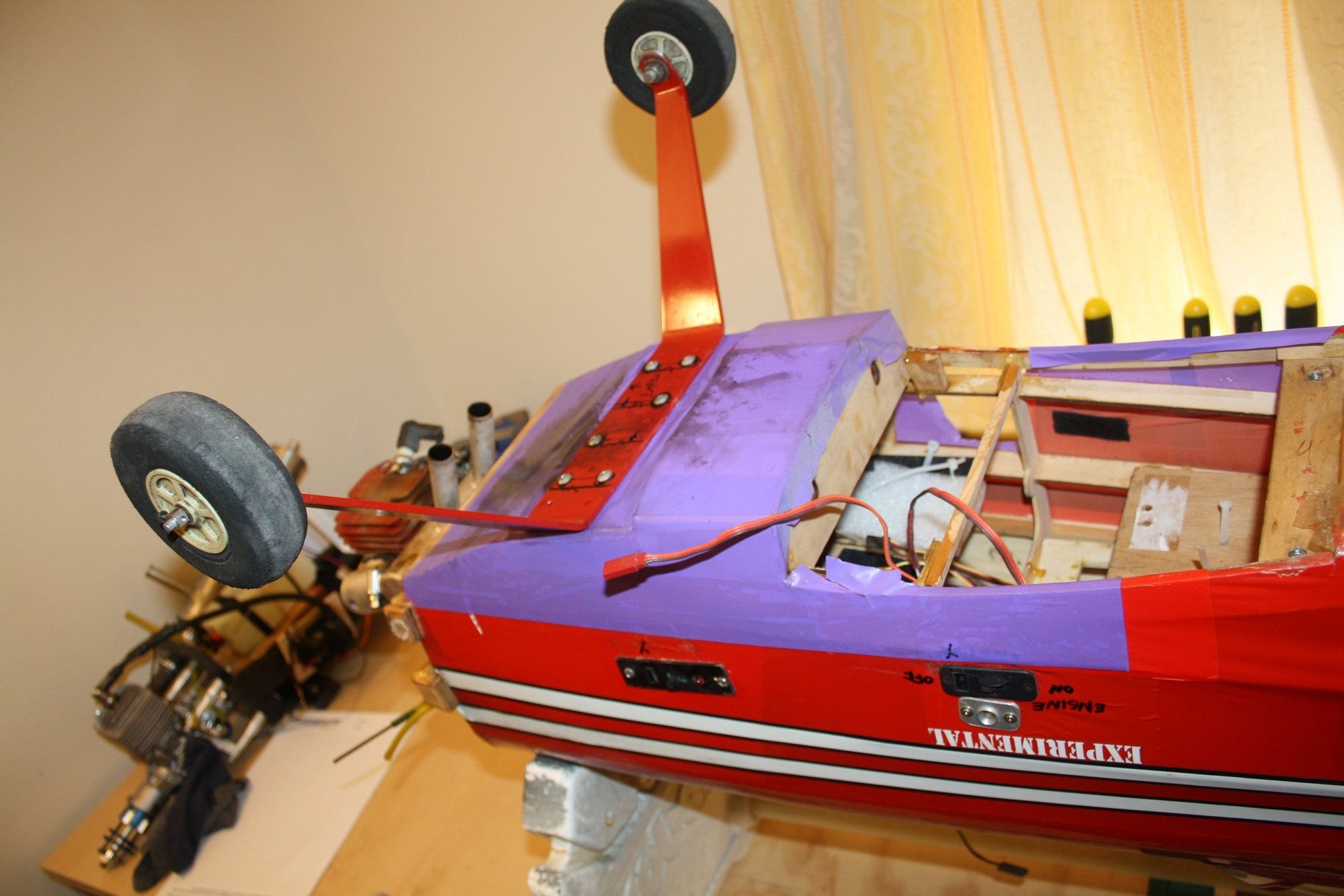

It was time to do some real work. First job was to relocate the landing gear to the approximate correct location prior to the previous. The location was established by calculating distances on the manual photo.
With the landing gear in place, it was time to re-create the shape of the fuselage next to it.

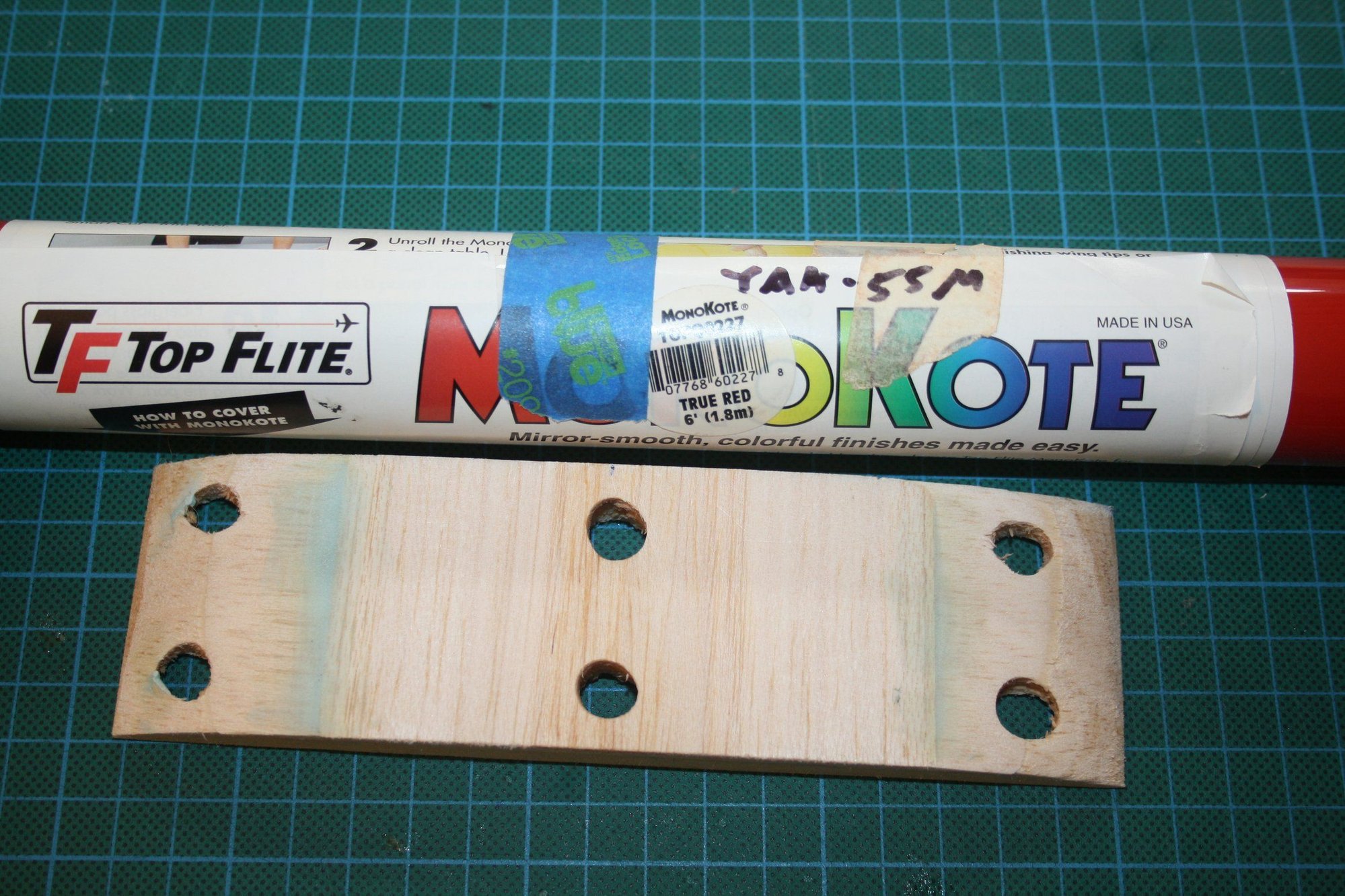

Next was creating better former fix then the one done by previous owner using a cardboard template

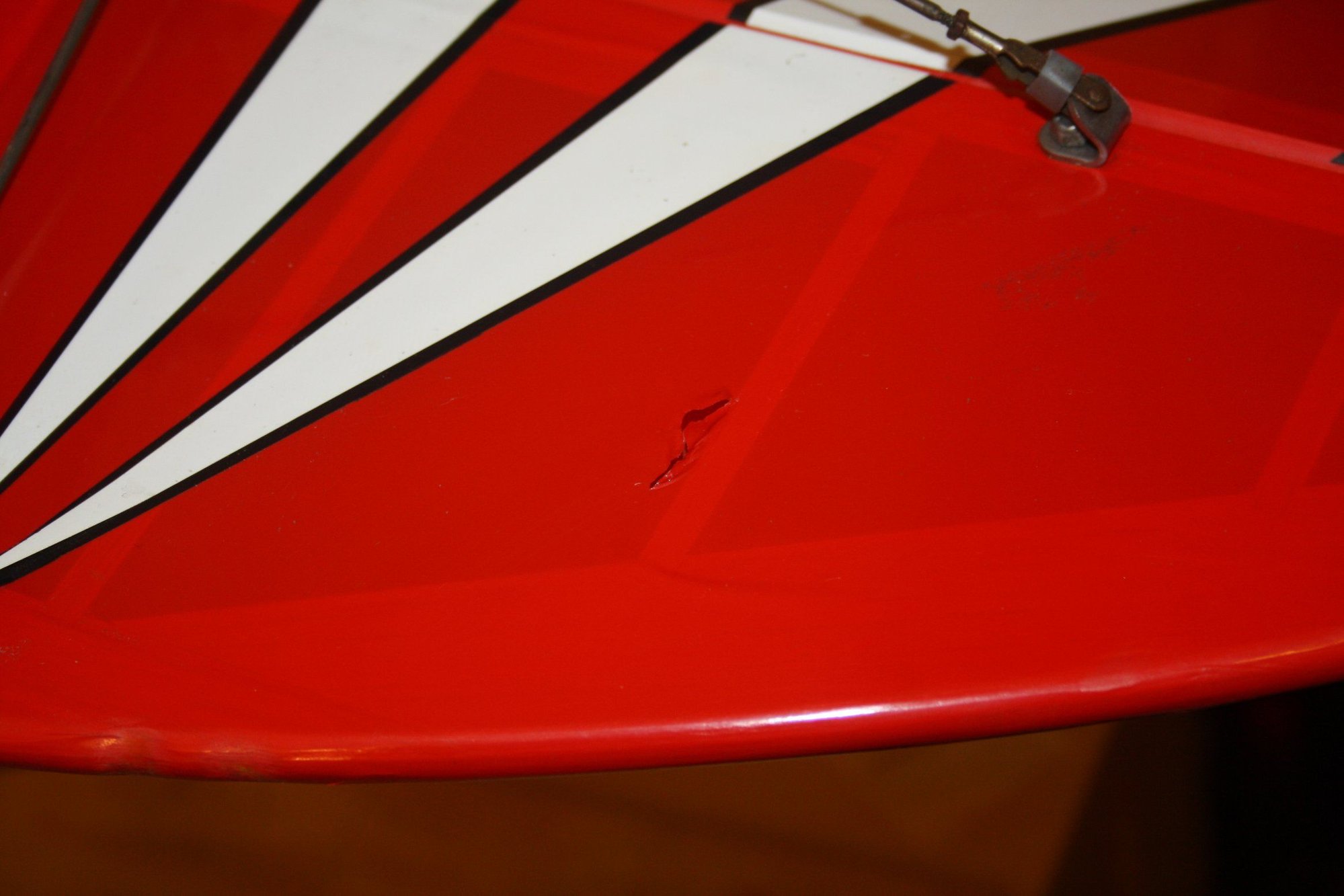

I received the wings and it is obvious that some repair was done to them in the past...

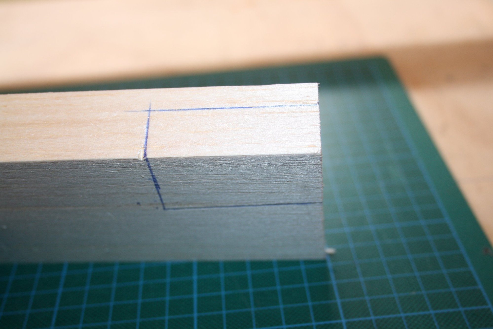

The repairs to the wing secondary spar started with cutting off additional covering checking the next bay for damage. There was none. Then the damaged section was cut with two 45 degree cuts. A new balsa spar was glued into place with corresponding 45 degree ends.
The same was then performed from the other side with new balsa spar glued into place and adding reinforcing piece over the joint
