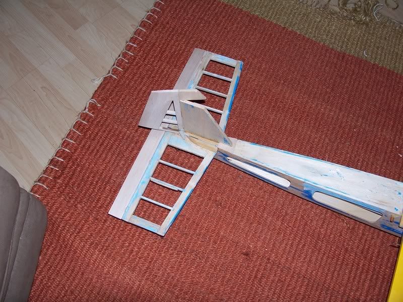

I'll post the before pic of a basket case I got for free tomorrow. It is a .40 size trainer of some sort. Seems to be pretty old. I plan on making it fly again using scavenged components from the infamous PT40 disaster of '06. Lets see any you have brought back from the edge.

Ok. Here it is. I put a firewall and landing gear on it. It was a tricycle config, now it will be a tail-dragger. 40LA from the PT40 fired up ok today. Total spent so far $0. The wings were in one piece, but I cut them apart and am sanding all the dihedral out and will reinstall the halves with a 4" lay-up of glass and 1/8 ply joiners. I'll just post he 'after' pics when I get done rather than make a progress thread. I still would like to see some re-builds. I will cover it with scraps of left over monokote because I'm going as cheap as possible on this one. I might even remove a rib or two just to see what happens...
RE: The Resurrection Thread
That can't be the same fuselage as the top picture. The rear tail section tapers differently from the trailing edge to the stab. The stab appears lower on this model. The remains of the covering on the fuselage are blue and red not white and yellow.

I'll post a few pics of the Rise of the Mongoloid tonight if I can. It is almost ready to (partially re-)cover. Had to fabricate new control surfaces so I went with a disco theme on the rudder. I put pretty large control surfaces on and took all but about 2-3 deg of dihedral out of the wing. This was and kind of is one crooked airplane. I bet it flies, though. I've spent about $10 out of pocket on it so far.
