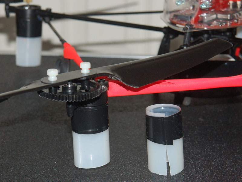

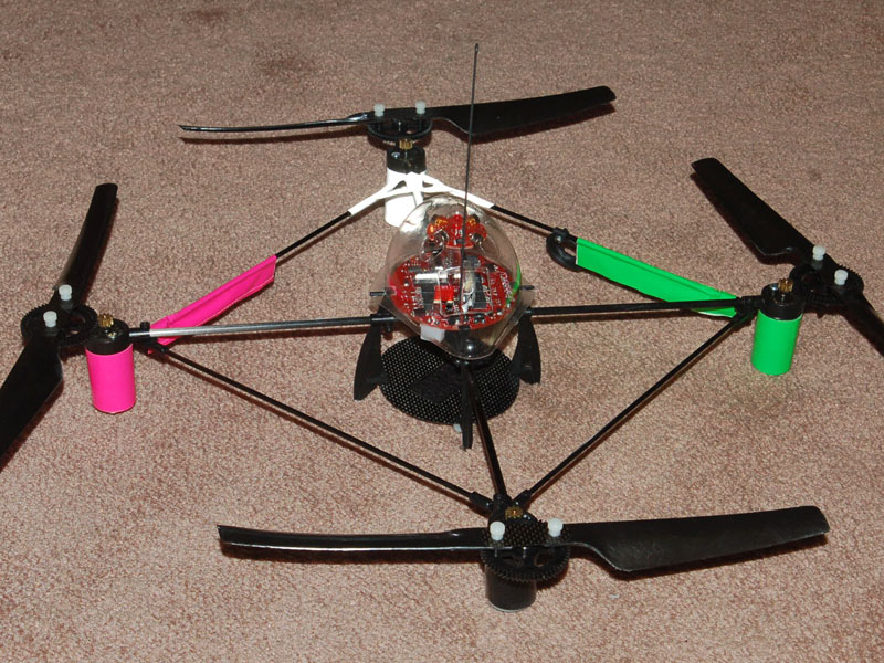

Well, not exactly wheels but some of you might find this little mod interesting. I've noticed that during hard landings the HD motors take a beating on the exposed bottom area where the small braided wires and capacitors are located. I've often had a motor stop working after the braided wire became mashed flat enough to restrict the spring contact. In addition, a low throttle up can tilt the DF to the point where a blade can hit the ground. Both of these problems can be solved by using four plastic film canisters which have the ends cut away and a side cut of 1/2 inch to allow it to wrap around the motor housing. A couple of wraps of Black tape keeps it snug to the motor. The picture below should explain it all. The total added weight for all four protectors is less than 3/4 ounce. I was very surprised to find that the DF actually flew more stable with these four protectors. My best hovering time in the 8' x 8' room before the mod was 1 minute. I am now able to do double that. Here is a little video of the modification in flight: [link=http://www.af9y.com/draganflyer1.wmv]DFinside[/link]
When flying outside, the protectors seem to act as a shock absorber during a hard angle landing and help to keep the rotors out of the grass during normal landings and takeoffs.
Mike
Mike

Hi Mike
I think it is not a good idea to wrap the HD motors in anything at all as they are getting very hot.
Secondly, if you crash, all the force is distributed to the one motor you hit on and will more likely break the motor mount, or even the center cross, and will also not prevent the rotors from hitting the ground.

Hey Mike,
Good flyin' man, in such a small area! I agree with kokomiko - the motors get hot enough already and don't need any encouragement.

Kokomiko,
I'll address your second point first. When the film canisters are cut into the slitted tube form, they are quite flexible. A shock absorber works by distributing the energy of an impulse over time. That is exactly what these protectors do. During an angled crash without the protectors, the very hard motor body takes all the force impulse and trasfers it to the frame. With the protectors that force is distributed over time and is less likely to damage either the motor or the frame. I had a 45 degree crash yesterday from aprox 30 feet with absolutely no damage. While that is not absolute proof (I put my faith in engineering principles) it certainly is encouraging. Of course an large angle crash will still allow the rotors to hit. The added rotor clearance I was referring to was for normal takeoffs and landings.
As for the HD motors. First, these motors are lightly loaded without the SAVS portion installed. Mine run warm to the touch after 10 mins of flight but certainly not hot. I could detect no difference in temperature by feel with the protectors vs without them. Remember that the canisters are cut as slotted tube so there is still air flow. Since you and others questioned the heat, I will make some direct thermal coupled temperature measurement to establish the real temperature difference. My personal opinion is that you are more likely to damage the motors from a crash without the protectors than from the small increase in heat.

Ok guys, I spent some time today testing with a thermalcouple attached to one of the motors and a temperature monitor mounted to the battery platform (see attached). Here are the results:
No Motor Protectors after 1 min flight (average of 3):
- 11 F deg rise at end of 1 min
- 17 F deg rise (peak) aprox 1 min later after motor shutoff
With Motor Protectors after 1 min flight (average of 3):
- 14 F deg rise at end of 1 min
- 21 F deg rise (peak) aprox 1 min later after motor shutoff
After looking more closely at the the motor design, I can see that the real cooling comes from the air passing thru the motor. Heatsinking the motor case does very little to cool down the temperature of the motor windings and magnets since there is a high thermal resistance between those components and the case. The protectors do not restrict the air flow thru the motor which is why there is only a 3 to 4 degree increase of motor temperature. Notice that there the temperature rise after stopping the motors is about twice the increase from adding the protectors. If you really want to reduce the maximum temperature levels for the motors just spray some compressed air into the top of each motor after landing. I tried this and it immediately stopped the post flight temperature rise.
By the way, I was able to fly inside my 8' x 8' test area for a continuous 5 mins with the motor protectors. I could only do a little over 1 minute without the protectors due to higher instability (I need to understand if this is due to the added weight at each motor or if there is some aerodynamic effect of the tubes that increase the stability). Anyway the temperature rise peak after the 5 min flight was 44 degrees. I believe that 140 degrees is the approximate point at which motor life begins to suffer so flying in the upper 90's might become a problem. Again, you can help things a lot by just spraying compressed air in the tops of the motors after landing.
Finally, I think that a small funnel expansion at the top of the protectors might actually provide increased cooling compared to no protectors. Not sure how it could be fabricated. But for the time being, I'm sticking with this simple approach to protecting the DF during the hard landings along with gaining that additional stability.
