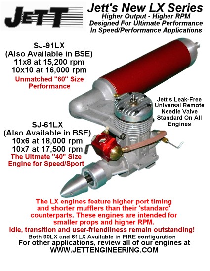

I have attached a flyer for the recently released LX series Jett engines. These represent the two highest power output sport engines Jett offers in the ".40" size and ".60" size class. These are RPM engines. RPM is key to their performance, prop selection must be made accordingly. As previously noted, several other engines and variations of these engines are available that are best configured for larger prop/lower rpm setups, and other balanced applications. A photo of the BSE-76L with the lite-muffler is also provided.
