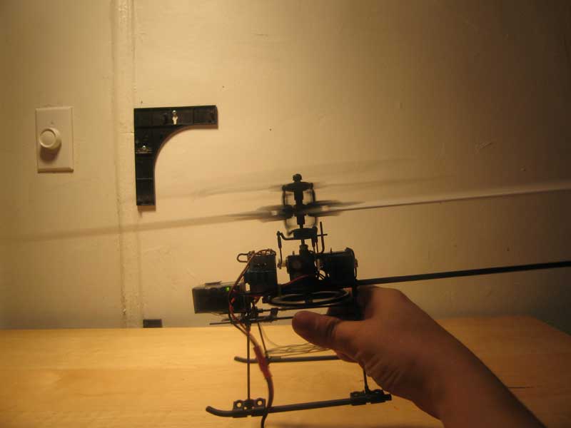

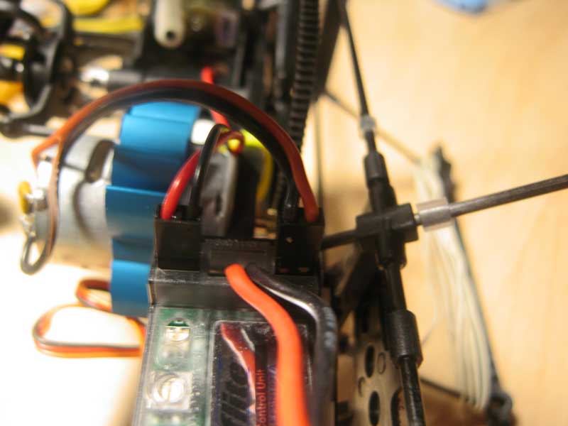

ok gota problem i cant fig out i cant get lift on the on the blade cp i check the track it looks good.. fly bar looks level getting a little vibration if i hit ilde up i can get lift ( i am hold blade in had and i can feel it)
but if i take it off i just feel blades spinning and that is it
the 4in 1 i have is the smokey gray one i have motor red wire plug in bottom with red wire in bottom.
Any clues to what i should do?
Tommy
Tommy

you may have the wires switched. check the rotation of the blades. the main rotor should be going clockwise and the tail rotor should be going counter clockwise.

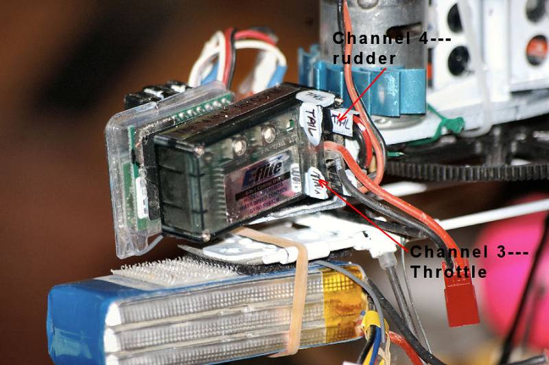

RE: Bdavison's E-flite Blade Assembly
The motor connections to the CP 4-in-1..
it pays to mark which lead is to which motor.
The channel assignments are for the Spektrum hack.

ok the main rotor is going clockwise which side do you look at to check tail?
could it be the way i have the pitch set up i have them level
Tommy

Tommy, tail rotor blade needs to rotate upward into the downwash of the rotor. (clockwise, when viewed from the rotor side)

ok this is my wiring for the motor and from this view the tail rotor is going clockwise but at 50% throttle to 3/4 throttle i am not even feeling wind on my had or pull or push which i should.
so some i am missing or not doing correctly to get this heli to lift off.

just looking at the pic on the right the pitch seems to be downward by several degrees. is this a rebuild from a crash? did your heli just start doing this? did you unplug any of the servos from your 4 in 1? if you did you may want to check the sevros as per your manual and check on all the connections. also check your pitch.[8D]

yea it was the pitch that is causing the problem its a rebuilt system.
fig that out last nite i notice the diff when i was idle up mode angle was different.
might have to replace the spindle also i am geting a little vibration.
Thanks pitch.
