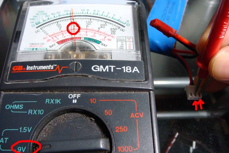

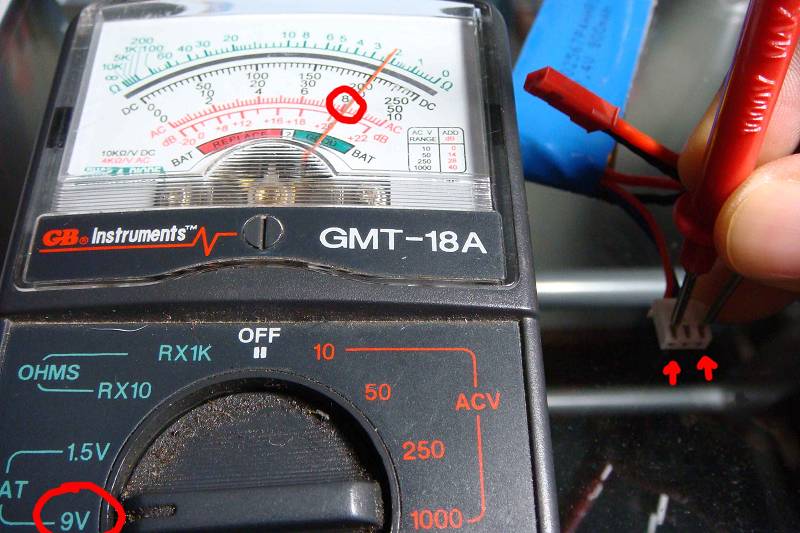

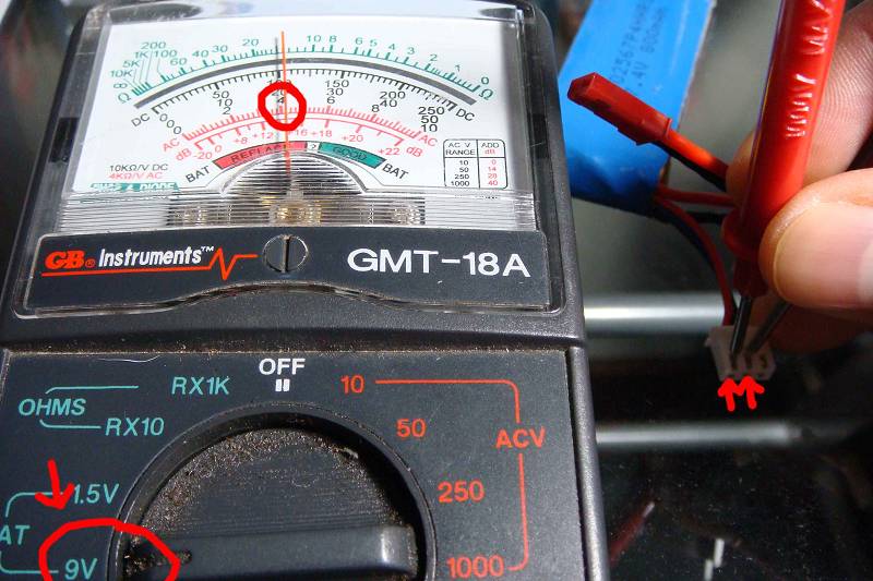

give me a few minutes to make some pictures for you.
Alright done.
each cell should read at 4.2v both cells will read at 8.4v
You can see in the picture that this battery is unbalanced where one reads at 4v and the other is at 4.2v. I am useing a cheap charger and will only get about 5-6 minutes of flight out of it, my good battery will get 8-9 mins. My stock batteries have over 200-300+ flights through them. I'm testing a cheap method to rebalance them and will keep you posted.
Alright done.

Thats an excellent Post. Very informative and as they say a picture says a 1000 words!
Also highlighting the pins with the red arrows/circles is very useful. I will get a multimeter at the weekend and check them out! Will be a crucial test.
And so what can you do about it if one of the batteries isnt reading the same voltage as the 2nd? Does it mean your battery is defective/ready for scrapping?
If its not the batteries then it'll be the Motors!? Very much appreciated, thanks for taking the time to compose that info.

NO! if its not the batteries then next check the blades..Bad blades will cause huge powerloss. I've gone through this before with mine and it turned out to be the blades.
If your batteries arn't balanced then its probably your charger. E-flite chargers are cheap, maybe invest in a better one. I am working on a theory on how to rebalance them but its going to take me a while to test it. I'll keep you posted.
