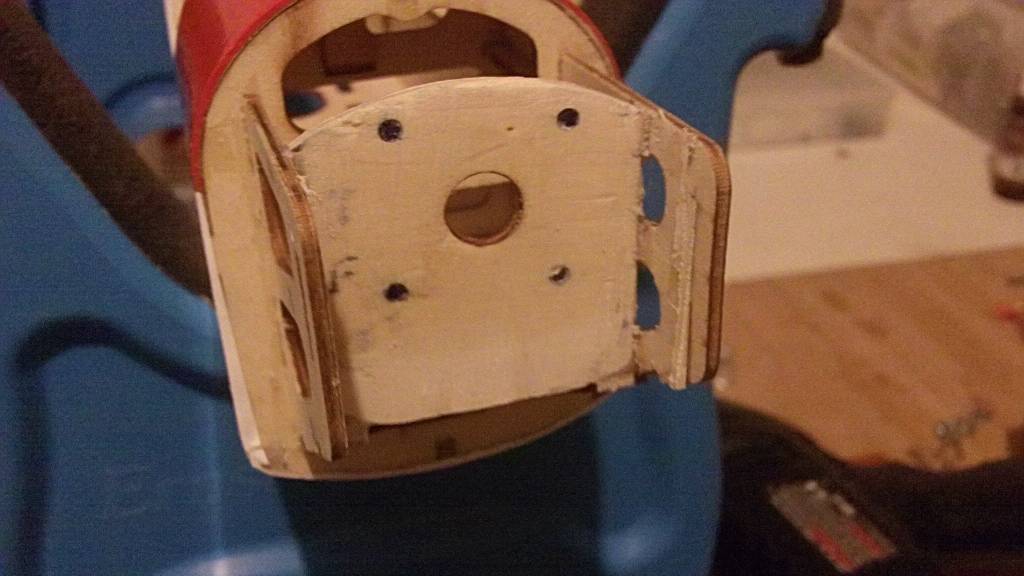

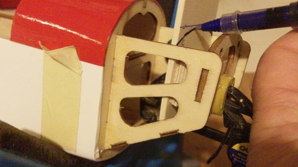

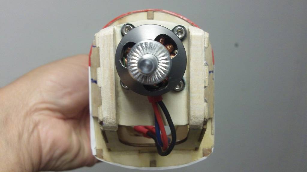

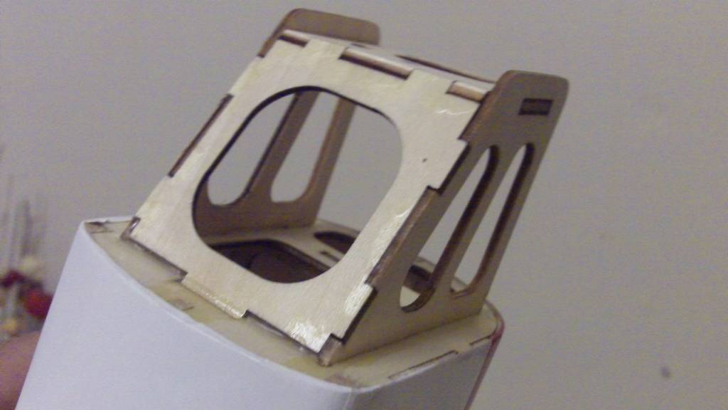

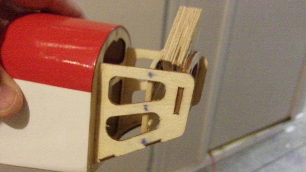

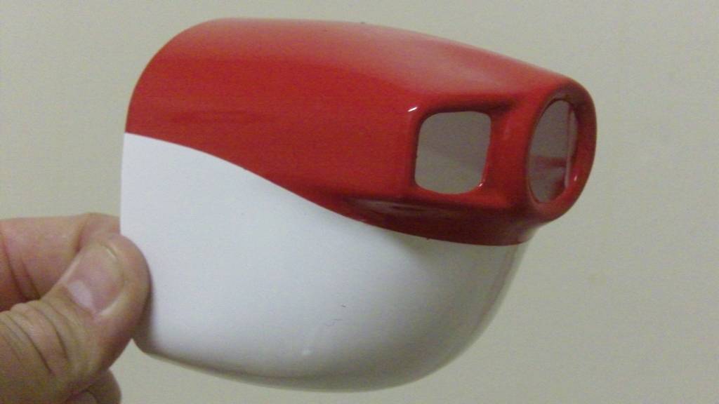

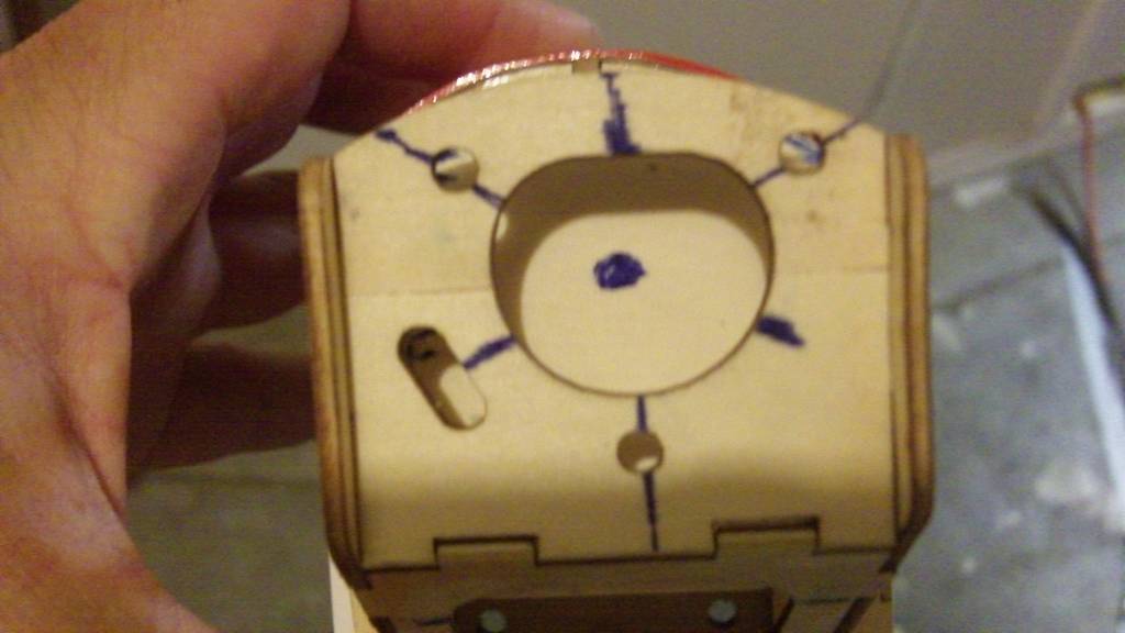

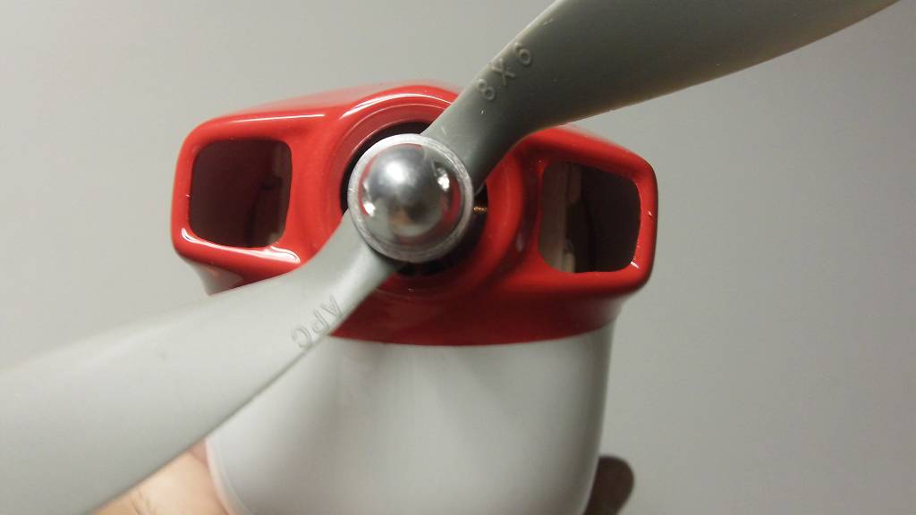

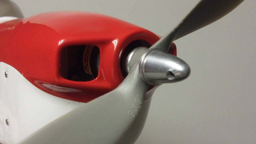

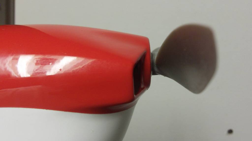

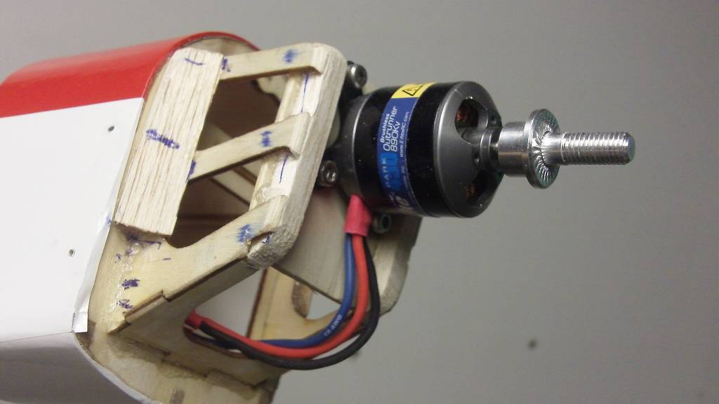

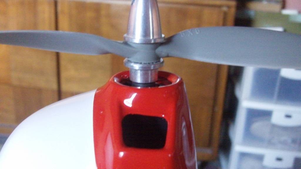

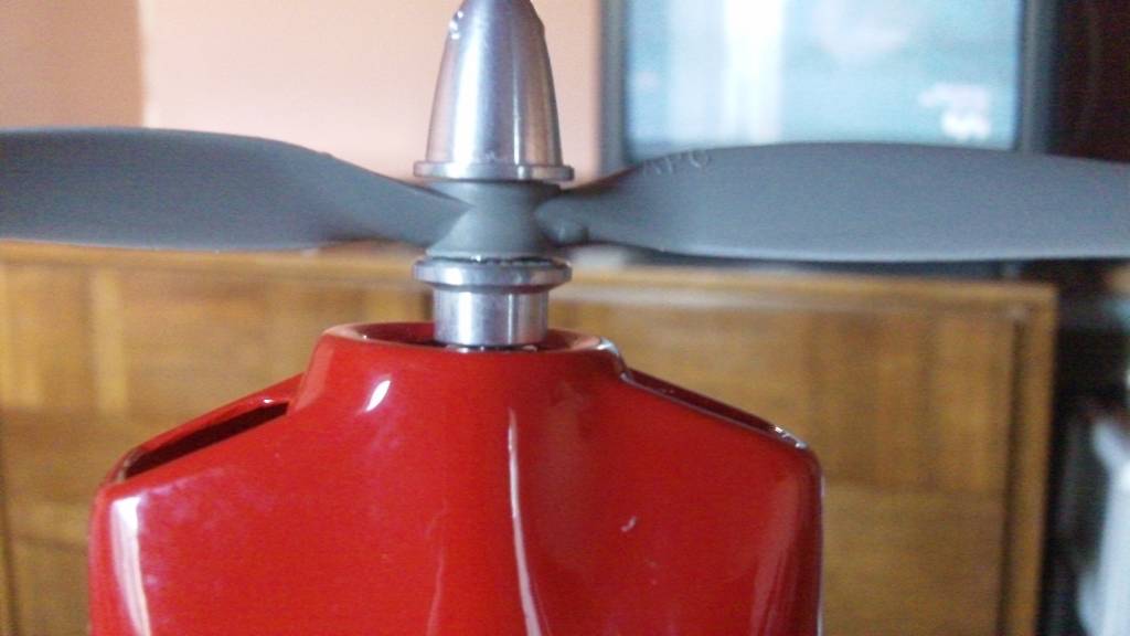

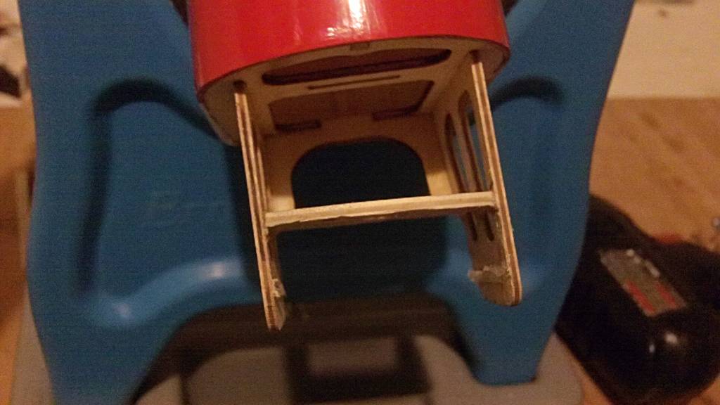

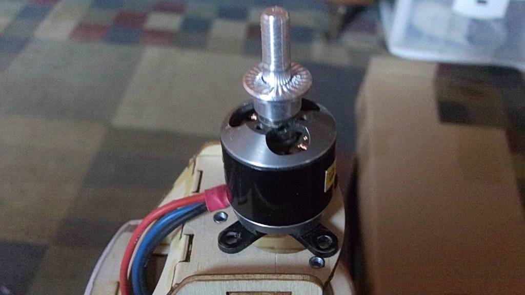

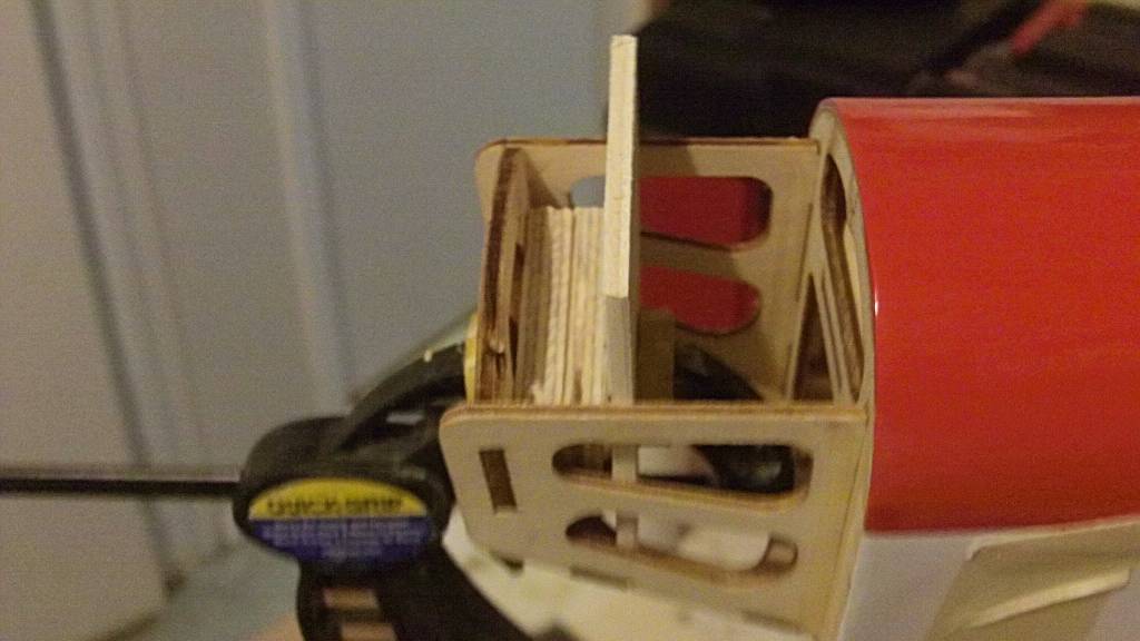

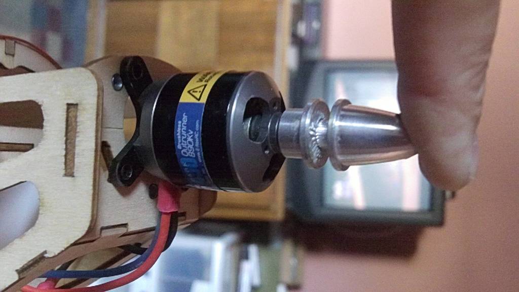

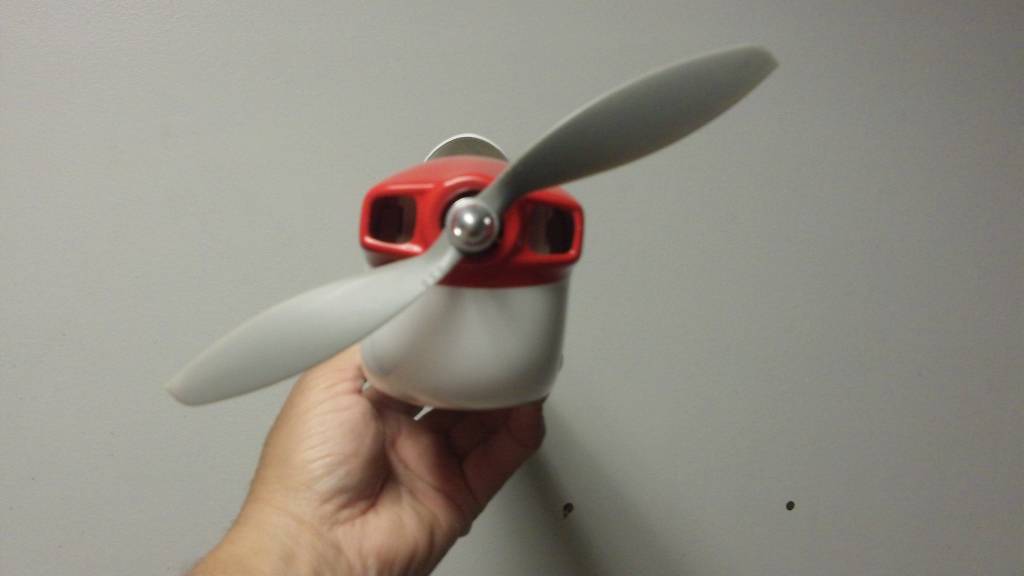

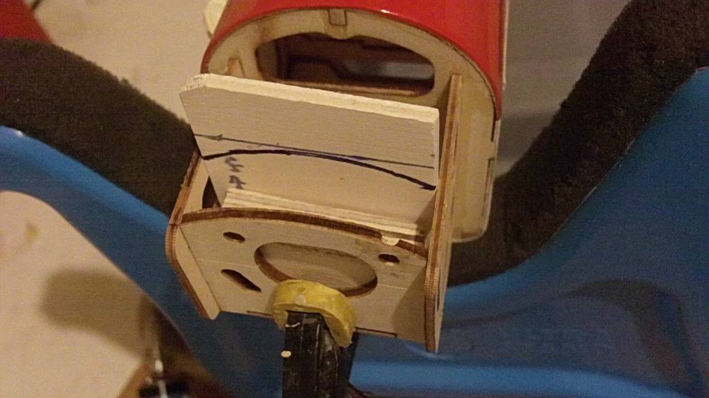

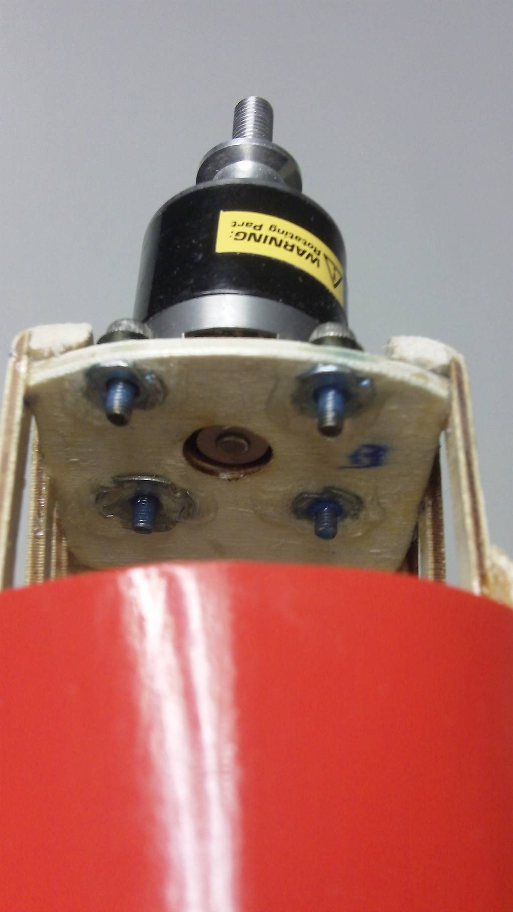

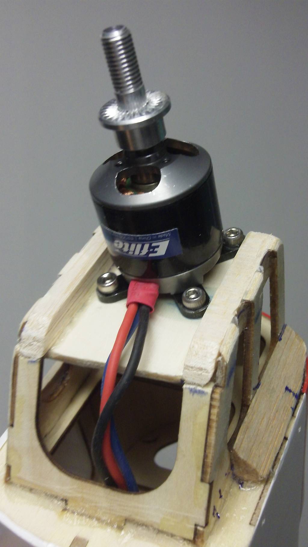

I was asked to post pictures of the E-Flight 450/890kv motor mounting, this motor is longer than the Rimfire, I have been thinking all day today about how to go about it ( best scenario )
First I thought I could keep the original firewall but it may end up in the way of the E-Flight motor, I think I'm going to install a second firewall about 1/2 inch behind the original one because my E-Flight motor is longer than the RimFire motor.

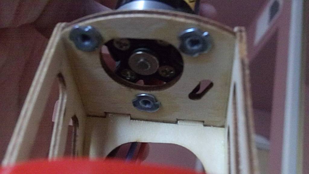

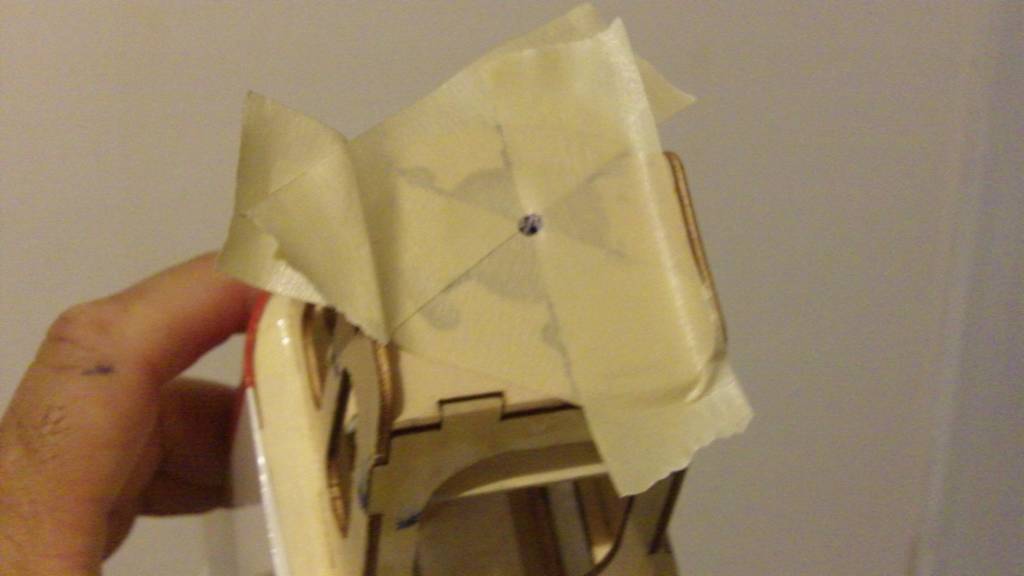

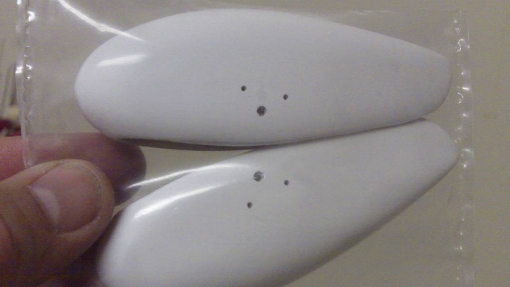

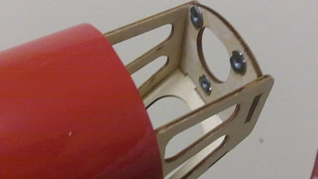

I'm done installing the new firewal on the E-Chippy, I will post pictures tonight after work by midnight.
It came out good as I used the original one as a guide ( pictures will show in detail ) with this now the prop washer is flush with the cowl and not forward from it, the prop is just infront of the cowl ( looks really good this way ) I end up gluing the new firewal 1/2" bihind the original one ( as predicted ) using it to guide me for the correct position for the new firewall and using the 1/2" spacer was a great idea and made things very easy to instal

Pics.

The rest of the build should fallow the normal building sequence, the only thing her to look for is that the servo arm on the HS 81 end up right where the Futabas do be cause the push roads on the ailerons been fix ( can't be adjusted too much )
One other thing I added a strip of white ductape on the inside of the cowl over the mounting holes, this is to reinforce the edges.
