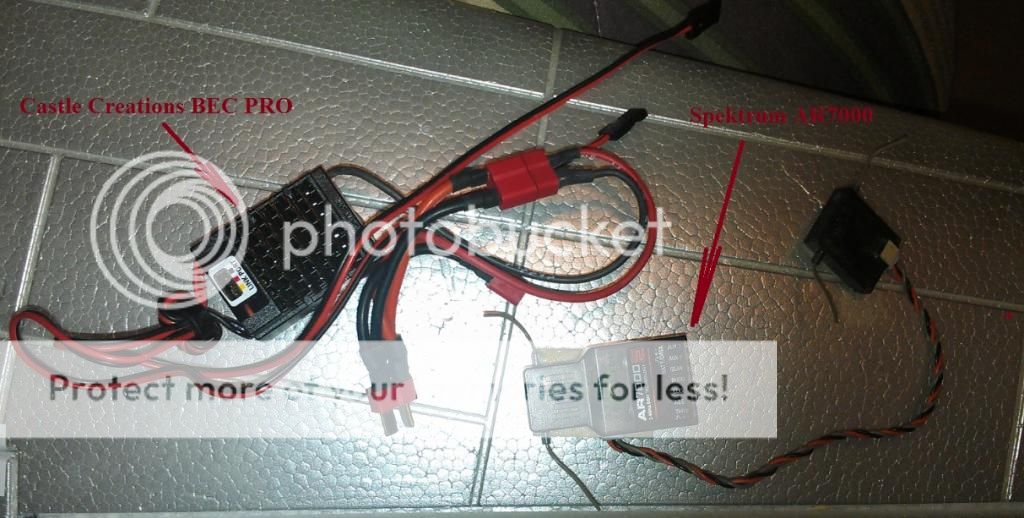

Guys,
Well it seems like a few are having issues with the Main Gear, In any case, for those that Love this model and don't mind those reports that we can't determine if they are isolated cases or not and want to own and fly this large T-28 Trojan of the sky then, consider using Castle Creations BEC PRO!
I have this Castle Creations PRO in all my larger warbirds that have Electric Retracts, Flaps, etc.....etc....etc......
This will provide pretty much carefree flying for your larger aircraft needs short of having a traditional separate RX battery and switch harness.
Check it out the review back in 2009 at:
http://www.rcgroups.com/forums/showthread.php?t=1112622
Here is my Hangar9 F4U-1A Corsair 50-Size Electric with it as an example:

[HR][/HR] Looks like there may be another issue with this plane.
In two weeks two planes went in under similar circumstances. The first was late last week and the second was today. The first plane had around 15 flights and the second around 25 and both had a very experienced pilot at the controls. Both planes lost power to the control surfaces and nosedived into the ground.....total losses. Both planes were not abused and were flown and landed normally by well trained pilots.
The first plane was reported flying fine ,then loosing all control and watching it nosedive into the ground.
The second plane today was reported flying fine and the pilot turned the gear down to check for landing and nothing happened. He cycled them once and still nothing. He cycled them again and then he lost all control to the plane and it nosedived straight into the ground.
Had a chance to go over the remains this afternoon and checked everything that was left. When we got to the retracts we think we found the problem. One main retract was not working and that could have been due to the crash, the other main and the nose gear were working. Note that all gear were not bent or hanging up in any way.They were still in the closed position and seated properly with no noticeable damage.
We tested each retract and of course the one main would not work but the others extended and retracted fine with no odd noises or binding. We connected an amp meter to each retract and the nose gear was drawing around 0.25amps through the cycle ...which is normal. The working main gear was drawing around 2.6 amps ! Of course there was no draw on the non-working main. Several more tests with the same results....high current draw from the only working main gear.
At this point it looks like the main retract or retract(s) failed and pulled too many amps and in turn overloaded the BEC (thermal shutdown)and shut down power to the receiver.
The retracts from the first plane were checked and again all retracts were in good physical shape. All worked however one main was drawing very high amperage intermittently .
I would advise anyone flying this plane to get a Nixx battery pack and a switch and install them in the plane as there is plenty of room. Wire the switch with a Y-harness to power only the retracts.Remove the red wire from the Y plug that goes to the receiver so you don't backfeed voltage.
If this is not an isolated incident and the retracts are a problem waiting to happen ,the separate retract battery will handle the overload and not cut power to the receiver so you can control (and save )your plane.

Originally Posted by flyinwalenda View Post
Probable Current Overload Issue with BEC
[HR][/HR]If this is not an isolated incident and the retracts are a problem waiting to happen ,the separate retract battery will handle the overload and not cut power to the receiver so you can control (and save )your plane.
I went the other direction and eliminated the use of the built-in BEC, because that is what will fail in the current overload situation. It is not voltage loss that is the issue, it is the fact that the BEC in the ESC dies when the retracts fail.

Originally Posted by jchorak View Post
Performed a maiden for a gentleman today on this plane. Being an experienced warbird pilot, everything was checked and rechecked ala full scale. After a scale takeoff the plane rolled over and went in when it was about 15 feet off of the ground. Seemed to be from loss of power to the control surfaces, Local hobby shop is contacting Horizon.
Were the retracts still down ,up, or were they cycling?
That is another option to make sure power is not interrupted to the receiver and is a good thing to do for this plane. Disable the internal bec and install a second flight battery to power the receiver .
Also , when a bec(voltage regulator) fails or reaches thermal overload shutdown, it does indeed stop providing voltage and in turn cuts power to whatever it is connected to. Power=Voltage x Current. In the case of an ESC with a built in bec(like this plane) the bec is the only way the receiver gets power.
You misunderstood what I was saying. My fault, I should have been more clear. I was talking about voltage drop, or depression under load. Voltage depression is not culprit in most cases, it is a failure of the BEC, either temporary or total. Which is why I don't use the things.
Another thing I have done on mine is to replace those tiny wires on the "Y"s, especially for the retracts. I went to 20 gauge ones which should be plenty robust. Those E-Flite light gauge Y's concerned me.
Retracts still down, uncycled.
