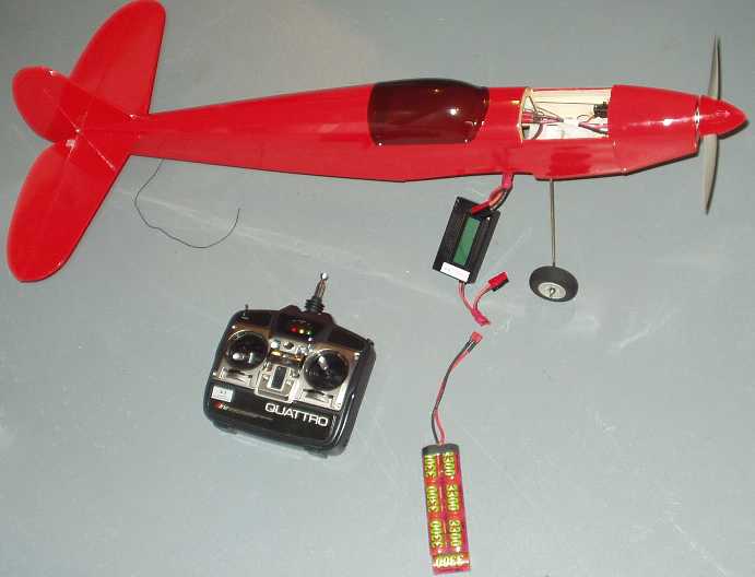

Dear Super Sportster EP Fans:
I have finally converted my Great Planes Super Sportster EP to fly with a modified Power System. No, I did not install the Kyosho Endoplasma 16-turn brushed motor but, instead I used a combo setup from Great Planes and sold by Tower Hobby known as the S-600GD Power System.
My model has flown half a dozen flights now with this power system and can tell all of you how great this setup is. Provides the model with much more prop speed and has transformed the model into a true SPORT model.
The S-600GD Power Setup includes the following:
1. EPIC 19-turn Brushed Motor with replaceable 4 X 5 Brushes.
2. Great Planes Electrify GD-600 gearbox.
3. Prop. Adapter with set screw.
4. APC Sport 9 X 8
5. 15 tooth and 18 tooth pinion for (3:1 and 2.5:1 ratios)
There are two combos, one with the ESC and the other without....I ordered the one without since I can use the Stock 30 AMP ESC that came with the Super Sportster EP.

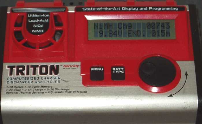

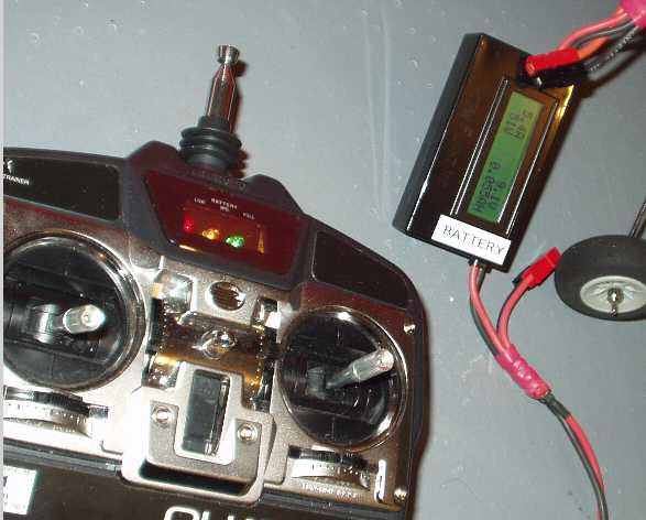

Great Planes inexpensive Power System Upgrade current draw measurments.
Pic's showing the final off the charger measured voltage of my 7-Cell, GP-3300mAH, Ni-MH and the initial measured No-Load Voltage of the Battery when connected to the ASTRO FLIGHT 101 Watt Meter.
The last pic shows the Quarter Throttle measurement....

Great Planes inexpensive Power System Upgrade (S-600GD) current draw measurements continued....
Half, 3/4 and Full throttle measurements.
Notice that the Full Throttle is a little blurry as a result from the thrust and vibration, sorry, however, Full Throttle measured 25.6 AMPS, 8 Volts Under Load, and 206 Watts.
