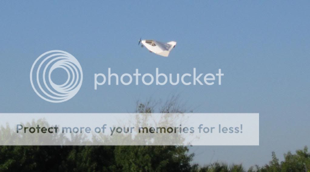

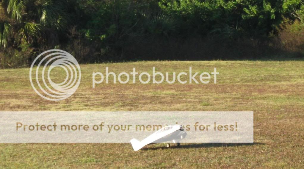

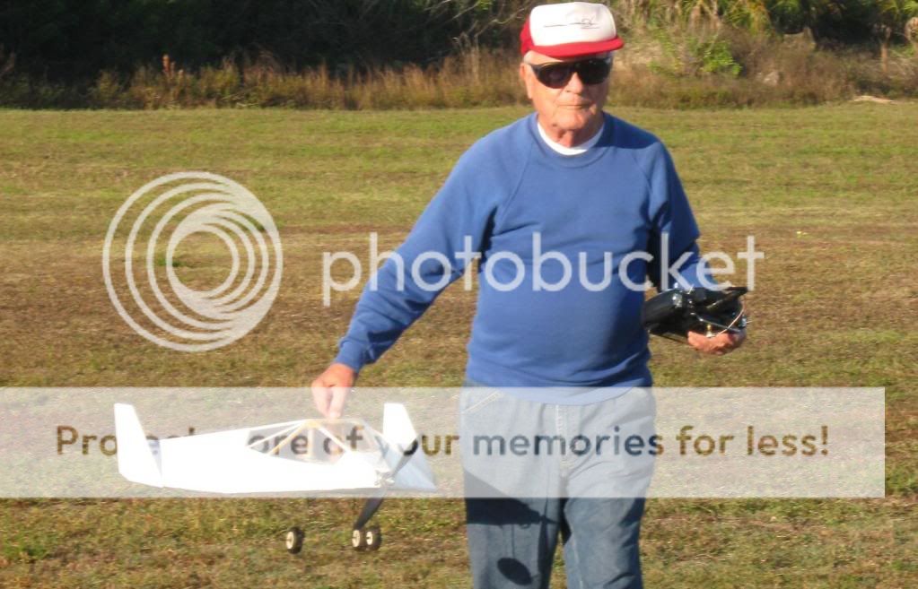

Soarrich,
I noticed your post of one certain Facetmobile Lifting Body model.
Here is a few pictures of Rodney's Facetmobile RC Lifting Body flying model!
Rodney goes by the same handle here and at RCG's!
Okay a few pictures!
Rodney's Facetmobile is powered by the E-Flite 400 inrunner and swinging the Park Zone 9.5 X 7.5 Propeller with 3-Cell, 1300mAH, Li-POLYs.
Rodney and his smaller version Facetmobile, he does have a larger one!
