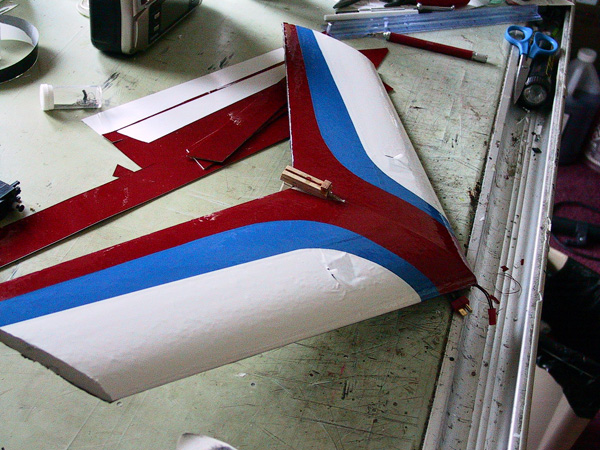

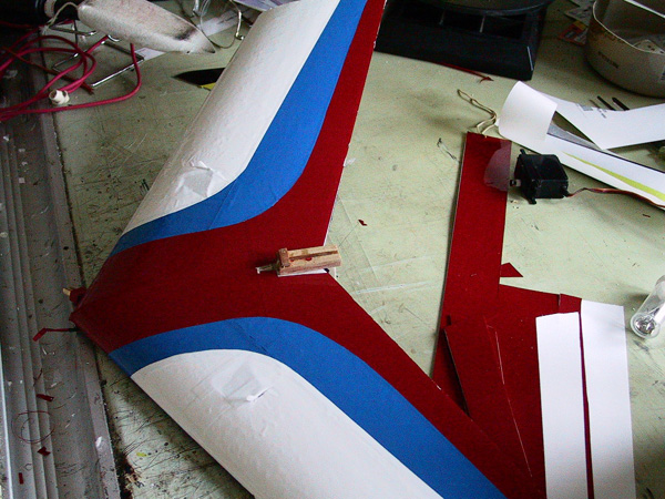

[img] [/img] Heres a few shots of mu 2ND Clic ,,,I think it turned out NICE !!!
Thanks Ron
