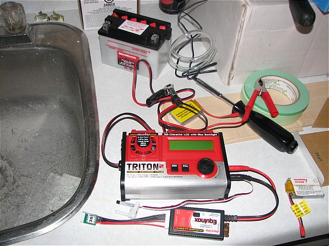

I hear you, everyone goes through this ordeal once, then you learn to really read and go through everything and get all the little required parts and do your homework so you don't have to go through it again
On the charger, it looks like you need a separate power supply for that? Did you get one? From what I have read, it does not have a wall plug, it needs a 11-15 volt power supply that will allow for banana plugs or alligator clips.
On the charge connector, it looks like that charger has banana plug output as well, you will need to solder on a Deans Ultra female connector to your battery, then get the "Charge Lead Banana Plugs to Deans Male Ultra" connector on this website http://www.electrifly.com/powersyste...onnectors.html
The Stock Number is GPMM3148 - I think that should do it.

Well the frustration factor just rose a few degrees.
I did buy a 12V motorcycle battery to use as a power supply. I did go that far. But really, how is one to know that you have to solder all those ends on all that stuff?
Here's a couple of pics of what I have so far. Man am I confused on what I need to do where.
Really appreciate the help though, fliprob17. It's been an eye opener. I know that learning now will help me in my future endeavours as I know that I will keep buying, building and flying. There is such a learning curve from nitro to electric that I wasn't aware of, that's for sure. And I know that the planes that I am interested in do not all come in RTF form either. Plus I do like to build sometimes. Makes these stormy nights go faster without wasting my time in front of the tv.

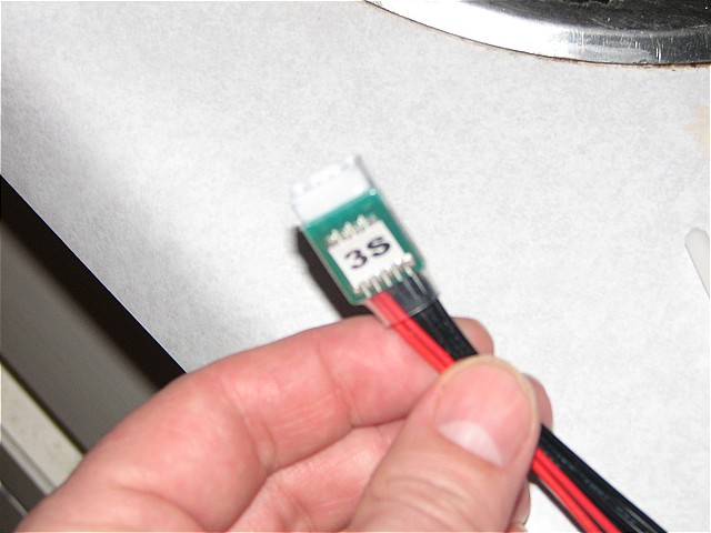

I take it that the connector that is on the battery now will not fit into the Equinox Balancer end that says 3S?
I noticed that the battery you have does not have a balancing tap on it, but they sold you a balancer? I didn't think you could balance a battery through the discharge/charge leads alone (main black and red wires)?
My setup is a bit different, and all of my Thunder Power batteries have balancer taps, 4-5 smaller wires with a little black plug.
To me, it does not look like you are setup to charge that battery, it won't hook-up to that balancer plug.

No...that connector won't fit into the 3S. It came with a 2S too, but this is a 3 cell lipo.
Balancing tap huh? Never heard of that. I bought the battery and charger/balancer/thermal probe separately.
No, the batter won't hook up to anything at this point. Therein lies the problem...lol.
And to think I thought I could just order a wire or something to fix this...

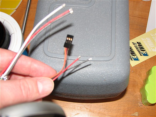

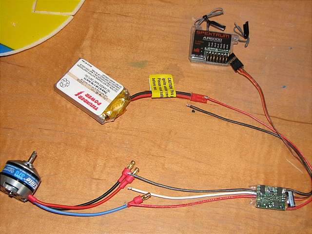

Sorry for all the questions guys. And thank you for your patience. I really think that I am learning something. Maybe slowly but it is sinking in. Hard to do this when there is no-one in the know that I know in person.
I can just unplug the balancer for now and get the ends that you recommended. As in banana plugs to the one the connector on the battery. But then I would have to get the same end for the ESC too you are saying. Or change the ends to Deans Ultra? As in cut the connector off the battery and replace it with the Deans Ultra ends?
I've taken some more pics. My ESC ends and then I layed them out as they will be hooked up eventually when I get this stuff figured out. Let me know if I am right.
Thanks again for all the help so far.

Honestly, if it were me, I would have everything be Deans Ultra plugs. So you would put the male plug onto the ESC black and red wires that go to the battery, like the way you have it. Then cut off the connector that is on your battery now, and put a female on that. BE CAREFUL WHEN CUTTING THE BATTERY WIRES, cut one at a time and solder it to the new connector, then shrink wrap it up, then do the other wire, also always do the positive wire first. You DO NOT want to cut both wires at the same time, or have them both exposed at the same time, that could lead to a battery short and the pack may ignite. Also, be 100% sure that you are matching positive wires to positive posts on the connector, and same with negative otherwise the pack will short.
After that, all you need is that little charge adapter I linked before and you should be good.

Ok. I think I know now. I basically need to get 3 ends then.
1. For replacement of the battery end - Deans Ultra Female.
2. For ESC - Deans Ultra Male.
3. For charger - Banana Plugs to Deans Male.
I'll worry about the balancer later. And if what you say is correct then these batteries aren't meant to be balanced anyways for some reason.
Am I right about this?
Where might I purchase said accessories online? Or would Radio Shack or some other local shop carry plugs like those on that website you gave me?
Blain

Good luck Just be sure/careful when taking off the old battery connector and putting the new one on. Also, be sure you do not exceed the recommended charge rate for those batteries - should be 480 mah or 0.480 amps.
Unless there is some way that I am not aware of, the battery has to have a balancing tap with a balancing plug in order to be balanced. So batteries that just have the two main charge/discharge leads, and no balancing tap, cannot be balanced.
