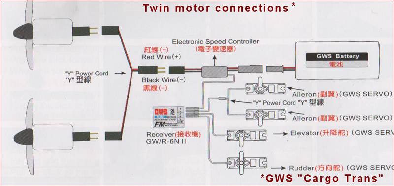

Hi all - have had a lot of fun flying electric models having spent years with the petrol stuff. My question is does anyone have a diagram or explanation on how to connect two motors on a twin with regard to the engines, ESC, receiver etc?
It is simple enough with a single engine (fly an Extra300 atm) but am new to it all with much else.
Any help greatly appreciated - thanks guys and blue skies! -Mark.

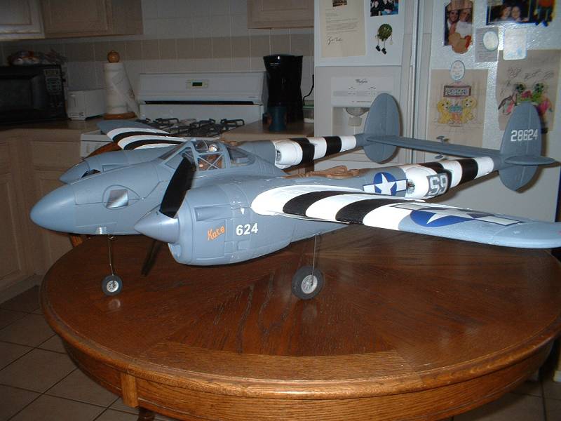

I used a Y Harness to connect the esc's to the receiver on my E Flight P-38. Then ran both esc's power wires to one deans connector to the battery .Pretty straight foward and it works. Mike

I currently have two twins. A GWS P-38 and a Hobico TwinStar.
In the P-38 the Castle Creations (CC) Thunderbird 18 Amp ESC's connect to a "Y" and plug into channel 3. These ESC's are good to parallel the BEC's, some others are not. The ESC's are in the nacelles and connect to a hand made 14 AWG "Y" to a 3S1P 2100 (6 min) or 3200 (11 min) LiPo.
The TwinStar is similar, CC HV45's are in the nacelles with the 4120 motors. A 12 AWG "Y" connects the ESC's the the 6S2P 4200mAh Lipo in the center of the plane. I use an LM2576-5.0 as a BEC, goto DigiKey.com for a datasheet.
I both the props counter rotate to make turning right and trimming easier.
It is important to test any new setup. I strap the plane down, run the motor(s) at 1/2 to 3/4 power while moving all the controls for 3 to 5 minutes. As I do this I keep checking the watts and amps, the temperature of the motors, ESC's, batteries and other parts. If everything is working correctly, no part should get hot. Anytime an ESC gets more than the slightest bit warm something is wrong, wrong timing, bad connection, motor and ESC don't like each other...

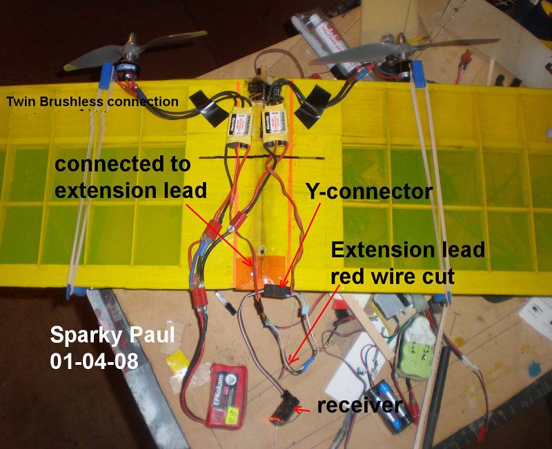

Brushed motors can use a single ESC.
Brushless motors need one for each motor.
These can be y-d together to the throttle channel.
