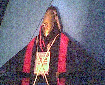

hi everyone, here's the jet with the battery on top.
it does fly but not very well, the cg is at the back of the prop openning. with full throttle it hardly climbs and and when turning it just looses altitude and crashes. i've added a foam plate piece at the rear (between the 2 stabs) without any results...
neurotex, did the motors you sent me, where the actual one on this plane? it seems they don't have enaught "pep". it's flying speed is about the same, if not slower, then the aa bipe...
neurotex, what mod where you talking about? that you made/report in another thread?

RE: Air Hogs Aero Ace!
ORIGINAL: novielo
I found it nothing but dead weight.
The motors I sent you were 05 stock bipe motors direct from AAMods.com.
They still have the gray ribbed motor casings still on them. They're not the
original jet motors. The jet motors are in black casings- flying my Strato wing.
If you go back on this thread I made that clear, sorry if you misunderstood.
I listed the jet up for grabs several posts after I posted the bipe motors.
The bipe motors are not that much different than the jet motors but with that
heavier lipo it might be causing problems.
The jet flew sluggish out of the box that's why I chopped the back off, to get
rid of about 2 grams of dead weight.
For some reason you've got the CG moved back an inch from where I had it also.
I thought you stated you had a pair of N20's with Defender props. Did you put
those props on the AA bipe motors?
The battery might burn up those bipe motors. Bet they're screaming.

On this thread, page 81 post #2007, shows the jet with the N20's
and the Defender props installed. Post #2023, shows a close up
of the N20.
If you want to fly it, and it will fly good, remove the back piece you
installed, leave the bipe motors in it and replace that lipo with one
from the original AA bipe or jet.
AAMods has em for about $8. You should be all set.
Or get a pair of N20's with the larger props and that will solve your
power problems with the heavier lipo.

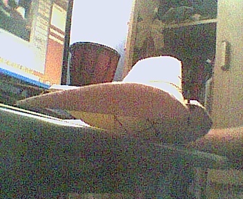

#2490
Join Date: Apr 2006
Location: st-jerome,
QC, CANADA
Posts: 155
thanks neurotex, i will for sure continue 'till i get something flying.

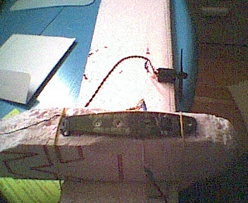

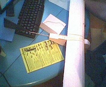

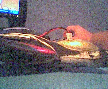

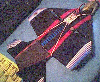

here's a pic of what i'm trying to do with the defender guts.
it's raw and ugly but it will fly, i tried it yesterday... not the best flight ever. but at least it did fly, i have to balance everything again 'cause it flown more sideways then straight.
btw, i did not removed anything of the original rx, all the plastic, plugs, and nicad are still there... i will balance everything and then i will remove all the excessive weight, balance again. it will be a part of my lerning to know the difference between, what's to heavy and what's ok...
the material use is what i could found here (i don't have a hobby shop in an area less then 50 km (35 miles)). so i did my best with material.
- pink foam shaped with a homemade wire cutter for wings and fuse, foam plates for the tail , a bamboo skew for the boom and the traditional tape and rubber band.

ORIGINAL: novielo
i will try with the n20 and defender props. my only concern was that i tought that the 2 n20 at 10-15grams where way to much to make it fly...
props but I believe they only add about 2 to 3 grams more weight. You definately
have to remove the black plastic motor mount casings the Defender uses. They're
just junk weight.
The wing area on the jet is enough to handle the extra weight. If you want it to climb
even more try hollowing out some of the foam on the fuselage. Might be able to get
rid of a gram or two there.

ORIGINAL: novielo
So a mere 25 sq. inch wing will carry 25 grams of aeroplane.
My planes come out heavy because I spare no glue in reinforcing everything.
They hold up better in a crash so it's less glue latter.

ORIGINAL: novielo
here's the pics...
here's the pics...
You could also save some weight by cutting that airfoil down a bit.
[link=http://en.wikipedia.org/wiki/Airfoil]airfoil[/link]

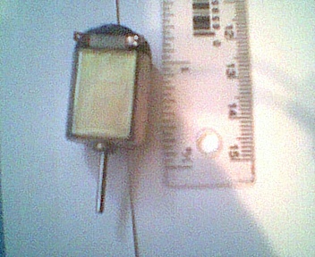

That motor isn't an N20. It looks simular to the motor I pulled out of my Air Hog's Rush plane.
And that motor was truly a hog. Weighed too much for what I wanted.

Looks like you already have the N20's.
If that's a Defender motor mounted to your wing, which it looks
like to me, then there's an N20 under all that plastic casing.

yes, it's a defender motor. tought it wasn't a n20 that i had. where do you get them, the n20?
i also tought that the airfoil was a bit to fat. i'll keep the flat botom design but with less thickness.
a big thanks also for the wiki link, didn't saw that page yet. i tooked the airfoil from an old timer model (in fact the first flat bottm i have found....) traced directly from the pc screen!!!
