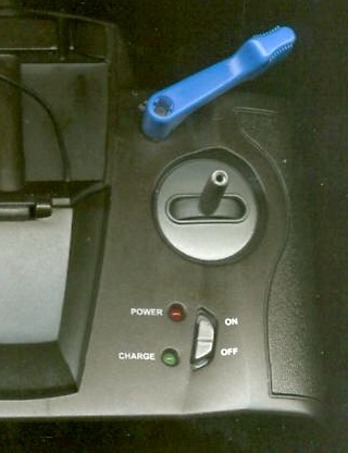

I got tired of fighting that little trim knob so I installed a larger
lever. Now I can trim and steer the plane with just my thumb
or forefinger during flight with better accuracy.
Throwing both sticks to one side or the other I can get better
spin dives.

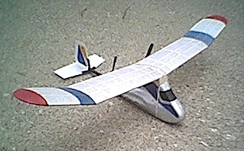

hi Kevin,
here's a couple pics of the lightened AA. it didnt take much, just cut out some slots in the wings, trimmed as much foam from the inside of the fusealge as possible, CF tail boom, 1/32" tail feathers, and thats about it.
i dont have a pic of the modded RXs at the moment, but most of the mods require some decent soldering skills. i removed the M7 charging diode, the blue electrolytic cap, the charging plug and prongs, and the switch. doing these mods will drop the weight of the RX down to about a gram. i was able to do these modifications because i charge the cells with my own charger, not the stock TX charger. most of the components need to remain on the RX if you're charging with the TX though. i'll try to find a pic of the RX.

180 sq. inches!?!
What is that? 3 foot span- 5" chord?
Seems to me the motors are drawing too much trying to lift that
gargantuan wing and frying the Rx's transistors. Look into an FET mod.
You might be on to something. The last RX failure occured after some full power test flying. Perhaps 3 minutes of it. I would think that is within RX design limits. It also occured on the side where I extended the motor wiring so there may have been some extra resistance. If the FET mod involes RX soldering, I'll have to consider this experiment a dead end. The wing is 30 inches with a 6 inch chord. About 40 grams in AUW.
Micro, thanks for the pictures. I think it's worth another $30 to give this one more try.

Klouche,
Another thing you might want to try is make the wing with a shorter chord. I don't know how you have your wing constructed, but if you can make a 30" wingspan with a 2" or even 3" chord would have much less drag then with a 6" chord. Plus think of all the weight you'll save! Even if you made your wingspan a little longer, it would definately help. Think of a glider, they have long narrow wings because they're highly efficient and have little drag. Worth a shot anyway...
Snit
