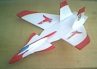

No motors- it's a spoof.
I cut the wings off to test glide some other wings for a jet I'm
building and just pinned the wings on ****wkcab.[sm=spinnyeyes.gif]
The pic is an idea of what I'm shootin for.
Not sure about the CG (red dot) or the location of the prop slots.
The elevator is adjusted at the rear which is flat. Should the tail
be angled up slightly? Any ideas?

you sure know how to pick the challenging designs, neurotex i assume this is the one based off the S-37?
i ran across a thread not long ago that was talking about canards, someone mentioned that the canard wing should be near the stall point for its angle of attack, for more autostability when/if it stalls out. plus, with a more forward CG, it makes it a bit more stable as well. although, stalling might not even be an issue with its forward swept main wings.
you should build a real basic balsa or foam chucker, so you can adjust the angles without having to worry about messing up the finished product (or losing all the time you invested in the finished product). if the balsa/foam chucker gets trimmed well enough, you could just stick in some AA electronics and then work out the thrust angles. once all that is done, you can just copy it and put it all to work on the finall build.
i'd start with the elevator at 0, with the main wings at 0 as well, and then have the canards at 3 degrees positive (who knows what the needed angle would be). with everything else at 0 except the canards, you wouldnt have as many variables to deal with all at once. if you find a sweet spot, then you could use the elevator to really tune it in for a better climb rate or more flat glides. i dont know if you bookmarked this link, but you had posted it a while ago, it might prove usefull in finding the CG: http://adamone.rchomepage.com/cg_canard.htm

Thanks again micro! I'll make a smaller foam glider at about half
scale. I'll start everything at 0 and make the canard adjustable
as well as the wing, that way I can try out quick adjustments.
With the final plane I'm going to start with the fuselage first and
build it flat in sheets, lay 2 sticks of hard balsa length wise and then
build it up from there, installing the wings and rudders last.
On the S-37 the wings have a nice dihedral. More than most jets.
Should be an interesting build.
Haven't tried that link yet. I'm wondering if the calculator will even
take these wing measurements.

ORIGINAL: micro_builder
no problem, Neurotex. just out of curiosity, how big is the final version going to be?
I'm thinking a 9" wingspan with 26- 28 sq. inches of wing area.
This test glider has a 6.5" wingspan and is extremely stable. I'm amazed at how
stable it really is. After cutting rudder flaps it's still stable even in tight turns.
The nose won't drop. The guy who dreampt this design up is a genius. I don't
think the S-37 was the first.
The glider is flat hot glued to a balsa stick. Cut exactly from the plan I posted above.
0 on the canard and wing with the rear flap up 5- 7 degrees.
The dihedral is about 30 for each wing from the fuselage with some clay at the nose.
CG is about where the leading edges meet the center of the fuse.
Fleet of foamies that would make great AA conversions.

nice little chucker, Neurotex. have you tested its "anti-stall" abilities by chucking it up at a high angle?
hope the final build goes as well for ya, its a good looking design.
