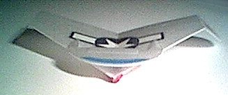

Finished the airframe for the FSW jet. 1.75mm foam plate for the bottom
reinforced with two balsa sticks with 1.13mm foam plate covering on top.
The rear of the fuse is airfoil shaped so I should get some added lift from
it since the wing design channels air flow back down the center.
Weighs just under 4 grams. If I can keep the wings and rudders down to
5 grams she just might fly.
[link=http://www.area51zone.com/aircraft/switchblade.shtml]switchblade[/link]

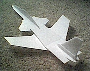

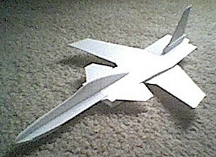

Thanks, I really don't spend all that much time on building. The airframe took
about 3hrs. while the plate foam test gliders usually take half an hour.
The X-29 below left took about 35 minutes. It could easily be scaled up into an
AA conversion and built in several hours.
Found some good glue at ACO for foam builds. It's called Duco Plastic Model Cement
and is a good bond for polystyrene.

* (pics right) X-29- AA size. 14" length, 8.5" wingspan, 10.2 grams. 1.80mm plate foam.

I don't know, I should cut down the canopy some more, it's like a forward rudder
to some extent. That might help a bit. Soon I cut this stock jet open...[>:]
Pics & plan for a surprisingly stable flying wing.
Should make the AA go nutz!

Neurotex,
I was referring to the pic in post 3272 on the wide turning.
The one in post 3746 should be very acrobatic. Kiss your butt turning and the ability to loop pretty easy when you see the nose "pop" up when turning into a puff of wind.

ORIGINAL: MegaByte-2
Neurotex,
Tony
ARS Software & Innovative Solutions
http://www.falcon1.net/~ars/rcmodels.html
Yeah, that's the one I was talking about- the X-29. The canopy acts like a
forward rudder in a sense. The smaller model takes turns nice. The larger
version, for the AA works, glides great but I haven't tried any turning with
that one yet.
The flyingwing (flig) flys great also once trimmed up. It takes turns on a dime
and once you start adjusting the flaps, does some crazy stunts.
I'm making a larger AA version for this one also. Should be a blast to fly under
some power.

the Fling is neat looking! i may have to use that as my foam plate flyer cookoff contestant. i'll build one today, as i just happen to have a huge stack of foam dinner plates by my feet
interesting about the anhedral in the wingtips. does it help its stability a lot? did you try it with a polyhedral wing?
