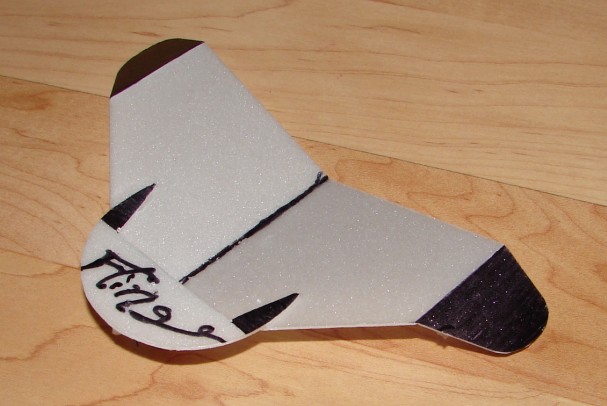

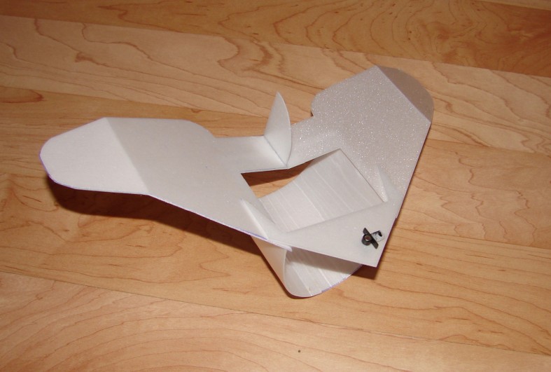

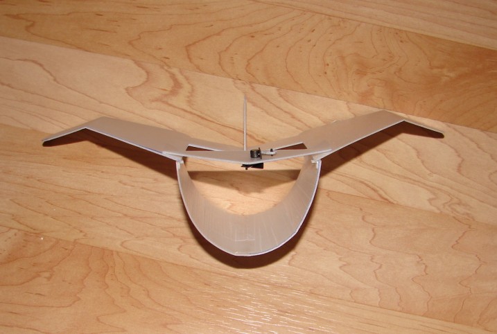

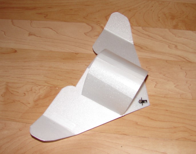

the Fling is sweet just got done building one and tossing it around inside and outside. if thrown in the wind just right, she'll cruise around for a short while, hard toss results in a loop. i added a little something to mine just to try. i poked a hole in the bottom of the lower wing and inserted an inch long peice of CF through it, then i glued the CF rod into the upper wing (canard?). added a little peice of heatshrink tubing to the CF and now i can adjust the angle of the little upper wing. it can make for big changes in flight. the thumb tack was the only thing i had within arms reach, but it seems to work well.
i didnt check to see how long it took to build it, but it wasnt very long, used two foam dinner plates and foam safe CA for contruction. these could work really well for AA or other equipment, quite stable for a flying wing!
nick

The fling looks good, maybe with the 1/2 powered motors?

ORIGINAL: micro_builder
the Fling is sweet
Amazin' ain't it!
I found that the wing tip flaps do the brunt of the turning as
well as some of the lifting. Wing flaps really haul it upwards.
You've made the bridge adjustable I see... already modding it.
ORIGINAL: FERNDALE AIR FORCE
Build one Ferndale, put the 1/2 motors in it with an old lipo you don't
want and free flight it.
nick
Could you post some instructions on how to build that? or is it just different length foam glued together at angles. Also, how much weight does the foam safe CA add?

ORIGINAL: googledperson
The glider is as far as I've gotten so far. A larger version will take some patching
together unless you have some larger sheet foam.
The one I made has a 7" winspan and was made from several plates of 1.75mm
foam.
Cut each wing half from one plate and then glue it to a balsa stick. I used hot glue
and the extra weight made little difference.
Then cut out the half circle bridge and glue it to the wings. Make sure you cut the wing
& bridge flaps for trimming. It does need a fine tune up.
Last add weight to the nose until you get a nice glide. You might need a bit of "up"
elevator to the wing tip flaps to get a nice lift.

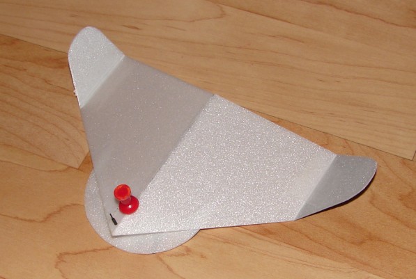

micro, I'm having my doubts about using a 10" wing span. I slapped together a
10" model and hooked up an N20 with a capacitor. The planes flys really good but
has a slow climb rate. The N20 & cap weigh 7.2 grams.
The AA works are going to weigh about 10 grams, so maybe an 11" or 12" wingspan
might work better.
Also I noticed your model has less dihedral than this one. Did you find rolling to
be any problem? Might make another one with less an angle, maybe that will help.

neurotex,
the 10" model with an N20/cap should be a good combo, i wonder why she doesnt climb hard. did you try adjusting the motors angle and CG (probably a silly question)? there's more drag on a wing type plane, and with the prop getting blocked it creates a little more drag, but there should still be pleanty of power to push that plane around. maybe a bit of up trim on the flaps would even do it.
mine has a lot less dihedral than yours it looks like, i didnt really measure the angles when i put it together, but there havent been any problems so far. even when i whip it up for a loop, she almost always went all the way around rather than rolling out of it. however, i built a 10 inch version as well, but this one has the channel in it. it has even less dihedral, no rolling issues, but this one turns to a spiral every launch, no matter what. if i try to toss it to the right a bit to compensate for a left hand spiral, she just spirals right my wings look dead straight, and i had even put a verticle stab on it to act as a rudder, but she still spirals.
i'm guessing its the channel. my plans got a bit warped and twisted when i printed, so the channel peices came out larger than they shouldve been. the channel needs to be trimmed down and i need to find a way to make the channel bend in a perfect half circle, with CF i suppose, and the remount it and see if it helps. assuming it does fly, the SWP parts will get some use. heck, it might even be the pointed upper deck wing, rather than the rounded one - who knows?
nick

Where is the CG on that plane? Cause it looks like that channel has a ton of side area ahead of the CG....just my guess but I'd say thats whats causing youre spiral. Dont know for sure ...but I think it will spiral whether the channel is built perfectly strait or not.

You've got me as to why it spirals but I would guess it's the channel
acting like a giant rudder against the sweep of the wings.
The one I was working on spiraled also when the angle of the motor
was to steep. I finally got some lift out of it by installing a switch and
then over charging the capacitor to get some more RPM's. I also made
the bridge (canard?) adjustable with a pin to help. Lift is better but still
not what I hoped. I'm done with that now since I used up about 8 batteries
and finally fried the cap.
I also might redesign the bridge and make it bigger. It took some trimming
to get it to fly so anything you come up with to help stabalize it would help.
Now to start on an AA version.
