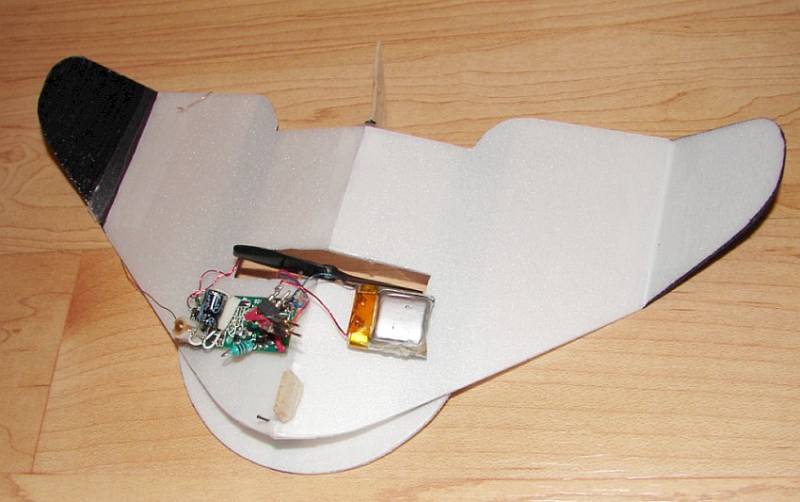

i took a shot and tried electrifying the little Fling, the one straight off the plans. .6g actuator for the rudder, AA motor and prop, Silverlit SingleWing Plane RX, and a 50mah lipo from the Picco (talk about a grab bag of parts!).
unbelievably, it actually flys, and very quickly. i'll need to reduce the size of the rudder as it gives way too much turn. unfortunately, i'm having a little issue with the RX so i need to tinker with that a bit more, but i got few little flights to show me that it will actually fly. the motor has 0 degrees thrust on it, and the weight is at 7.2 grams. with 0 degrees thrust, it didnt want to climb much untill i really gave the little canard wing a high positive angle.
i'll try to get the RX working tonight so i can get some more time with the plane tomarrow.

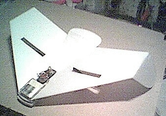

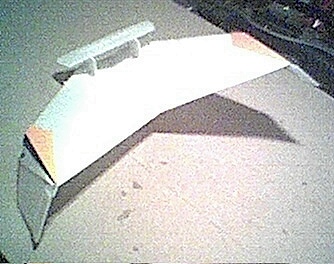

ORIGINAL: micro_builder
unbelievably? hey, I have faith!
Hope you get the RX squared away. I found that too much of a motor angle
causes a tail spin and the canard is sufficient enough for lift on the smaller
versions.
I think I may have solved the lift problem by adding spoiler flaps to the
trailing edges. Lengthening the bridge also helped quite a bit. It seemed
that the larger and heavier the plane became the more top surface resistance
it needed to keep it aloft.
It now flys very well with the 10 grams of weight but she's pretty beat up
so I'll have to build another one. It actually flies better with the wing tips
down. (can't figure out why either)

i should've had faith too! i didnt think it was going to fly cause i figured i was going to end up with some terrible prop torque issues, but even though there's 0 degrees left or right thrust, prop torque didnt seem to be an issue at all (just the oversized, over deflecting rudder!). the soldering iron is warming up right now so i can try to fix the RX.
what i find interesting about the Flings design is that most flying wings have at least some amount of reflex in the LE and TE to give it some stability. the fling doesnt have either and is still quite stable, i'm guessing its got something to do with the dihedral mated up to the anhedral of the wing tips (though anhedral usually creates a less stable craft). interesting that the larger it gets the more reflex it seems to need, at least on the TE side. i think having the wingtips down more would help stability, acting as a rudder of sorts.

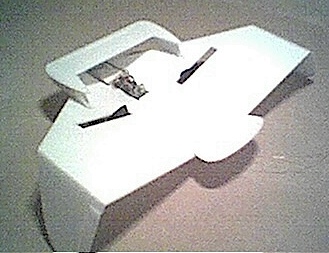

The basic design I found I lifted from Airplane News Jan 42.
It's a Northrup design I don't think ever was built. At least I can't find
anything like this prototype.
(notice the lil rudder) you may want to add the rudder under the plane.
The lil foamie I built of it had the usual flyingwing problems. It jus fluttered
about no matter what I did. It needed a stab but after adding the canard
forward it didn't look like a flying wing anymore. So I went Star Trek on it
and added a bridge. More like a canard cheat.
I can see why it wasn't built in its day. Unstable without the present technology
of computers. Not to mention the problems you would have in a full scale
model. Not to mention the problems making it an AA conversion.
edit: I'm having no luck at all making a forward swept flyingwing (FSFW?)
version with a bridge. Sorry micro, but it's just too unstable.

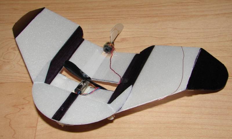

interesting design on the Northrup, no surprise it never made it to production, tailless wings are just too much without computer assistance.
i've built a slightly larger version, 8" span, and re-installed the electronics on it. interestingly, it didnt want to climb much, like your larger one, neurotex. i think it had more to do with the CG and canard angle, after a crash, the canard was at a very high angle of attack and i flew it that way and it climbed very nicely. the lipo is recharging right now, so i'll see what happens when its charged and ready.
bummer about the forward swept version. maybe a more traditional approach with some major reflex in the TE and LE would help stabilize it enough. wouldnt be suprised if it needed an oversized rudder to help calm it down too. i suppose i should finish the Fling first though
googledperson,
the Fling is a pretty straight forward build. only takes a couple foam dinner plates and some foam safe glue. the AlleyCat has been built by a number of people over on RCG, i havent built one myself, but it looks pretty straight forward too. the plans can be found in the plans section here: http://aatoolbox.no-ip.org/ speaking of the toolbox site, Chris is working on a "master toolbox" page where the AA, Picco, and the Silverlit SingleWing mods can all be accessed - http://www.rctoolbox.no-ip.com/
nick
edit: woohoo, she flys! bit more stable than the smaller one, climbs well enough, and the turns arent so bad now (though a right hand turn causes it to lose some altitude). she cruises along at a pretty good pace, at one point i had it high enough that i made a hard left turn, and she rolled over and looped! AUW is now at 7.8 grams, i'll try to get some video. nice design, Neurotex...you know if you dont enter this into the foam plate cook off, i'm going to have to, right?

Another random thought as to why it flies better with the wingtips down... Its having the same effect as STOL wingtips. (pic below)
They decrease spanwise flow (air spilling off the sides of the wing) effectivly increasing lift. They also make stalls less severe and easy to recover.
Congrats micro, fantastic job!
Sure, by all means enter it in the cook off. You've made it into the air while I'm
still on the board.
Making the bridge adjustable is the way to go since I've noticed on the larger version
with the spoiler the bridge flap causes fluttering. With the flap down for lift it causes
air turbulance over the spoiler, and the plane rocks up & down. Having the bridge set
at an angle like you described is enough for smooth flight, even with the spoiler, it flys
nice.
