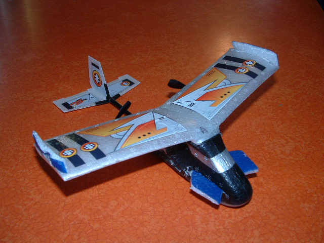

I just got back from some experiments with both cannards and wing spoilers (What are their names on a plane?). A bit of a breeze makes conclusions iffy but here's what I found. The spoilers do tend to control the tendency to roll over in a turn so that was nice. Angling the cannards down JUST a little helps reduce climb rate. BUt it doesen't take much or you get a nasty dive. I use doulbe face tape so I can take things off, change angles and configurations. I found that with everyting on the plane flew ok but some slower. Not as slow as the biplane and more fun then the biplane but not as a speedster like the mono wing without all the attachments. I don't know if it is a weight issue or an air flow issue. I'll let you guys play with it. Have fun. iIm trying to add a picture to this post to show both the modifications.

I've found that even making minor changes to a planes
design can have drastic results. I noticed that the wing rudders
you installed have an airfoil to them. It might be better to use
a flat material instead of a curved wing left over. Same with
the cannard. For my wing tips I used styro foam from a pie
plate. You can also use sheet balsa.
Flatter surfaces should cut down on the drag and speed the
plane up a bit.
The motors that I used were from an Air Hog's Defender. I found
the TX from the plane and it says Defender on it. I stripped off the
plastic motor mounts to cut down on the weight and mounted them
directly to the wing with an angled balsa shim. The props are 2.2"
long instead of the stock AA's props which are 1.7" in length. The
thrust seems to be doubled and the sound is a deep hum. What a
difference!
Ferndale, hope the V works out for you. If at first the plane flys
unstable don't give up on it. You might have to shim the tail up
or down a bit to find the sweet spot. Once you find the right setting
you'll be amazed at the performance.

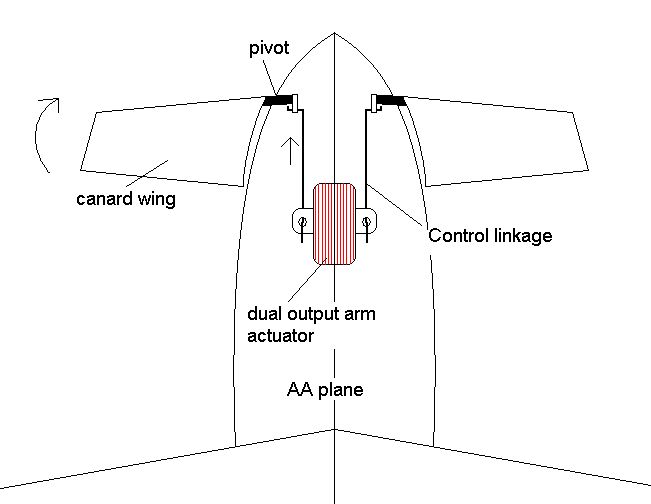

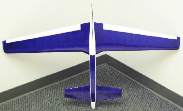

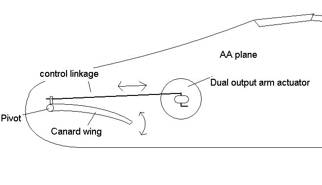

how about these for canard planes? the S1A is a plane being made by a hobby company, and the StarShip is a burt rutan design, a very good design at that.
if you got the canard wings in the position that you wanted, you could even go one step further and add an actuator to the AAs RX. use an actuator that has dual output arms, make your canards on hinges like ailerons, connect the two, and when you turn left or right, the canards would pivot up and down, opposite of eachother, and help aid in the turns.
if you know how to solder, adding an actuator takes about as much time as it does to do the turn w/o throttle mod... 5-10 minutes. oh, and please excuse my not-so-wonderful MS-Paint skills. i wasnt about to get CorelDraw up and running for the little drawings
nick

I've got the same 3 views of the Beechcraft 2000 from a
William Green's book and thought too what a perfect design
for the AA.
As for the actuator... hmmm, I'm still deciding if I should attempt
the right stick mod. Even thinking of buying that TX from Aero Ace mods.
