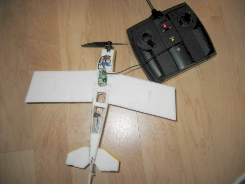

    well, heres the SingleWing conversion. the plane is a Micro Ultimate, this is probably the 3rd set of electronics that its had installed and probably has the most thrust. i already had an actuator installed for the rudder, so that cut down on a lot of the hastle, and i simply cut away the most of the gearbox and then just glued it in the nose. when i built this plane, it was from the first set of plans that had been drawn, which didnt have any incidence angles, so its hard to get it flying right, since the tail, main wings, and motors are at 0 degrees, the CG has to be set pretty accurately, especially without an elevator.
    it was pretty windy out when i tried to fly it tonight so i really couldnt tell how it was actually performing, but it did fly. i'm probably going to put some incidence in the wings this weekend to help get more lift (despite having twice the amount of wing area, i couldnt say it was any slower). AUW is just over 24 grams i think, i need to double check.
    so far so good though, the electronics certainly have some potential. i'm sure there will be more to come!

    Lol that prop is half the wingspan...sorry I just couldnt help but say somthing about that.

    armedzagi, yeah, the prop is a bit oversized...just a little (its not too bad though, some of the rubber powered free flight planes have props almost as large as the entire wing itself!).
