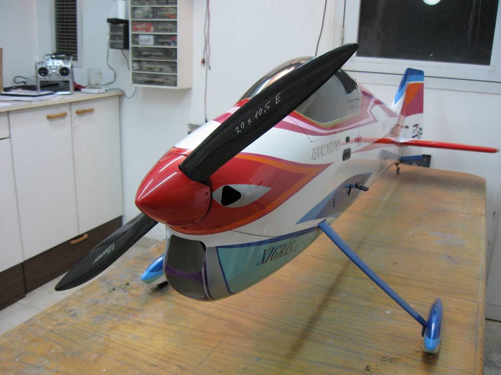

We have tried all props and the latest motor works at best with the 20x10,5 APC; accidental the same prop, the best pilots fly at the best and latest four stroke engine.
But with approx. 152 grams, this prop was too heavy for our motors and in the meantime, Günter Ulsamer have a version of his famous carbon-props (weight approx. 70 grams) with the same characteristic.

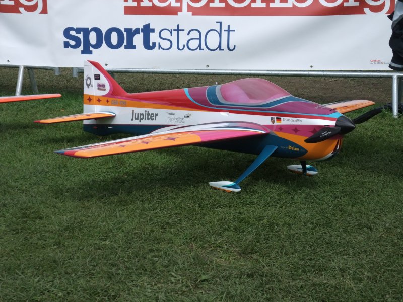

At the picture my new Jupiter ( Delro composite line) for season 2011 with Q 80 20P/11s. Official weight at the EC /Austria: 3670 grams without drive-batterie.
(Thanks to Ola Fremming for the nice picture)

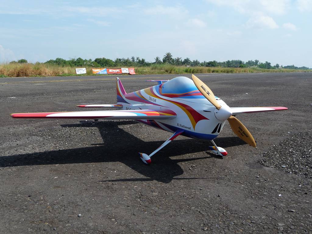

What i saw at the AOC championships in the Philippines was awesome. A totally different approach to prop selection. On Hatta's Pegasus he had a very wide bladed wood prop on a Q80, what was unusual was it's size. It was a 19x13. (19x14 for the hacker 14XL)These props look almost like the old rubber powered model ones.
Now the funny part is the Japanese with there YS170's were running 20x10.5 APC props. Again these combination's were awesome, quiet and not short of power.
