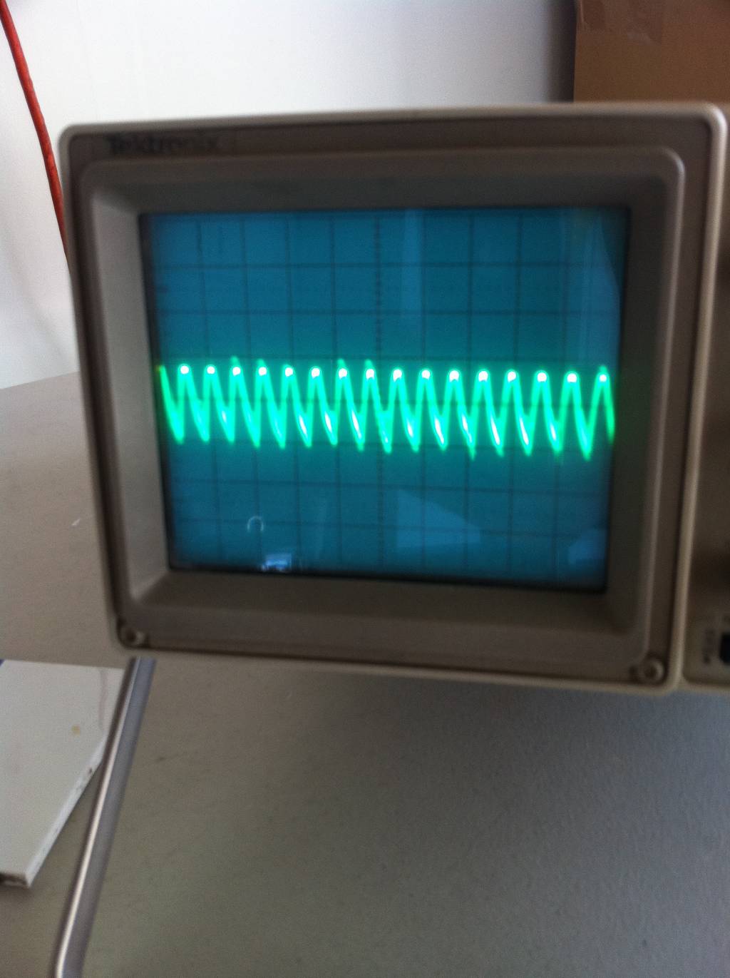

I had been thinking about a redundant power system and this looks like an easy way to do it. While I'm at it I will put a voltmeter on the connection to the bottom two cells that will tell me when I plug it in that the pack is charged (or not). You never want to take off with a pack that isn't charged.

Is that ripple at commutation rate or at the chopping rate? Sorry I couldn't read the timebase.
400 mV on two cells! I guess it's not that surprising. So that works out to maybe 2V peak to peak across the entire pack.
Sounds like more filtering at the ESC would lessen the current peaks at the battery. I wonder if the batteries will respond well to that.

We need the regulator to get down to 6 volts and it does the filtering so I don't see a need to do anything else at the battery/ ESC interface.

So it's the chopping rate that we see. Okay, that's high enough to easily filter out of the regulator output, and low enough not to cause any RF issues, seeing how the RX ground is going to end up riding on top of a common mode noise signal at the same frequency.
I wonder if there is any real high frequency crap as well? I can't imagine that the big electrolytic caps we see on any firm's ESCs are any use at RF. I would imagine that 2.4G is completely unaffected, but 72 Meg just might get unhappy.
