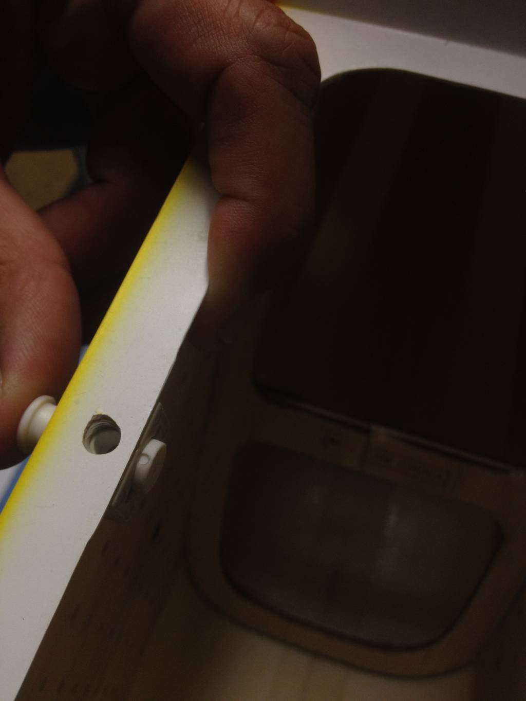

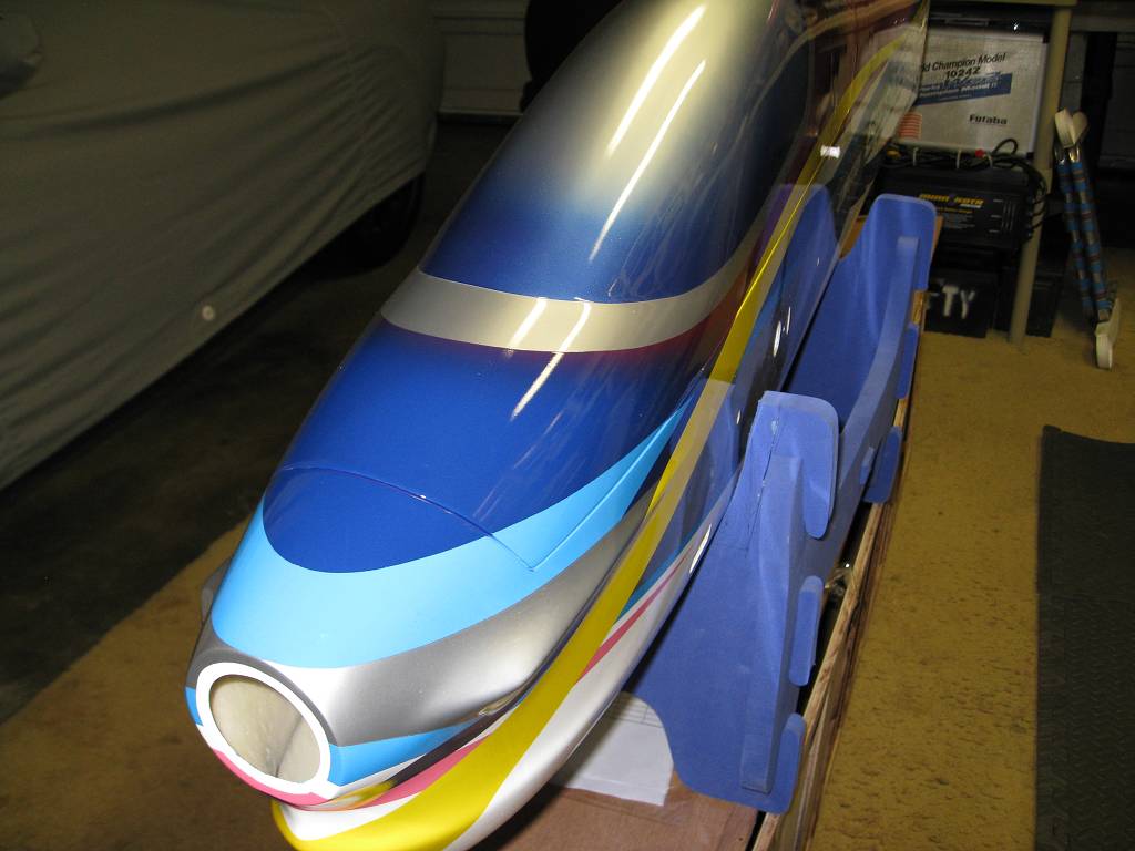

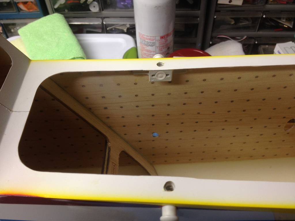

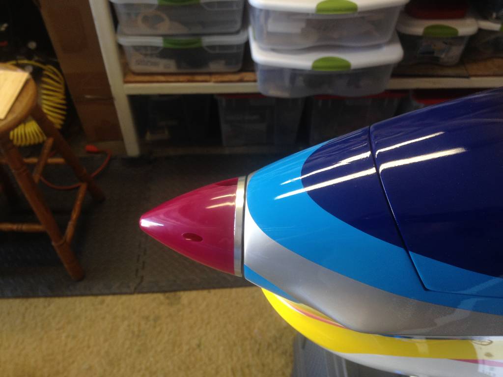

Sorry to leave everyone hanging. I intended on posting some pics last night but that banner message at the top of the forum was something that I should have paid attention to. The RCU site shut down at 10pm.
I got my Episode direct from BJ Craft and not part of the first shipment. I am lucky enough to be part of the BJ Craft team so I got mine early. I will do the same sort of build post that I did for the Nuance. Hopefully the info I post will be helpful to those of you that are waiting for your planes.
This is basically a Nuance with modifications. The basic fuselage shape is nearly identical, the only change is the height of the vertical fin as far as I can tell. The canopy is very different so that the Canalizer can mount to it. It includes heavier fiberglass and a support structure. It also attaches with the quick release buttons, not a latch.
I am going to power this with a Pletty Advance. This will be my first time trying a Pletty, so I am anxious to give it a shot. I also plan on using the OS ESC.
I'll try and post weights tonight, although it should be very similar to the Nuance. I plan on attacking the motor installation first since it is the toughest part. Overall, I have to say that it is really sharp looking. It looks much better in person than in the pics. That's what I said about the Nuance as well, but the color scheme on the fuselage is really neat.

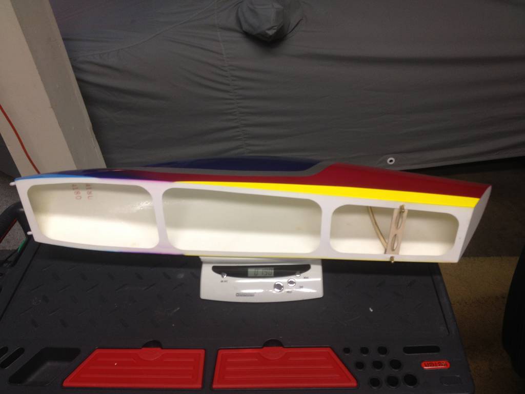

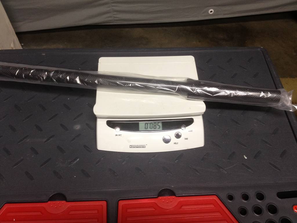

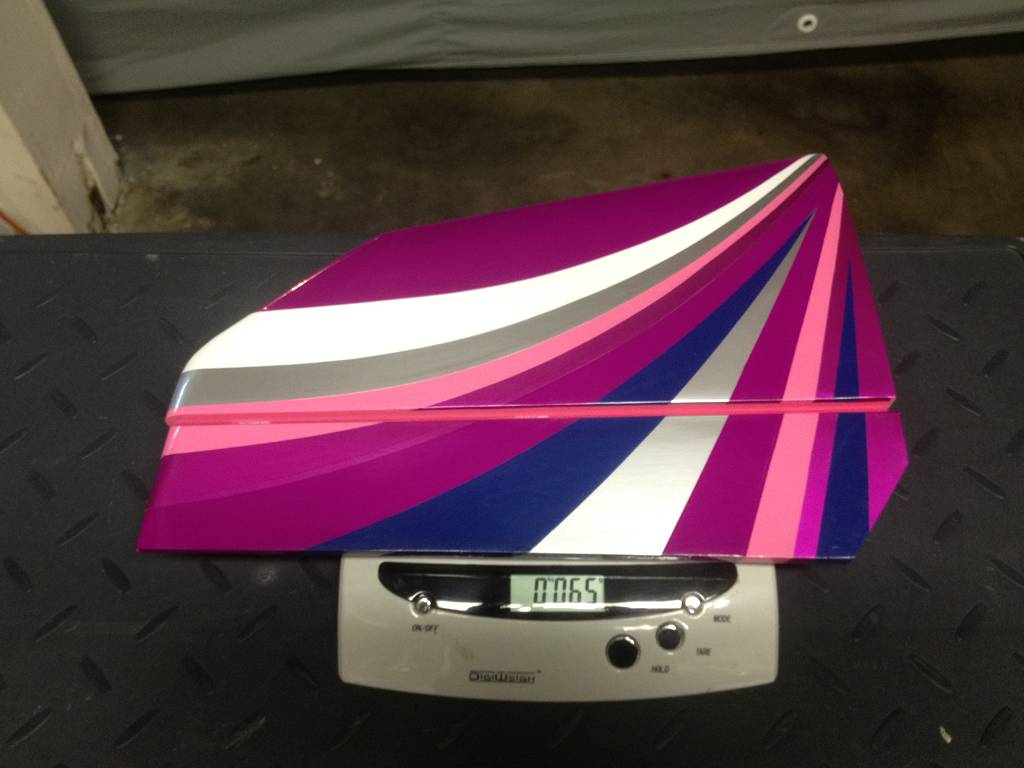

Here are the weights. I used the same scale that I used during the Nuance build thread so the weight comparison should be apples to apples. Based on the feedback that I got from others with their Nuances, my weights seemed to match what others were seeing.
NUANCE WEIGHTS
Rudder 45g
wheel pants, wheels & axles 50g
tailwheel 10g
Left and Right landing gear and mounts 135
Horns and Linkages pack 60g
R Wing 330
L Wing 330
Wing tube, stab tube, anti rotation pins 85g (wing tube 65g)
L Stab 70
R Stab 70
Fuse + canopy hatch 1080
That totals 2265.
EPISODE WEIGHTS
Rudder 55g
wheel pants, wheels & axles 45g
tailwheel 10g
Left and Right landing gear and mounts 125g
Horns and Linkages pack 55g
Stab Fences 10g
Canalyzer 85g
R Wing 285g
L Wing 290g
Wing tube, stab tubes, anti rotation pins 85g
L Stab 65g
R Stab 65g
Fuse + canopy hatch 1100g
That totals 2275. I am pretty surprised by this. I figured it would be quite a bit heavier, but the wings are so much lighter due to the reduced area. A few other items are lighter as well. So, it should be WELL under weight.

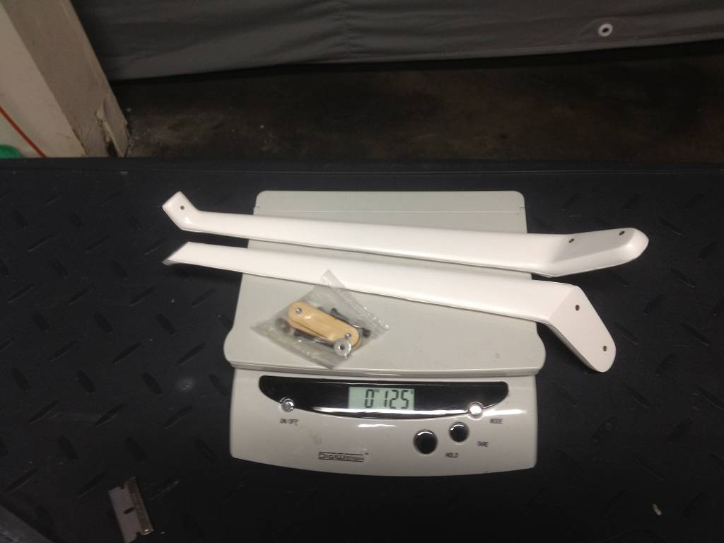

I decided to do a side by side weight comparison to see how much heavier the reinforced Episode canopy was compared with the Nuance. To my surprise, the Episode canopy was lighter! Episode Canopy = 190g Nuance Canopy = 205g. That one I can't quite figure out. Maybe my added wood cross braces on the Nuance account for the difference. He has included cross bracing in the Episode canopy

Firewall is in so I thought I'd post a pic. The spinner is 70mm plastic with aluminum backplate from Airborne Models. I may swap it out for an anodized tru turn with the cooling hole cutouts.

Quote:
ORIGINAL: shannah
Rudolf the rednosed reindeer....

Actually, it's purple...LOL. I have a white one, light blue, and dark blue as well. I'll try them all to see what I like best. So far, the white and purple match the best. The purple is a good match for the purple on the fuse, oddly enough. I think I got all of those for less than $35.
