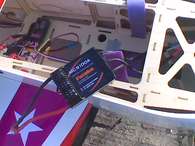

    Futaba MC 9100A ESC
    Having only been flying Jeti/Hacker Comp 90 ESC's since 05-06 (I think) I've always looked for something that was a direct replacement since they stopped making them. The Spin 99 is the closest to it, but even it isn't as easy to program as the old Comps. Since I'm now down to 2 Comps, it was time I started figuring something out. Over the holiday's I was able to do some flying with the new Futaba MC 9100A ESC. I must say, it's the closest to the Comp as far as performance and ease of programming (with the recommended programmer). The only real difference is the throttle transition seems smoother with the Futaba than the Comp.
    My plane set-up is as follows:
    Plane – 2M Osiris (prototype)
    Motor – Fury 60/67-230
    Prop – APC 21x13W
    Batt – ThunderPower 5000 45C (my 20C are 3 years old and a bit weak at the end of flights)
    ESC Settings:
    Batt type - Lipo
    Lipo cut - 3V
    Cut type – Slow
    Motor Direction - Normal
    Timing – 24 degrees
    Acceleration – Normal
    Start Power - Normal
    Brake % - 90%
    Brake – On
    Poles – 28
    Gear Ratio – 1.0 : 1
    Temps the days I flew were low to mid 70’s and the ESC was 123F when I took the canopy off to check it. This is with the ESC mounted on top of my batteries with not much air flowing to it. I will need to find a better mounting method than just that lol. I'll probably drop it in the chin for direct airflow to it.

    Had the chance to check it out and fly this set up this past weekend (Thanks Jason !). Airplane flew very well and very smoth throttle response.

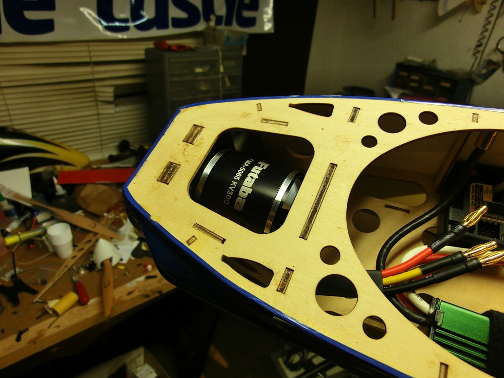

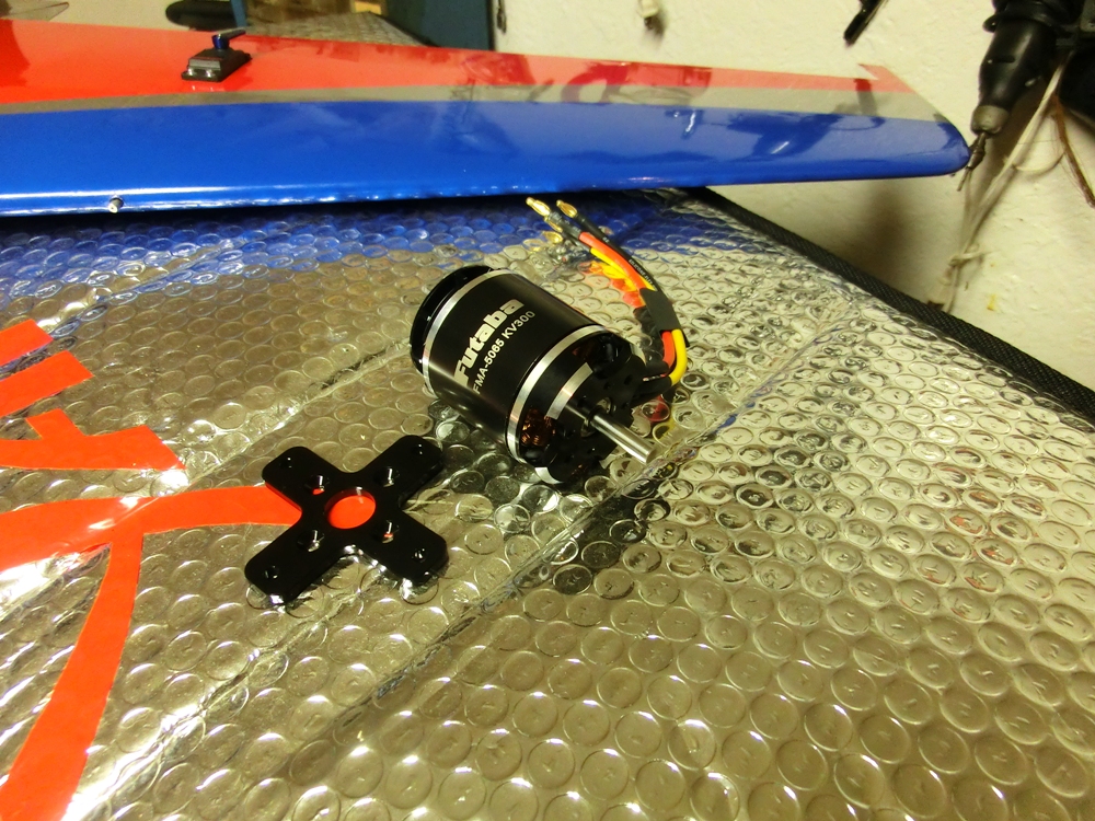

    After checking out the link to Futaba above I set out on a mission to get my hands on one of the 5065-300KV motors for my Wind 110e. A little luck and pulling some strings got it done. I was expecting the absolute highest quality and was not surprised once I got it in my hands. even the motor mount is fully machined. I will start on a 17x10 on 8s and go from there. Thanks for planting the seed Henning

    Bill
    Did you have to change much to mount the Futaba in your Wind 110 ? Can't wait to get ahold of one

    The firewall was a bolt up but the rear mount needed rework because the motor is shorter than a Hacker. I had to find someone that was going to Japan to get mine because no one has it in the US. Futaba told me they wouldnt ship to the US and none of Japans hobbyshops that carry it will sell outside Japan. Its a great motor and if you can get one you will be happy with it. I wish they would just go ahead and put their OS badge on it and start selling them in the states. 18x10 xoar at 7400rpm gives 14.5lbs static and 63 amps on 8s 20cand runs cool

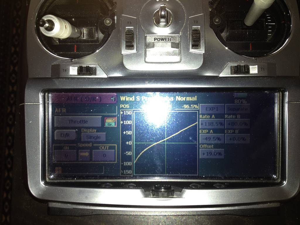

    Thanks again. It is not clear if you can turn the brake on and off in the air by changing the low end pulse width. My current Spin 99 setup gives me idle at low stick position (no brake) and ''brake'' when I switch to a shorter pulse width. In the no brake condition, I do have to jog the stick to get it started initially but once it is started it transitions off of idle very smoothly and the motor never stops. If I have the brake on, lower pulse width at low stick, it is not a smooth transition from off to idle. My YGE does transition from brake to idle very well and it is what I was hoping the Futaba might do too.
    I assume with the Futaba programming technique you would get ''brake'' at low stick position and would need to switch to a higher pulse width to get an idle at low stick. Is that doable? How do you set it up?
    Jim O
    [/quote]
    Yes Jim it's doable.
    My set up for Plettenberg Advance 30-10 and 14MZ
    ESC:
    Battery Type: LiPo
    Cutoff voltage: Auto
    Battery cutoff type: Soft
    Advanced Timing: 24ΒΊ
    Accelerations: Normal
    Start Power: Lowest
    Air Brake: On, 60%
    Motor Pole No: 20
    Gear Ratio: 1.0:1
    Radio:
    End points:
    High 80%
    Low 100%
    The break is executed when the stick is at low position. I do not use idle. Startup is super smooth and transition from break to power is seamless.
    I fly with APC 21x12WE in a Wind S Pro. The plane does not induce much drag so I only use 80 % power and have more than enough power for F3A in strong wind.
