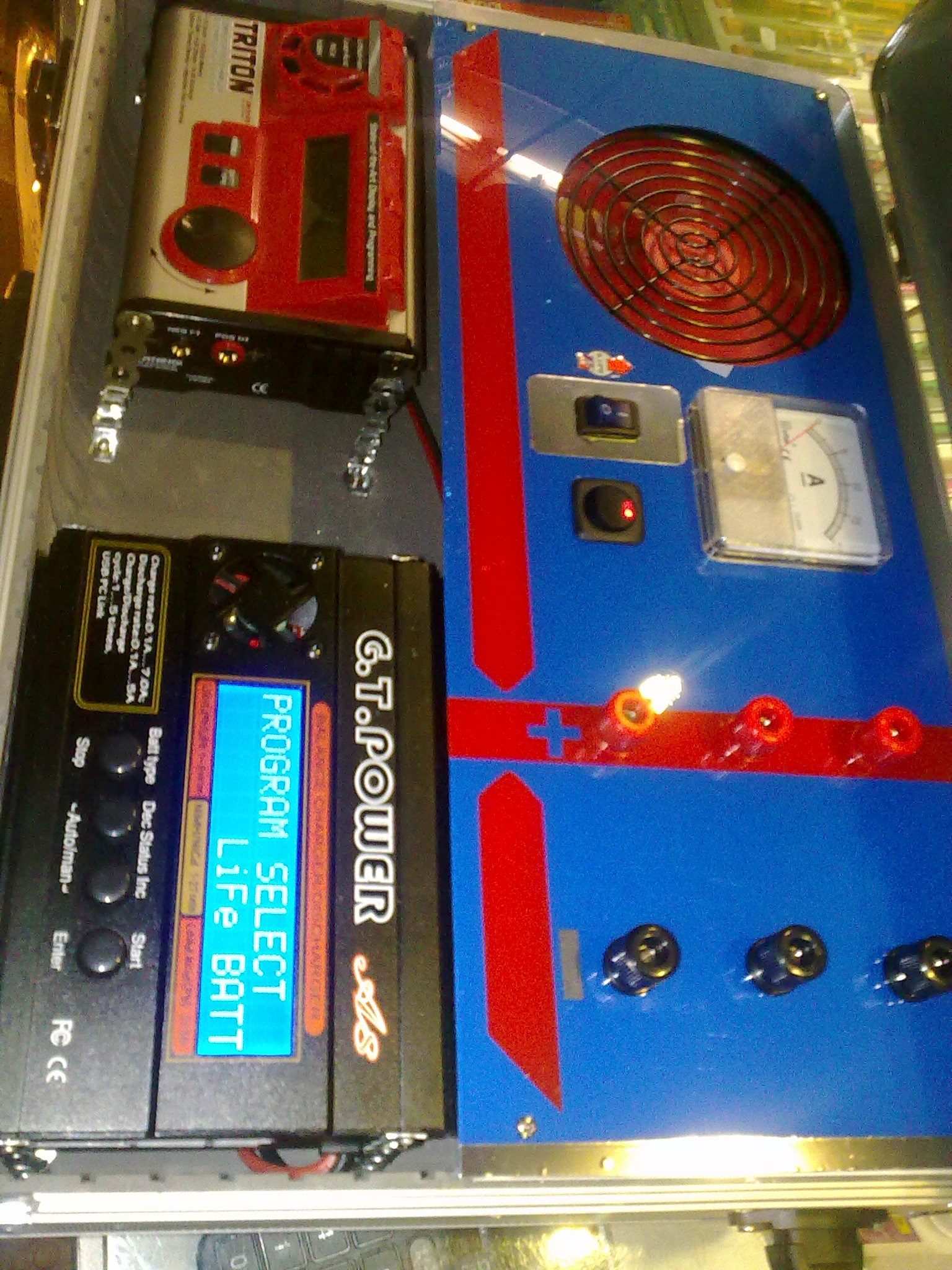

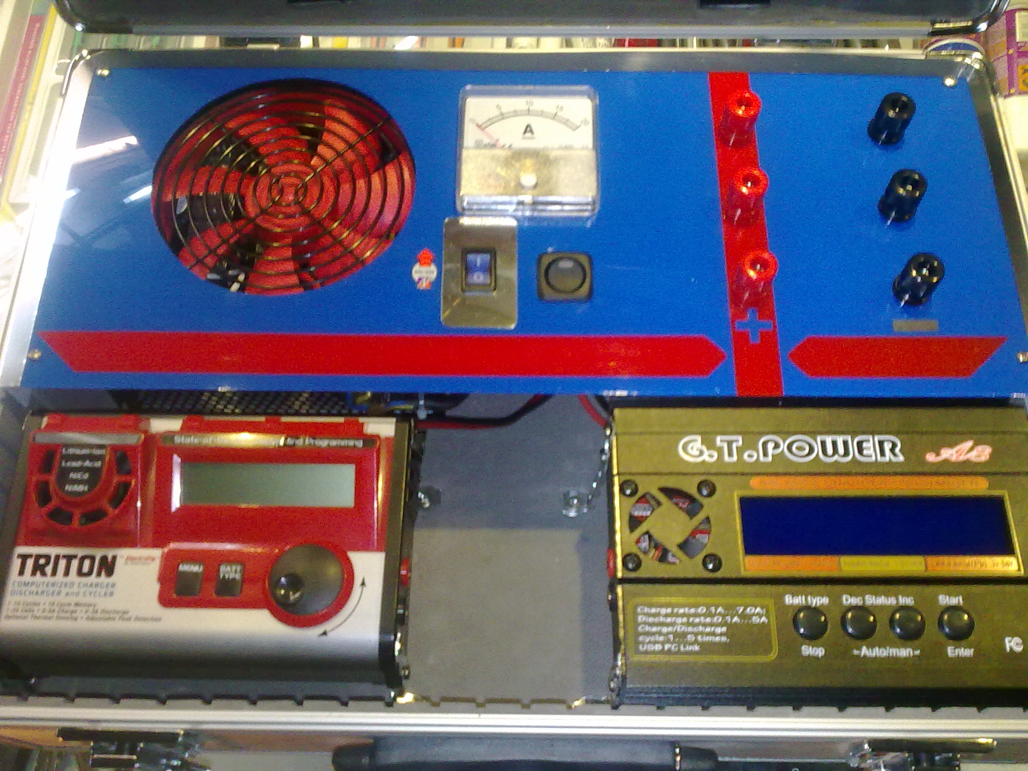

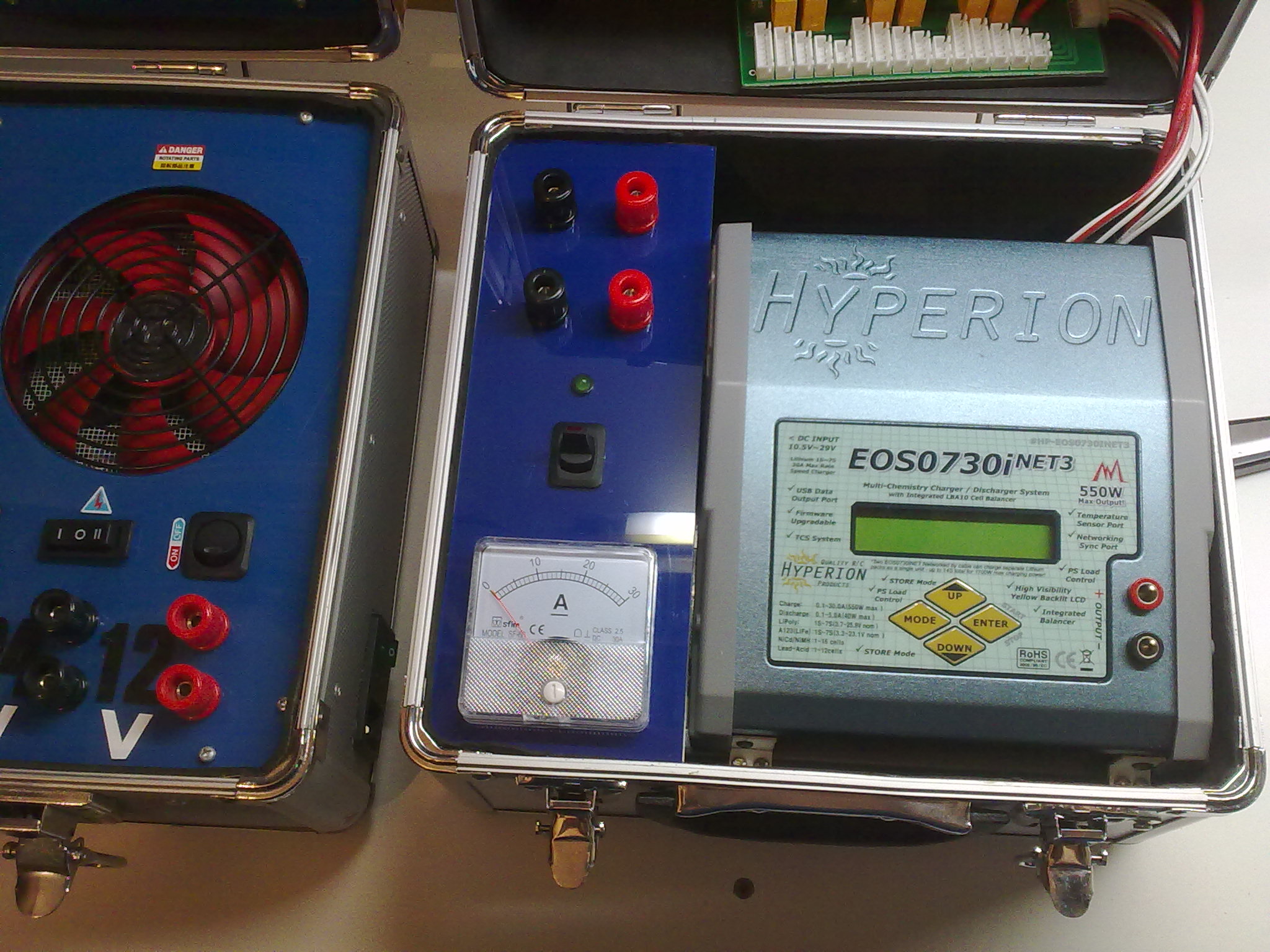

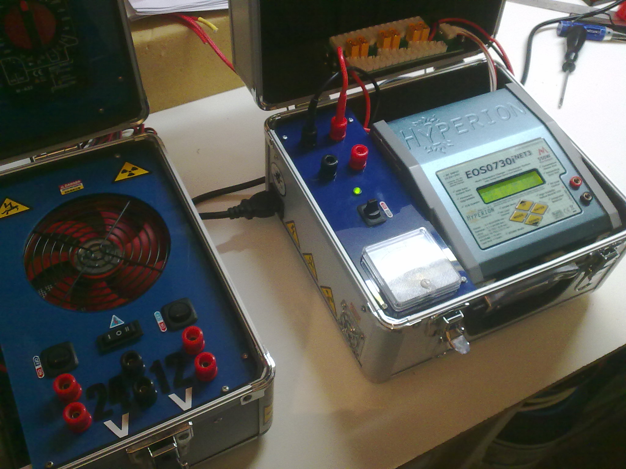

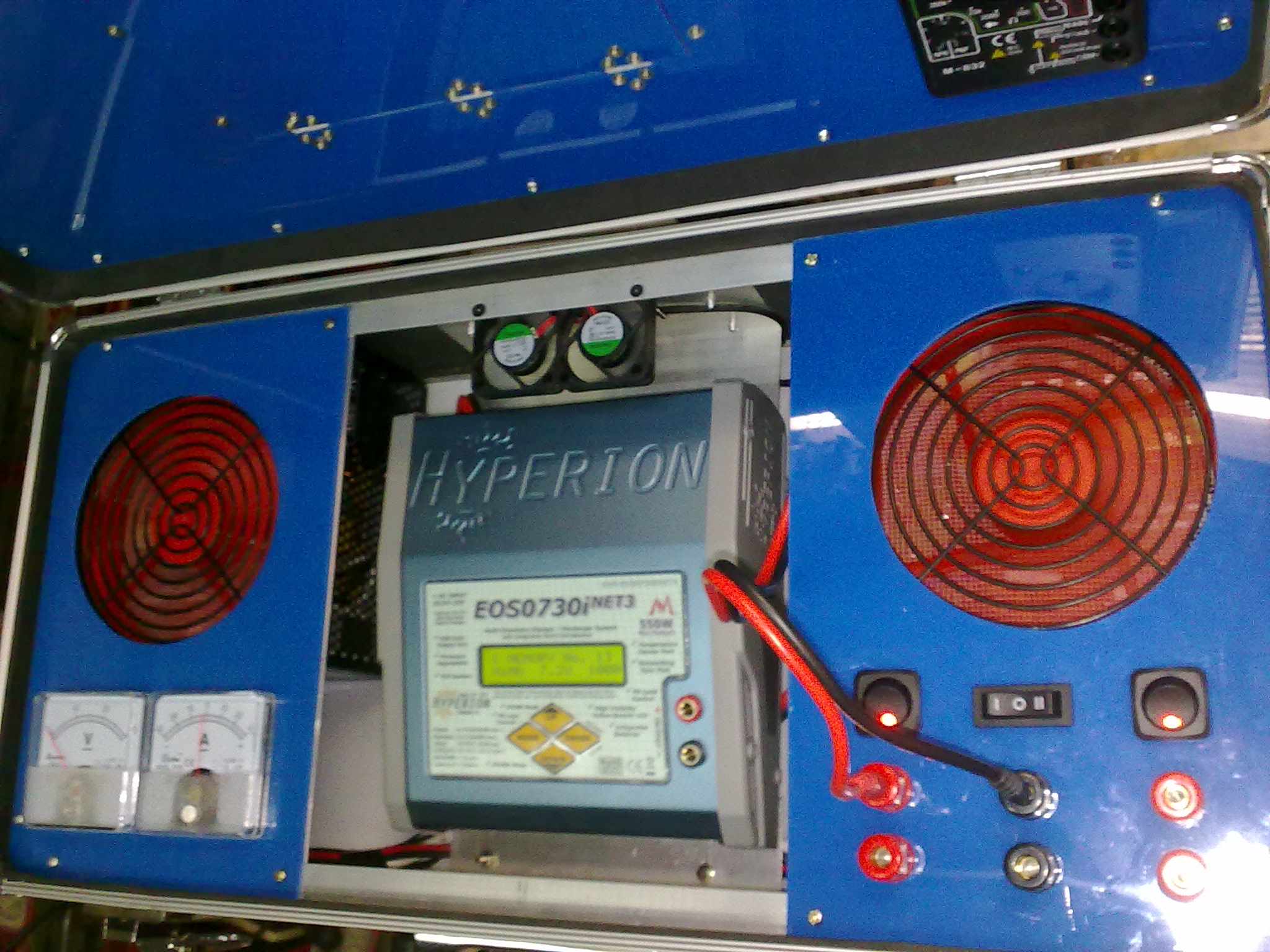

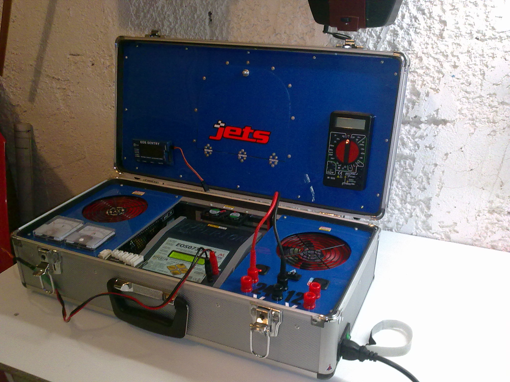

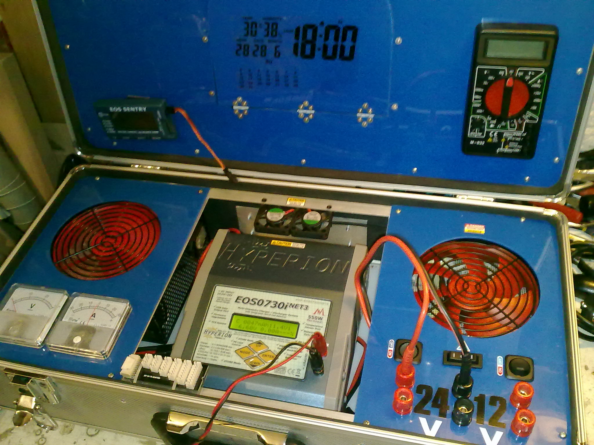

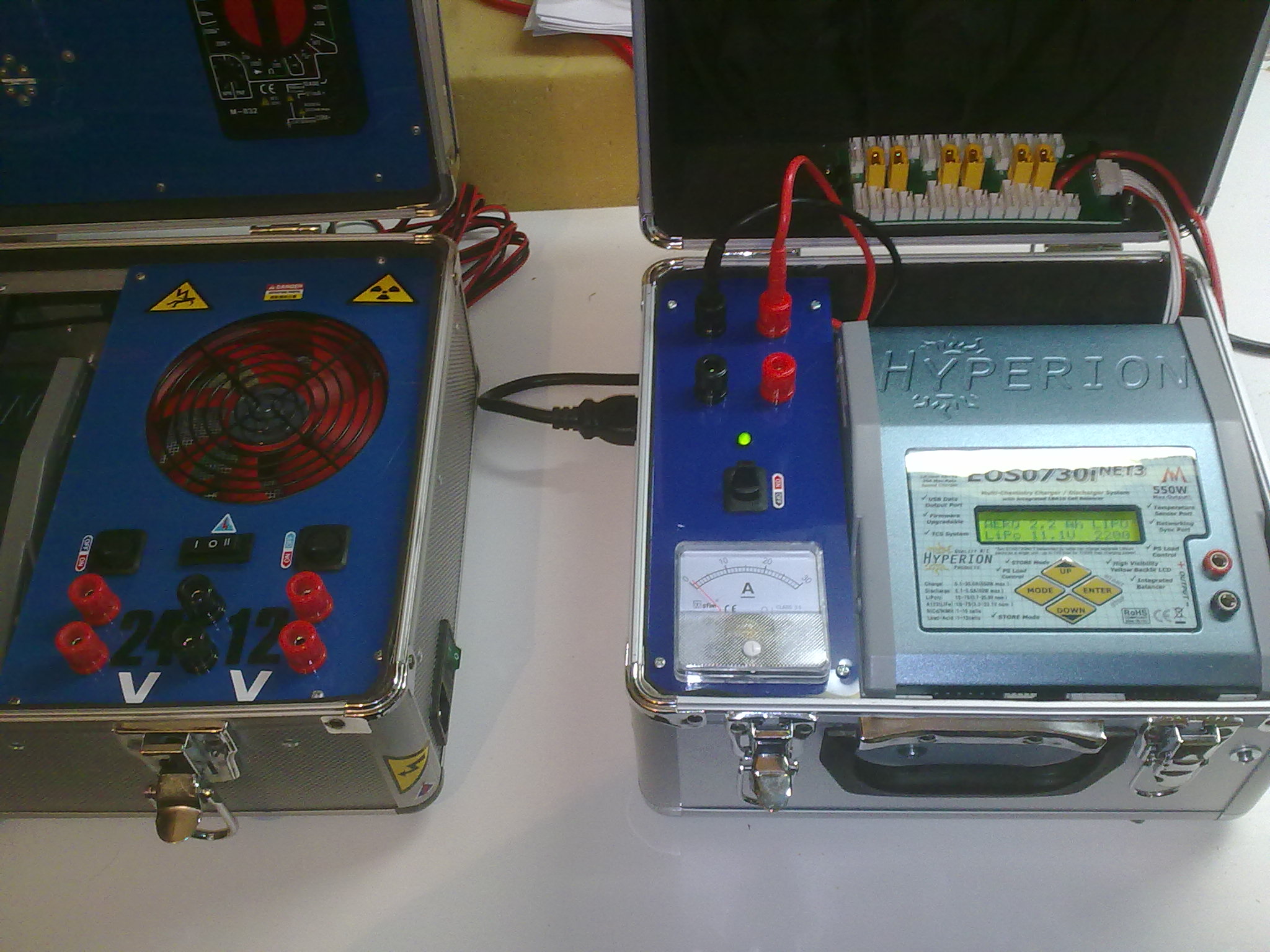

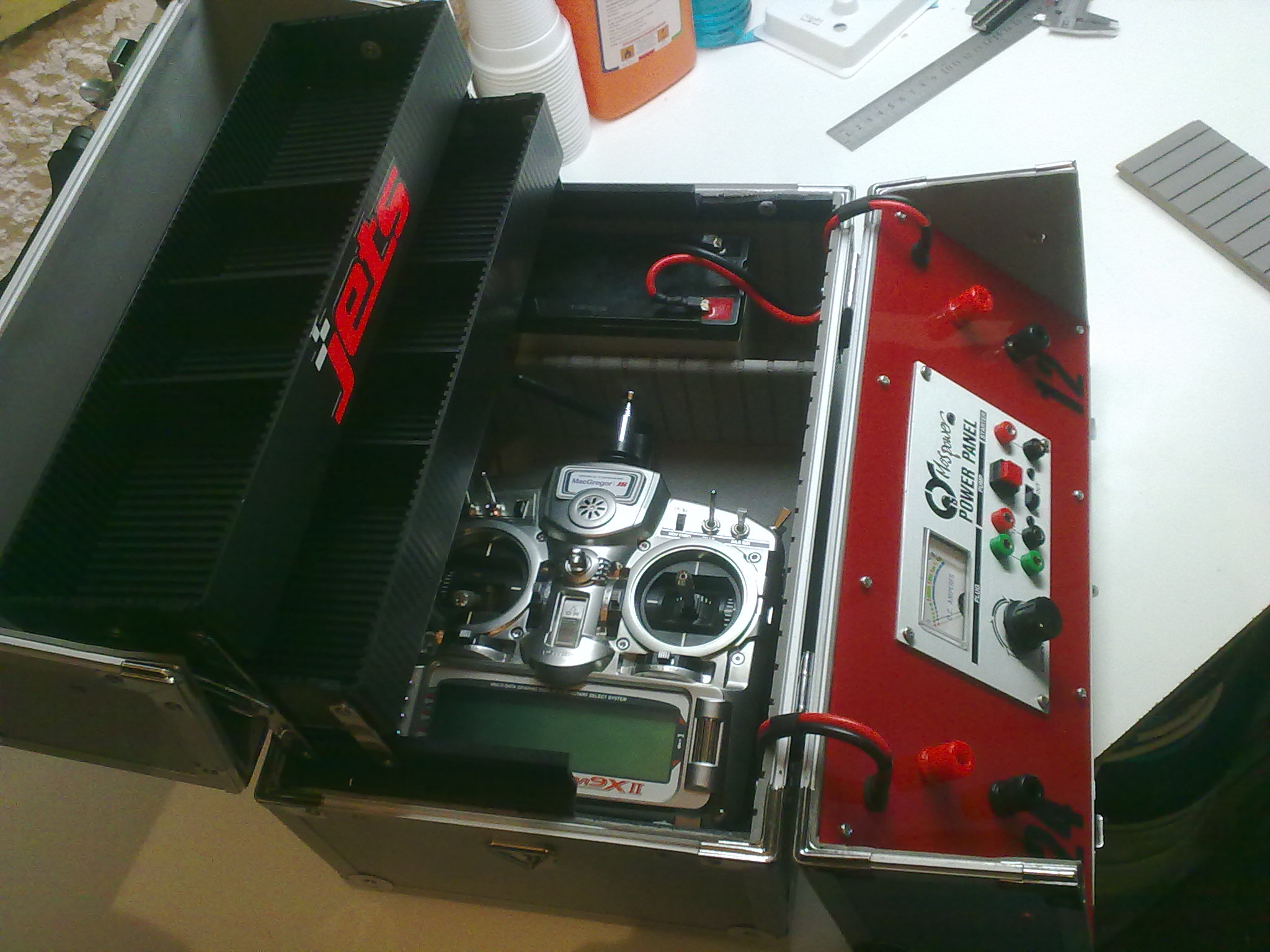

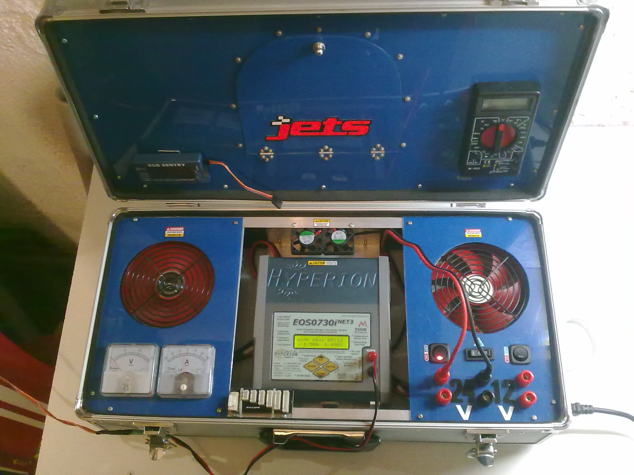

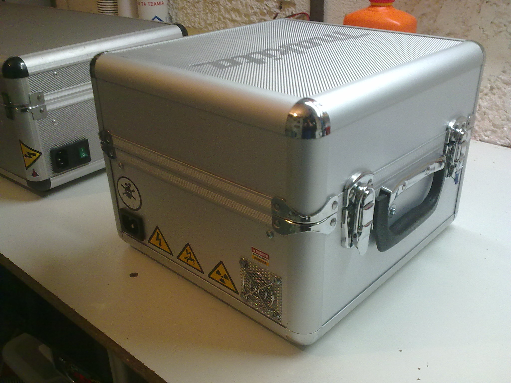

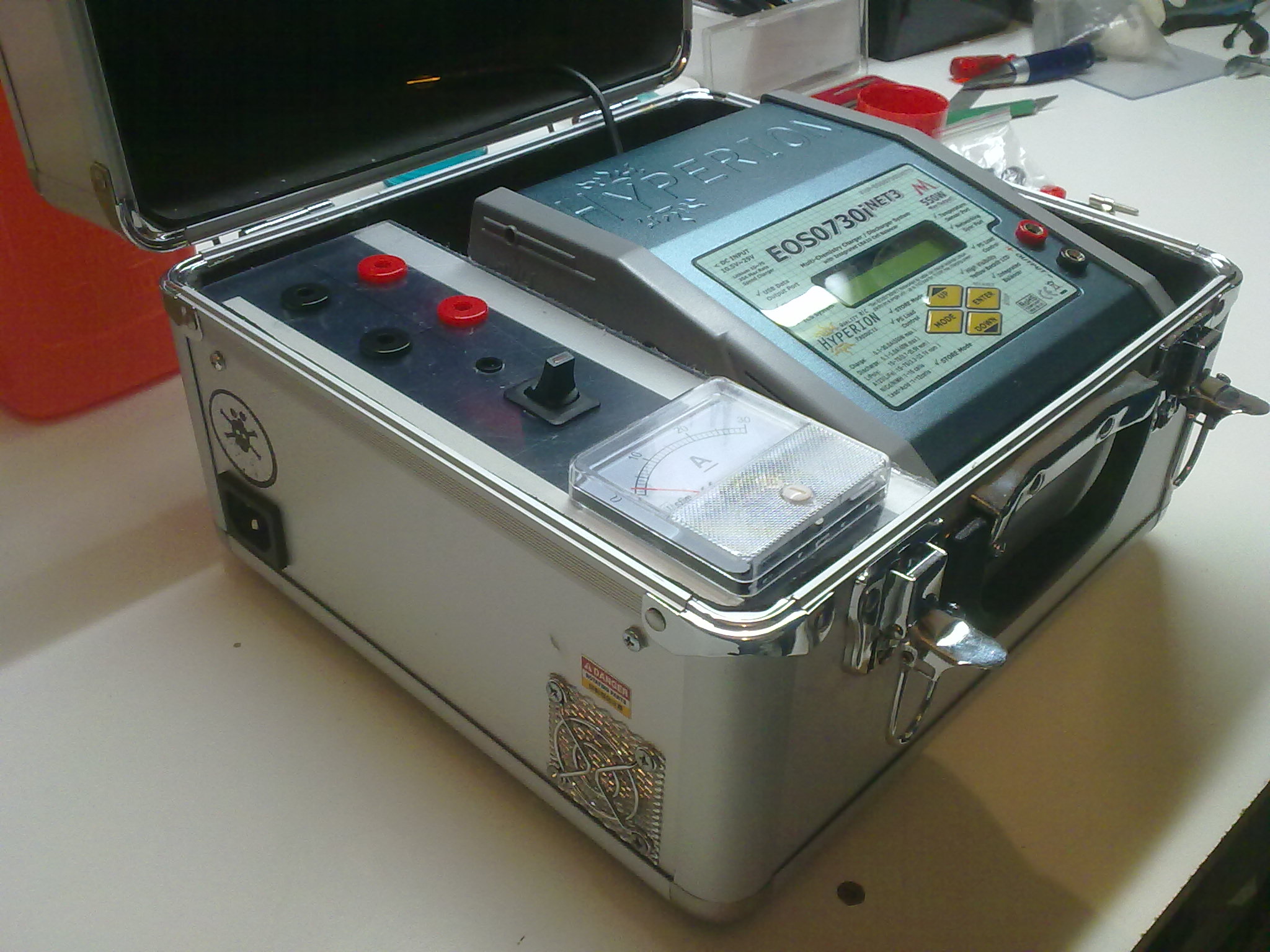

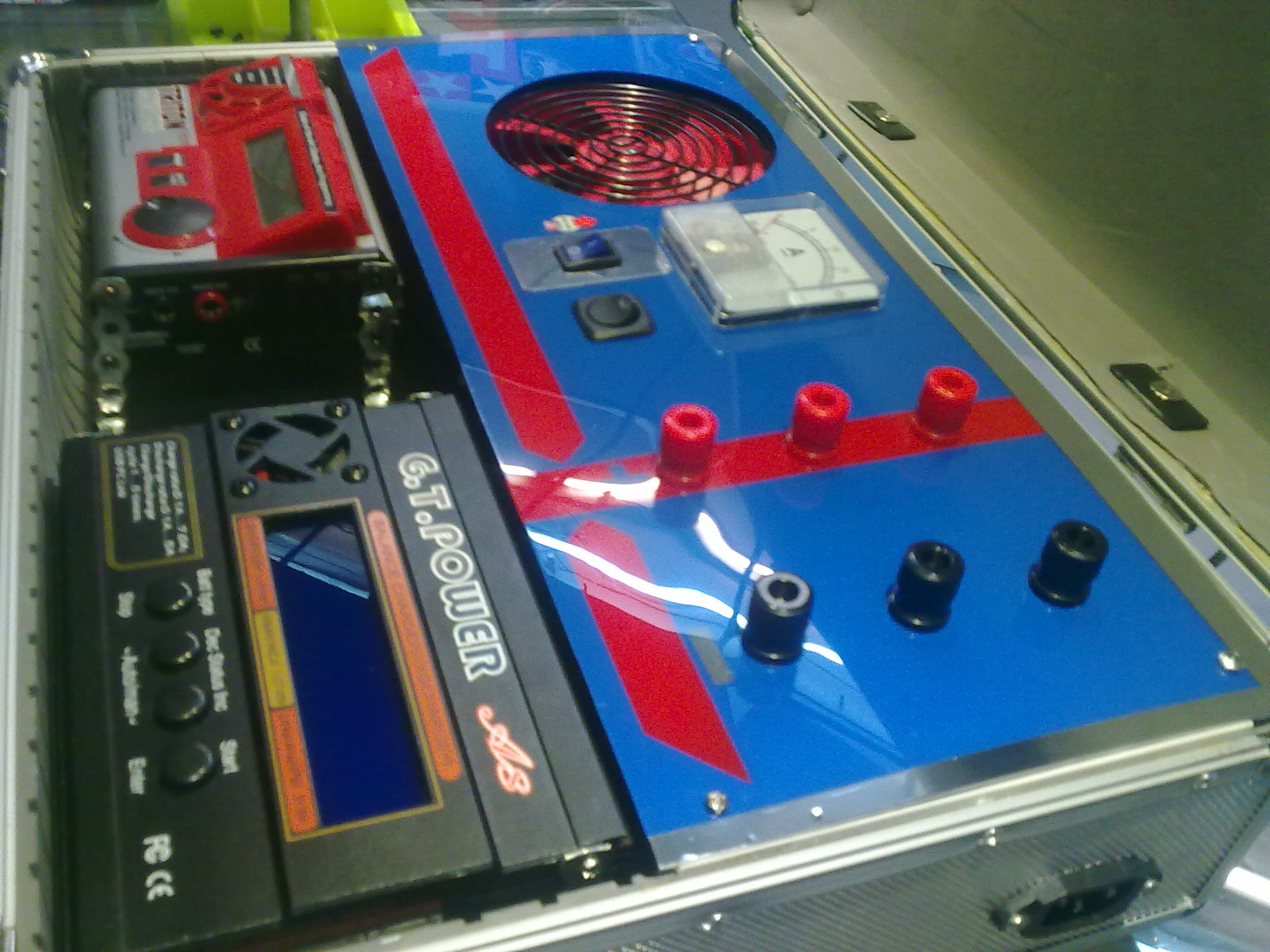

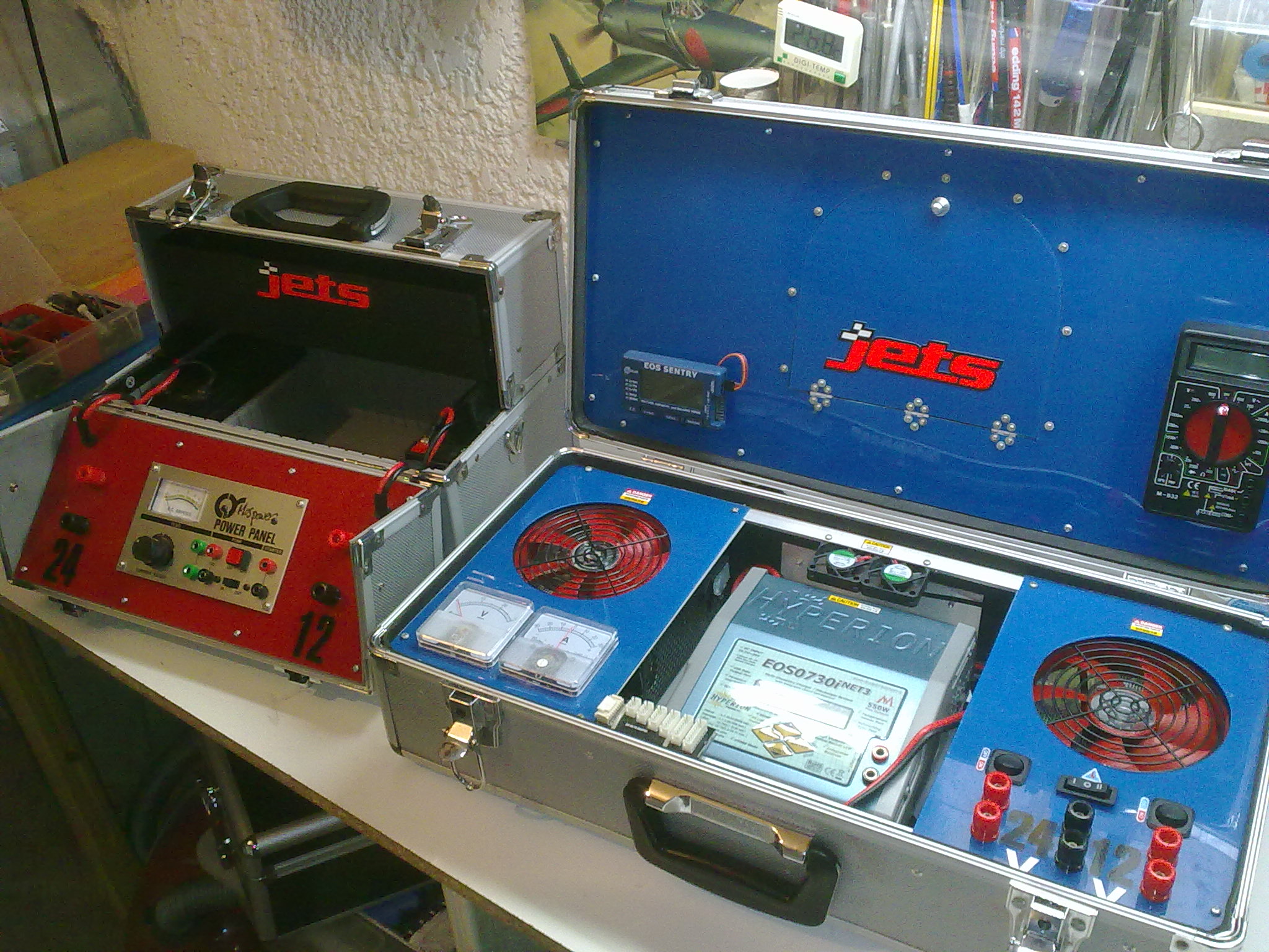

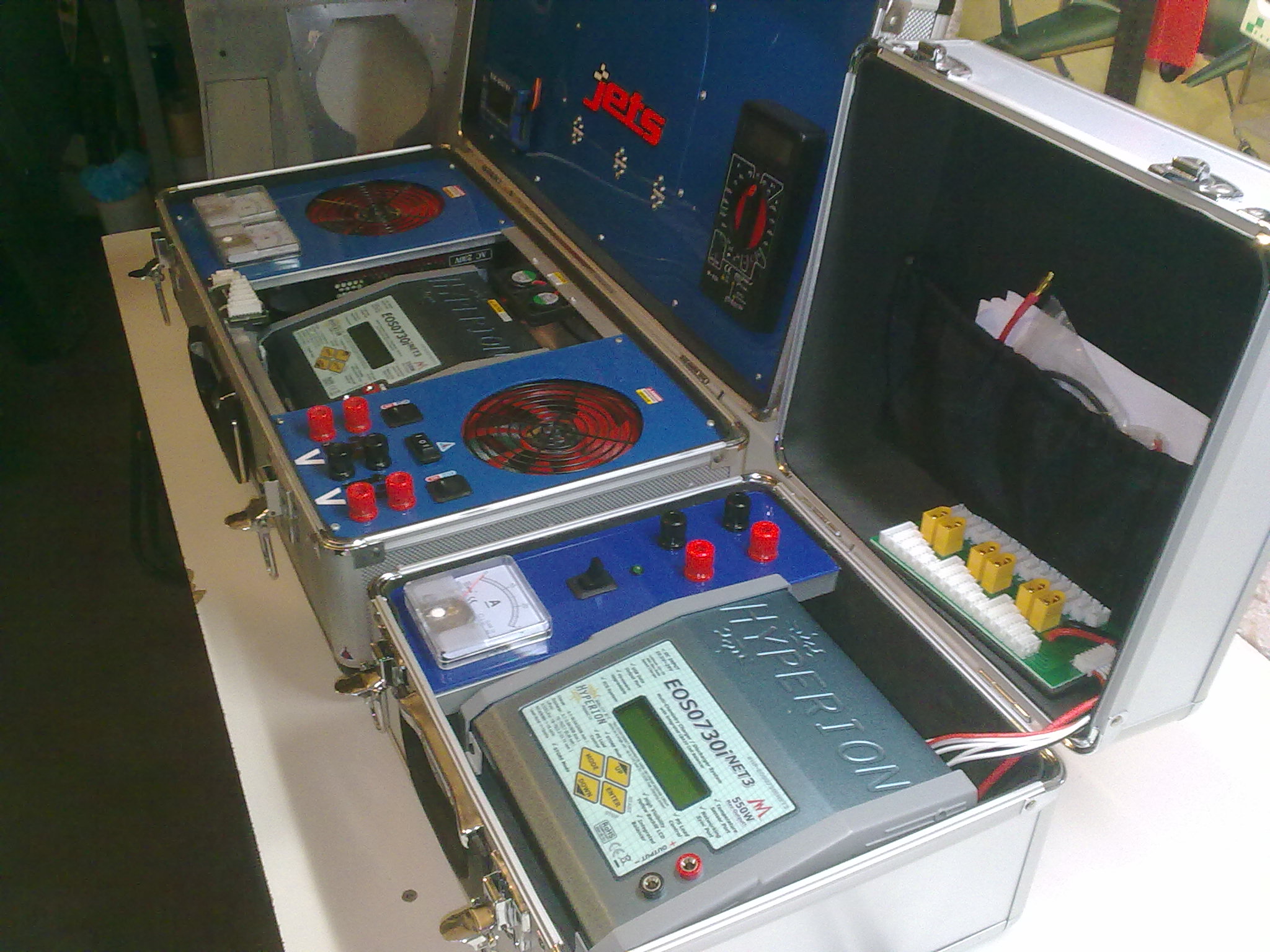

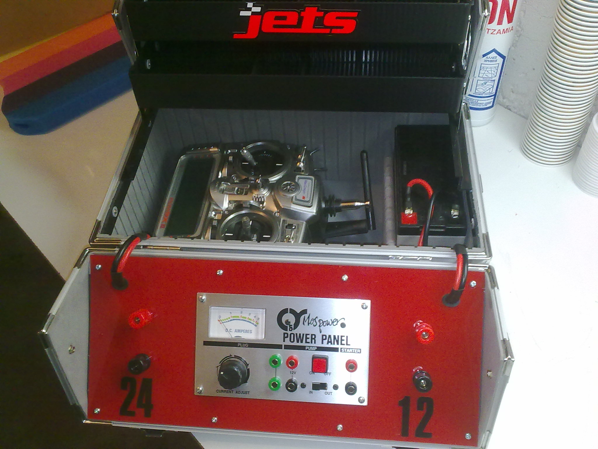

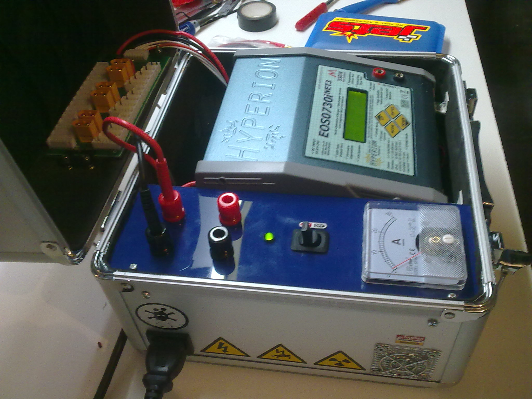

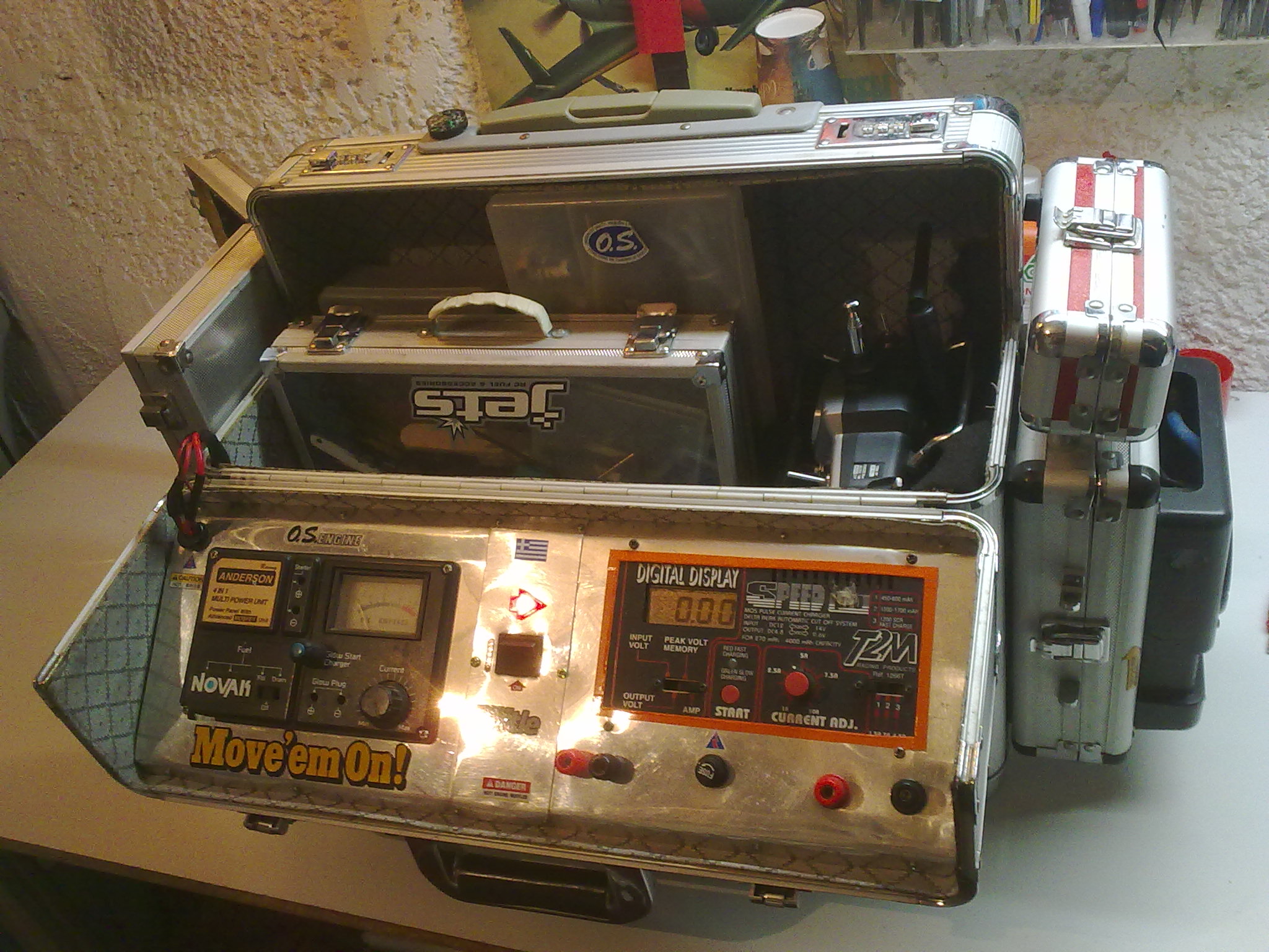

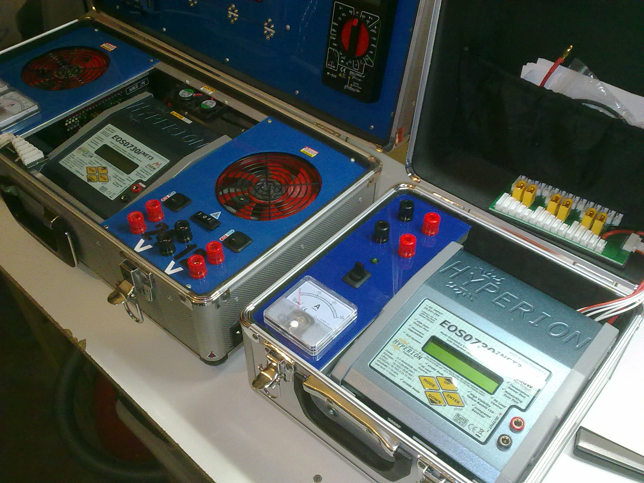

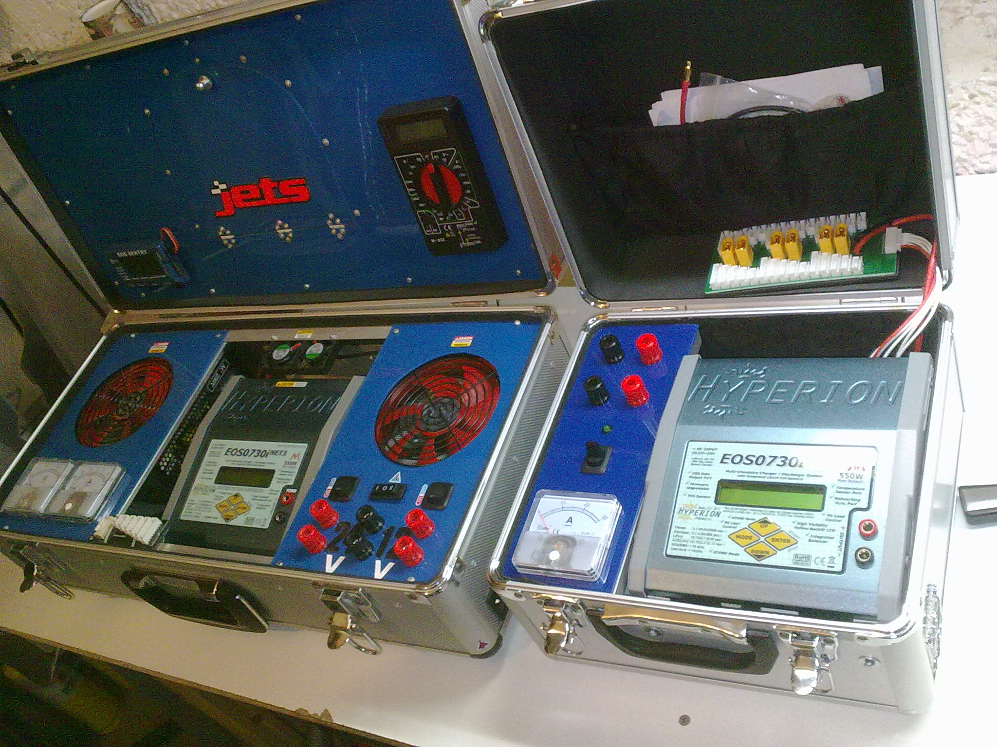

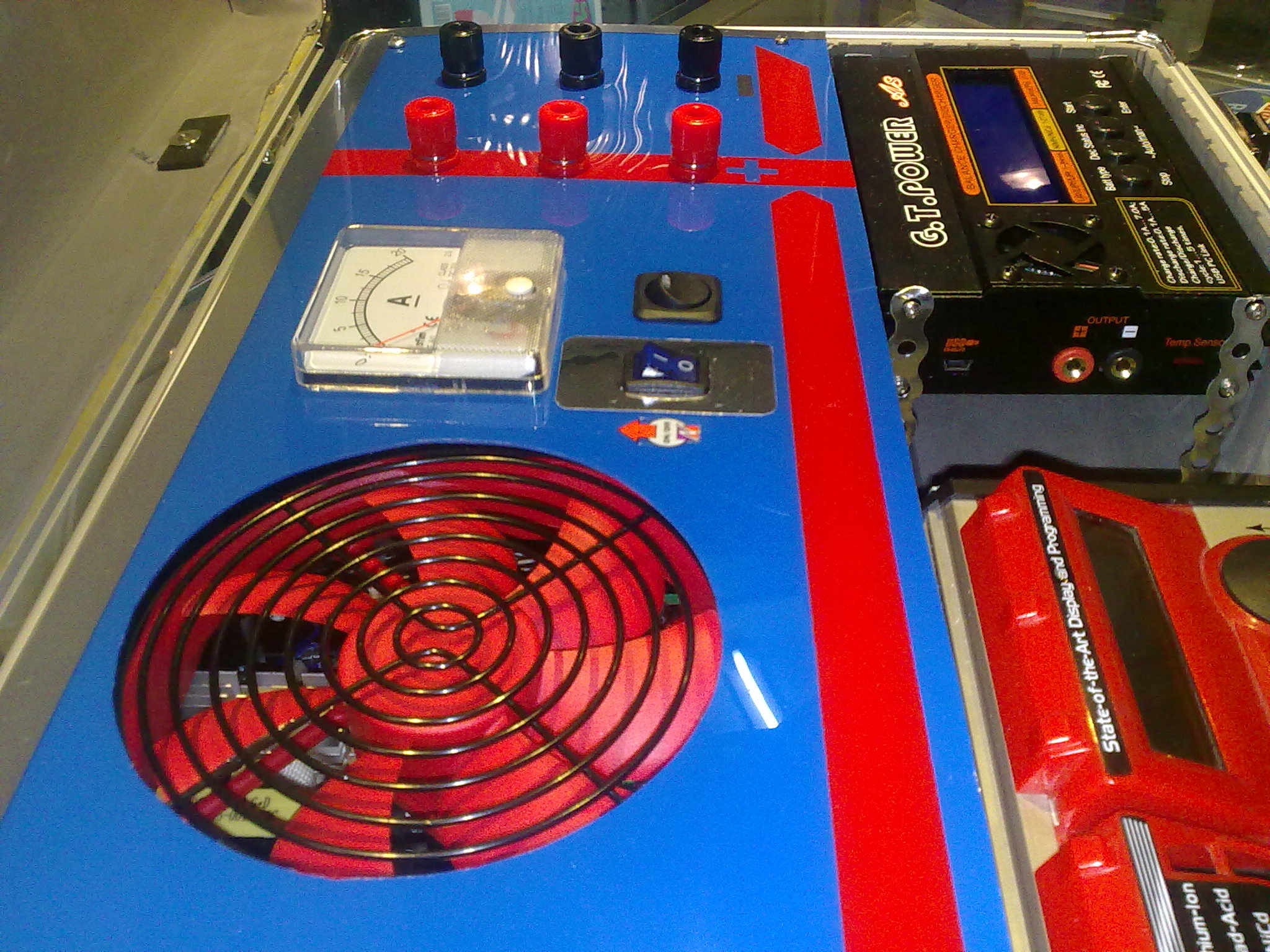

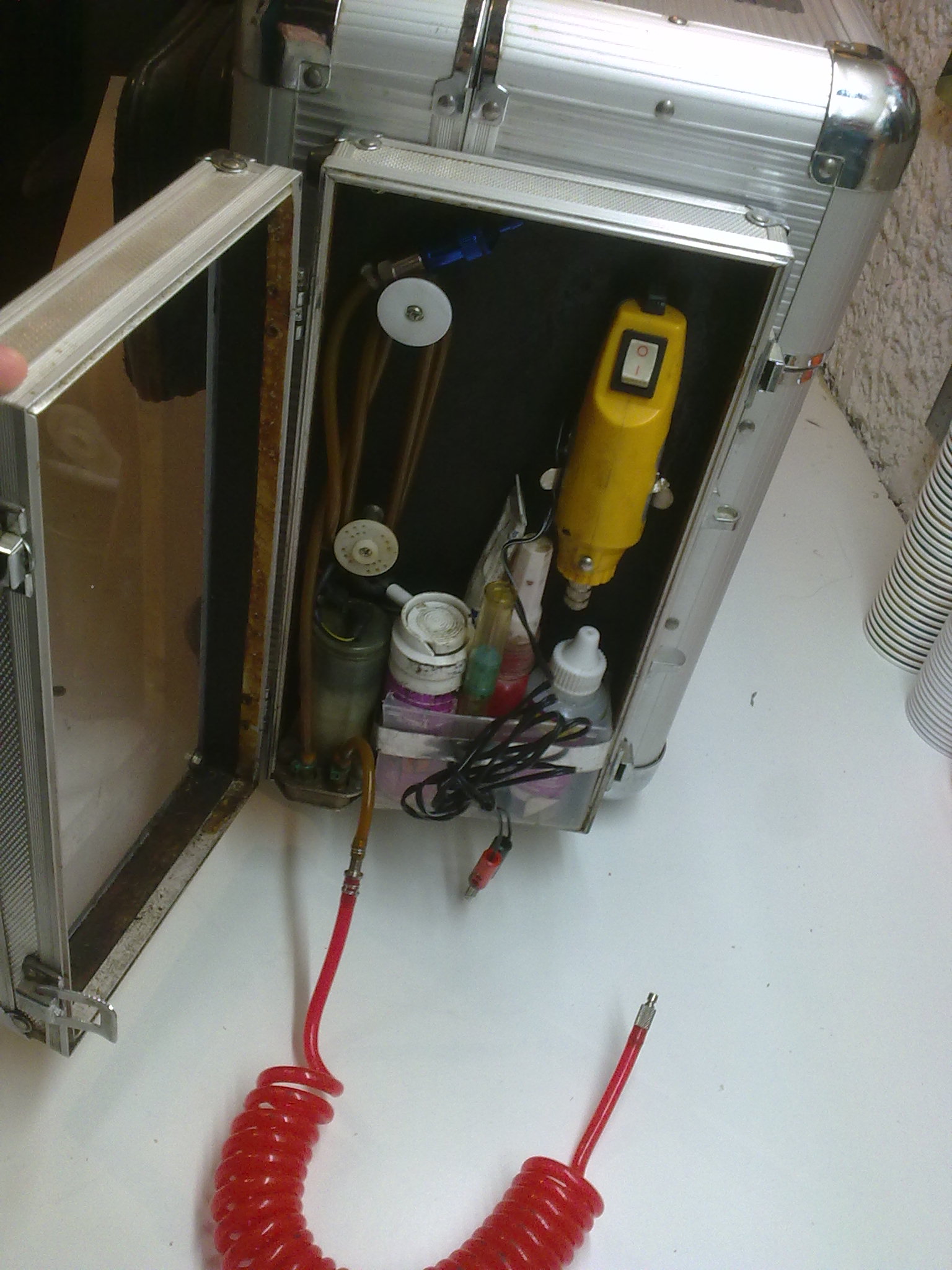

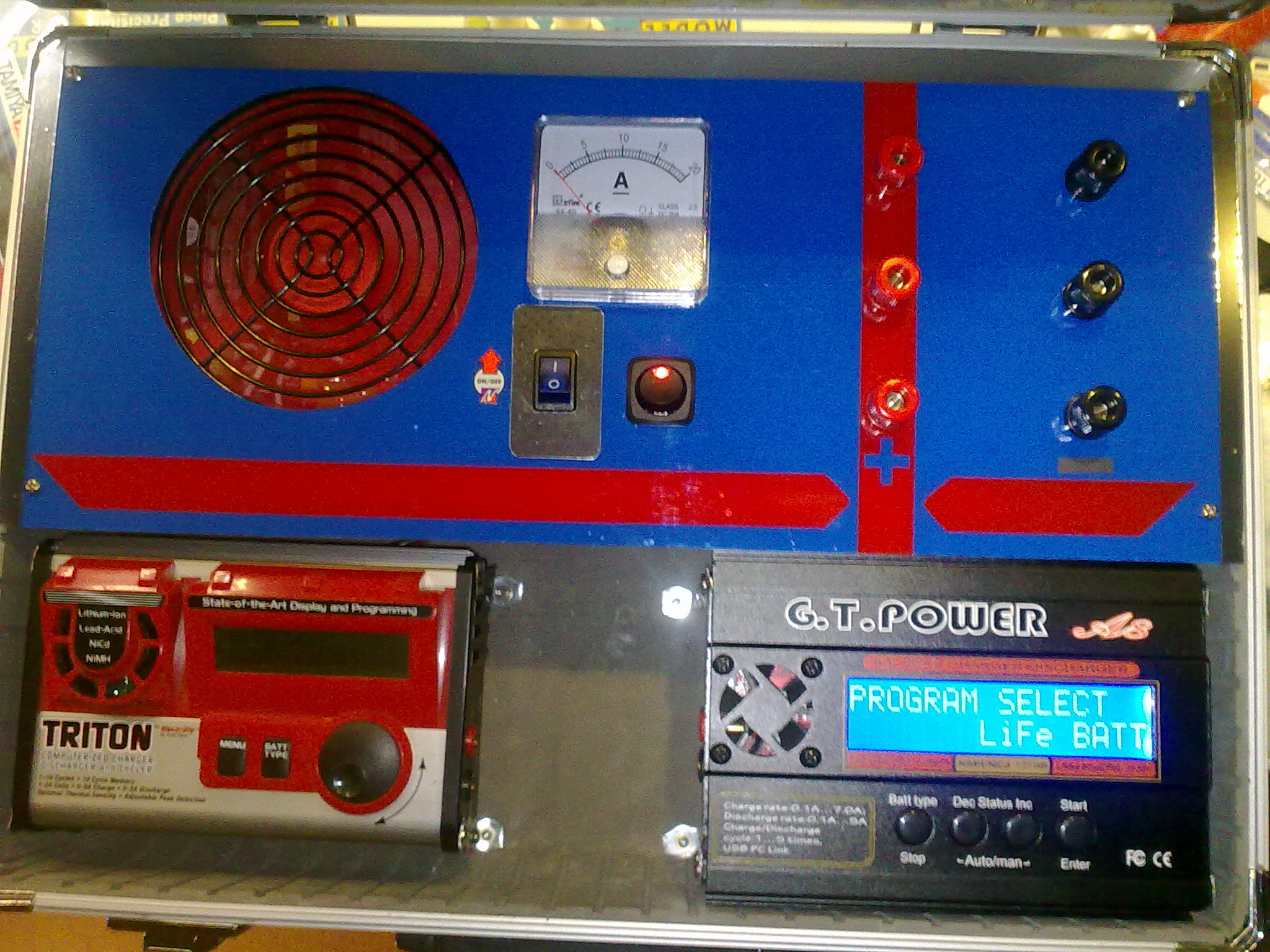

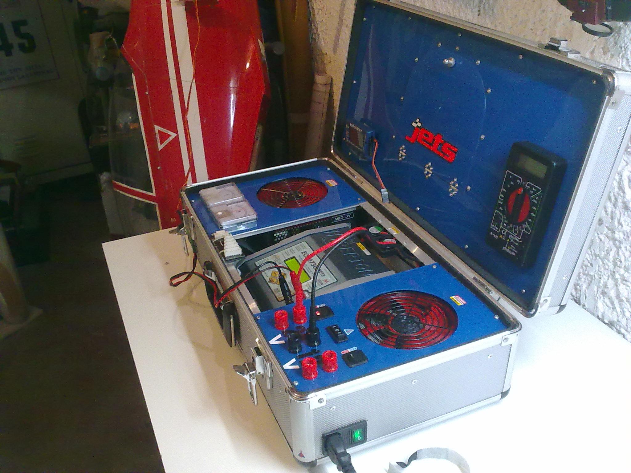

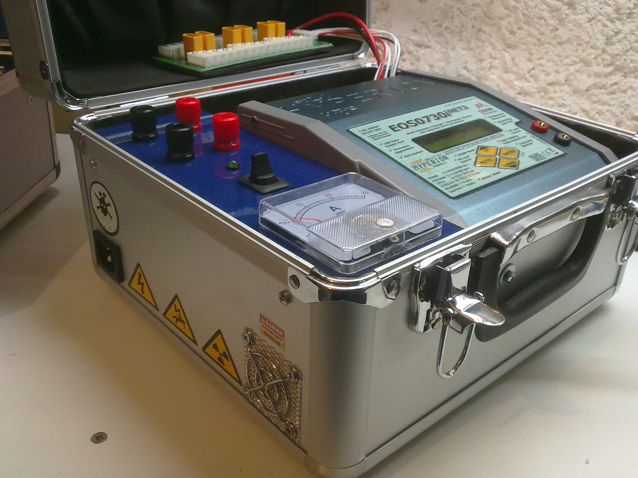

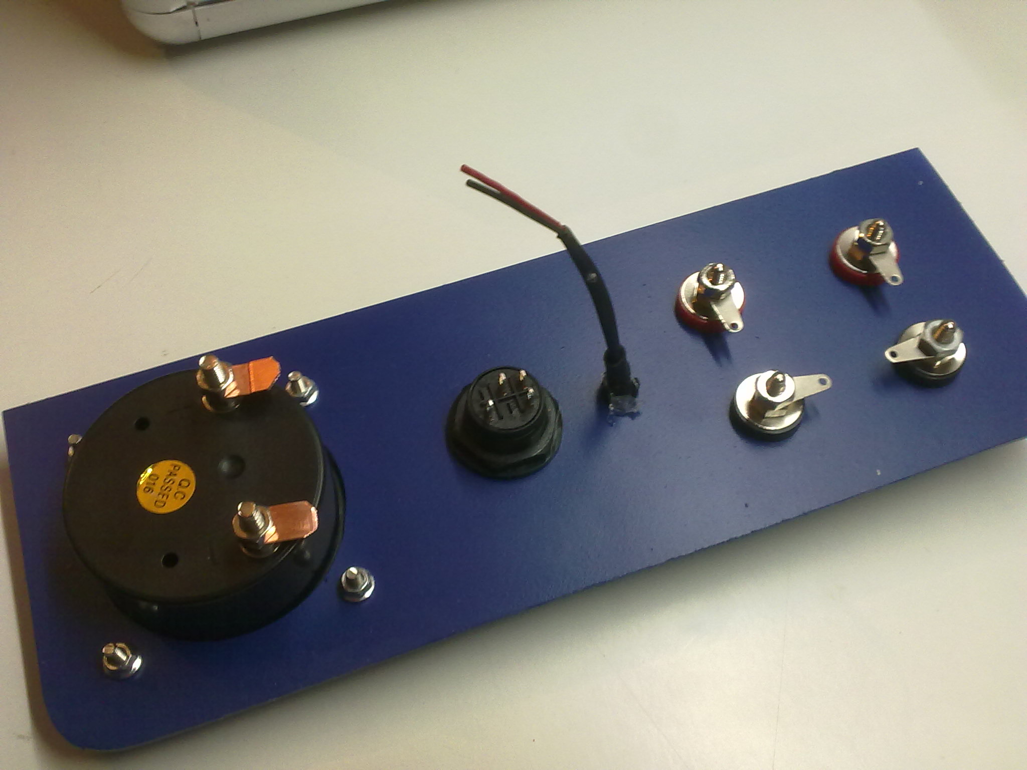

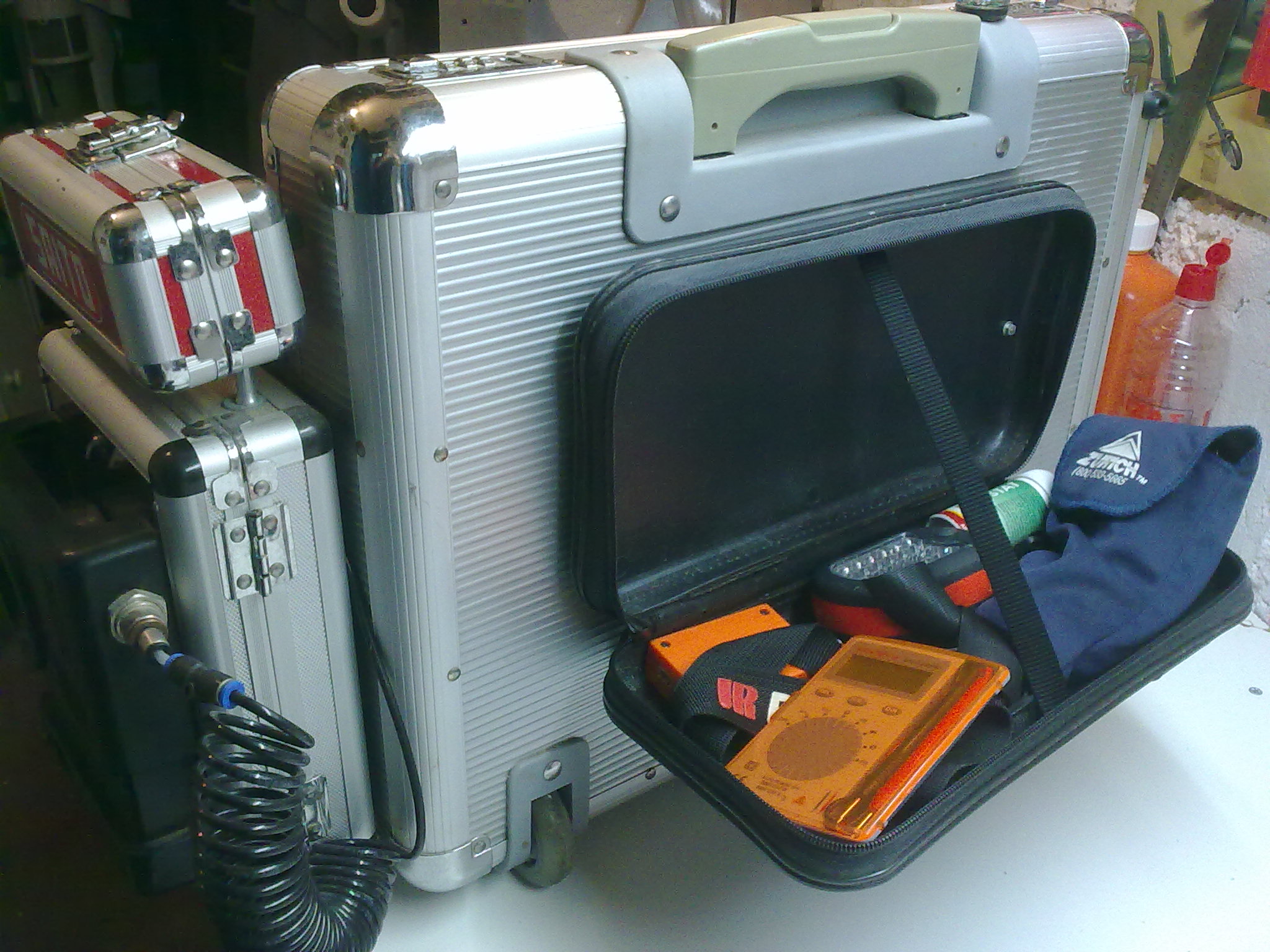

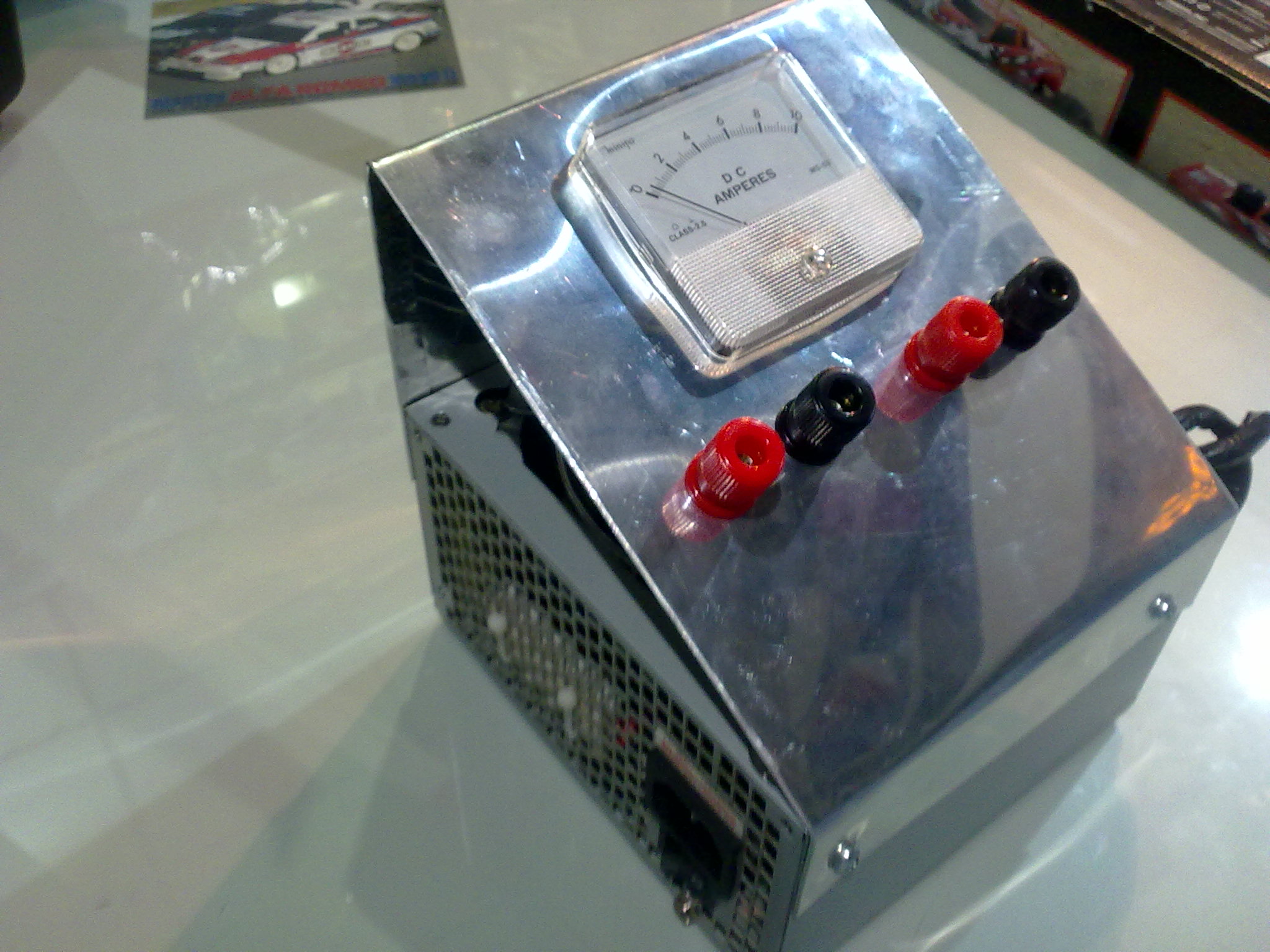

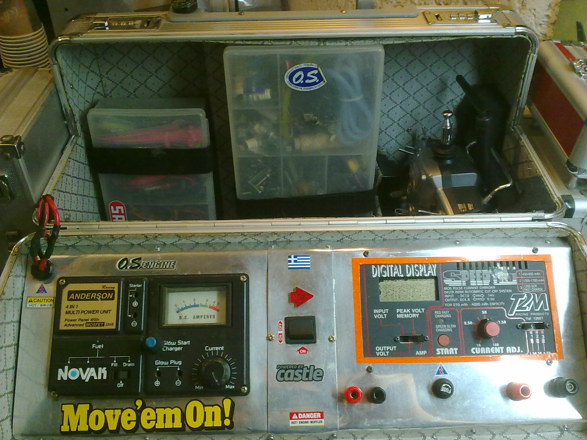

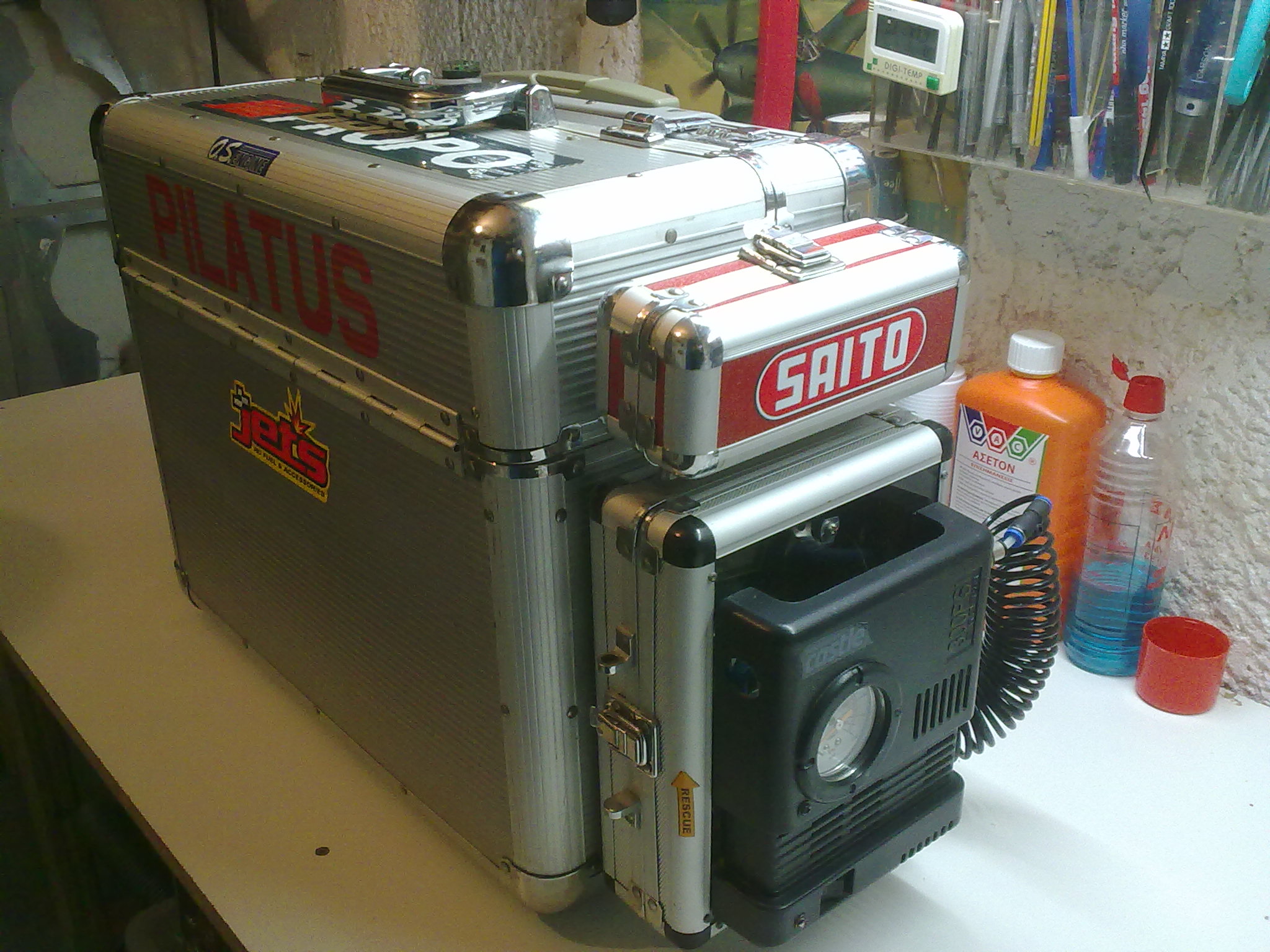

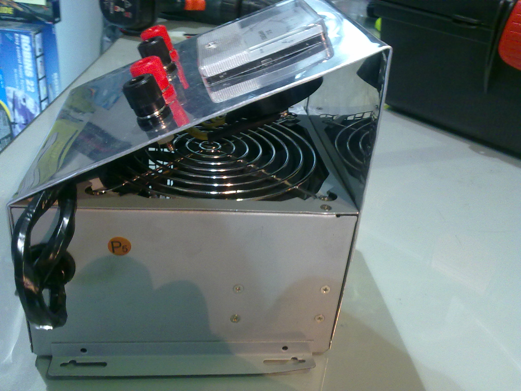

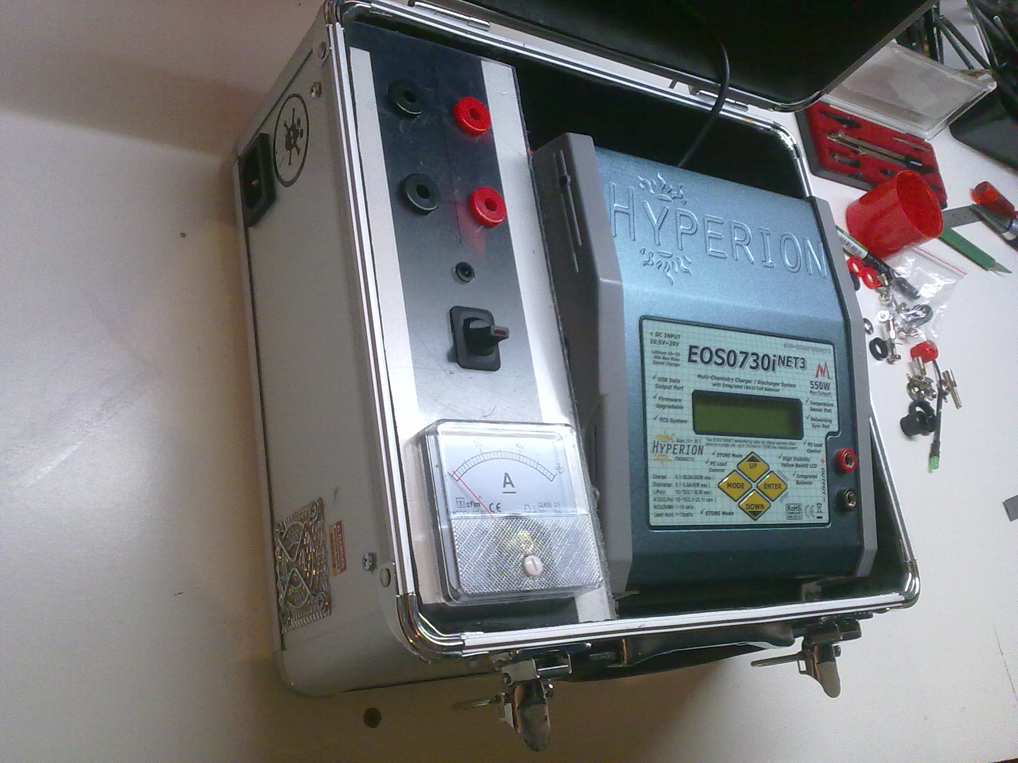

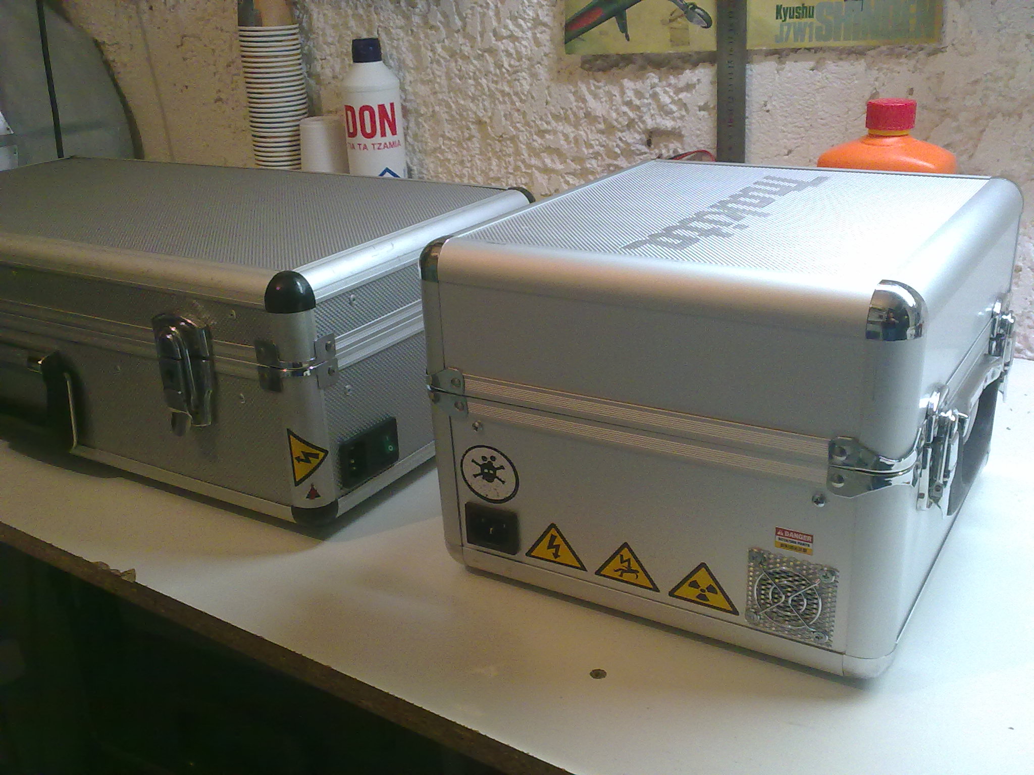

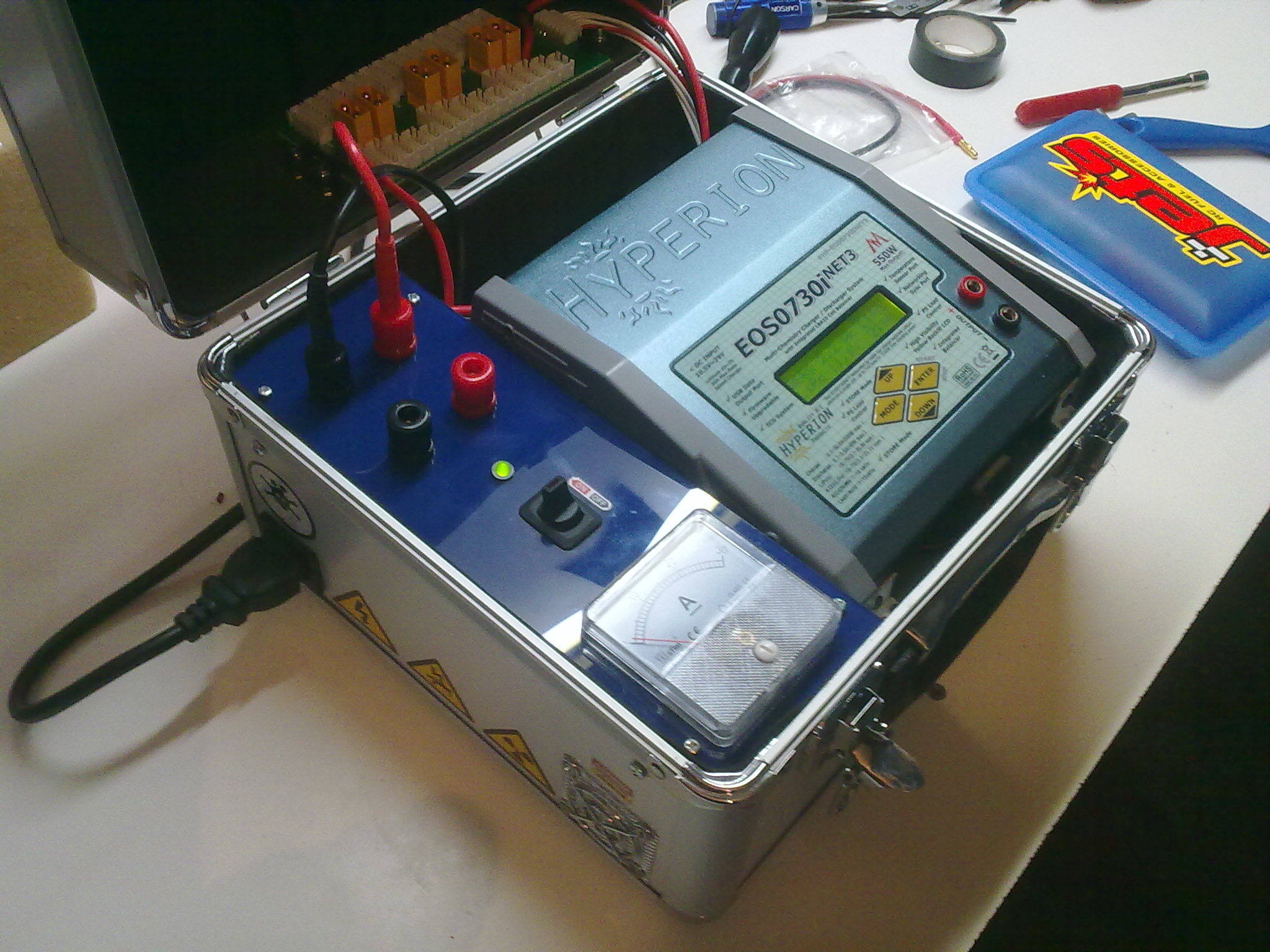

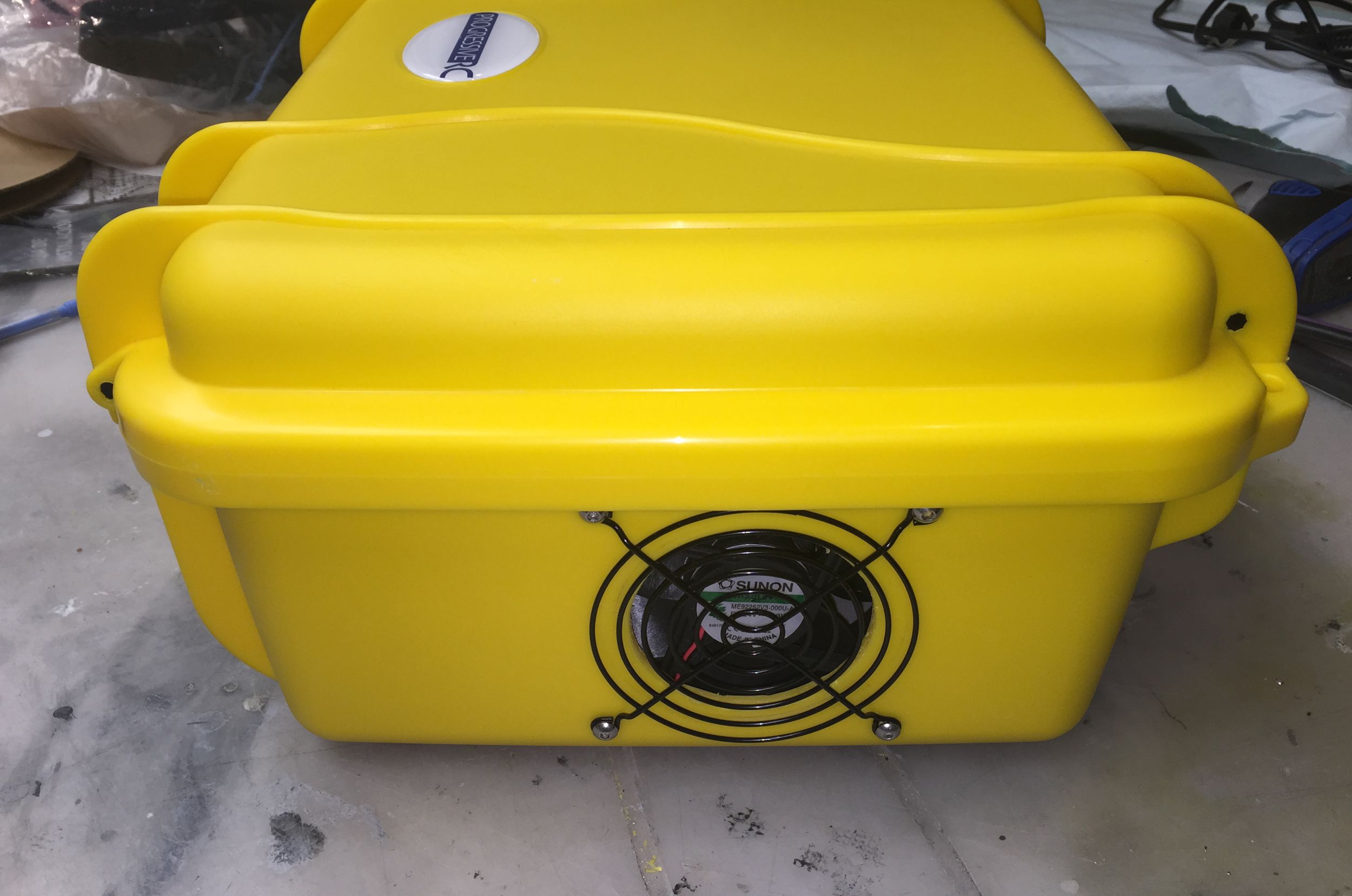

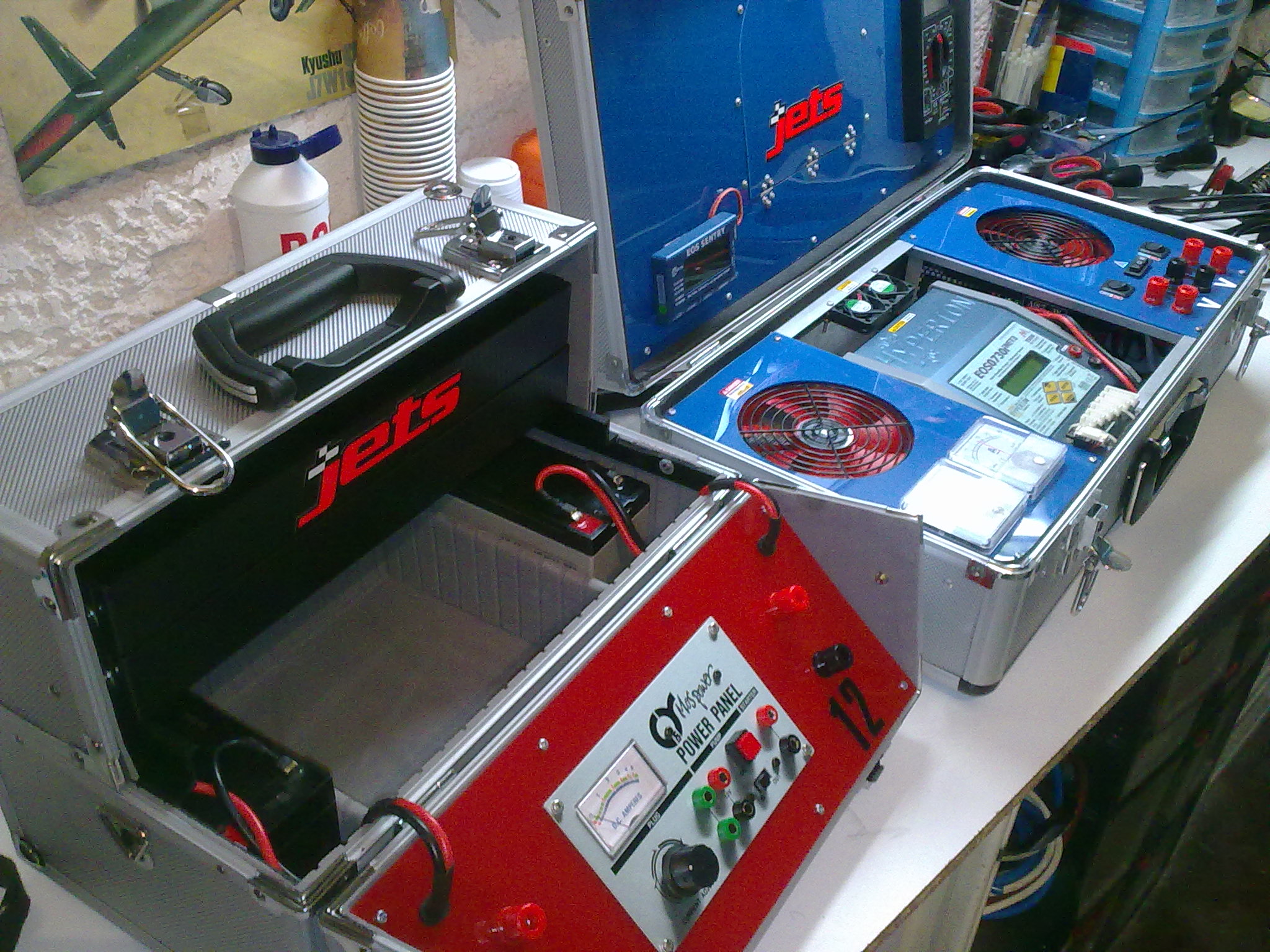

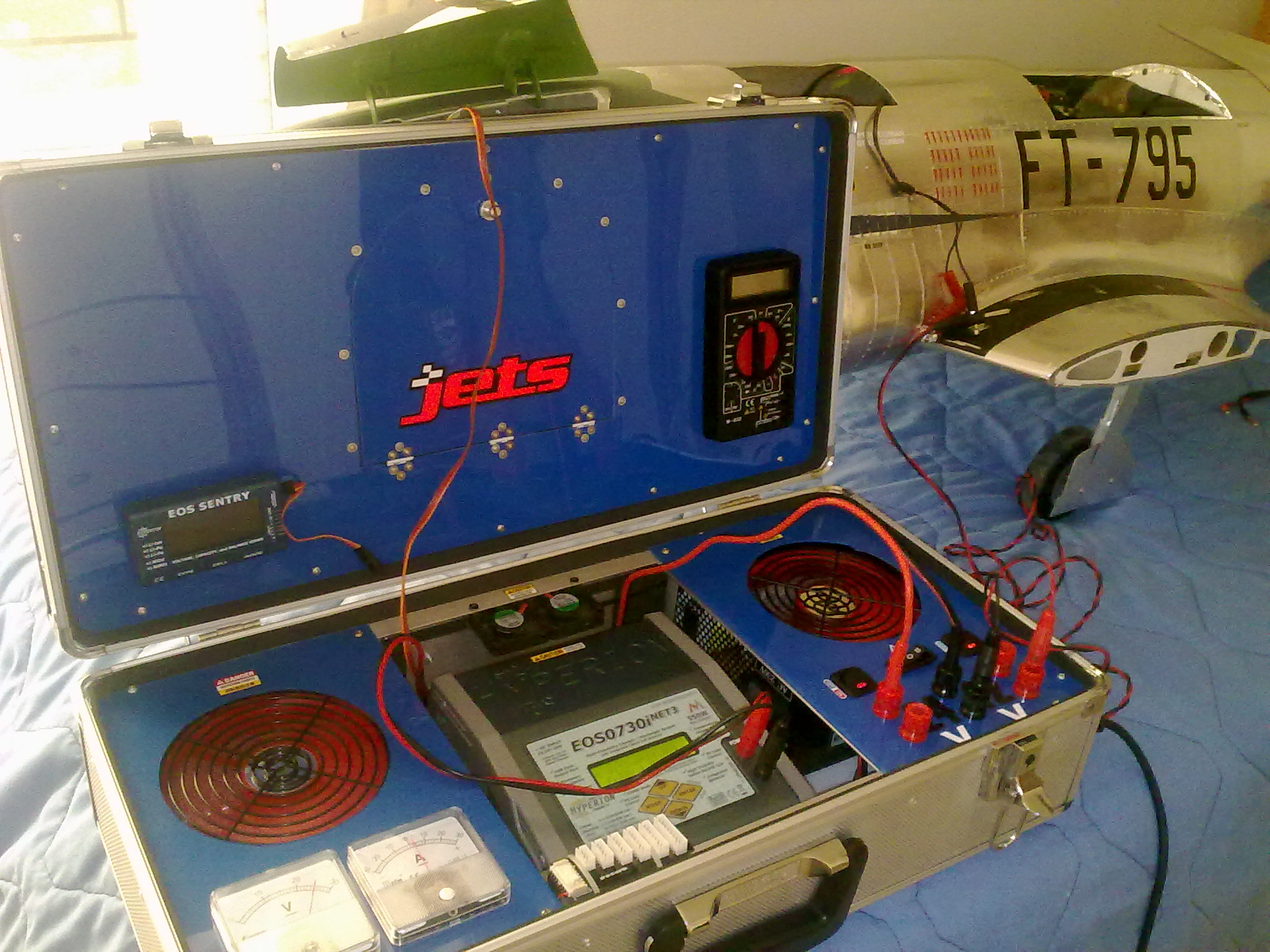

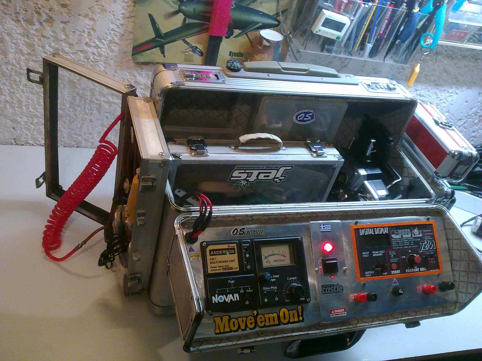

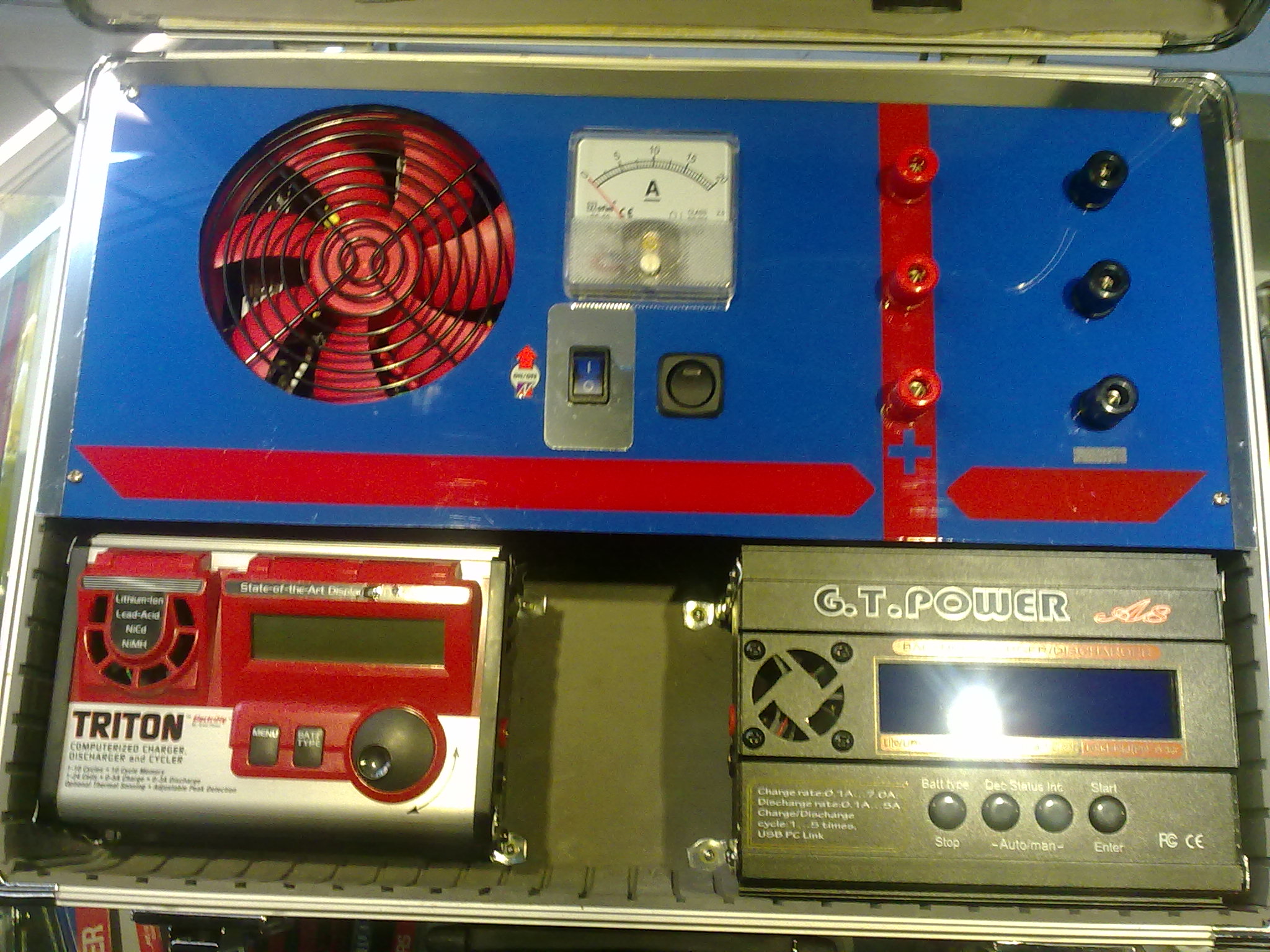

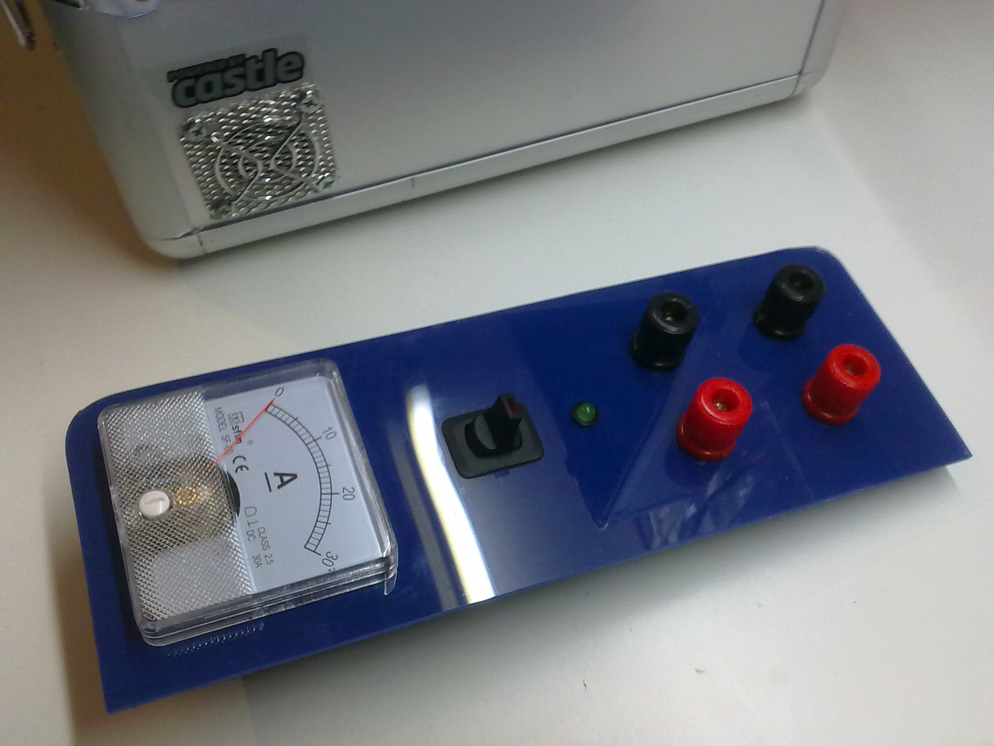

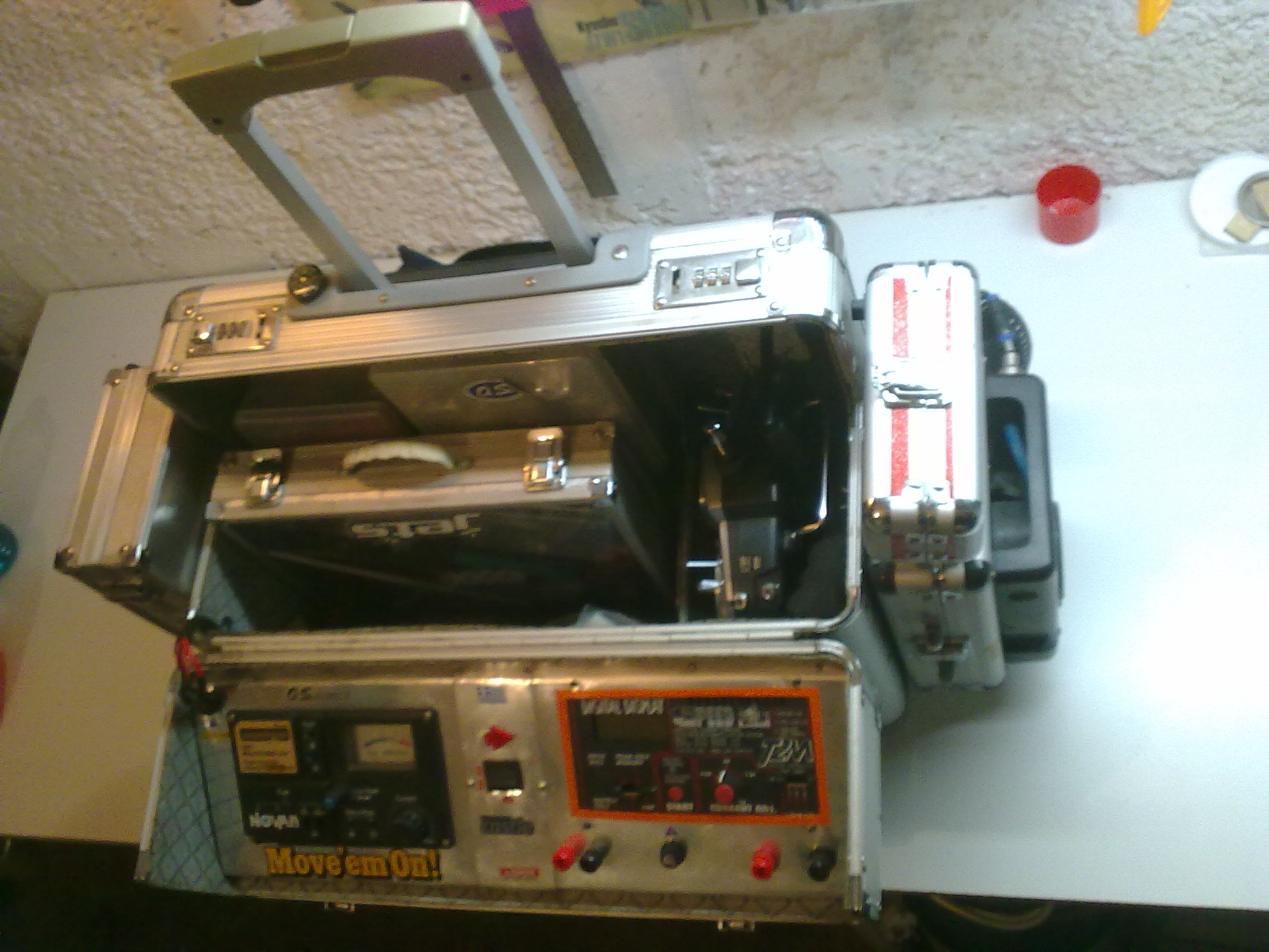

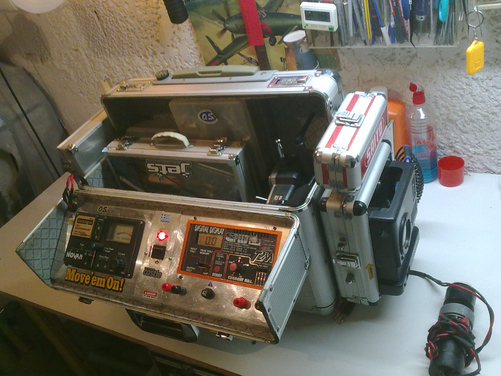

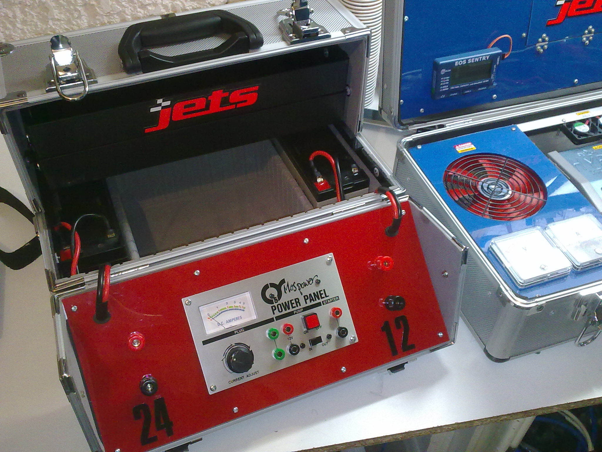

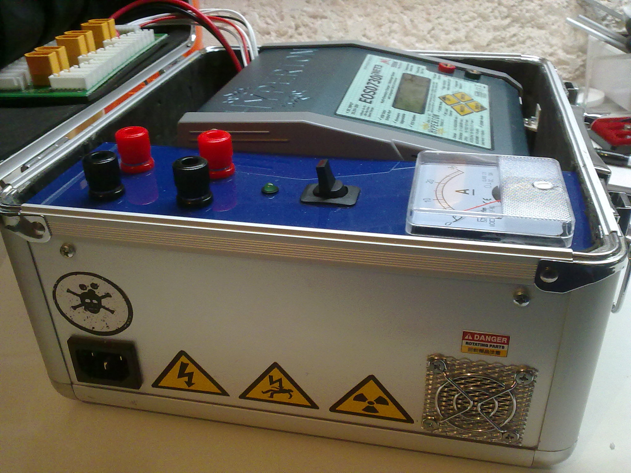

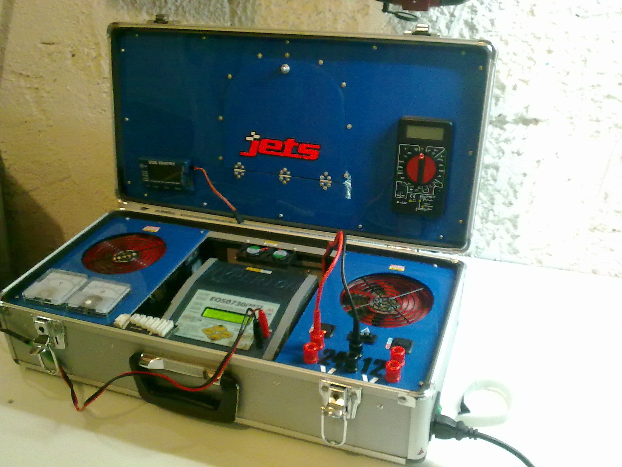

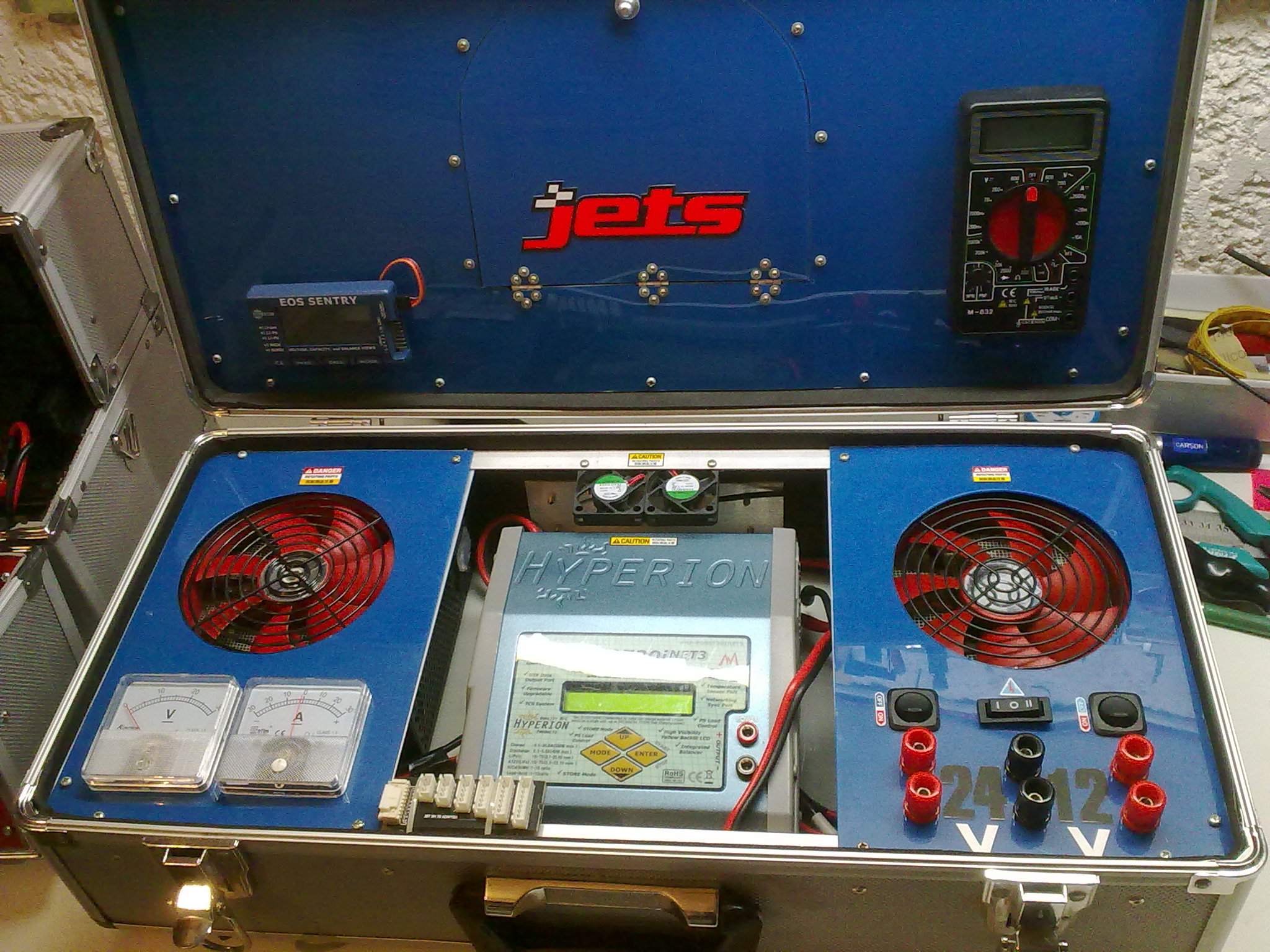

Some photos from pilot case tool box and charger station.

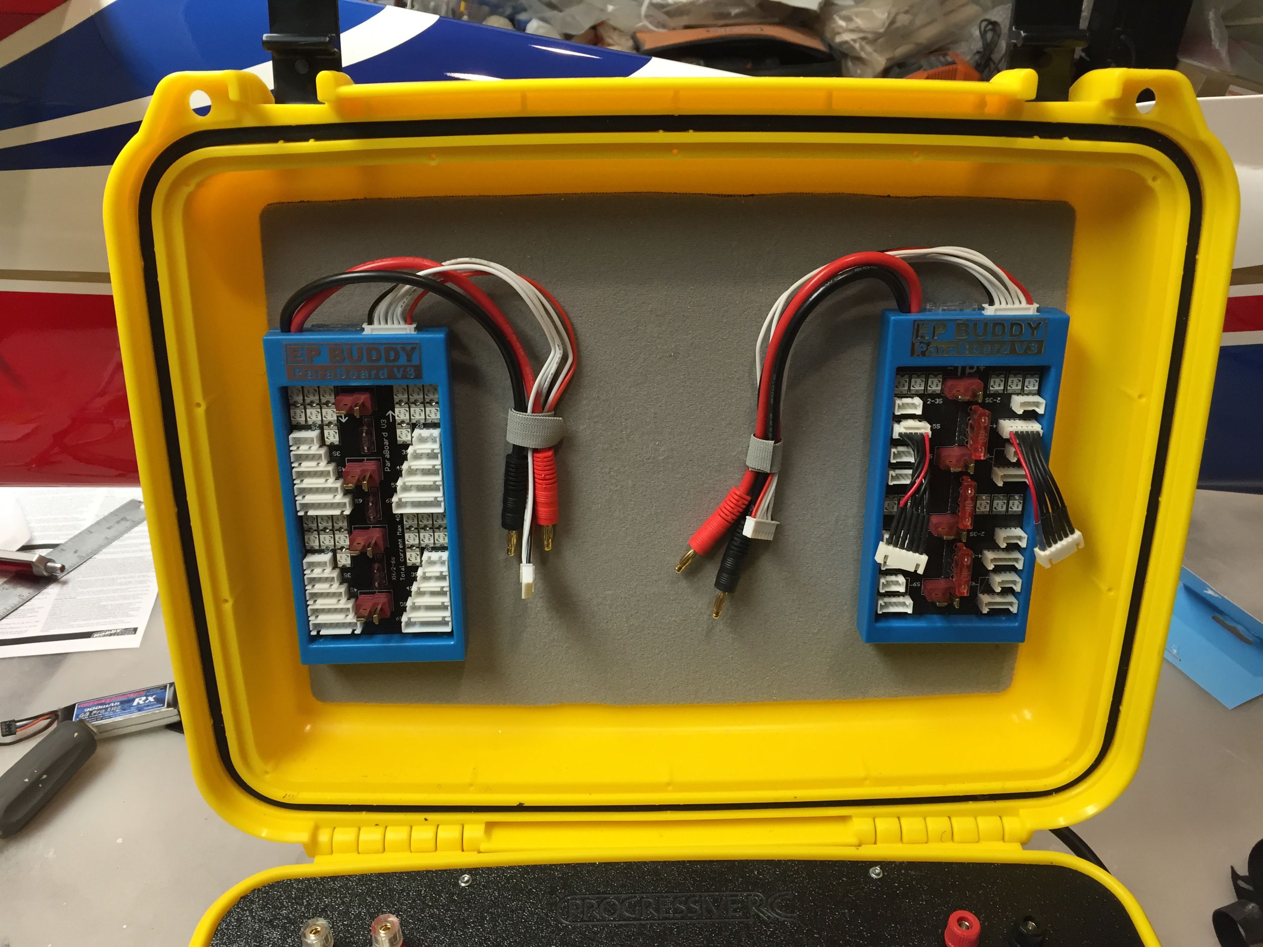

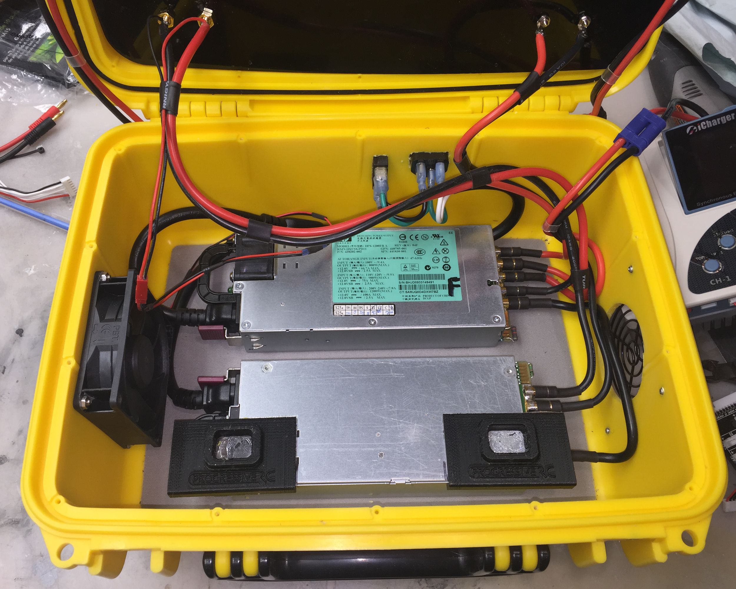

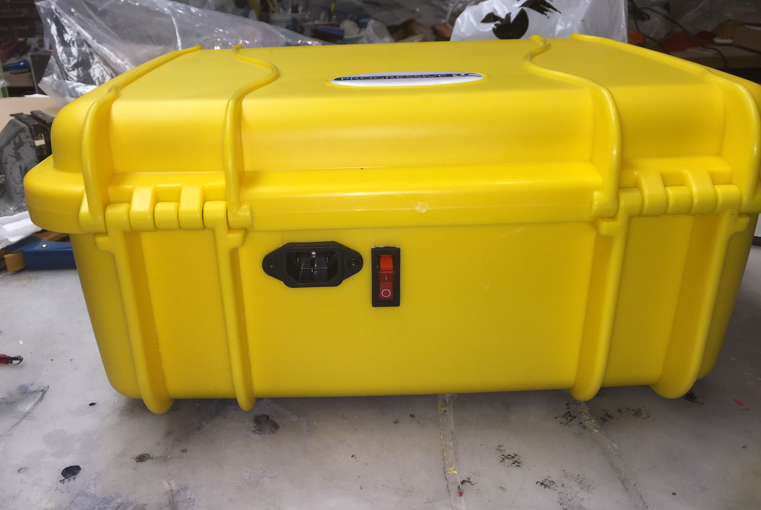

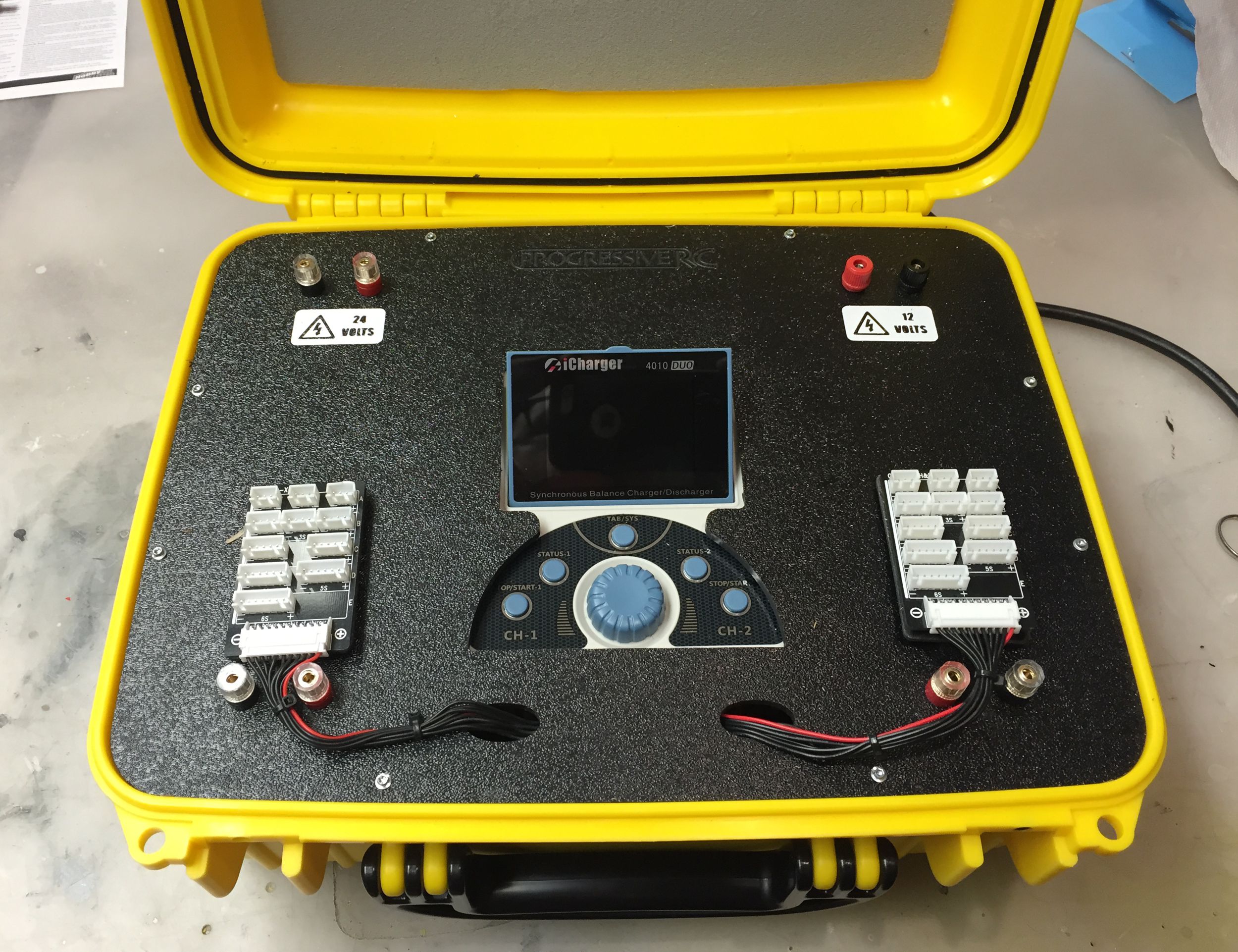

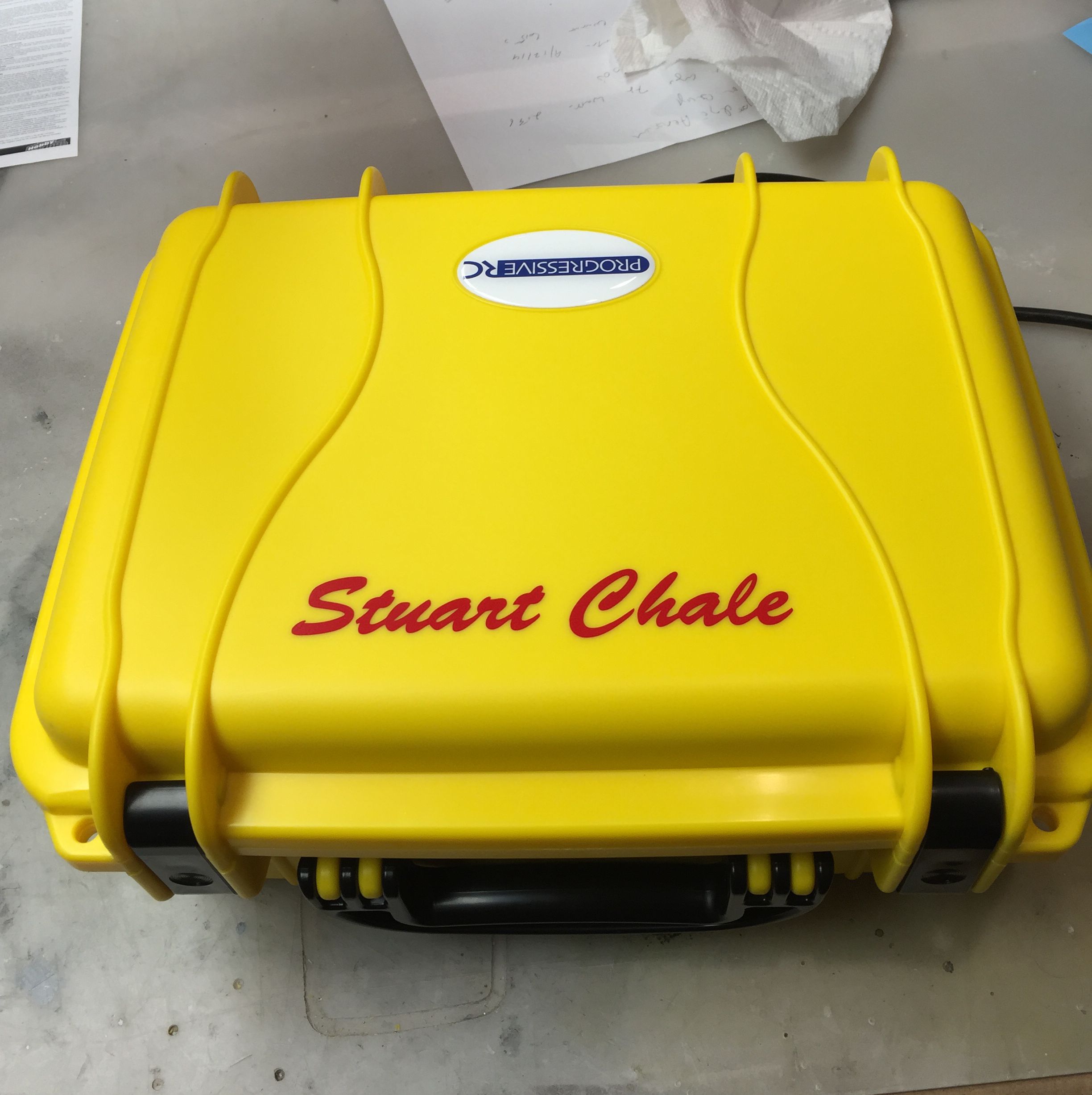

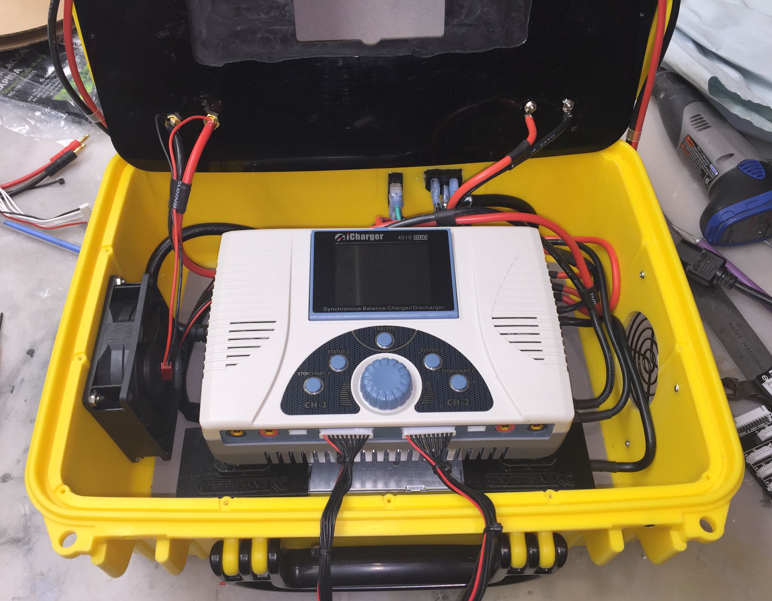

Just finished my new charging station as well. iCharger 4010 DUO powered by a pair of HP DPS-1200FB power supplies in series. 75 amps at 24 volts.
Extra 12 and 24 volt binding posts. Fan for cooling. With a couple of Paraboards and a good electric supply I can charge 8, 5 or 6 cell 5000mah packs at once.

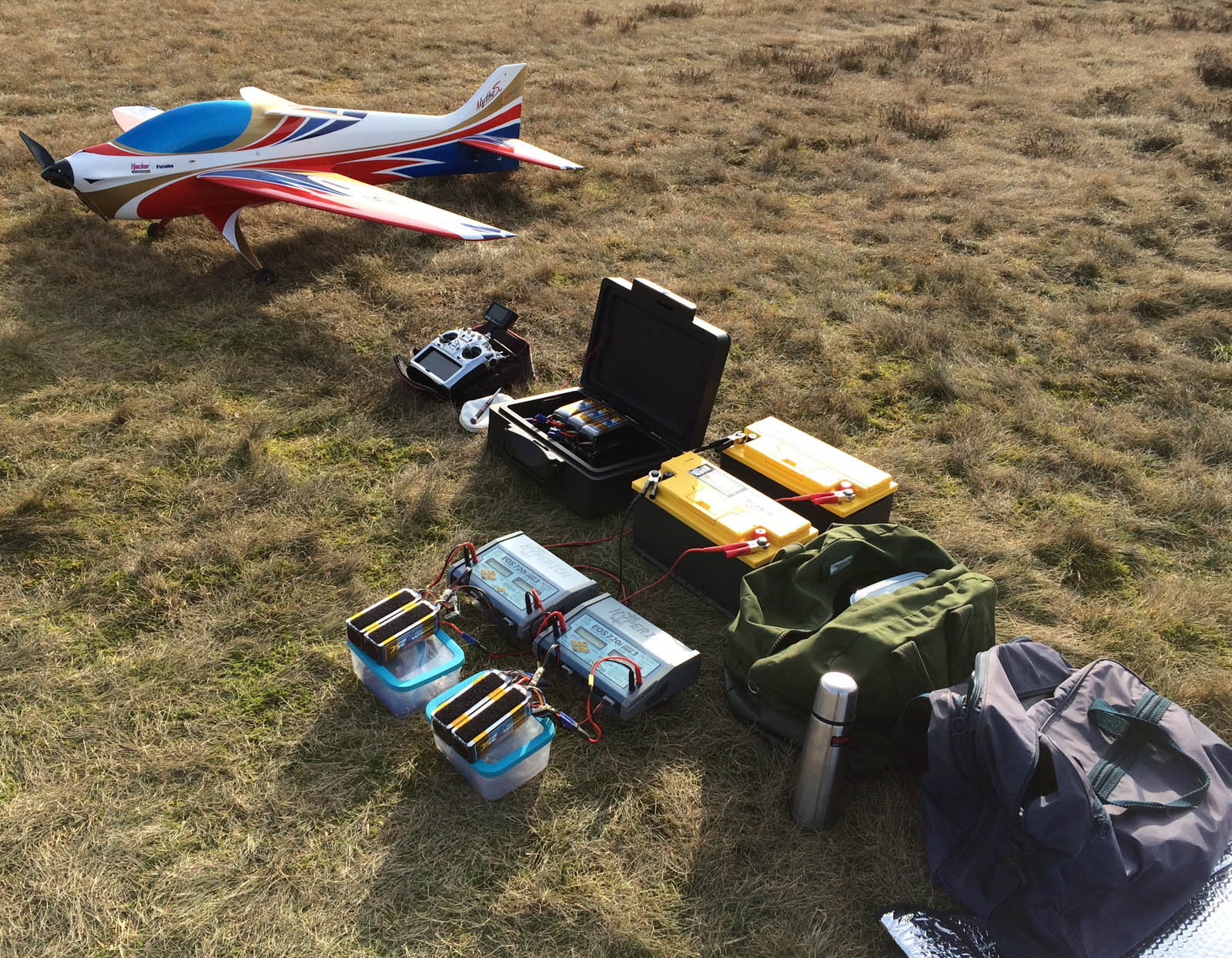

At the field: just two AGM (95Ah) batteries (sometime 3), two chargers (Hyperion EOS 0720 Super DUO3) and I can fly from morning to evening with my F3A plane. No field "charging station" (yet).
At home: same chargers as above and two Junsi S1200 (1200 watt) powersupply.
