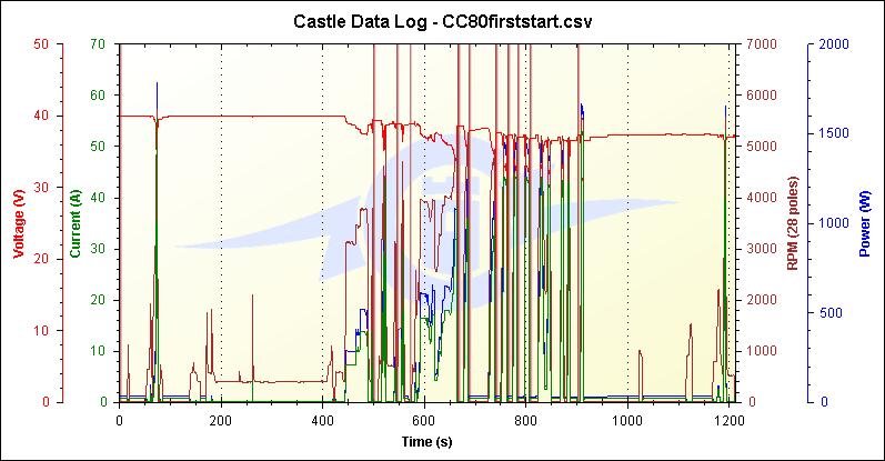

Ok you experts,
I am using a CC80HV, HACKER A-60-7S-V2 and started with a 20.5-14 APC PROP. I am waiting on my castle Link cable to arrive, so I can check the numbers.
This is what I experienced running the set up on 10S-5000 set up. When I go to full throttle the engine runs for about 10 seconds and shuts off, if I bring the stick on the TX back to the idle position and start to advance the throttle it's fine through out the throttle range once again. I ended up lowering the control point in the ATV's from 135% down to about 65% to eliminate the motor from kicking out (and thats' right on the thresh hold). Am I over AMPing the ESC? I didn't tach it yet either, but I know it's turning the crap out of the 20.5x14 (scary). I checked the trouble shooting guide and it really dosen't have an explaination for it.
I was wondering if anyone else has experienced this? I'll know more when the cable gets here tomorrow. In the mean time I figured I'd share this with everyone and get a head to a potential solution.

When the motor shuts off, is the ESC beeping? If so, I think 2 beeps means the ESC hit the limit for low voltage and shut down. Your cable will allow you to see the results of your last run so that may tell you more. A friend had the same issue at the field this last week and it was a combination of 2 things. First he was hitting LVC (low voltage cutoff) and it was set for hard shutdown instead of 'slow down'. Lowered his LVC setting and changed to 'slow down' and his problems went away. He hadn't programmed his ESC having been told it would be fine with the factory defaults. Might be ok with new batteries, but his older/weaker batteries dropped below the voltage thresh hold.
Let us know what you find. Good luck.

Set up the controller with the Castle Link so you can be sure of the setting you are working with. The factory defaults are not optimum for our use and as Woodie said you are hitting low voltage cutoff and bringing the throttle stick down resets the controller. When you get the Castle Link, use these settings and you will have success. Not to say there are no possible tweaks you can make from here, just start here with a stable operating setup and tweak from there if desired.

I have been running your exact setup for over a month now and have had to drop back to a 20x13 prop. I found the very high pitch prop was drawing too much out of my bats for a 7.5min Advanced sequence flght + a few extra. Still plenty of power and motor does not get too hot. A friend I fly with has this setup too and has 3 throttle curves setup, 100% - 95% & 85%. He rarely flys 100%.

Thats' what I did, ran it on older batteries about 3 years old and have not programmed the ESC. I did receive my cable yesterday afternoon. I will post the results later today. Sounds like you may be correct.

Yeah I understand that from owning and operating an electronics based security company. Usually the vendor on the other end will not take the time to verify the date stamp. You get what you get. I use to visit batteries plus and build my own packs and purchase batteries , because I could check the dates, etc. I will order my batteries from you. I will need to run the lighest packs I can and still get throught the programs without hurting the batteries. Right now I am at 10.75 lbs with my True RC 5000/25C packs on both planes. The Rhino's I don't like, never seemed to have the same power as my True RC's did.
I have loaded the graph data. (Low Voltage cut of was the problem). I used your link to re-program the device. I will try it again with the throttle restrictions removed.
