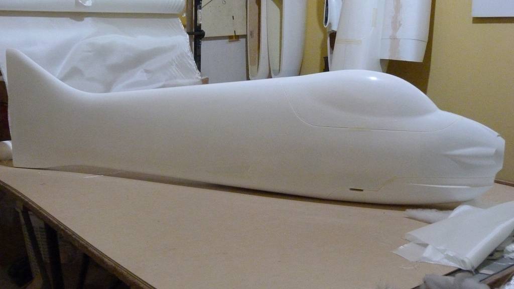

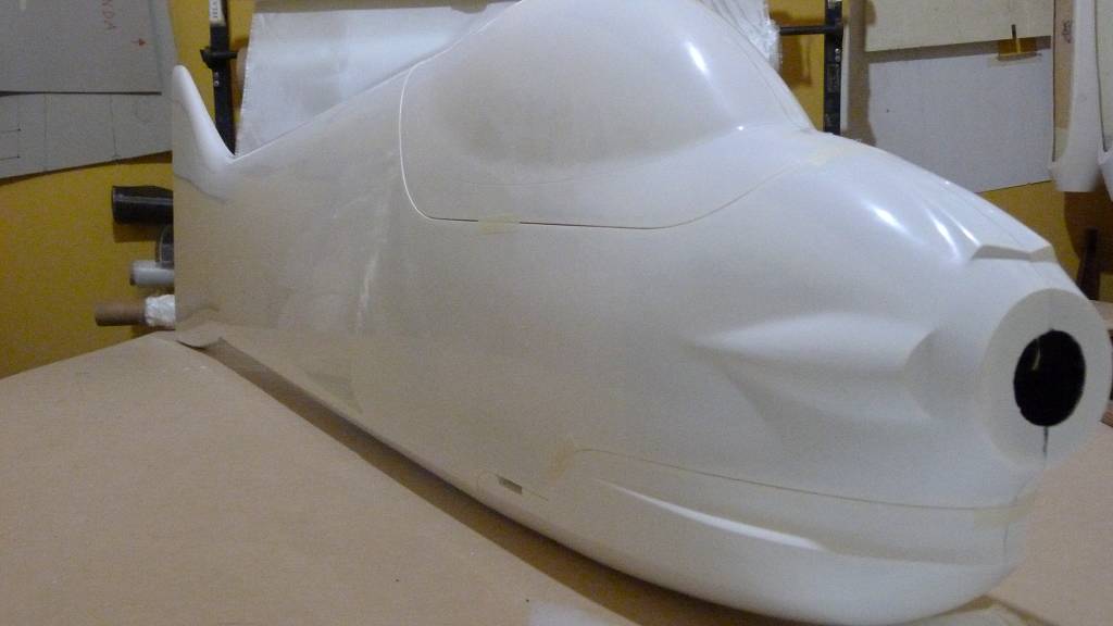

FedEx dropped off the box and everything was fine. A few foot prints on the crate but no real damage to the plane.
Since the [link=http://www.rcuniverse.com/forum/m_11335289/tm.htm]Ribs[/link] contest is this weekend, it's a mad dash to build.

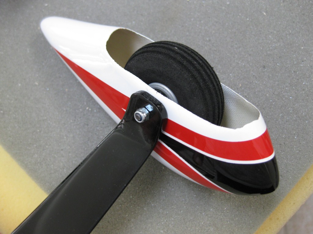

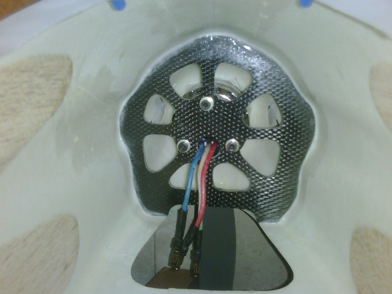

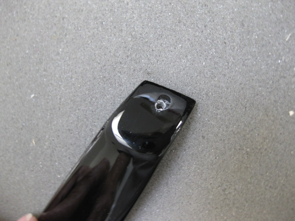

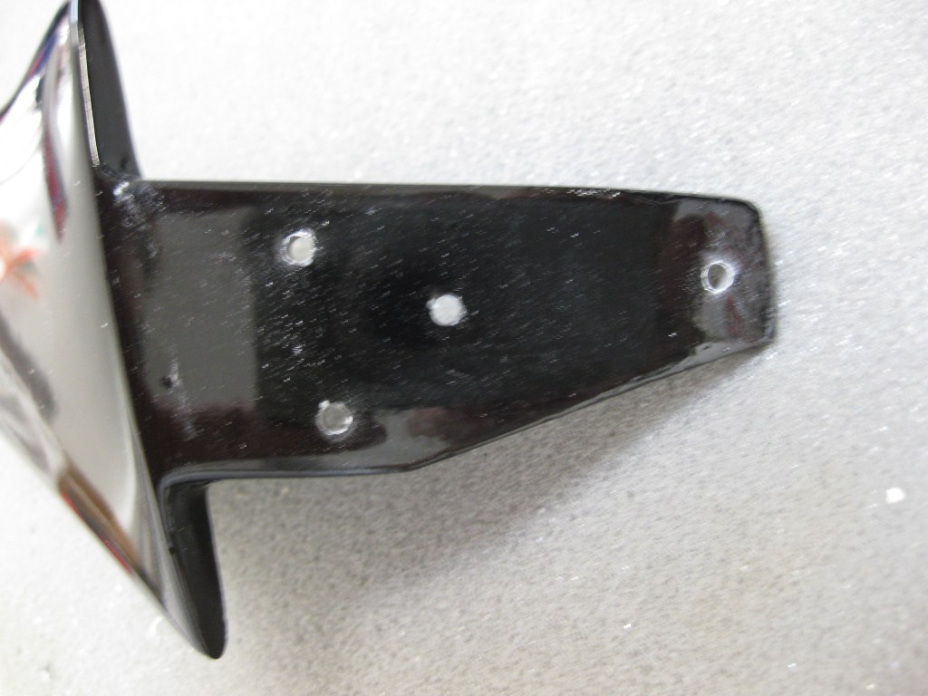

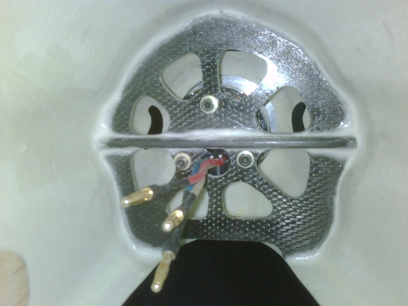

Any Carbon guru's out there that can help me out please? I cut my firewall out of some CST carbon plate, .060, but it's not strong enough and am pretty sure it's flexing. Is there anything that doesn't weigh a ton, that can be used once cut like this, that won't flex much?

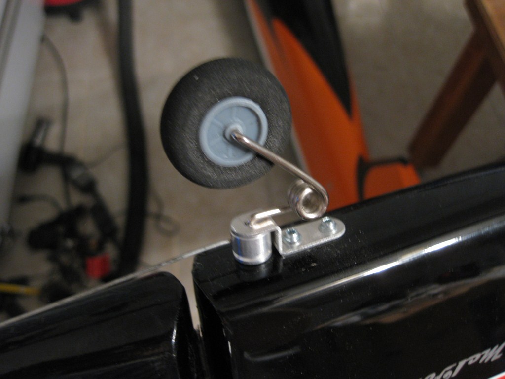

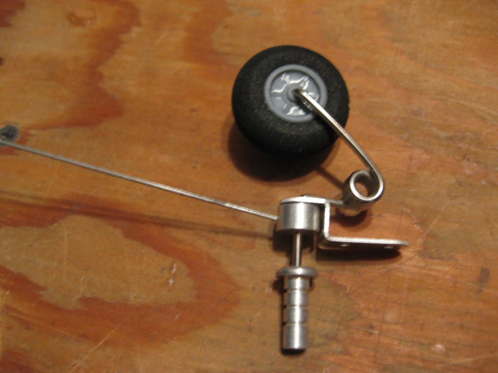

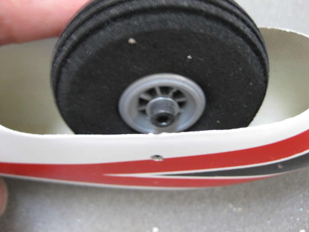

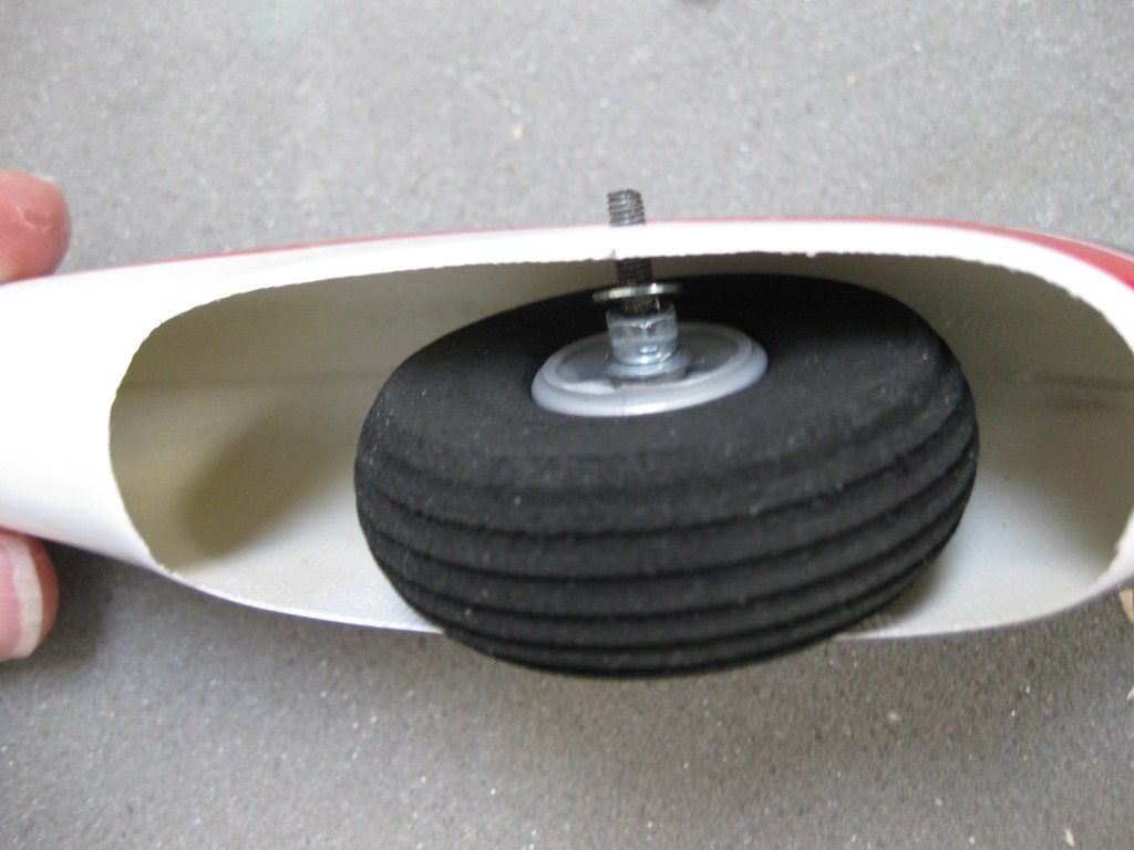

Some gear stuff

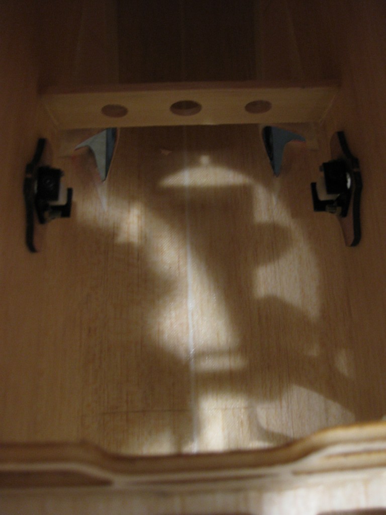

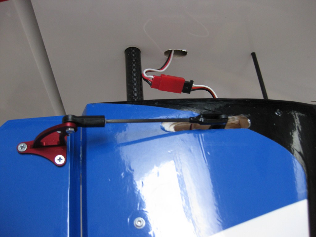

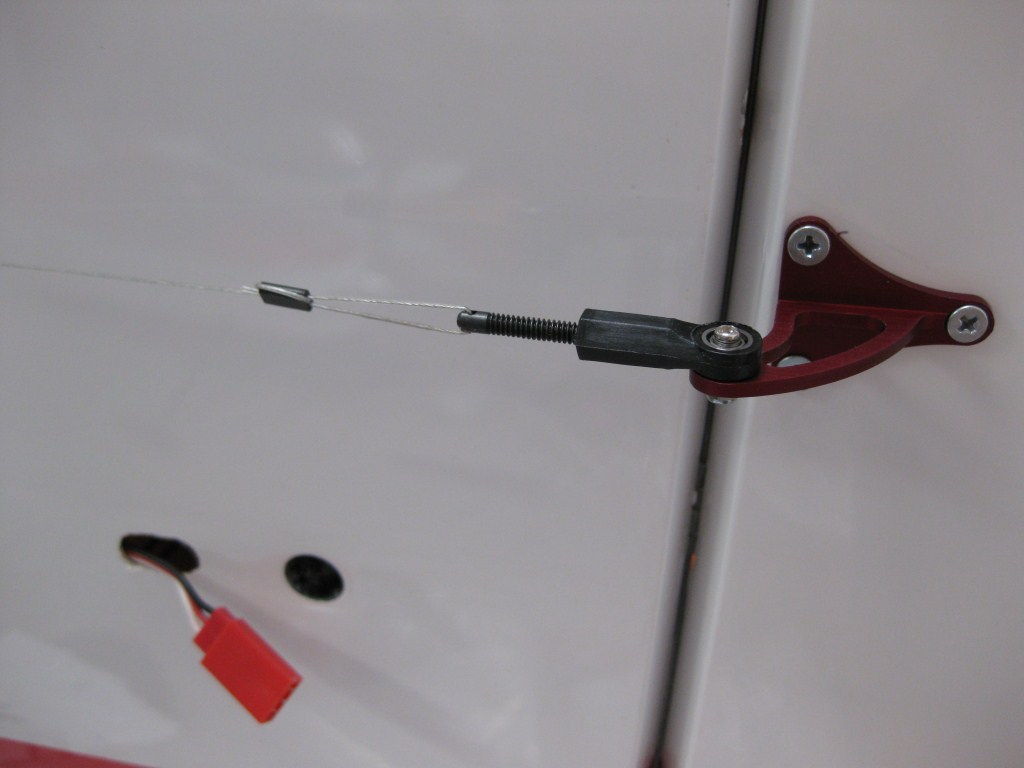

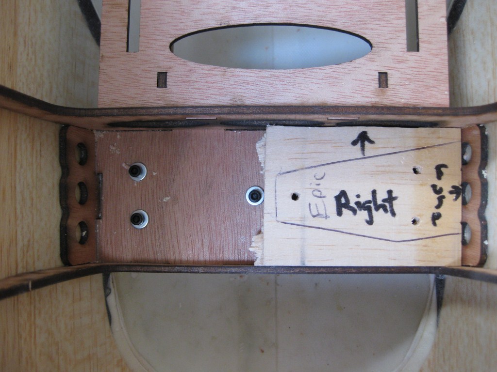

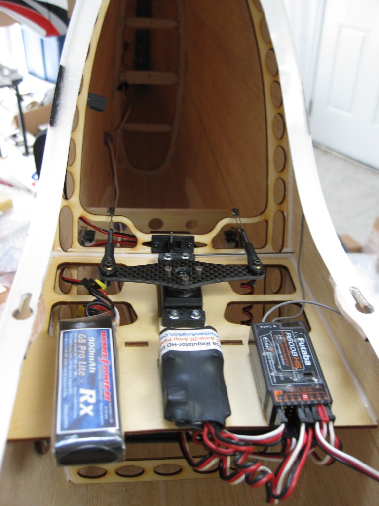

Rudder pull-pull and elevator set-up and layout in the fuse.

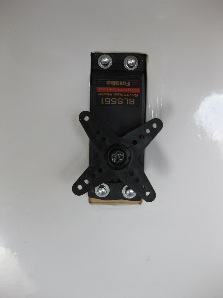

The guts are...
Futaba 6008HS Rx
Thunder Power 900 2-cell rx batt
Futaba small switch
Shulman Aviation 6v Reg
Futaba 153BLS on elevators, 352BLS on rudder and 551BLS on ailerons
Carbon .080 rod for pushrods CA'd into the clevis'
Futaba 9100 ESC
Fury F3A 60/67-230 motor
Thunder Power 5400 motor batts
2- 200mm ext's for ailerons and 1- 1.4m SA quad ext to the tail
still deciding which prop/spinner combo I'm going with (21x14, 21.5x13, 22x11 or 22x12)
Haven't weighed it complete, but it's around 10.5 RTF

I think .060 is just too thin. I'd bump it up to .084 carbon (some places call it .090). With as much as you're hogging out, the weight gain should be minimal. I'm not aware of anything lighter than carbon plate for what you're making. G-10 would be significantly heavier and not as strong.
Verne

JAS, an idea is reinforce the firewall with carbon fiber rods, minimum weight and reduce the flection a lot.

I won't use anything other than birch core Dragon Plate. The stuff is ridiculously stiff. I just used it in a build for a Q80 and I have more cutouts than carbon. I used 1/8 inch, but for a firewall as big as yours I might go with 5/32 or 3/16. The ¼ inch stuff works great in reinforcing your house foundation!

In the interest of time, or lack there of, I went ahead and cut a second firewall out of 1/4 AC Ply and just bolted it up with the .060 carbon. I'll be looking into the dragon plate site some more. It's like carbon heaven. This is working for now though. Next on the list is mounting the T on it and seeing how it does with that. Without it and with the cg now back where it should be, going through P and F are easy.
