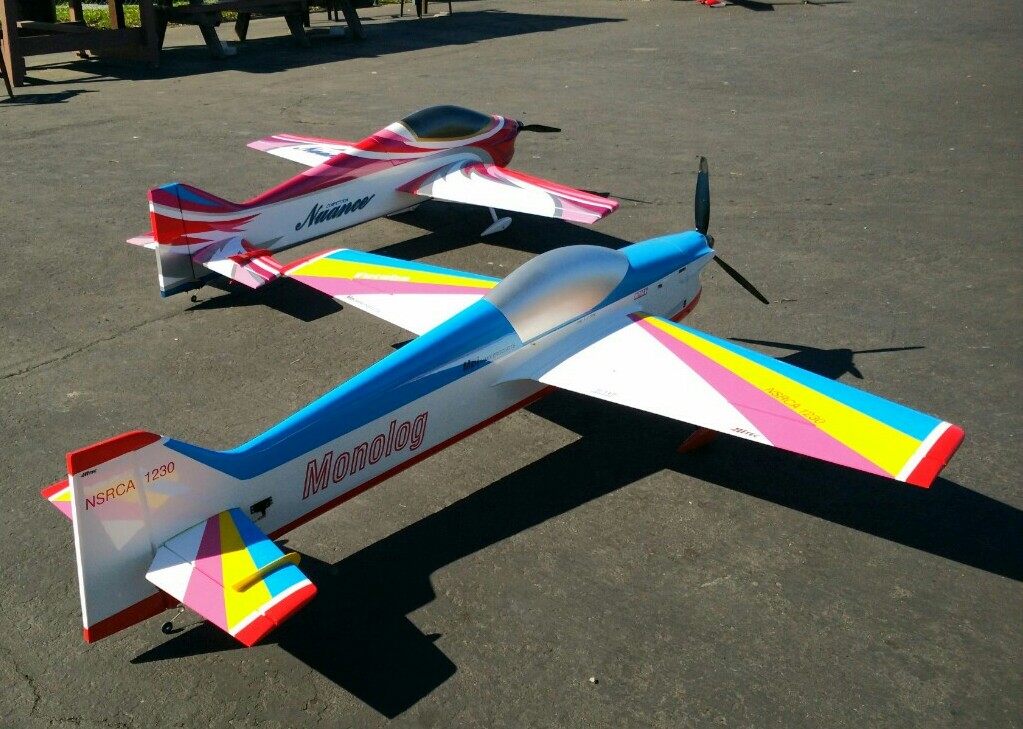

Had 20 flights on Falcon 19.5x13 3-blade so far, really like its smooth performance. One new AMA master sequence usage is 3600-3700mAh, no difference from the Falcon 21x13.5 V2 2-blade.
My Feedback: (42)
I have 4-5 flights on the falcon 19.5x13 3B and so far am really happy with it. I wouldn't say its a drastic difference between the braking of a good 2 blade but more constant speed feel through maneuvers. I'm still learning to fly with it, but so far so good. Flying through the advanced sequence burns approximately 2850-3000mah.
My Feedback: (42)
Motor is a hacker Q-80 14XS, as far as amp draw is concerned I never actually put it on a watt meter to be exact. But I can tell you that the motor comes down approximately the same temperature. Now for an FAI sequence I would expect a noticeable difference because of the heavier throttle requirements to fly those sequences. But as far as the AMA Advanced sequence is concerned the mah usage and motor temps are pretty close. The 3B uses just a bit more mah overall but nothing really substantial, 150-200mah.

Sounds Good, I want to try it on a Hacker A60 7S in a Nuance . I think it might work, I only fly Intermediate so not very demanding.
Did you notice any trim changes with it ?
Thanks Kirk
