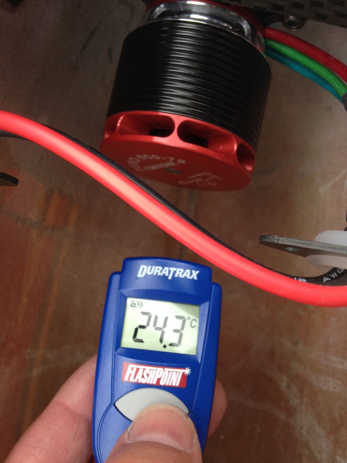

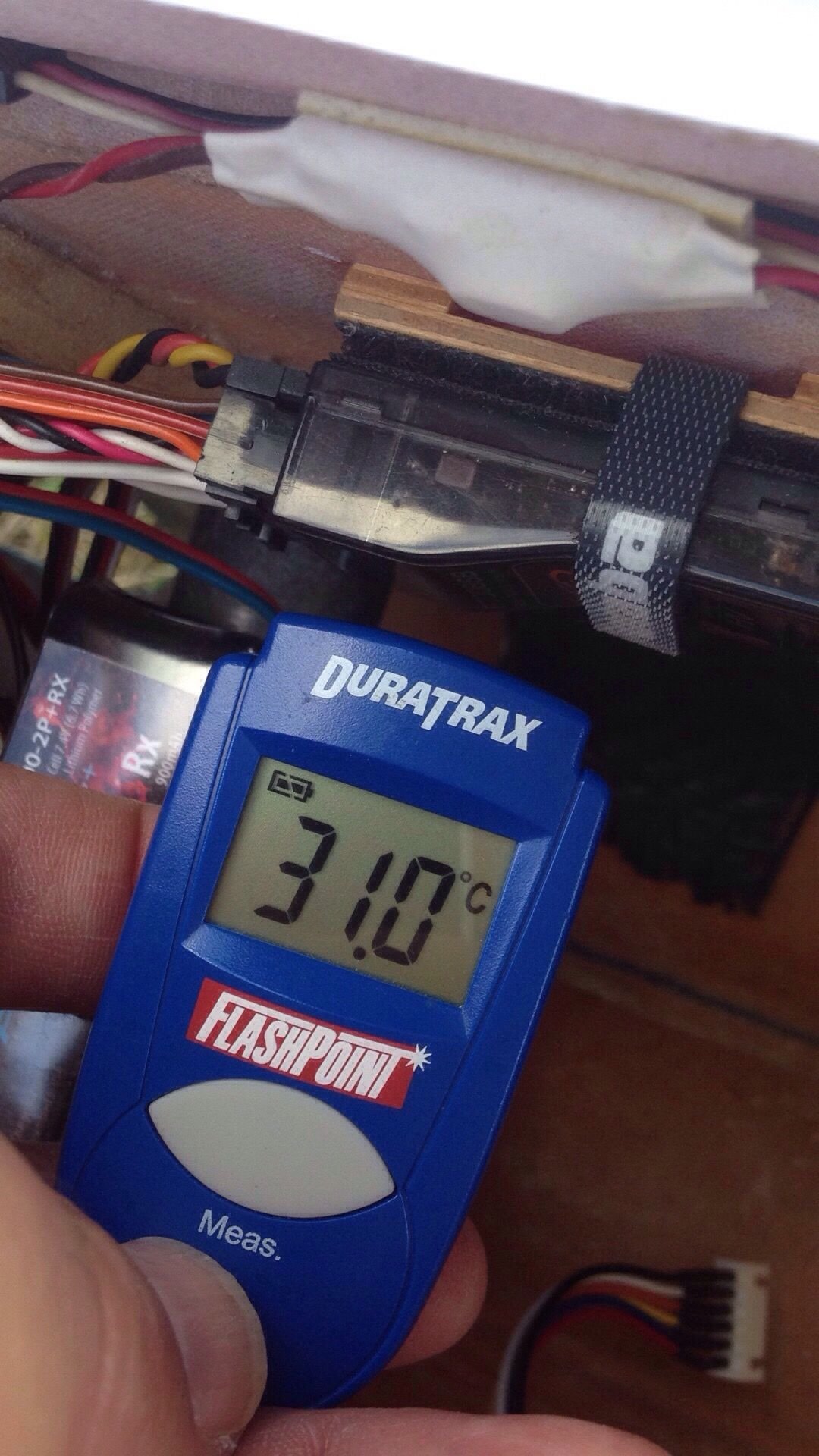

First flights are really encouraging.
The Single Drive seems to be more powerful than the OS, and the surprise is in the amps and engine temperature :
After landing, the FUTABA ESC is hotter than the engine .... no longer need to use a fan to cool down the OS engine, or wait for 20 mn.
Most of the time the OS was 56 °C
The ADVERRUN SINGLE DRIVE never exceeded 26 °C to date, after 60 flights, with outside temperature ranging from 6 to 18 °C.
Flying a P19 between 110 and 130 m and some extra maneuvers for a total time from take off of 8 mn, leave 20 to 25 % in the 5000 TP PROLITE X batteries.

After having flown a while for comparison with the OS Belt Drive, I mounted the ADVERRUN SINGLE BELT DRIVE again on the same plane for more testing.
Same prop and ESC
Although the outside temperature was 27 C, It appears that this engine is running really cool
After a 8 mn flight, a full P19 program , the engine just after landing was barely hot ... 37 C
I had to wait for the ESC to cool down
