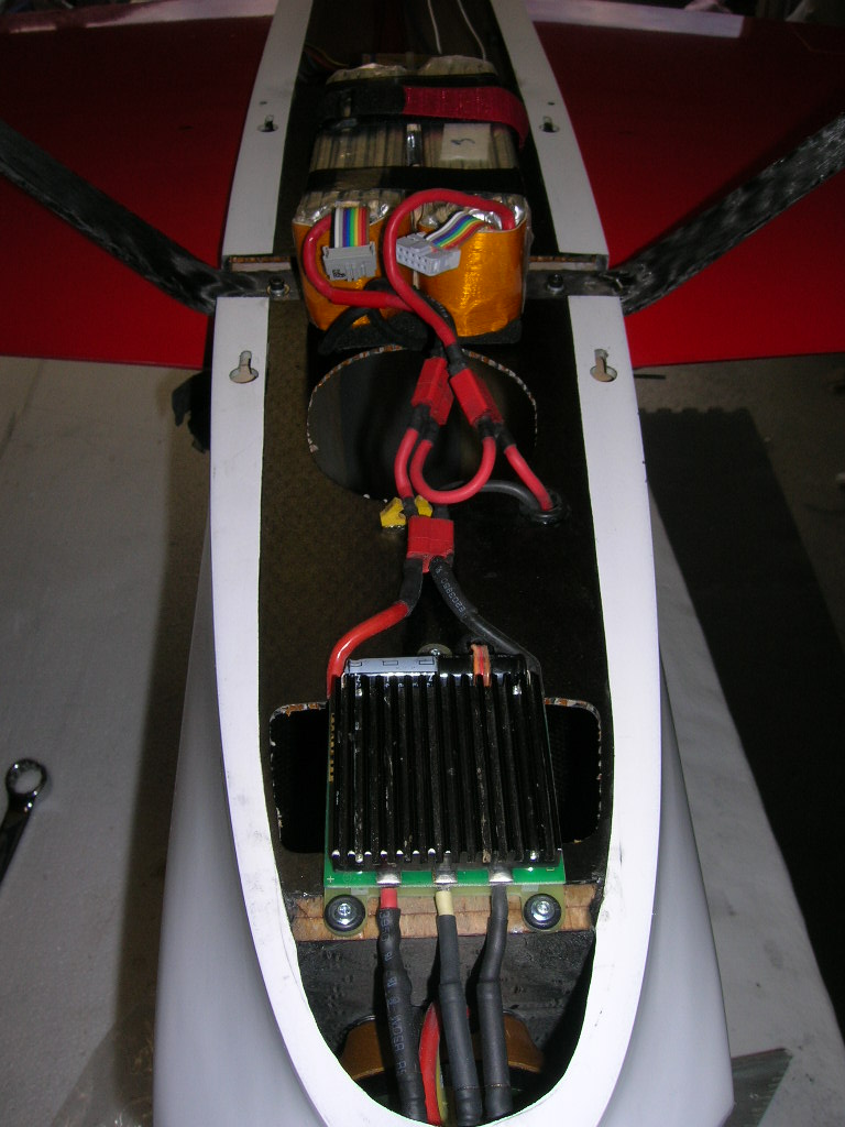

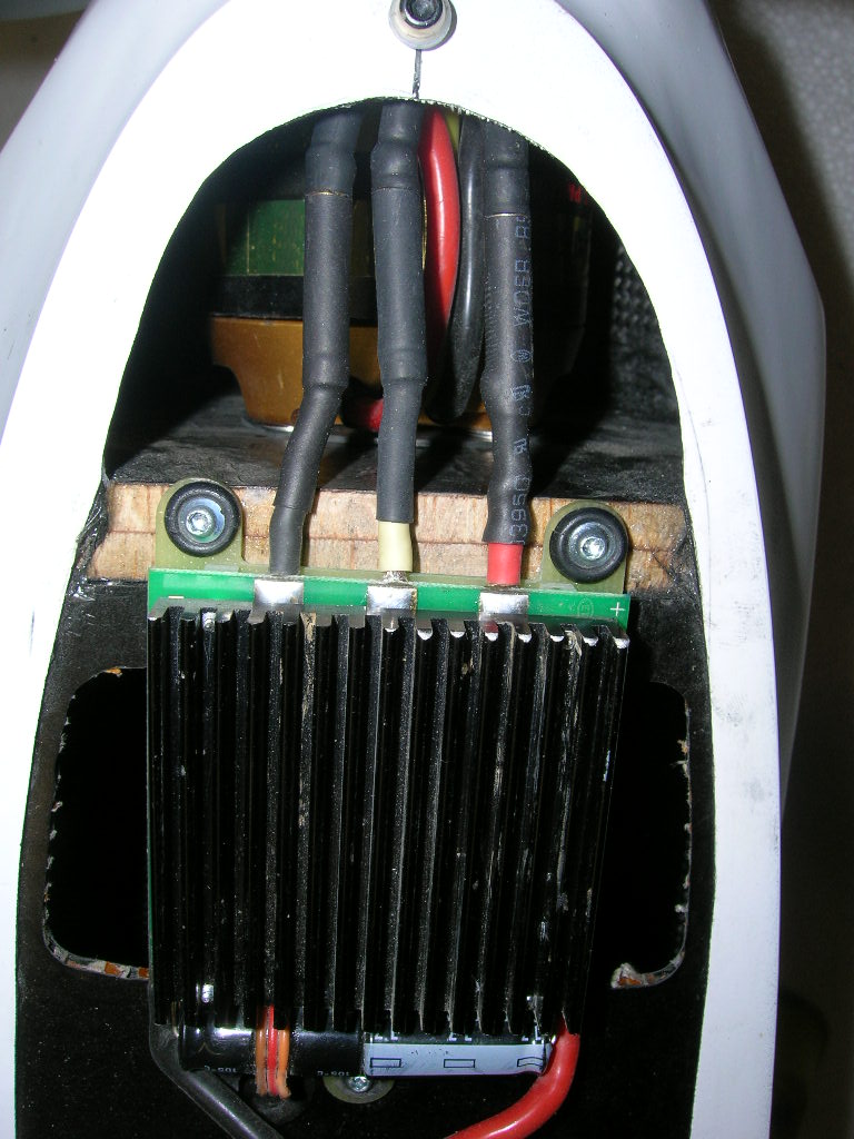

My firewalls are far from brick solid, simply 1/8" lite ply with 5.7 oz carbon on both sides, and mostly cut-out for weight/airflow. Pretty much everyone who has ran the Pletty has mounted it this way, I know of none that have failed in a variety of aircraft....thats thousands of flights of proof that firewalls dont need to be complicated, heavy and over engineered.
I cant speak for any other outrunner, maybe they are simply out of balance and inducing huge dynamic loads into the structure.
For anyone running a Pletti, the mount that I use works plain and simple no need to more.

Chad can you post up some pics here? Or just link to some?
I'm just trying to find solutions, definitely not trying to say "my way" is better worse or anything. I'm searching. The mount I'm using the like the Esprit Cambia mount, with long stand offs....so there is a good bit of torque out there, a pretty strong moment. A 16 ounce motor is probably not as bad as that monster AXI. I just hate taking chances, structural failure is something that I can live without...
And it has happened, with certain outrunners mounted to certain planes using the nose only. MOST don't fail, but if there's a chance, I like to take the less risky road.
-Mike
-Mike

Hi Mike
In post 10 of this thread you can see the firewall I have in my Twister (same as what I flew in Muncie). I dont know if it would work with other outrunners as I have never tried, but it works on the Plett motors quite well.
As with anything if your carbon is not well bonded to the wood you are going to have problems
I have the same setup on a Genesis 3D which has a much larger front end than the Twister, so far so good.

Well, we made one with the AXI and esprit mount about a year ago, and it is still going strong as well...but it's firewall mounted on standoffs. Weight isn't an issue. You can swing that thing by the prop and the spinner never moves.
Actually Chad, I was looking for pics of it mounted in the plane?
Thanks!
-Mike
Thanks!
