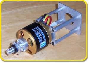

Hi Crazy, I'm not sure if it would work, but in the Evolution with the Axi, I ran the mount from Esprit models here..
http://www.espritmodel.com/index.asp...S&Category=678
Maybe you could call them to see if they have a pletty mount. Maybe they are the same as the axi. I don't know..
You could also run a budd mount, found here....
http://www.buddengineering.com/Merch...tegory_Code=MM
Which does work with the pletty...
Good luck!!

RE: E-Motor Mount for Pletti Xtra Outrunner
Chris
I am awaiting arrival of my Plett motor to measure and determine which mount I need to order.
I'm looking at the Esprit mount like the AxI 53xx.
Do oyu have any idea of a weight for such a setup, as you're using for your axi.
I don't see any weights for the mounts on there site.
I'm gonna be running the Plett 30-10Evo, Schultze fut 32.80KA ESC and FP Evo 5000 batts
thanks
Eddie

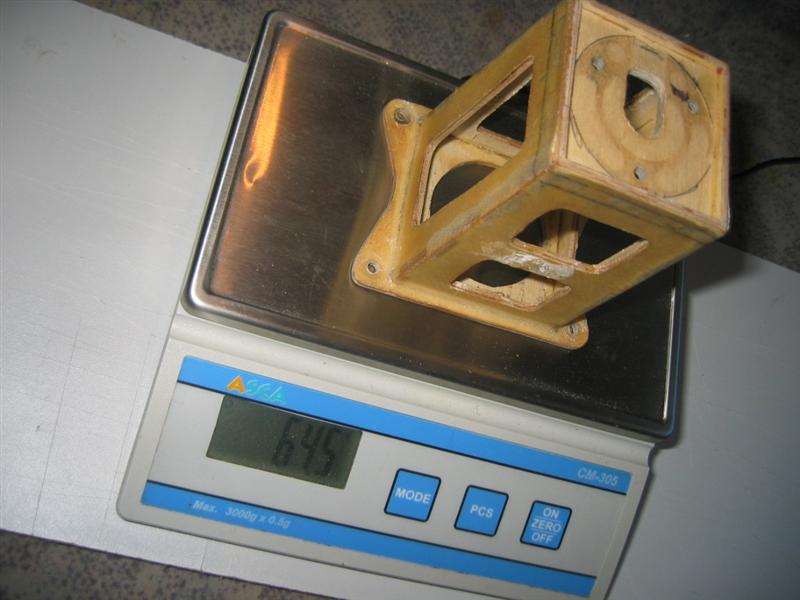

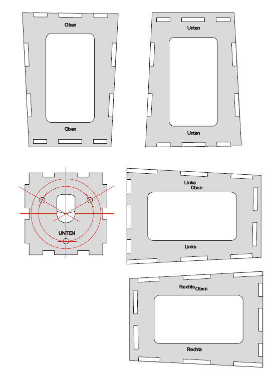

Hallo Chris
First thanks for Info
I does not think difference between the two engines is so large. Have me already considers to make this.
I have build for my E-Evolution a motor mount. Look at the Photo. But it is to heavy.
Crazyf3a
Man that's perect info. a lite ply box is my other alternative.
Do you know what the weight of your motor mount box in the photo comes to?
Also dimensions would be "nice" since I'll be putting the same motor on the same plane and my motor hasn't arrived yet.
Chris my prebuild weight estimate at this time is 4550Gm without a tail wheel, motor mount box ,battery mount tray,prop and spinner.
I am anxious to see what my AUW ends up at and how it flies as this will be my First Electric.
thanks for the help
Eddie
thanks for the help
Eddie

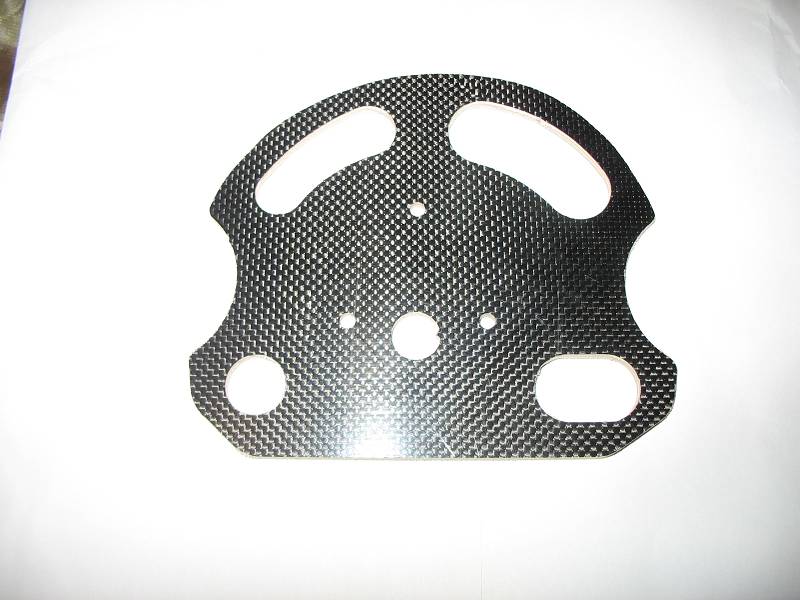

Crazy,
Here are a couple of pictures of the firewall I use with the 30-10 Evo motor, very simple, just 1/8" lite-ply with carbon laminated to each side. You have to use a backing ring for the bolts or they can easily crush the firewall, so 2mm solid carbon, or 1/8" aircraft plywood work well. The ring just needs to be big enough to support the washers on the bolts. As shown this firewall weighs 22 grams.
There is no need for a softmount with an electric motor, just extra weight and expense that is not required.

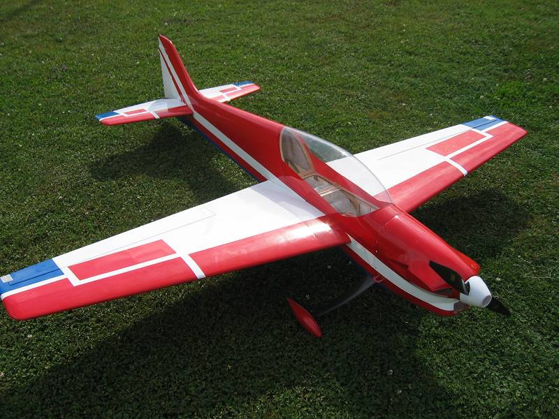

Hallo Chad
My secound plane is a ZN Synergy with the Pletti Evo and.... and.... The same setup you have in your twister.

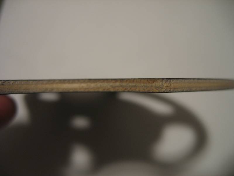

Hallo to All
Eddie:
The weight of the motor mount is 64.5 gr. ~ 2.27 oz. I have a picture in corel Draw. Please send a PM if you want the File.
I have build in aircraft Plywood 0.118 in laminated with 80 gr. (0.176 lb) Glass fiber one time.
Chris:
I have weight my E-Evolution today. The weigt is 4.783 gr. (10.5 lb) with all components. (Ready to fly).
The setup was: Pletti Xtra30-10, schulze 32-55, APC 21x14, Gear from ZN-Line, Lipo: Emcotec 10S2P Emcotec 4000mAh (1150gr.) That's it.
I hope correctly converted.
Thanks to All for infos and comments.

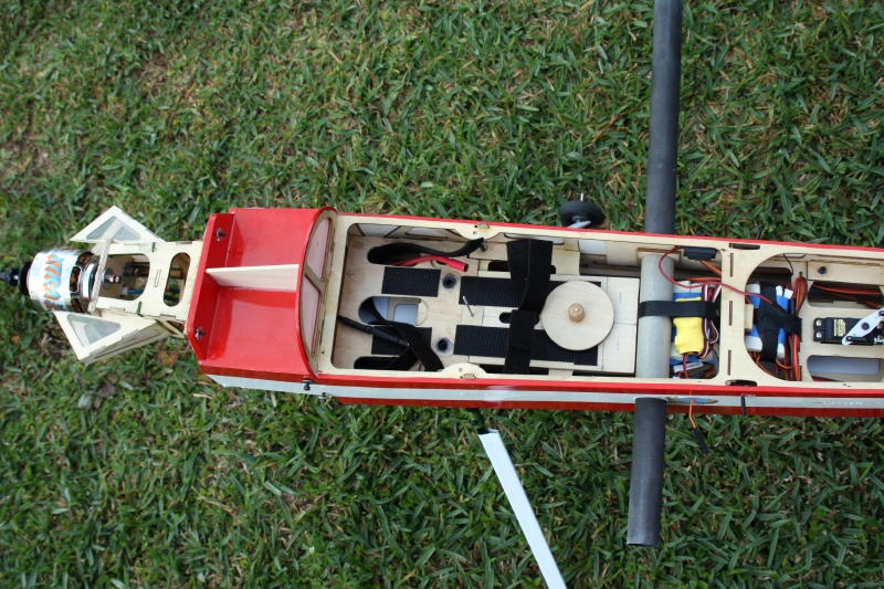

Hi there Everyone,
Well, that I could have look at Esprit model (didn’t ask do if thy have one for Pletty “Ops†) thy
don’t have one that could be use without any modification.
Well I’ve decided that will make my own.
And it isn’t that hard to made one of the back plate. I’ve only used there Rods.

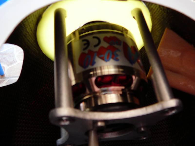

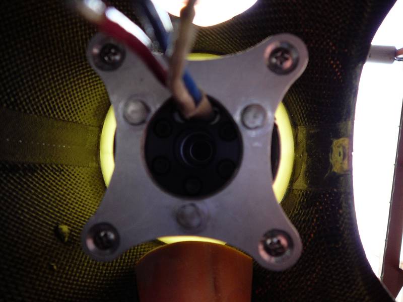

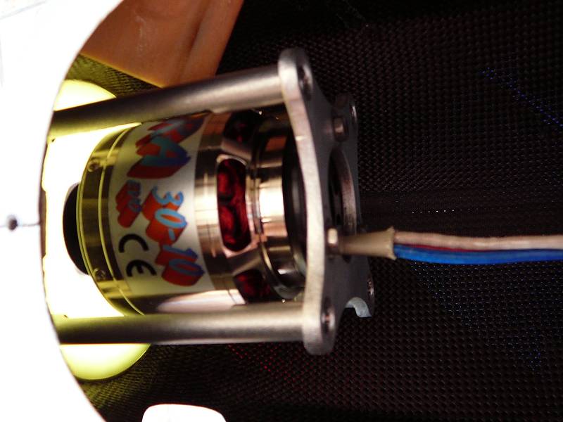

A Picture can (says) describe better than word so, here follows a couple of pic’s of my set-up.
Pletternberg Extra 30-10 Evo motor and plane JM Composite Leviosa.
Regards,
Danny Koolman

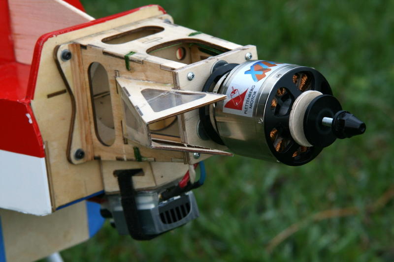

Join Date: Apr 2002
Location: DeQuincy,
LA
Posts: 463
I wanted to show what I ended up doing.
I modified the mount from UltraRC for the Hacker to accept the Plett.
Crazyf3a thanks for all your help.
Eddie
Eddie
Hello to all.
I thought always too much over the motor mount. It give so many variants. The most important is that it holds and I can say to myself its OK.
Hello Eddie:
your ventilation is ineffectively at least for the engine or esc. I white not however which you would like to cool . Your modified cooling is good for a Hacker but not for the Pletti. Think about it. Look at the photo of the Evolution. I have only cut my spinner. It is the not beauty but effectiv.
Here are two photos from the motor mount for my Synergy. (Copy by Chad) I think It is perfect for the pletti in my Synergy. This is the only way to build a motor mount for Outrunners like Pletti or Axi ...., with a Backplate mount in a Fuselage. I think the problem for most builders is to build a motor mount that is light and good. But who said this is good or not.
Hello Eddie:
