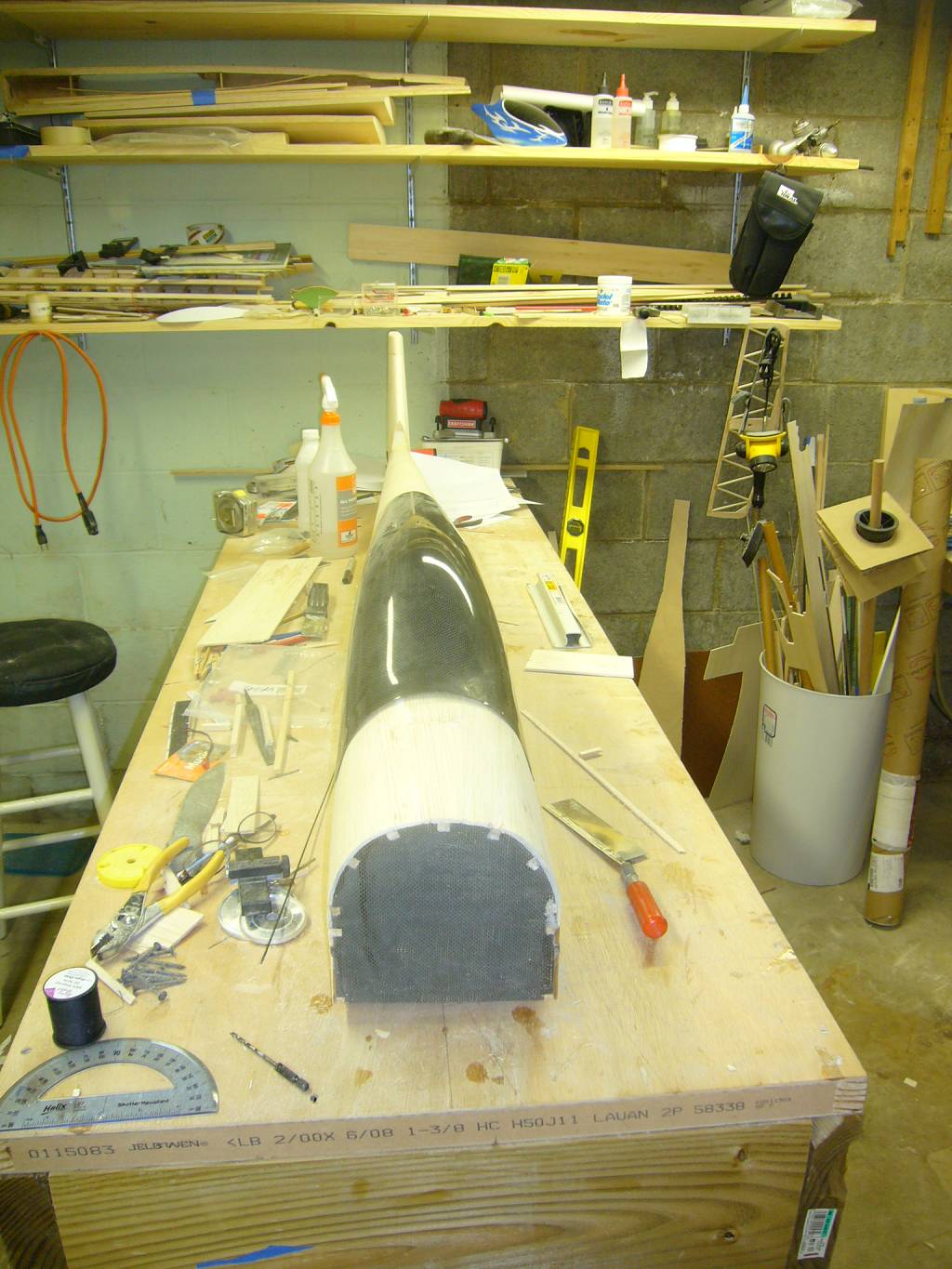

Here are the cores ready to skin, the layout of the carbon tow I use to reinforce the wing (I also used this technique on the stabs as well), a skin with the PU glue all rolled out and the CF tow stuck down and finally the cores in the vac bag sitting at 9.5" of mercury for the night.
Once I get them out of the bag I'll weigh them again and post some weights.
My spars are a little different than what came in the kit. I laminated some .007" X 3/8" CF between two pieces of 1/16" balsa and thay are an inch longer. The wing panels should be plenty strong.
ID:	1337221   Click image for larger version

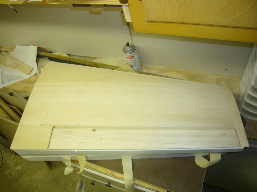

Wings capped and ready to go except for a couple things, caps on the end of the ailerons ans cut the hole for the servo lead...but they are both sitting at 238gr.

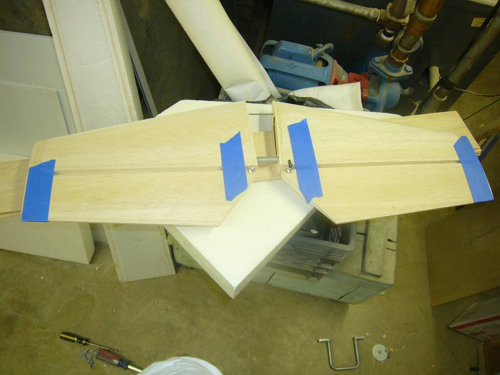

At this rate I should be ready to cover in a couple weeks. All hard points are in and all that is really left before I cover is the belly, dorsal for the fin and stab, blend in the fin, and mount the cowl along with routing the firewall...really not that much.
Here are some weights so far:
Fuse 544 grams
Wings 240 grams ea
Stabs and Tube 150 grams

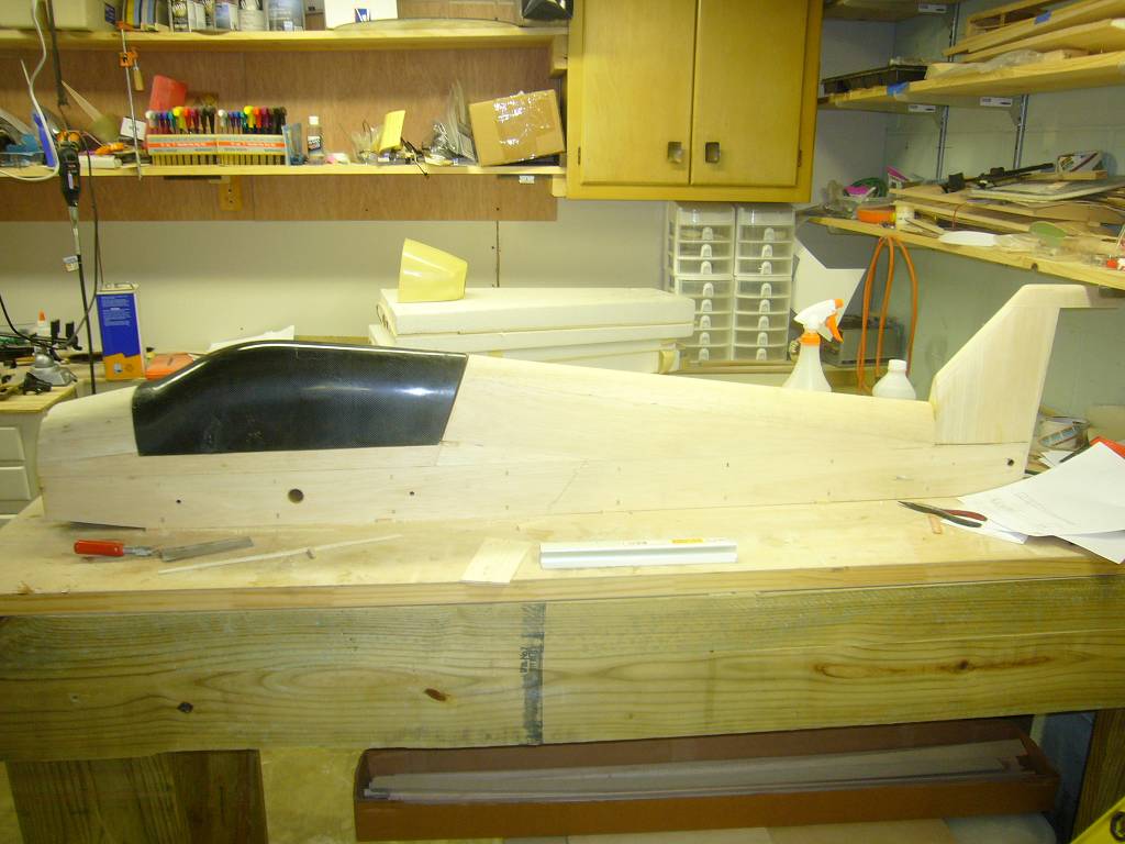

The belly is now on, fuse floor has been opened up, rudder servo mount, and wing adjusters are in place. Now for the dorsal, cowl and fire wall routing.
Guess I should start weighing all teh components to make sure I know where it will end up weight wise.....or at the very least a rogh idea.

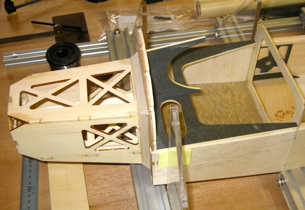

Ok, I'll bite...
How do I get my AXI in the front with the cross bracing & firewall support in place?
The only way I can see is to radically modify the cross brace and firewall support...
Cheers
Jason.

  #73
woodie
woodie's Avatar
Join Date: Jun 2002
Location: Absarokee, MT
Posts: 1,148
Default RE: Black Magic VF3 E build thread!
Is the cowl nose ring big enough to slide the motor in from the front? I can't remember what size the BM3 nose ring opening is.
Woodie

Jason,
If it were me I would open the bottom of that motor box up and put the motor in that way. I just pulled the plug from the mold for my motor mount which will be in the vacuum tomorrow and it is only two sided. you'll be fine with opening the bracing on the bottom of that mount enough to clear your motor.
Pics of my mount will be forthcoming.

G'day Pete,
I think cutting the bottom out of the mount might lose some of its rigidity. The hole for the AXI would need to be very big...
I found an old pic that Mike posted on the VF3 Glow thread and it seems that he didn't use the braces at all...[X(]
I don't like the idea of ommitting the braces all together as it must give quite a bit of strength to this area. I may just modify them buy cutting the middle out of them. I will post some pics once it's done so others have a reference.
Cheers
