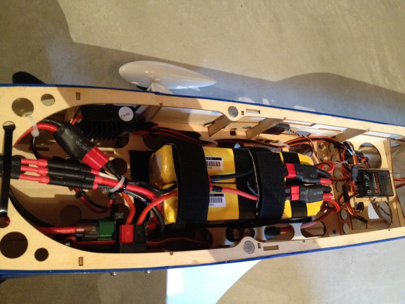

The tray is there, I thought of moving the RX batt there but would have to make some type of extension for the power box digi switch. those wires are small enough and I wasn't sure extending them would be a good idea. Thoughts?
Is it a bad idea to have the rx batt right next to the RX? Like I said, I'm sort of new to the electrics. I think I will move the Rudder servo in the back like Bob did. BTW, previous owner has a HS645MG for rudder...good enough? 133 OZ torque at 6 V
2 4 cell 5000 mah....came witht he plane
Cant seem to figure how to upload pic?
Guess I did
Guess I did

Just for balancing purposes, move the Rx battery next the Rx, and the big batteries up against the 'wall' and see how it works.
My Rx packs are right next to my Rx (touching) and I've never had any issues. You can move the power box (regulator?) back there as well, when I was running 10S my regs were back behind the canopy where the rx tray is.
If you only have one battery, using an extension is adding a failure point. I don't think I would do it there, but some would.
What motor/prop are you running? And what spinner? (Stock is white w/ aluminum back plate)
I tried using different batteries to save weight/optimize performance, however all I really did was add complexity as they all need to be in different places to achieve constant balance point. Based on that, I don't suggest trying smaller batteries, unless you want to buy a few sets to use for serious practice and contests, and save the set you have for warming up or other purposes. But you can probably get away with 4000-4400mah if you wanted to. And 20C is all you need for power packs, don't waste money and weight on higher 'C' packs.

Good info Joe
The power box is a switch with regulator. It's mounted in the side of the fuse so I'm not thrilled about moving it. Just another hole to cover I tried what you suggested witht he rx pack and moving the batts back. Didn't give me enough to really still not to have to add weight. It's all to close to the CG to make alot of difference. I weighd the servo...1.3 oz...Yea, that might be the ticket. Is pull pull that much better than one rod on one side of the rudder? I'm not at any stage in my flying that I call competitive........yet
Stock Spinner
Stock Spinner
