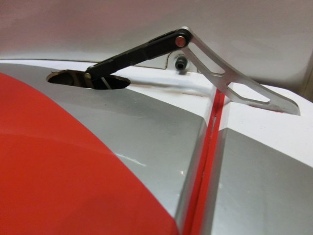

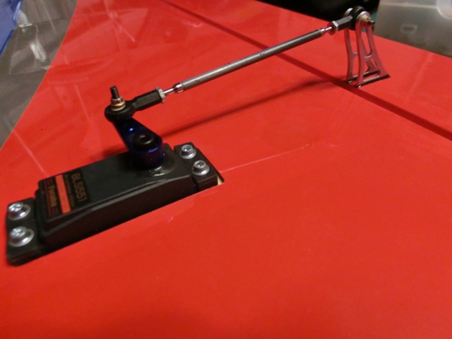

    ORIGINAL: UltraBob
    I'll be the first to admit that I get carried away on my linkages sometimes.
    I have that problem too although its more like an obssesion. My budy told me "your the only onr I know that takes 3 months to build an ARF". I'm still not sure how to take that

     The parts were made on my machines and the objective was to have near perfect linkage geometry, i.e. mirrored pos/neg throws and servo-surface ratios with max resolution so I would have nothing to blame for my flying. I never tried the stock setup but the plane feels good with forward cg and positive incidence . I will be making this type of stuff for a dealer in the future and may offer these parts for the W110 too

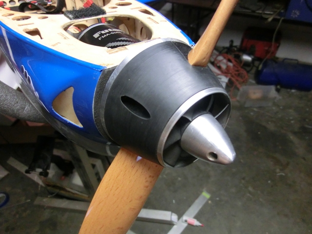

    Attached Thumbnails Attached Thumbnails Click image for larger version.

    Unusual spinner you have there in post #1734.
    TruTurn has also now special cooling electric spinners, Turbo-Cool.

    I'm just tinkering, Bo . I did see the Tru-Turn. no surprise its a nice piece. Imay do some more testing with the data loggeron its effectivness once the hot weather comes (its pretty much here). coming down with a 100deg F can/120 deg core tempat the moment
