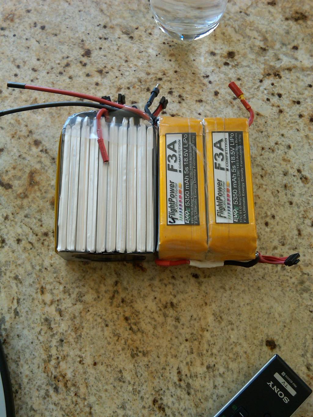

Pic attached, you can see the interconnector cable in the middle joing both sides of the pack. Physically it is a mm or two wider and longer than the FP5350 but is about 5mm lower....

Hi Niall!
all is good here. how are you?
I didnt fly alot the past season so I didn’t get in to the team for the WC. (work...[sm=what_smile.gif])
As you can see I got a new model and I am back in the business!
thanks for your replay, I think I'll go for it!
how many cycle do you have on your TP 5000 so far?
Ram
