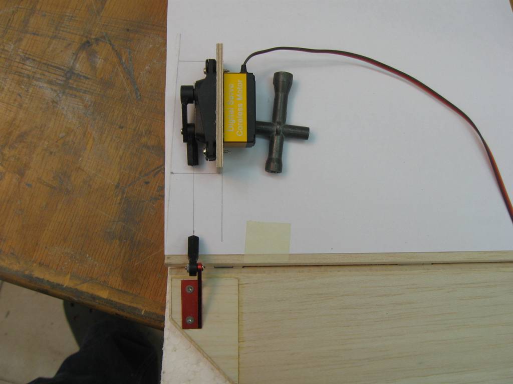

Hi Ryan,
The maximum deflection are:
Ailerons - 30 degrees up/down
Elevator - 30 degrees up/down
Best regards,
Isaac Najary

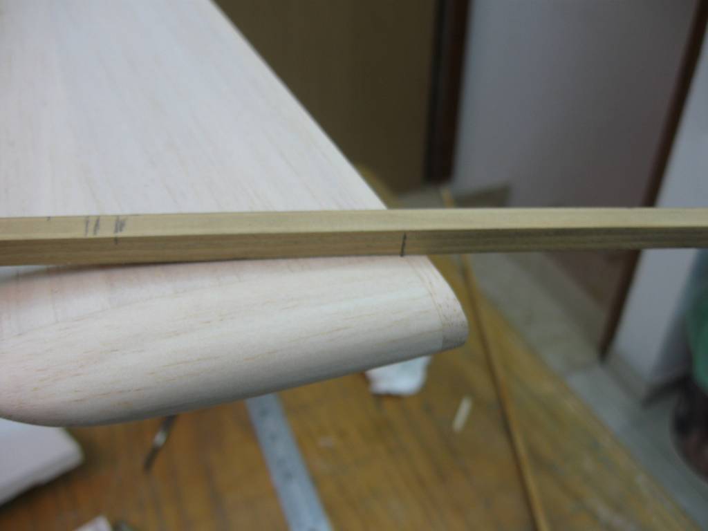

Old 01-09-2010, 01:13 AM
  #52
najary
najary's Avatar
Join Date: May 2003
Location: Ramat Hashrone, ISRAEL
Posts: 1,201
Received 36 Likes on 32 Posts
Default RE: Electric ZN Line Xigris C2 Build Thread

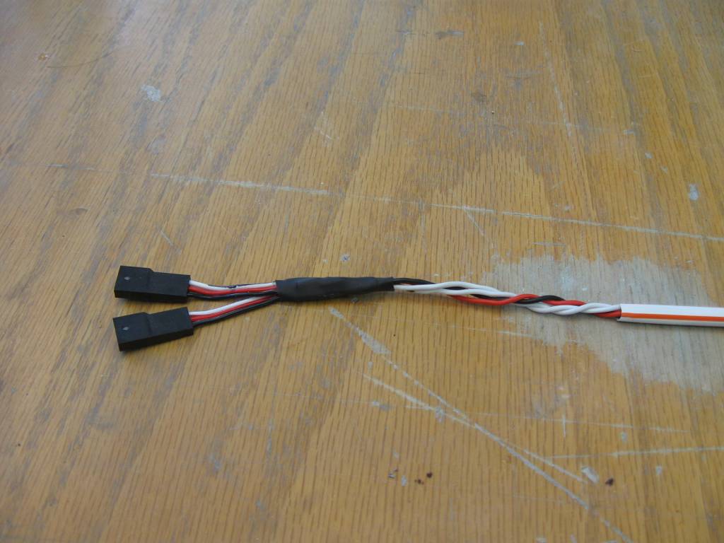

More
ID:	1352405   Click image for larger version
ID:	1352406   Click image for larger version
ID:	1352407   Click image for larger version
ID:	1352408   Click image for larger version
ID:	1352409   Click image for larger version

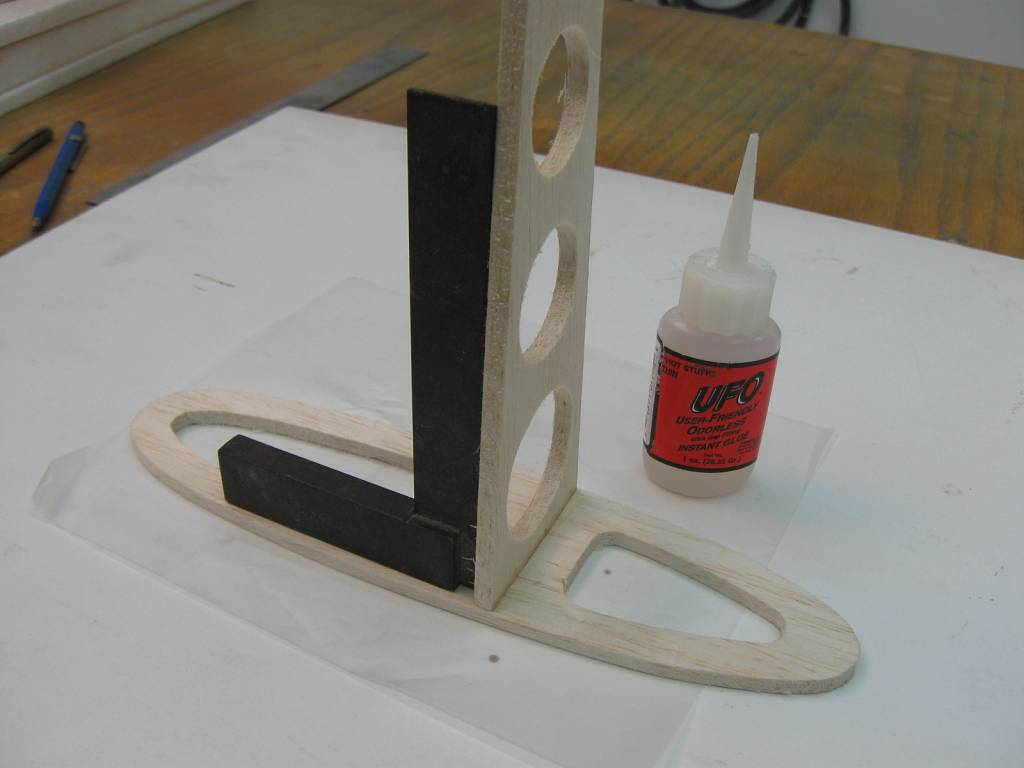

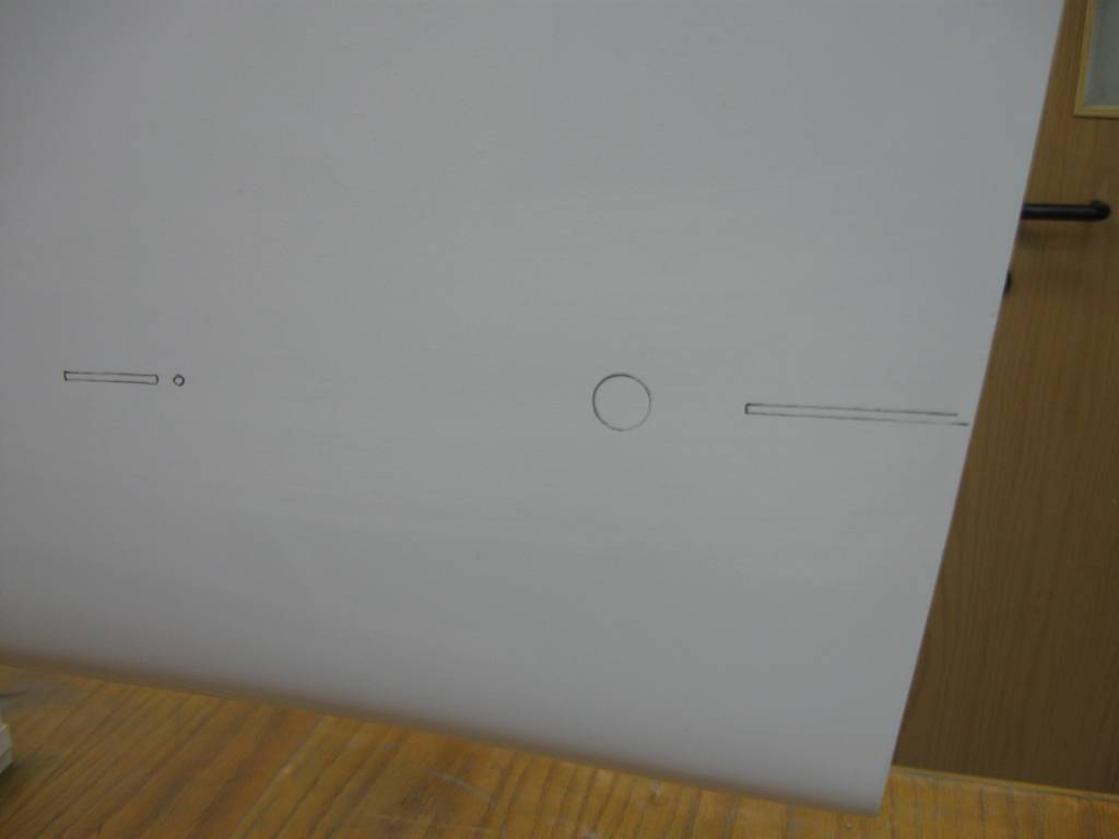

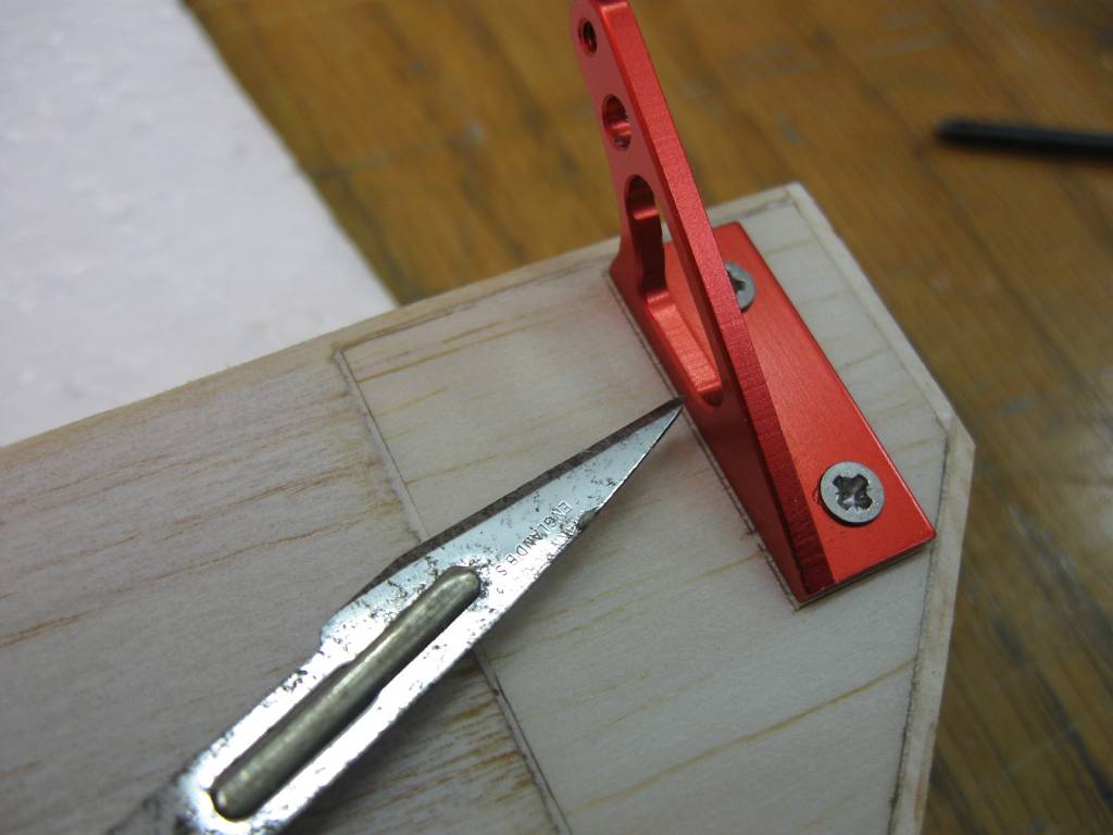

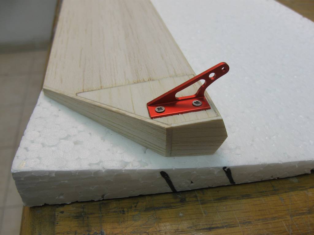

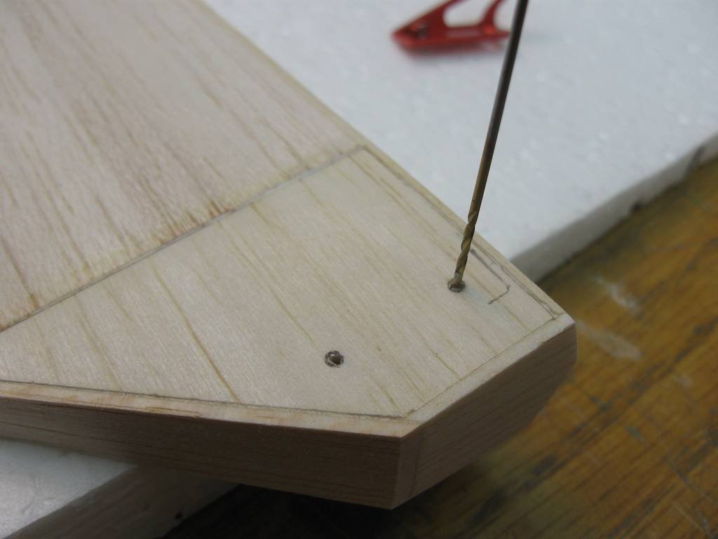

Would this approach for control horns be OK for a YS powerd version?
Colin.
Old 01-10-2010, 02:43 PM
  #54
can773
can773's Avatar
Join Date: Jan 2002
Location: Calgary, AB, CANADA
Posts: 2,286
Colin,
I have used ZN horns and this same method on all my ZN planes, both glow and electric. Its safe and easy to do.
Old 01-10-2010, 03:45 PM

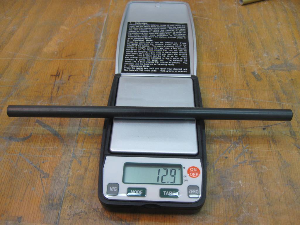

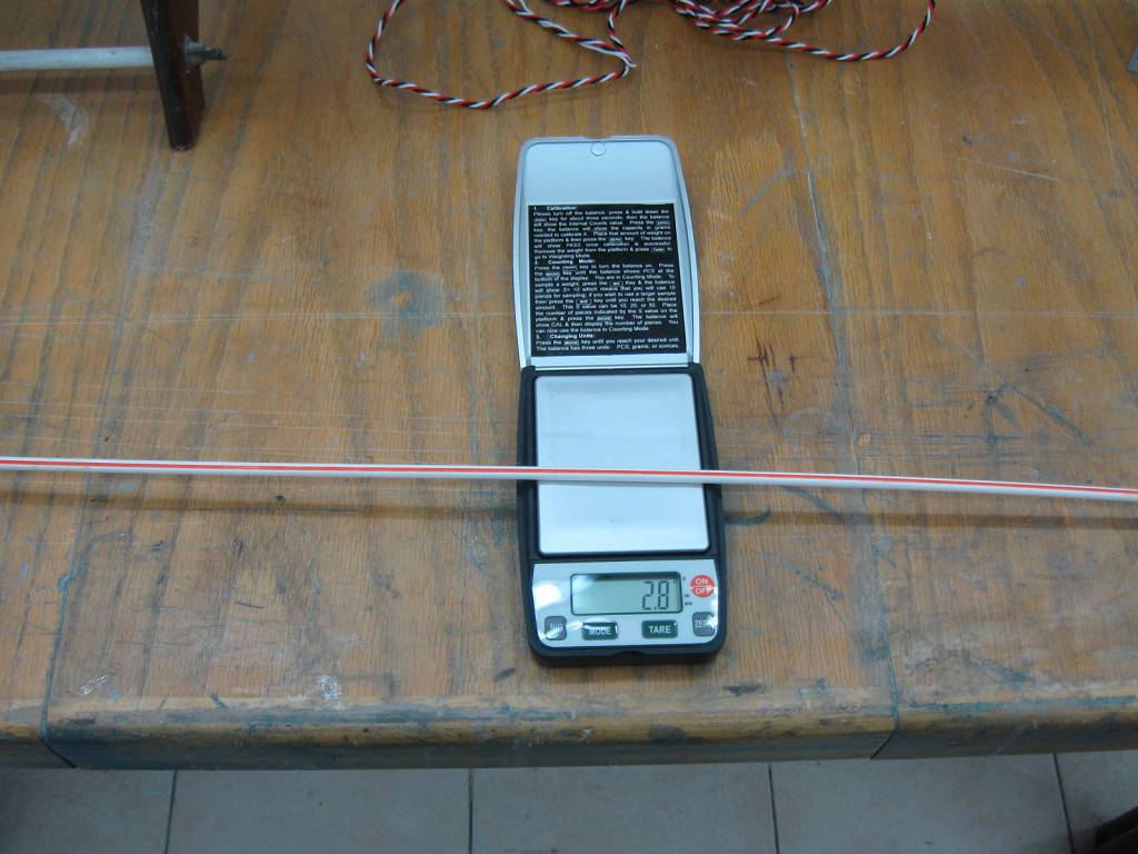

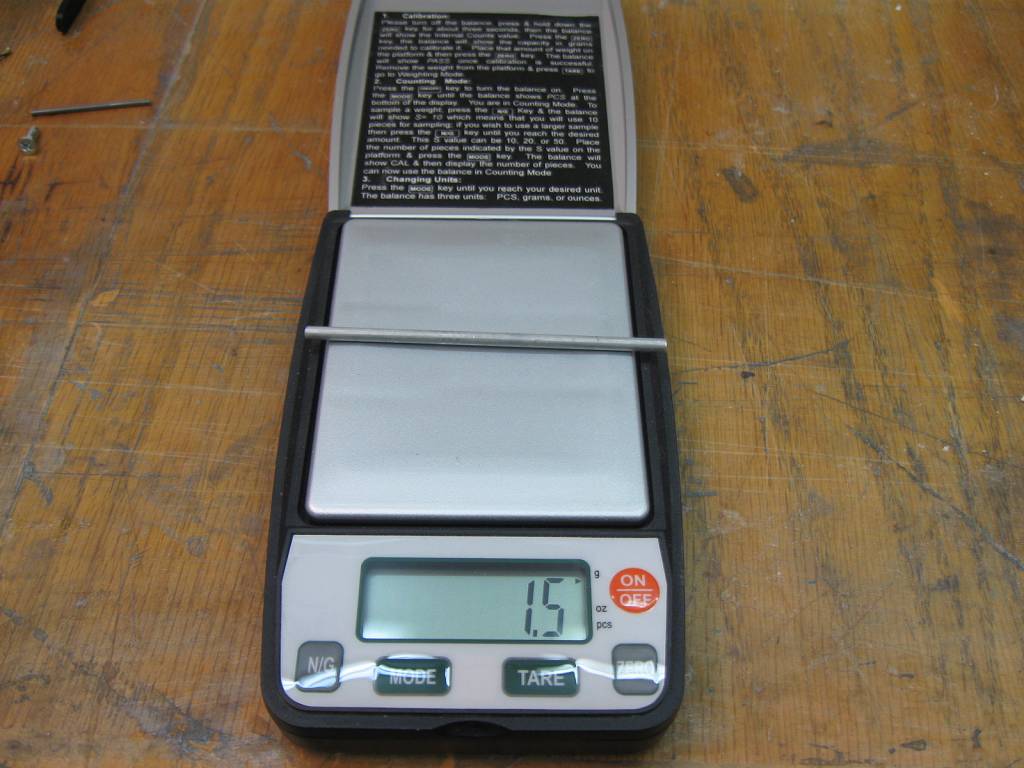

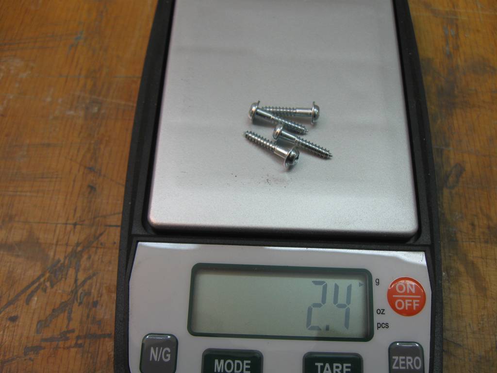

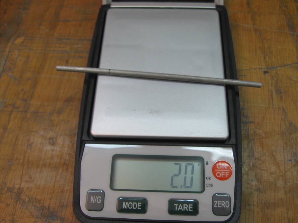

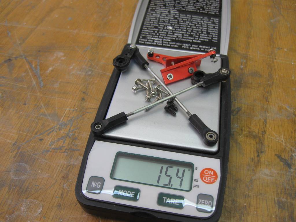

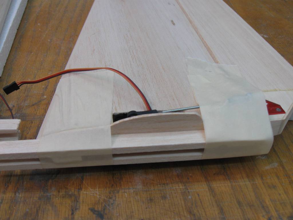

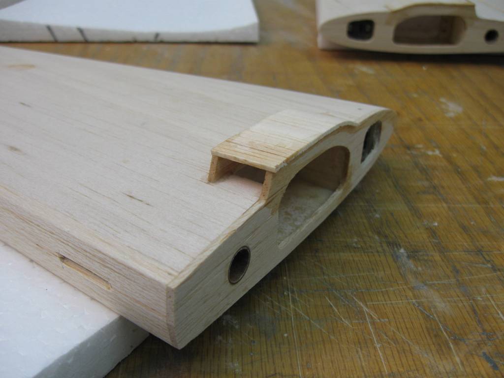

Saving 5.4 gram = (2.4+2.4+0.6)
Savox screws - 2.4 gram,
Central Hobbies Deep Head Socket Screws - 1.8 gram
http://www.centralhobbies.com/buildi...ers/fastnr.htm
Futaba screws - 1.2 gram
Elevators - 2.4 gram = 2X(2.4-1.2)
Ailerons - 2.4 gram = 2X(2.4-1.2)
Rudder - 0.6 gram = (2.4-1.8)

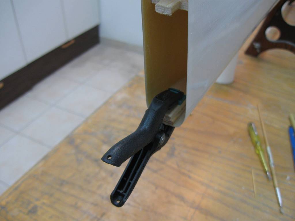

ID:	1354145   Click image for larger version
ID:	1354146   Click image for larger version

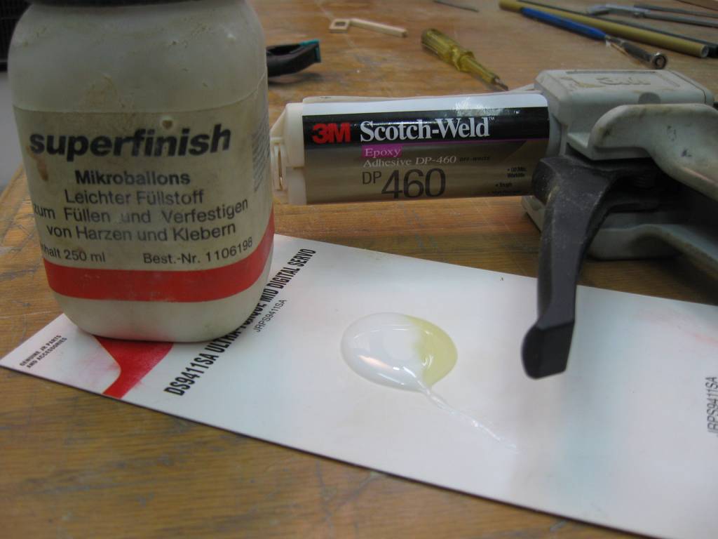

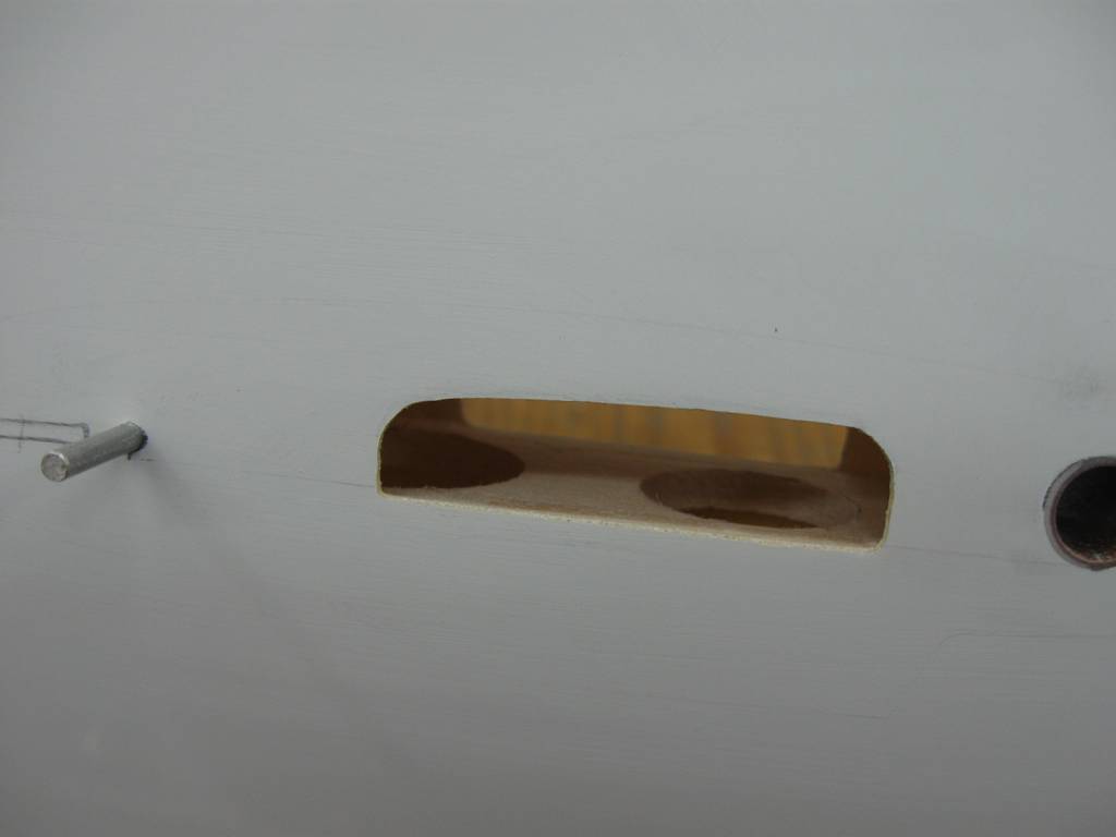

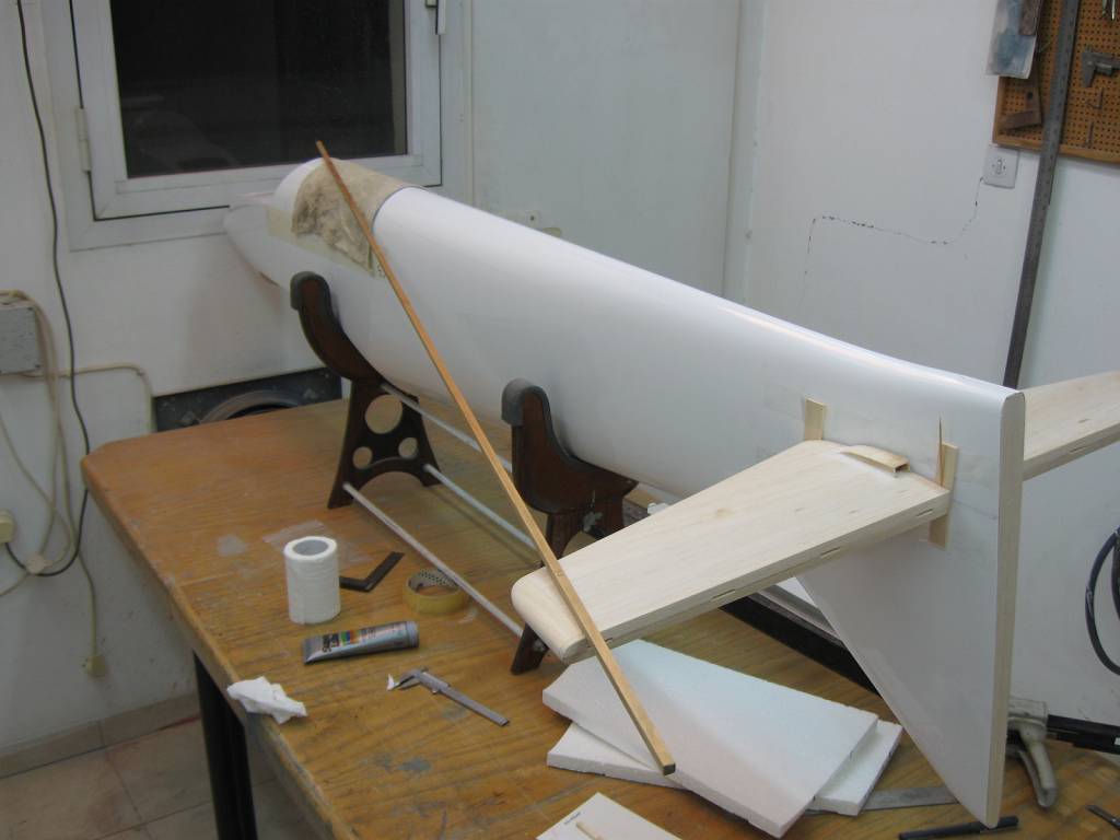

More
ID:	1354148   Click image for larger version
ID:	1354149   Click image for larger version
ID:	1354150   Click image for larger version
ID:	1354151   Click image for larger version
ID:	1354152   Click image for larger version
ID:	1354153   Click image for larger version
ID:	1354154   Click image for larger version

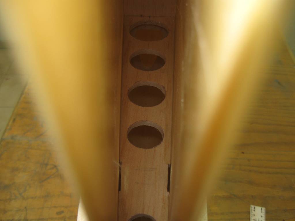

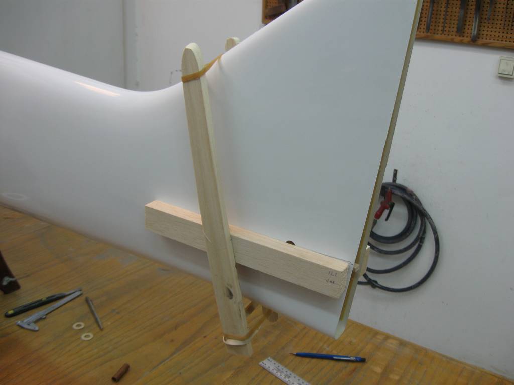

Old 01-12-2010, 01:44 AM
  #61
Andy P.
Andy P.'s Avatar
Join Date: Nov 2004
Location: Leicester, , UNITED KINGDOM
Posts: 316
ORIGINAL: cchariandy
I may be jumping ahead of the build a little but I didnt see it in Chads build either...how do you locate the stab ajuster pin with the adjuster already secured in place? Is the foam cutting so precise that you can just glue the adjuster plates in place and it will be aligned with the pin?
Colin.
Pretty much yes!
The plates that you glue into the stab halves are a real snug fit, well they were on my ZN Twister, also the screw holes to fix the adjusters onto the plates are pre-drilled. On the fuse, the hole points are pre-marked on the sides along with the joining tube markings, simples...........................
Isaac,
have you decided on the colour scheme for the Xigris yet or are you going the same as the Osmose?
Regards,
Andy.
Colin.
Hi Colin,
It is no so important if the foam cutting is so precise or not, I will make the hole for adjuster pin in the fuselage according to the location of the adjuster plates in the stabs.
Best regards,
Isaac Najary

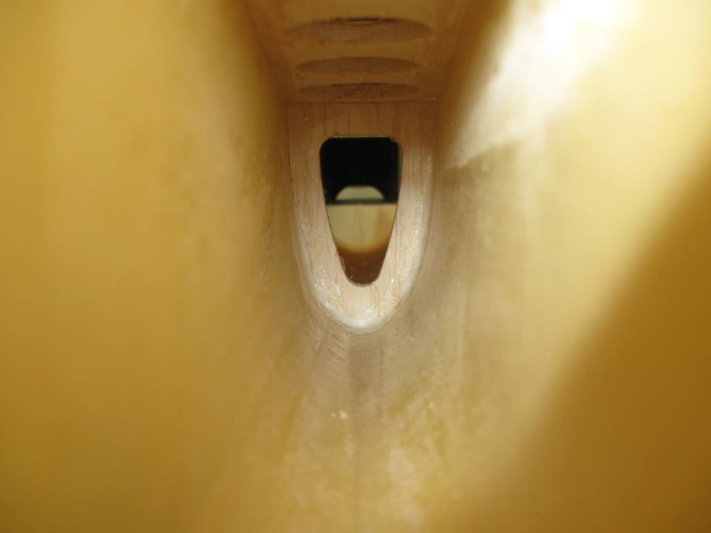

More
ID:	1356507   Click image for larger version
ID:	1356508   Click image for larger version

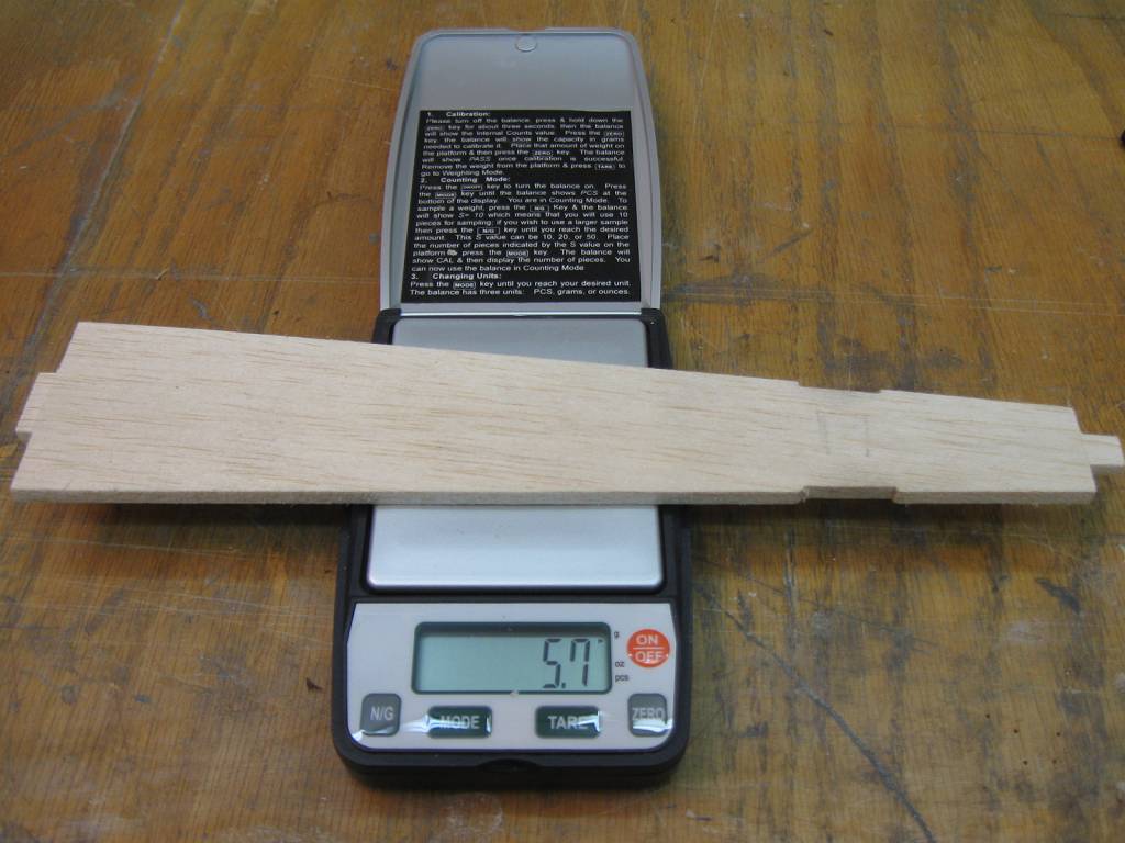

Old 01-21-2010, 12:25 PM
  #68
najary
najary's Avatar
Join Date: May 2003
Posts: 1,201

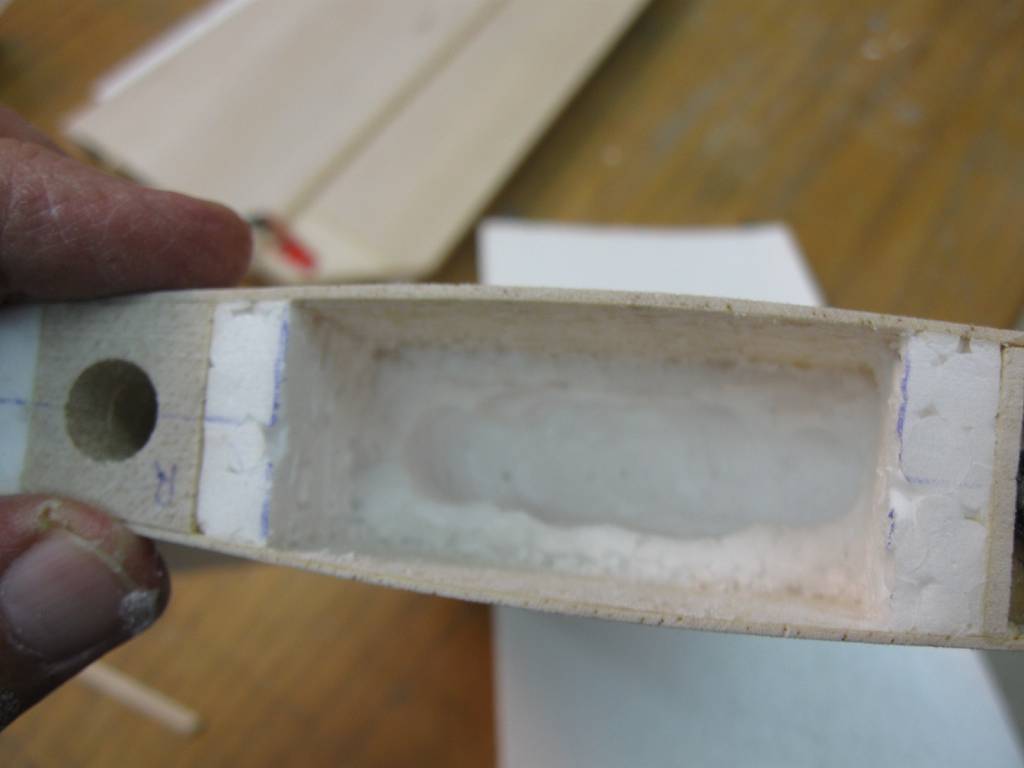

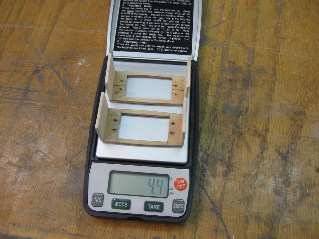

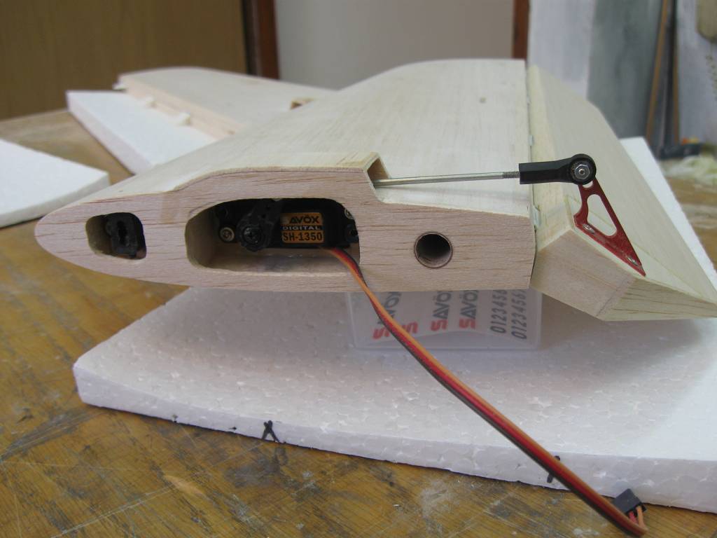

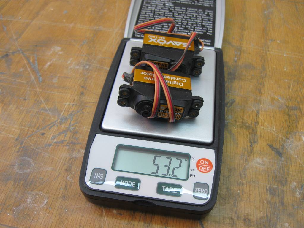

Saving 1.9 garm =(5.7-3.8)

Saving 4.8 gram =(17.7-12.9)
ID:	1360828   Click image for larger version

Saving 0.5 gram = (2.0-1.5)
ID:	1360830   Click image for larger version

Saving 0.6 gram =(1.5-0.9)
ID:	1360836   Click image for larger version

Saving 10.45 gram =(20.9/4X2)
