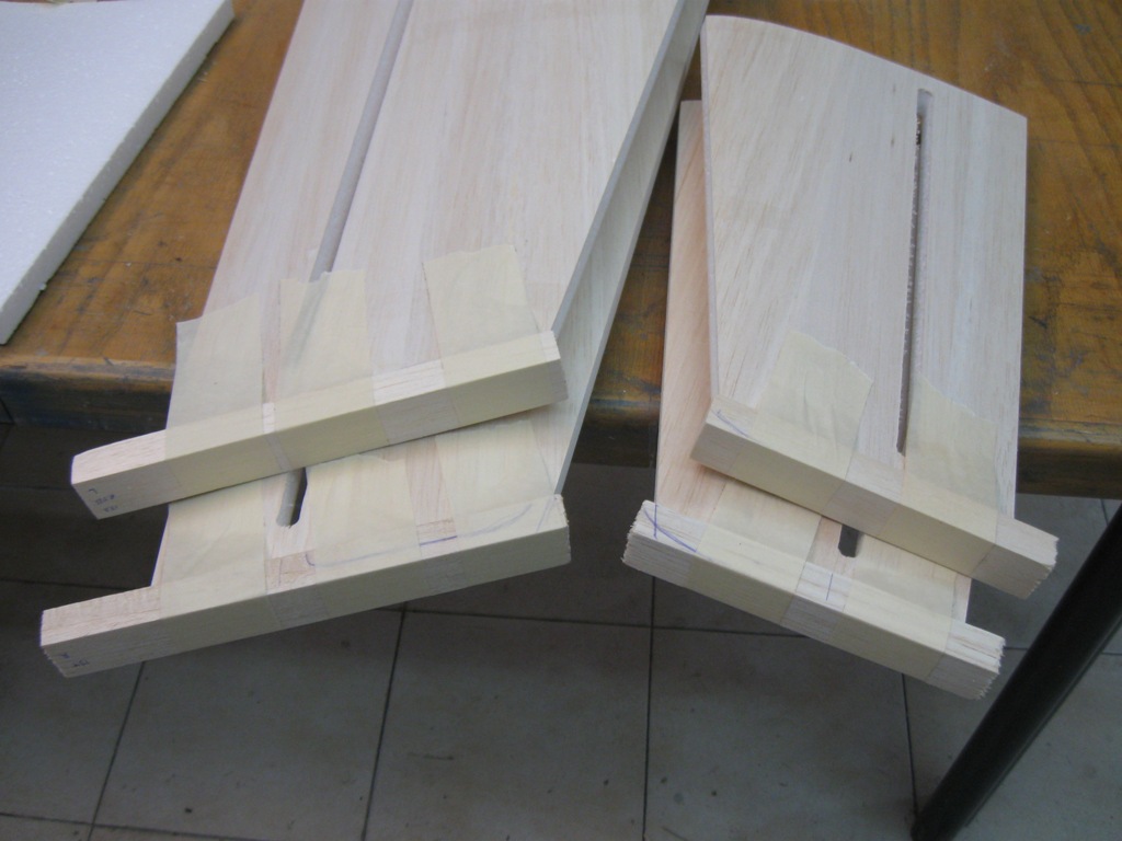

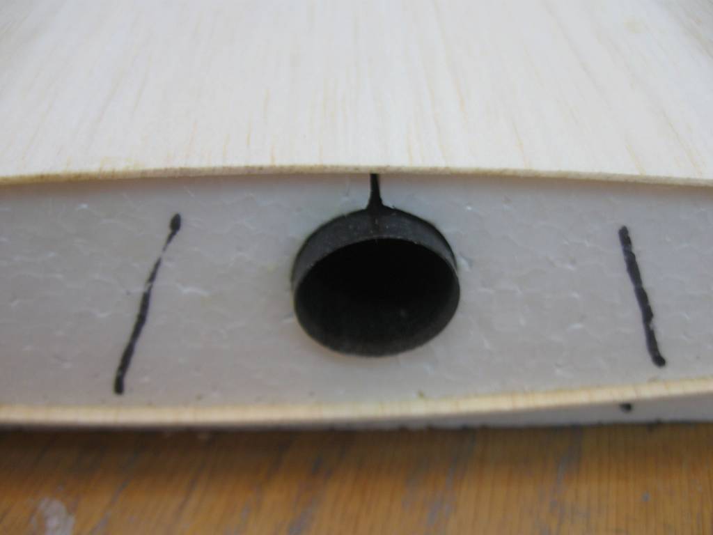

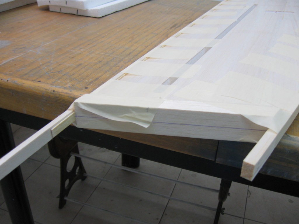

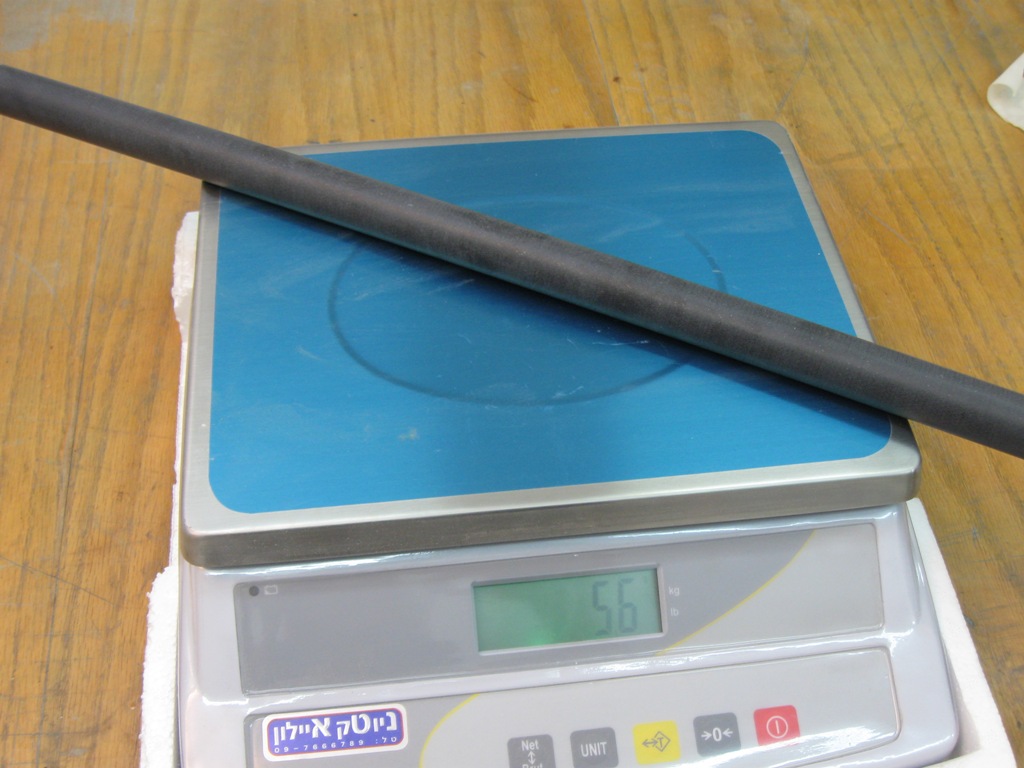

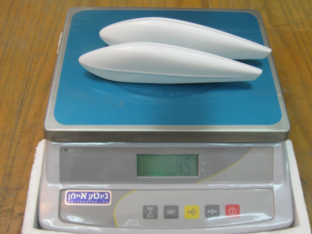

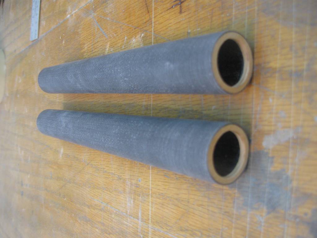

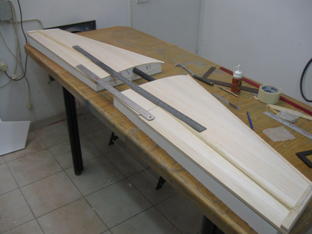

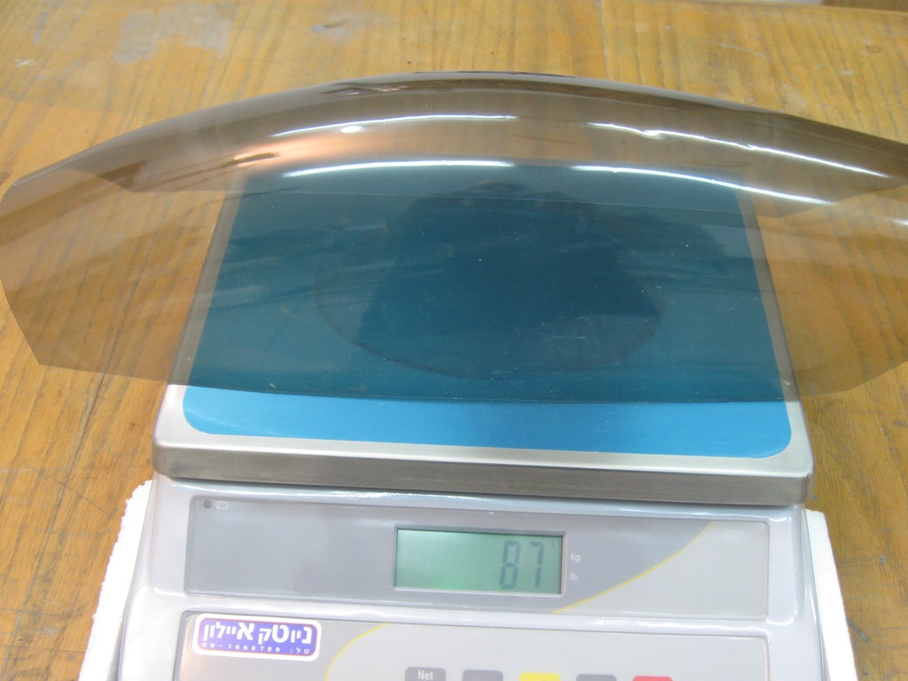

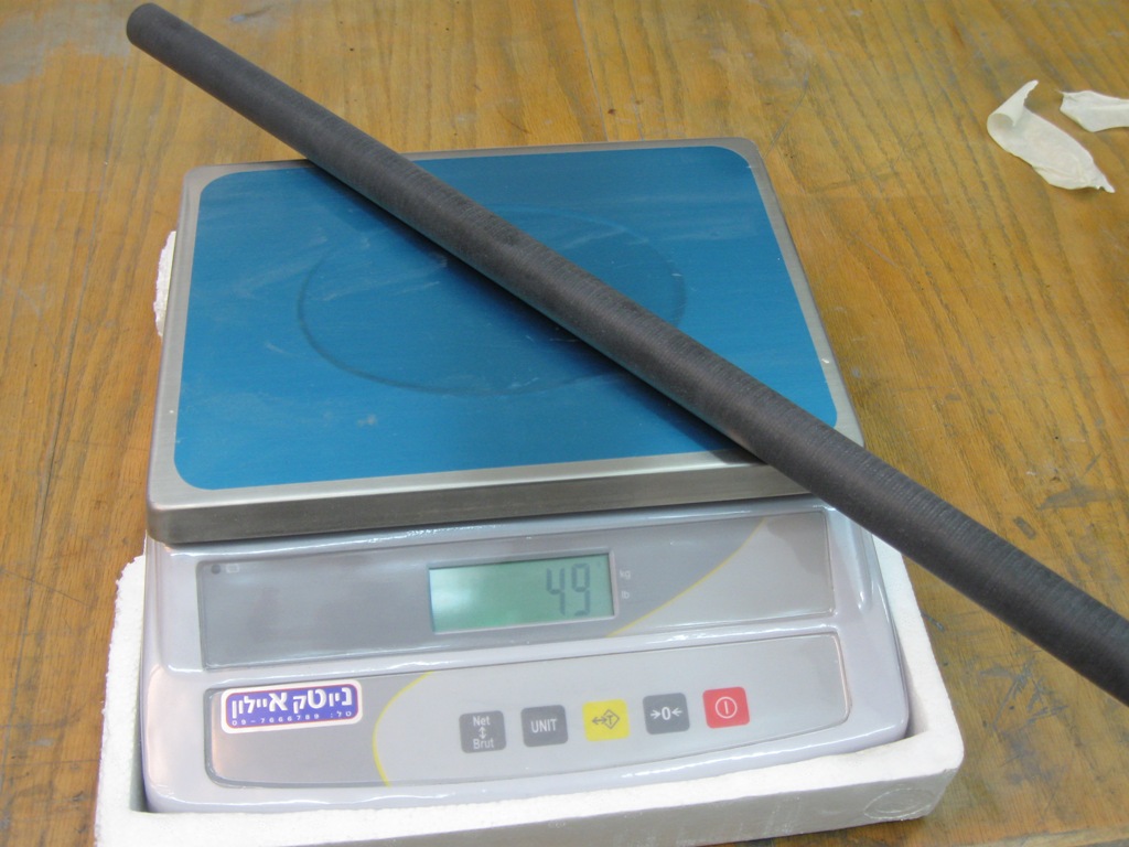

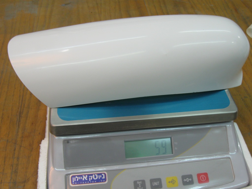

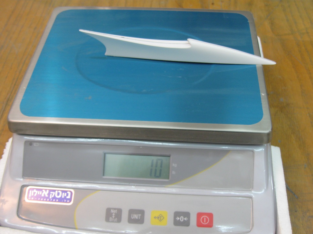

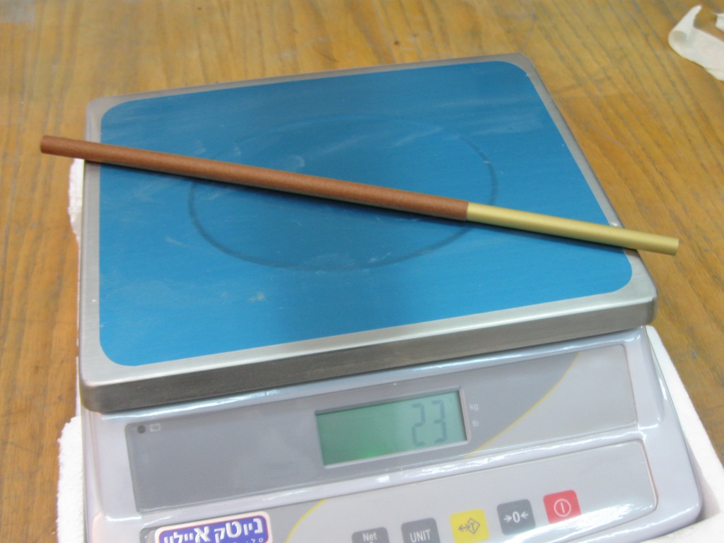

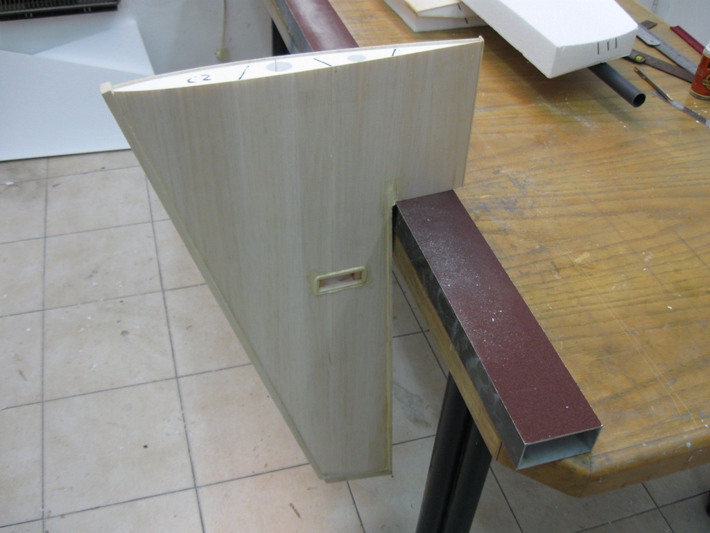

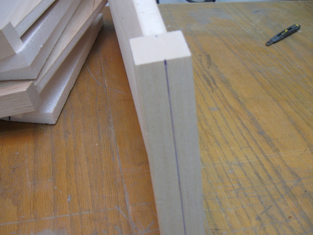

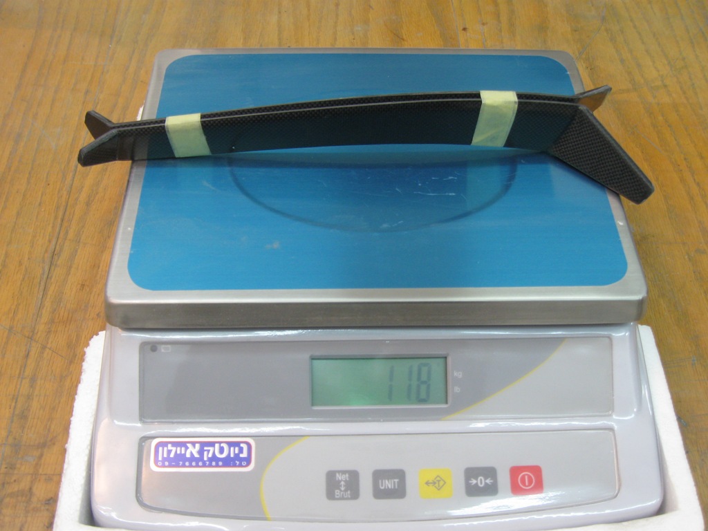

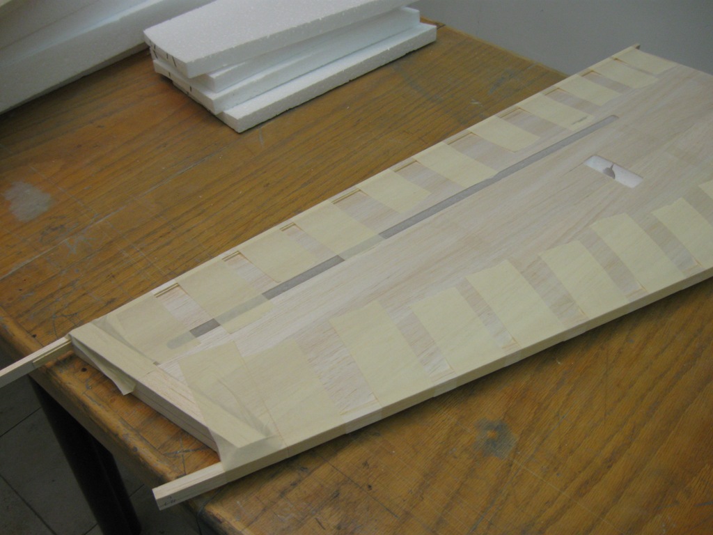

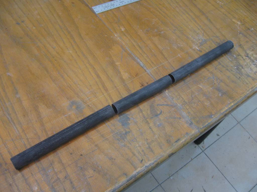

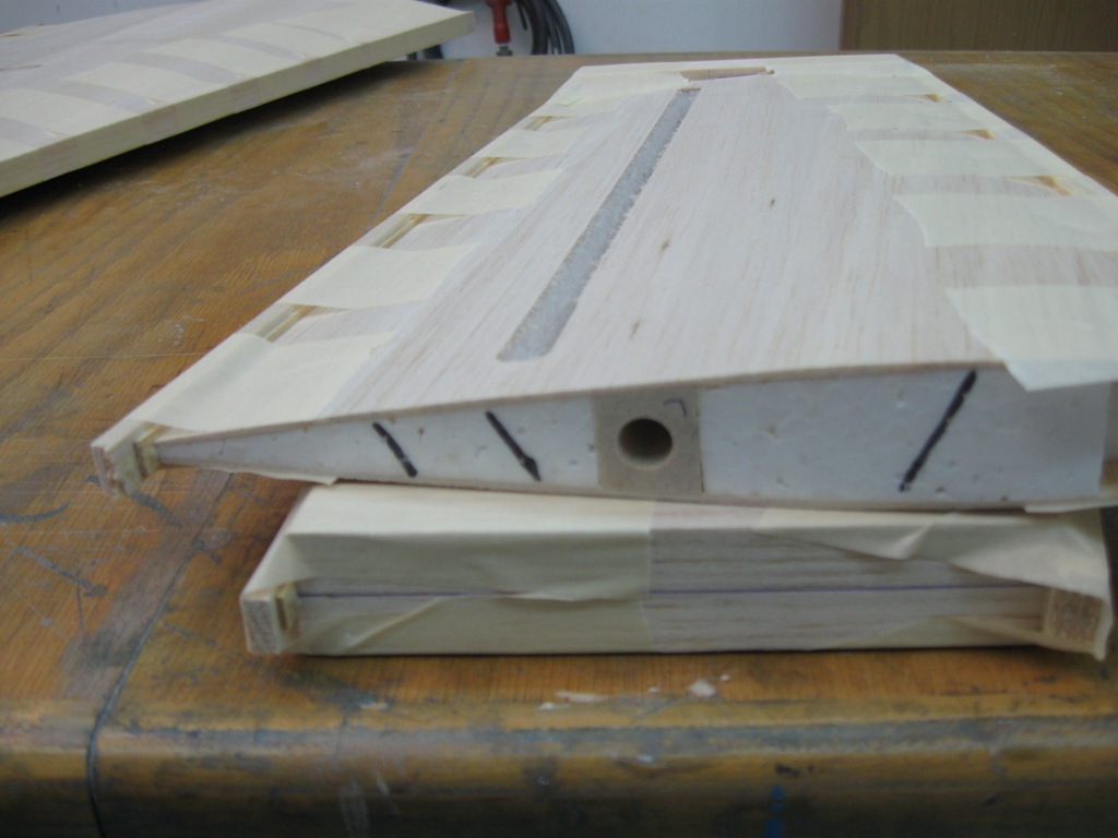

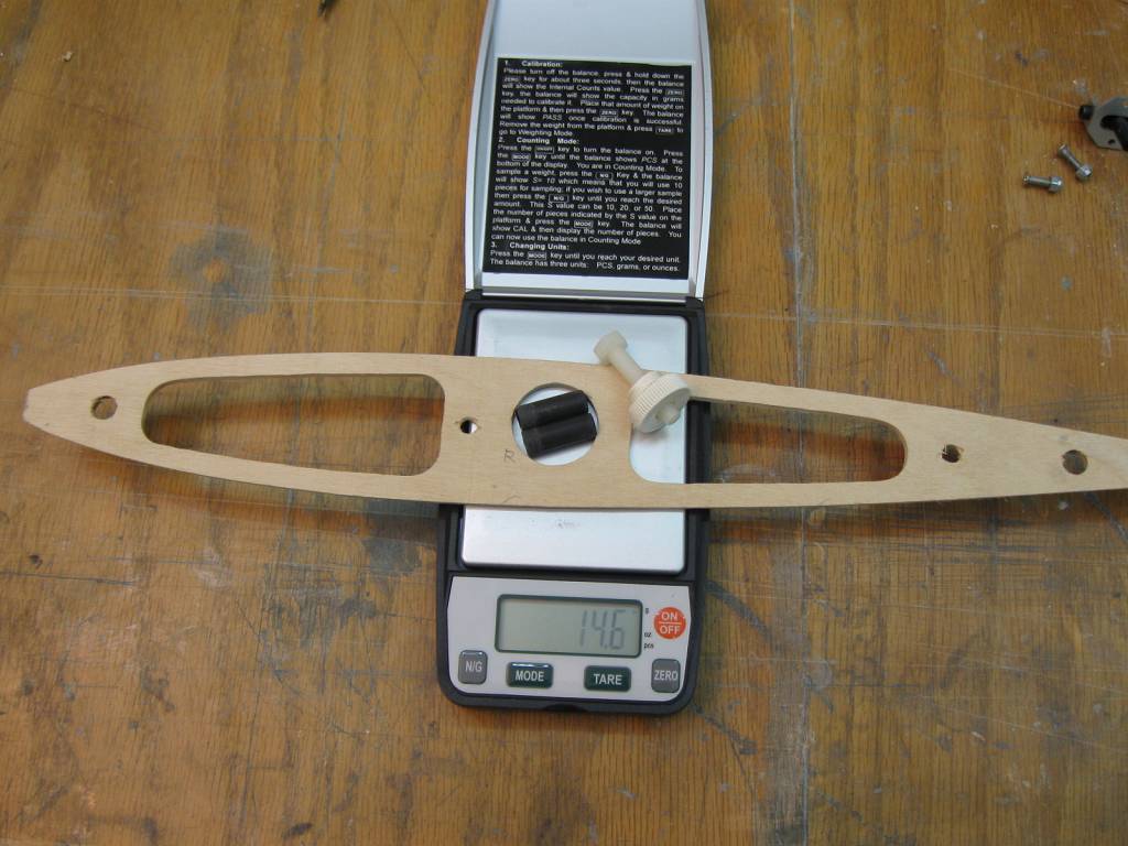

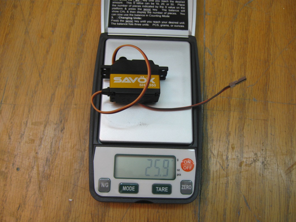

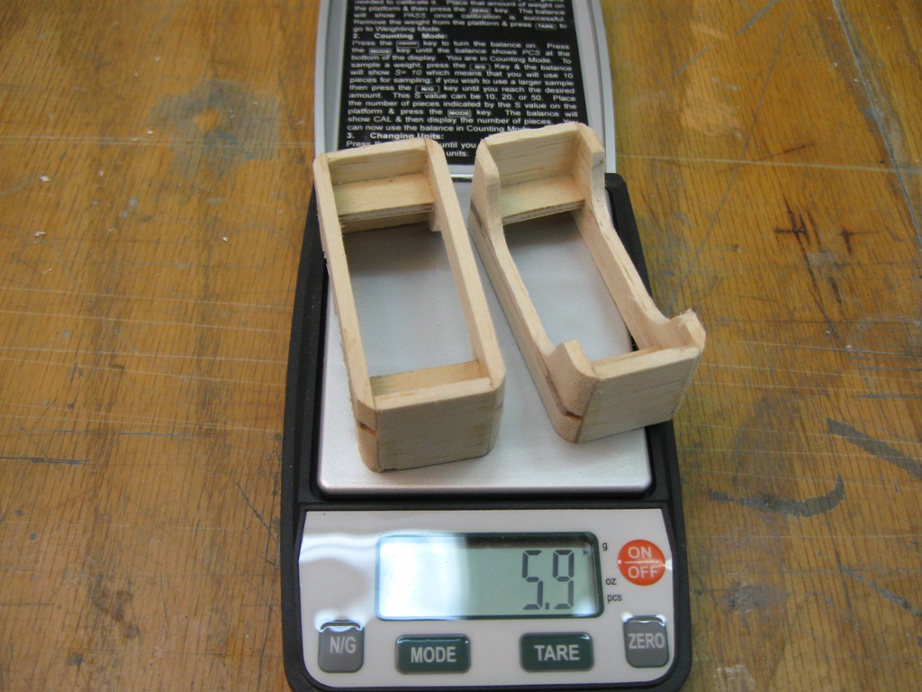

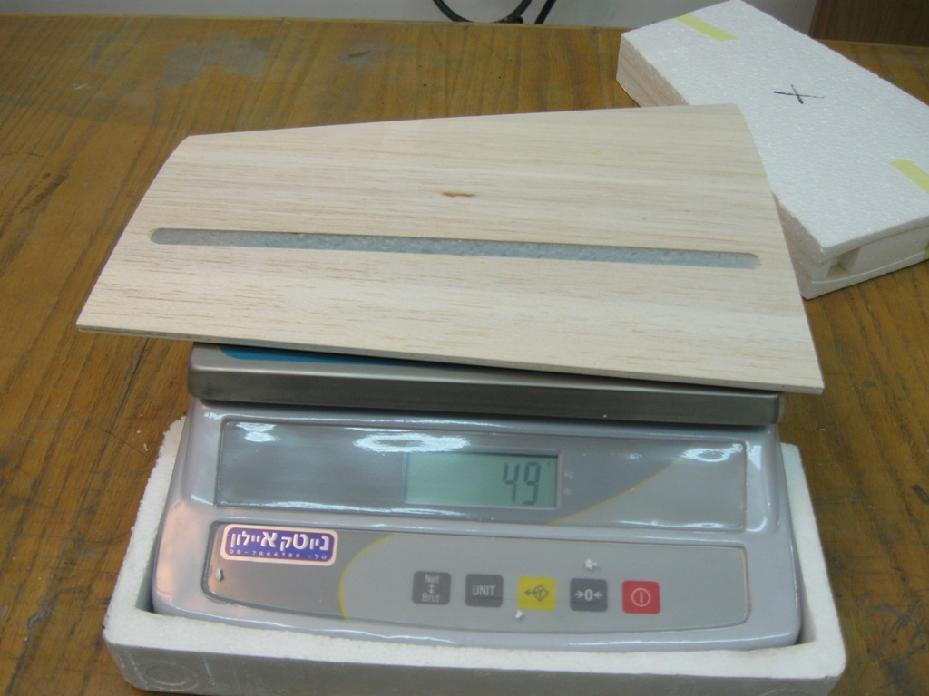

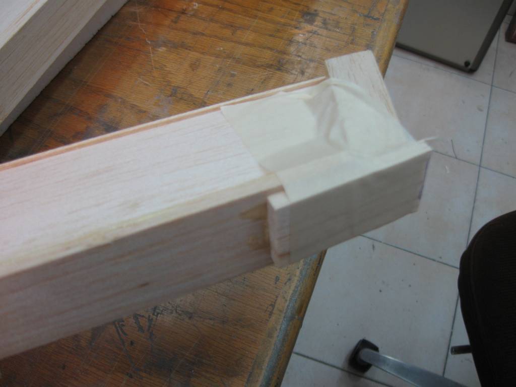

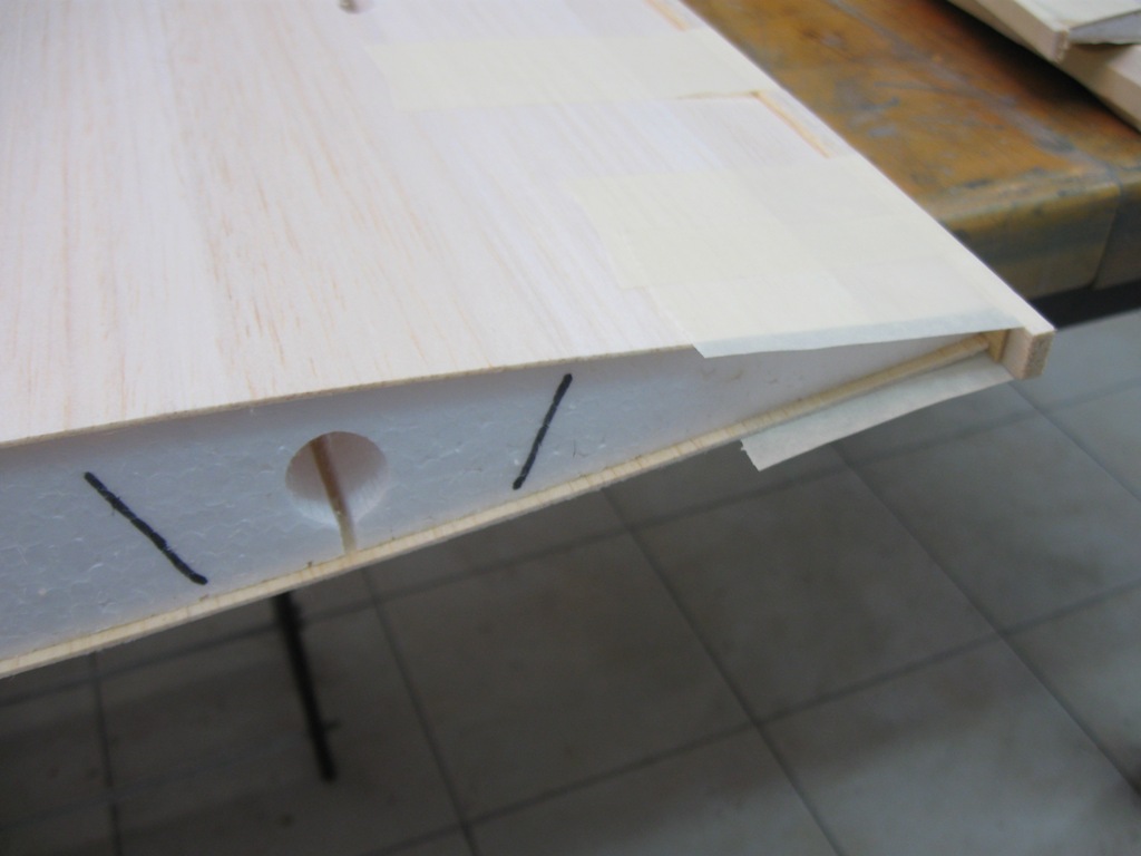

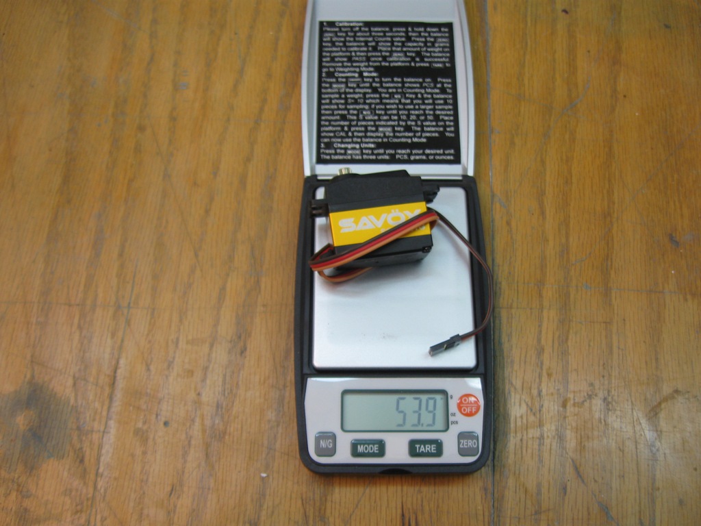

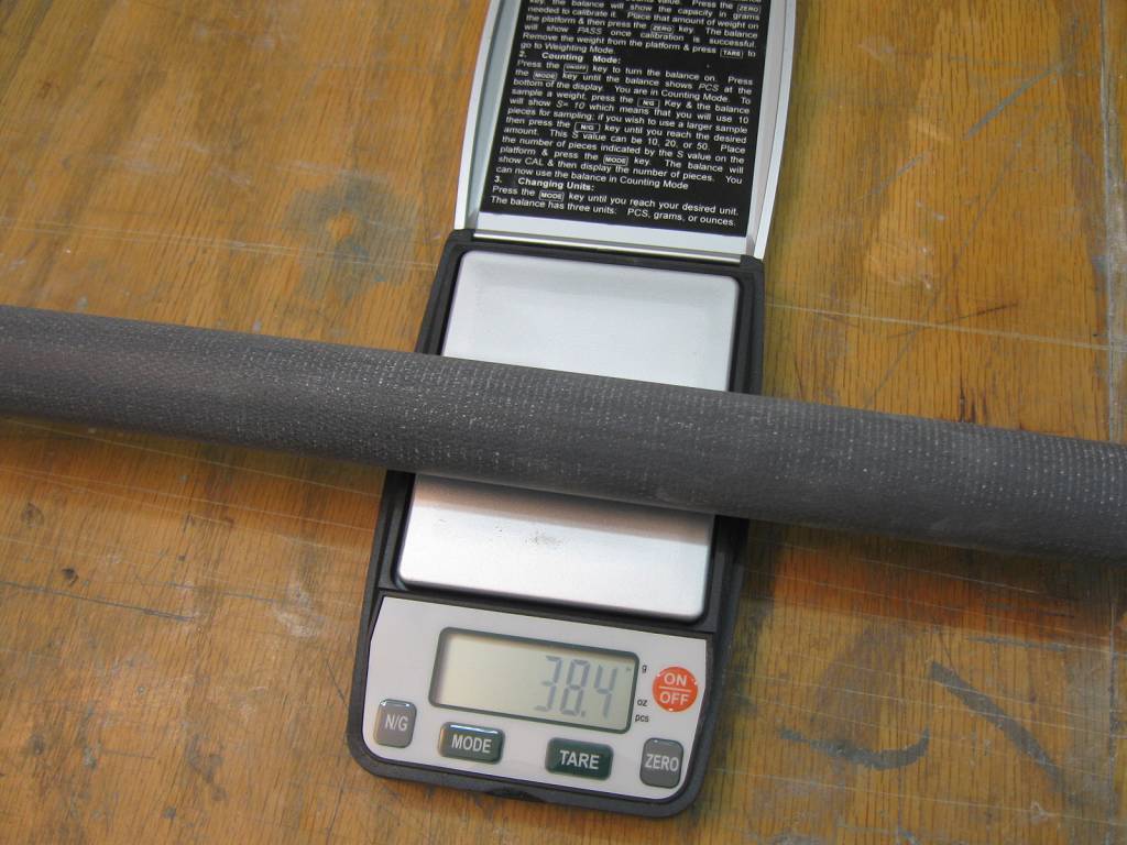

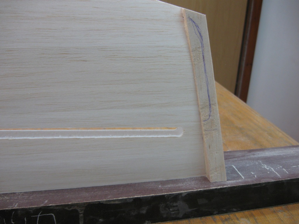

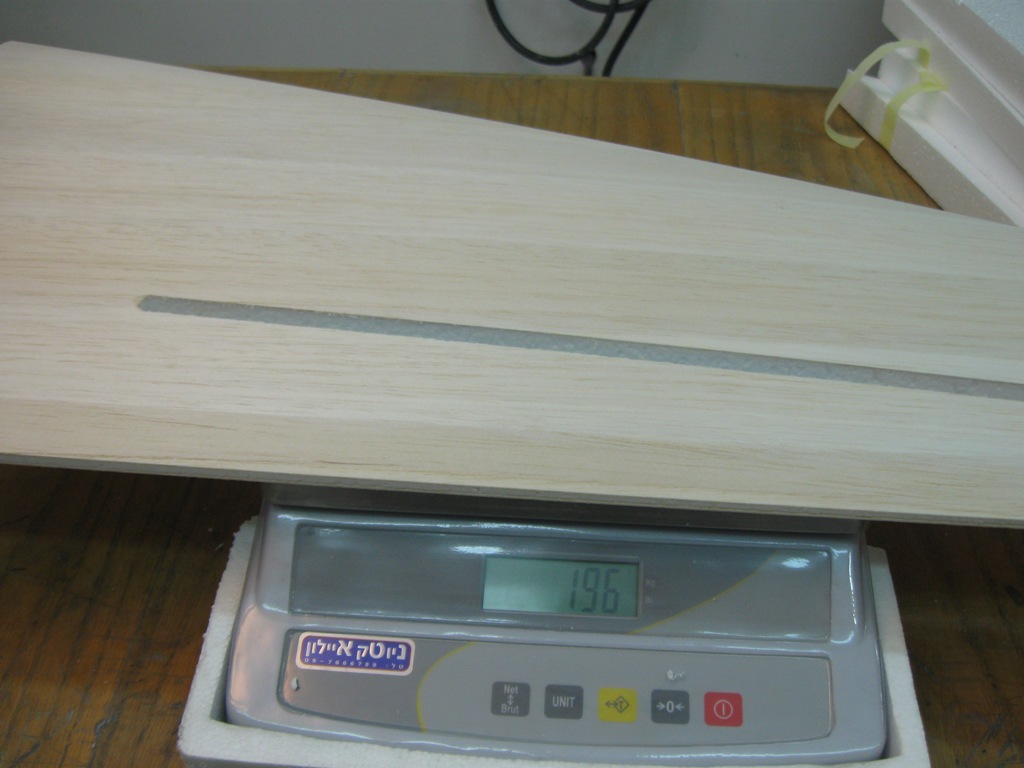

The first thing that I always do when starting a new project is weighing the kit parts.
Isaac Najary

Have a nice building! Is the fuselage made by Krill or ZN?
Savox servos for pattern...nice!

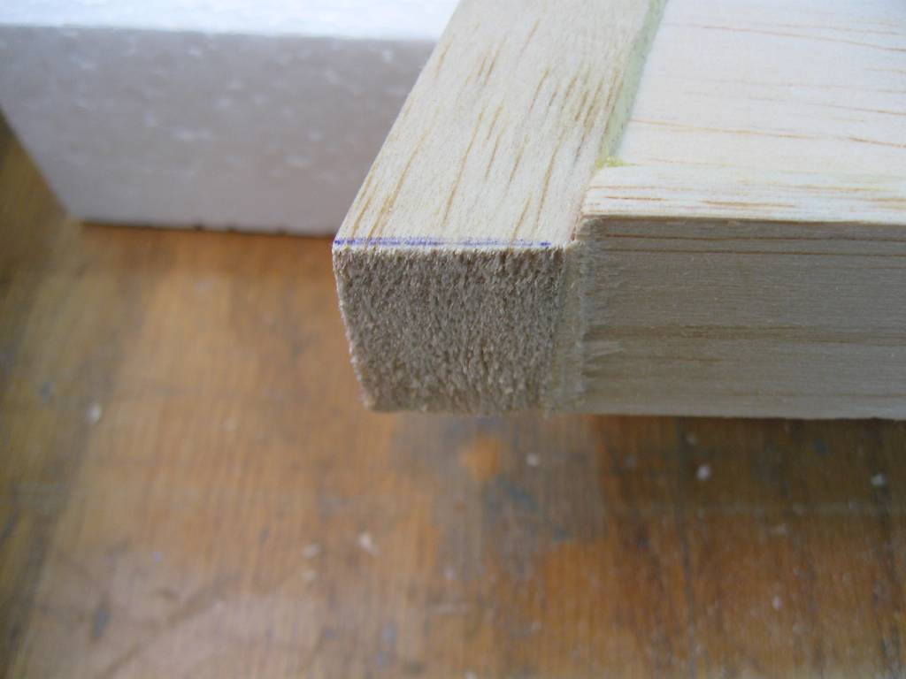

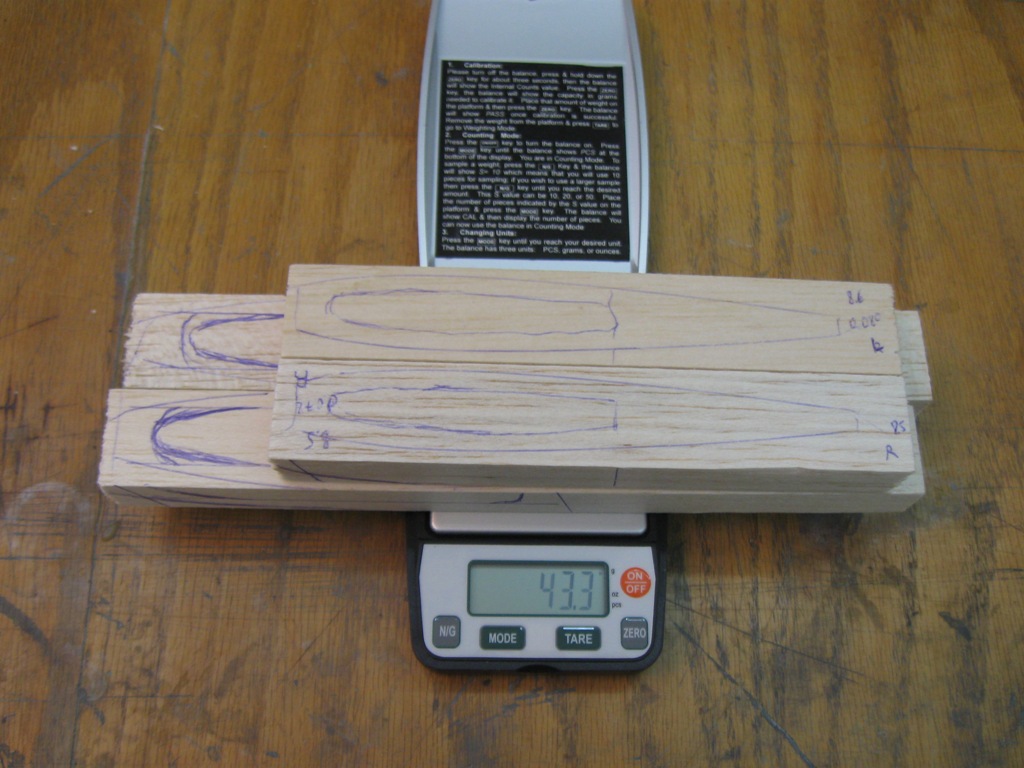

Default RE: Electric ZN Line Xigris C2 Build Thread

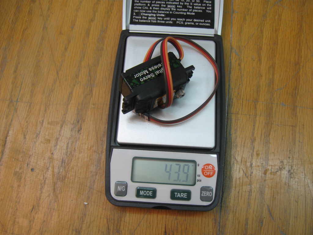

Saving 7.3 garm (43.3-36.0)
Isaac Najary

Hi David,
Before I decided to use the Savox servos, I made a long research for the best servo for each aplication.
Here enclosed comparison table.
My friend use the Savox servo for F3A with great success.
Isaac Najary

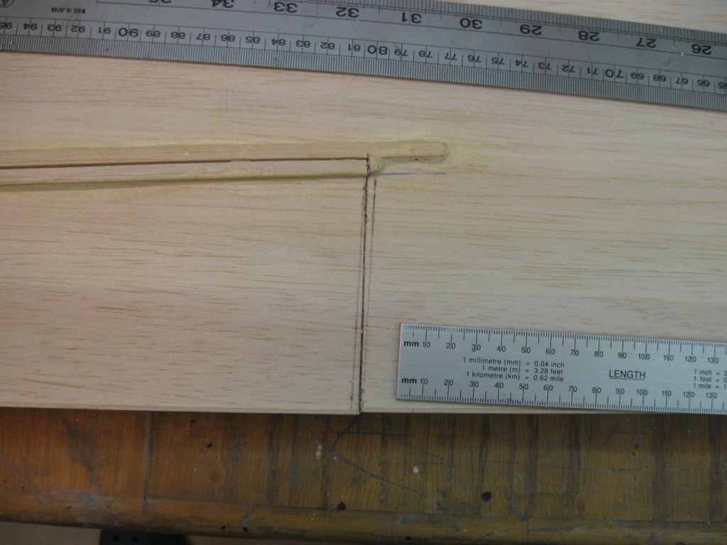

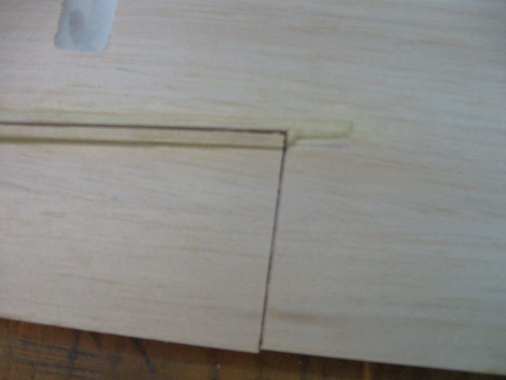

Hi all,
Here I made a mistake in the order which things have to be done !!! [sm=thumbs_down.gif]
I liked the idea of sharpening the ailerons hinges balsa when the ailerons are still connected to the wings, see Chad post no.5, http://www.rcuniverse.com/forum/m_8956458/tm.htm
As you can see in the pictures, I glued the hinges balsa in place, and I found that as a result, one of the ailerons was warped.[sm=thumbs_down.gif]
To solve the problem I had to cut the ailerons from the wings so the tension can be released.[sm=thumbs_up.gif]
Later, when I will work on the stabs, you will see the right order which things have to be done.
Regards,
Isaac Najary

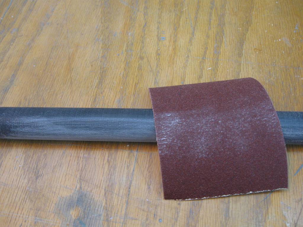

More
Saving 11.4 gram (49.8-38.4)

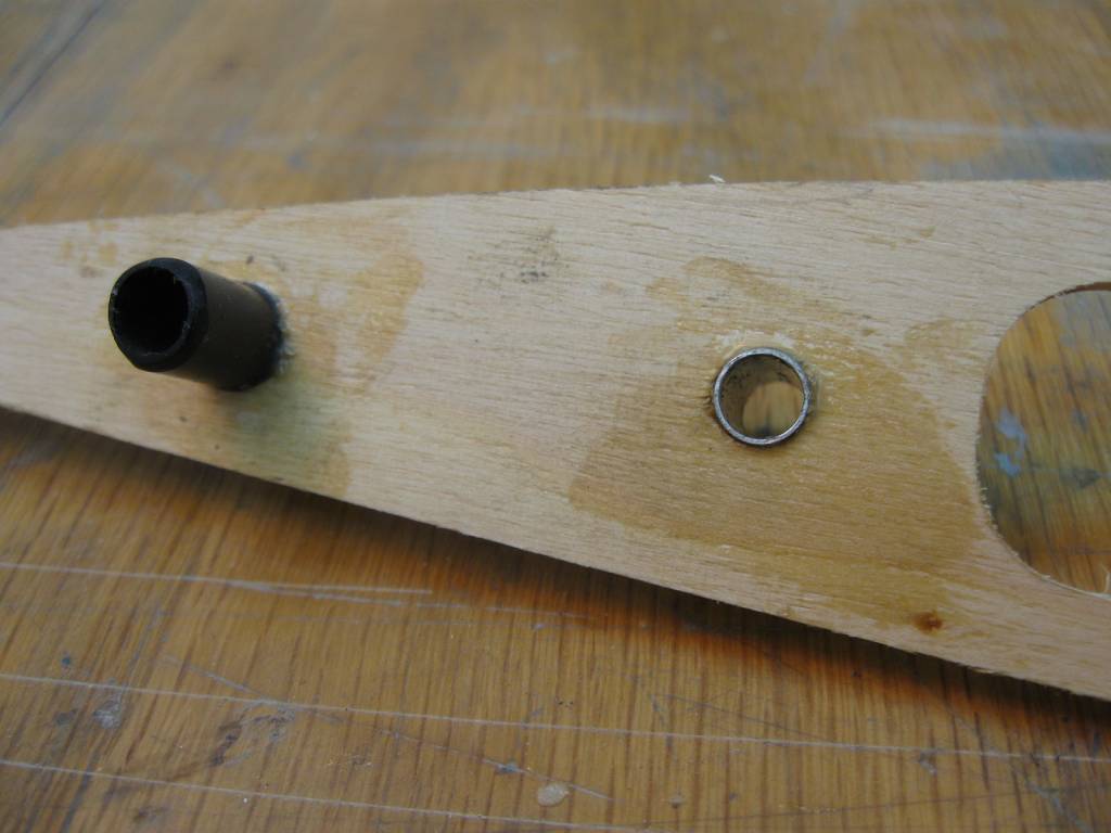

Saving 19 gram = (24.1X2)-(14.6X2)
The original method is: two bolts and wing incident adjusters = 48.2 gram (24.1X2)
My method is only one bolt in more comfortable place and two unrotate pins = 29.2 gram (14.6X2)
The wing incident adjusters will be remove after some flights, when I will be satisfy with the wings incident.
I will be able to reinstall the wing incident adjusters any time I want.
I use this method in my Osmose, and it works great.
Best regards,
Isaac Najary
