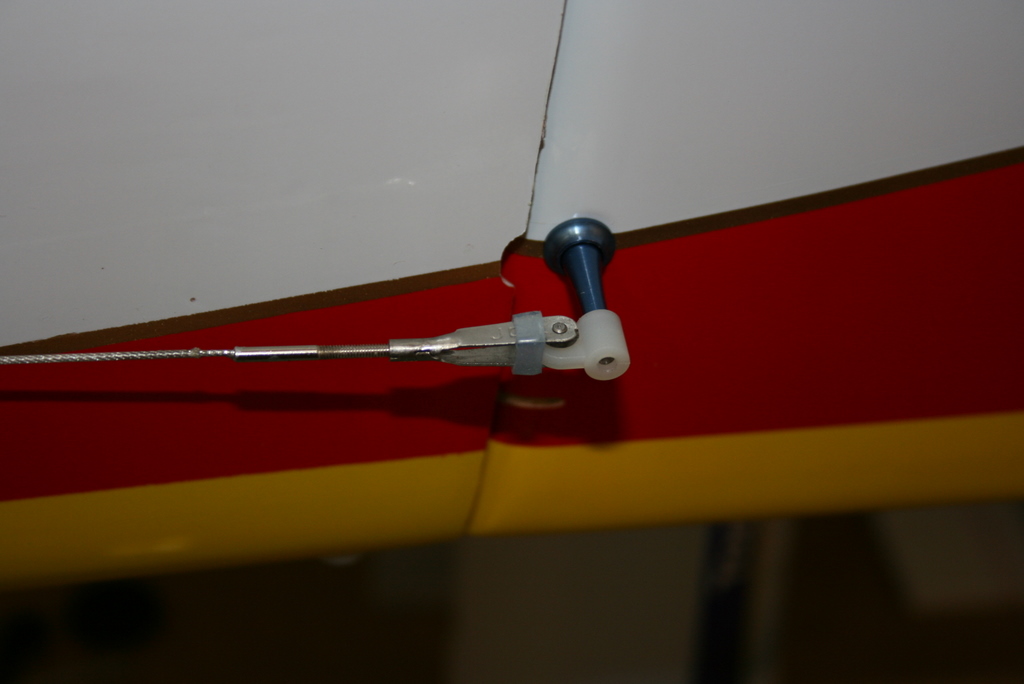

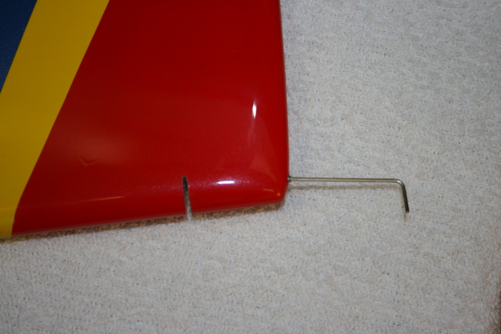

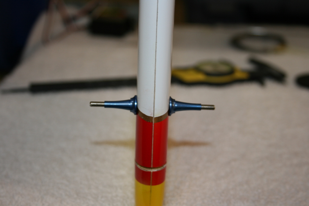

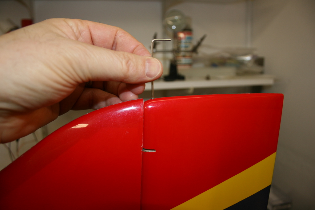

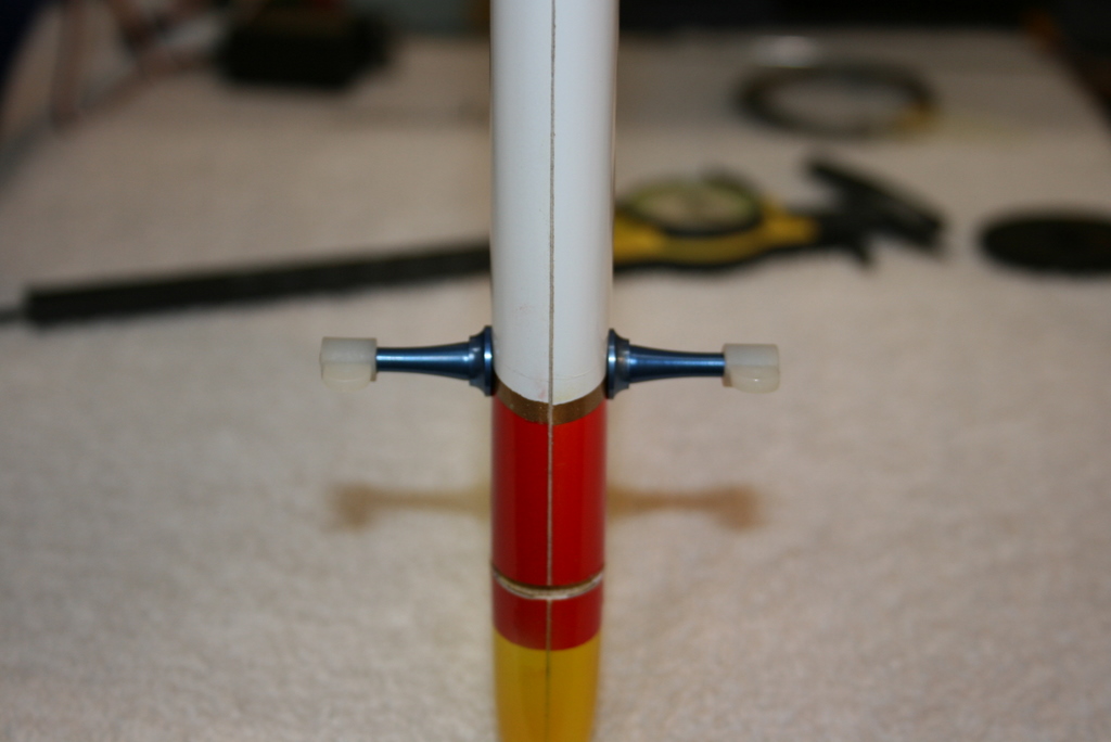

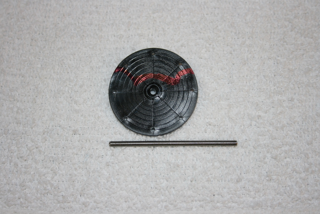

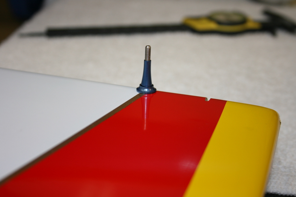

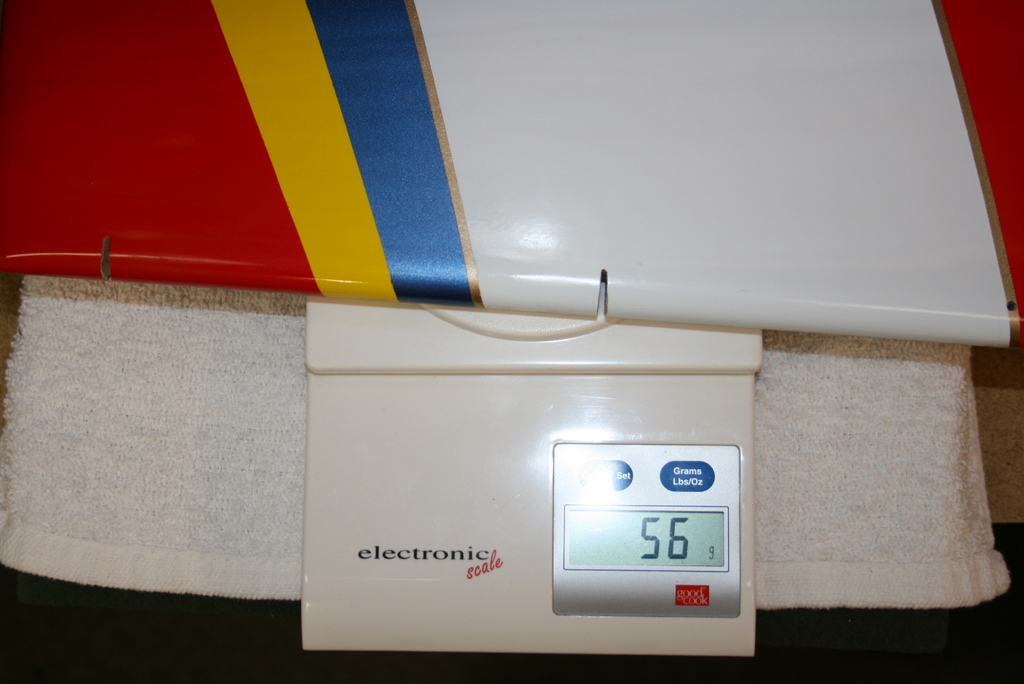

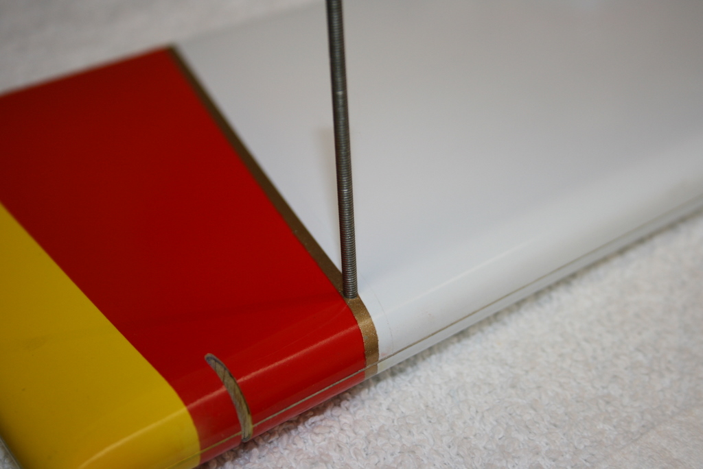

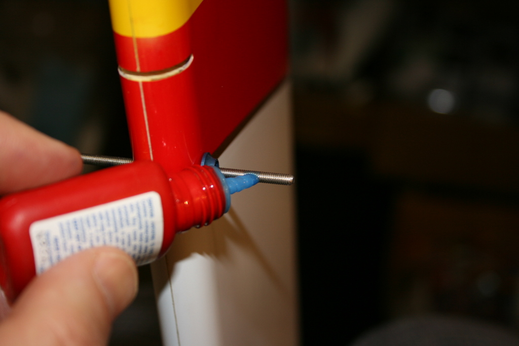

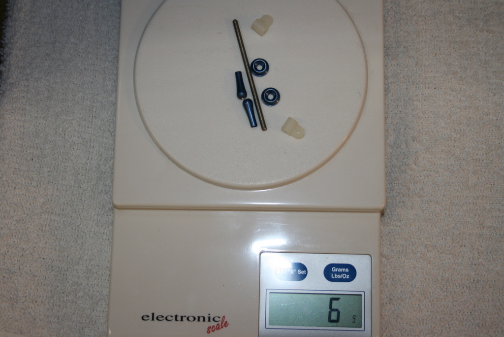

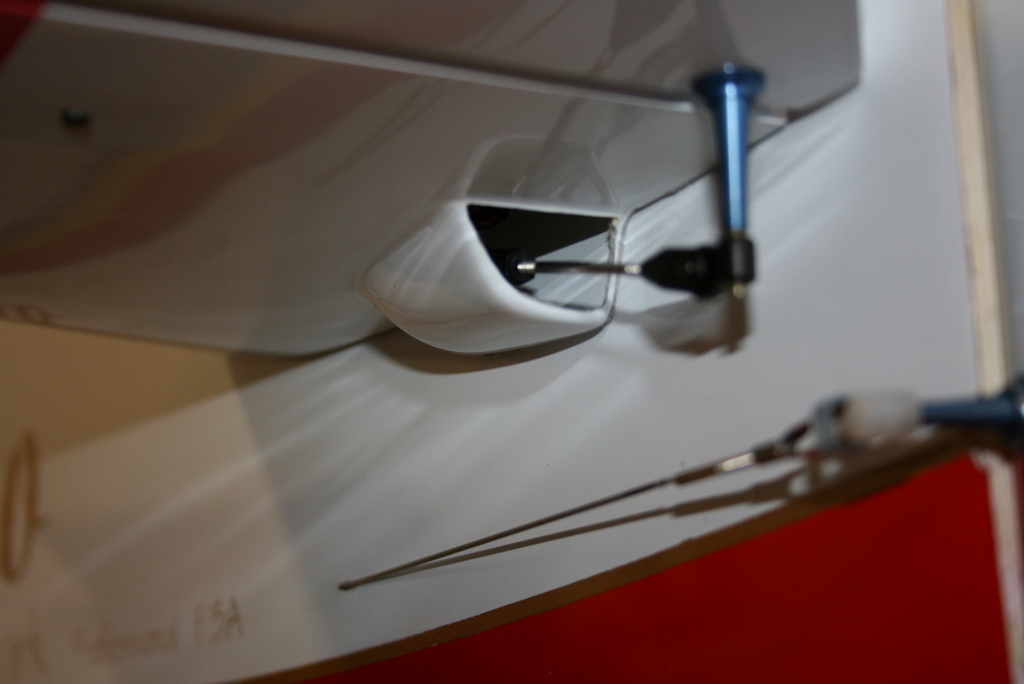

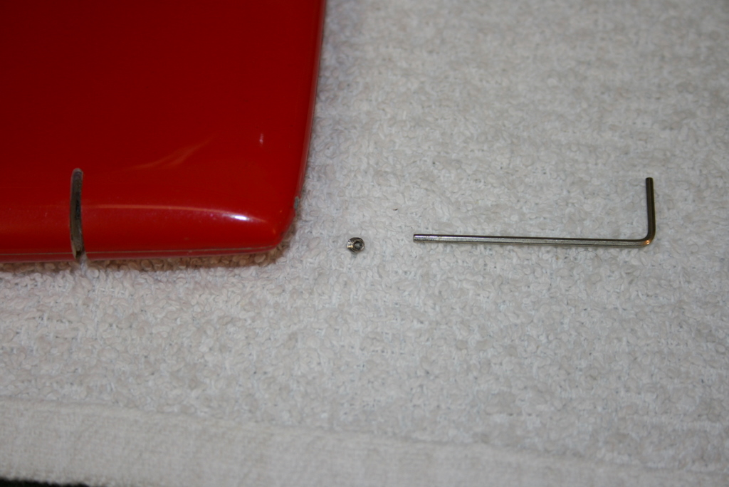

Continuing with the rudder installation, cabling and servo...
The weight of the rudder is 56g and the control horn and assorted fittings are 6g. The rudder cable and clevises are 10g. Since the rudder is removable there are 2 set screws that can be removed from the rudder - one on the top and one on the bottom. I removed the top set screw so that I could get the piano wire in from the top. I also threaded the rod through the rudder and mounted the fittings. I used Loctite to ensure that everything will stay together. The overall length of the control rod is much larger than the servo wheel that I will be using - at least by 15mm or so. All the fittings and horn ends were mounted.
Attached are the pictures...
1. Rudder weight
2. Rudder horn control rod and fittings weight
3. Rudder cable weight with clevises
4. Removing the set screw from the top of the rudder
5. Set screw
6. Screwing the rudder horn control rod into place
7. Rudder servo wheel and the control rod - you can see the increased length of the rod
8. Putting Loctite on the rod to hold the fittings in place
9. One fitting installed
10. Both fittings installed
11. Clevis connectors installed
12. Another view of the connectors in place

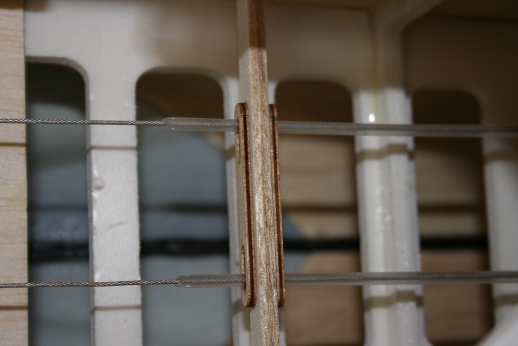

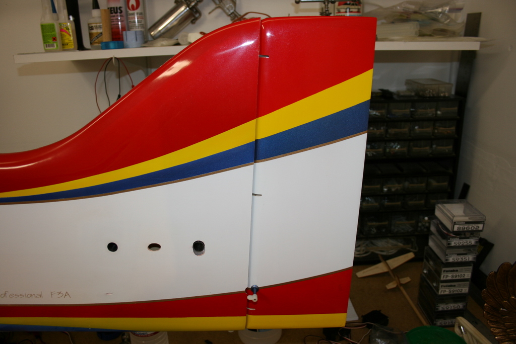

RE: e-Neptuno

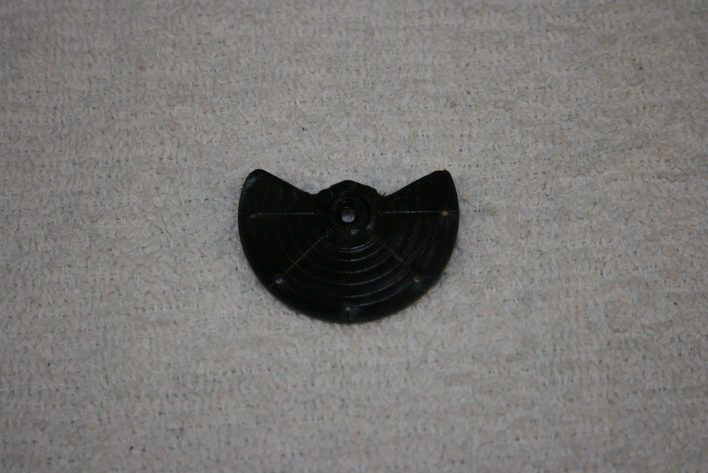

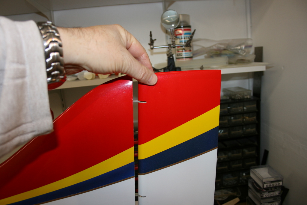

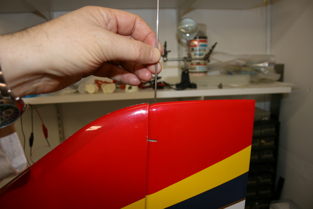

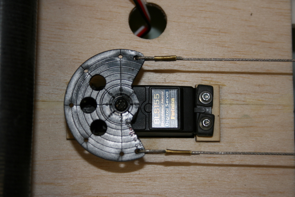

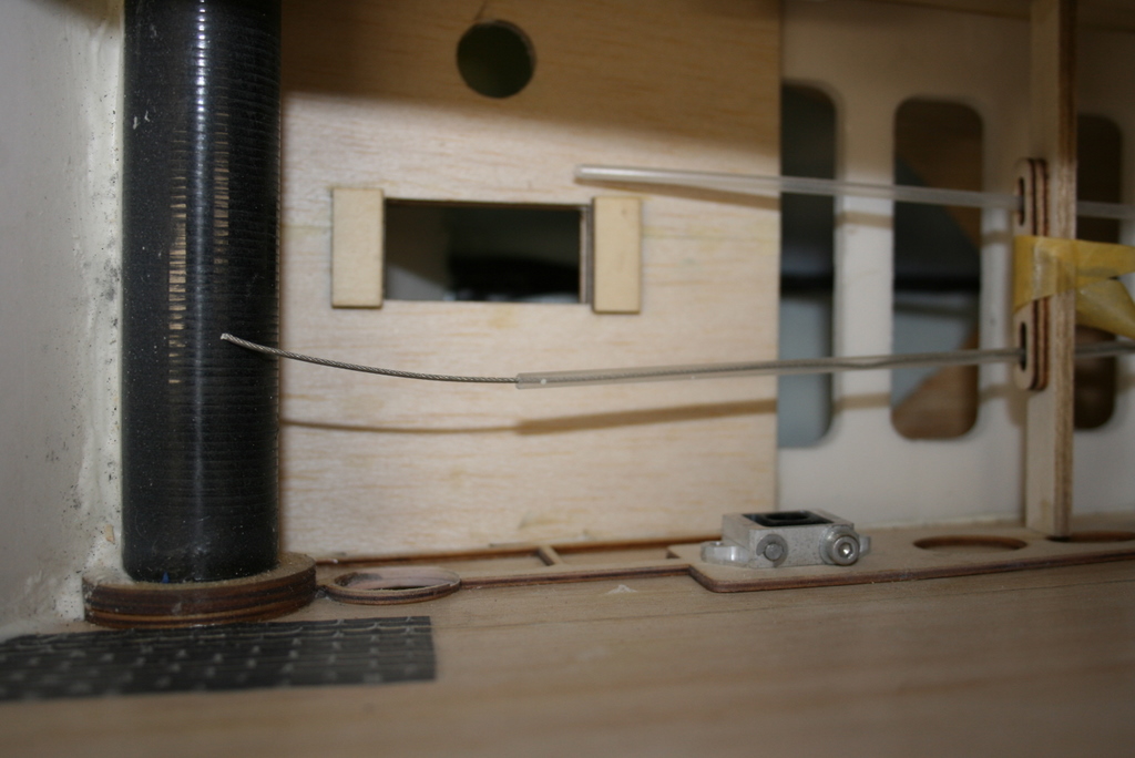

The next step is to mount the rudder to the hinges and to insert the piano wire from the top. Once the piano wire was in, I then screwed back in the set screw (with a little Loctite to hold it in place). Next came the rudder cable... I screwed on the plastic clevises and put a piece of fuel tubing on them to help keep the jaws closed. As you can see from the pictures the rudder cable (once cut in half) is just the right length. The next step was to mount the servo. I also cut the servo wheel to allow for an offset of about 6mm since the hinge point on the rudder is offset by a similar amount. I also drilled out the servo wheel to save some weight. The next step was to cut the rudder cable guides to the right length and then to connect the rudder cable through the rudder wheel and to crimp the ends. I used some brass tubing (from an old fuel tank) to put over the wires and a needle nose vice grip to crimp the brass tubing. After that it was just a matter of adjusting the clevises to tighten up the cables. As you can see I decided to replace the plastic clevises with metal ones - why? When I was tightening up the clevises the one clevis actually came off the cable ended (slipped off - perhaps wore out the threads).
Next is the tail wheel...
Pictures are as follows:
1. Mounting the rudder to the hinge points
2. Rudder mounted on the hinge points (just resting on them)
3. Slipping the piano wire down the rudder to connect the hinges to the internal rudder hinges
4. Putting the set screw back in
5. Connect the rudder clevises to the horn
6. Loose rudder cable in the fuselage coming out of the cable guides
7. Dropping the rudder servo into place
8. Rudder servo wheel after being cut
9. Clevis now being tightened - as you can see I've now switched over the metal clevis and put a piece of fuel tubing in place to keep them closed
10. Servo wheel showing the cable ends that have been crimped
11. Cable guides that have been trimmed

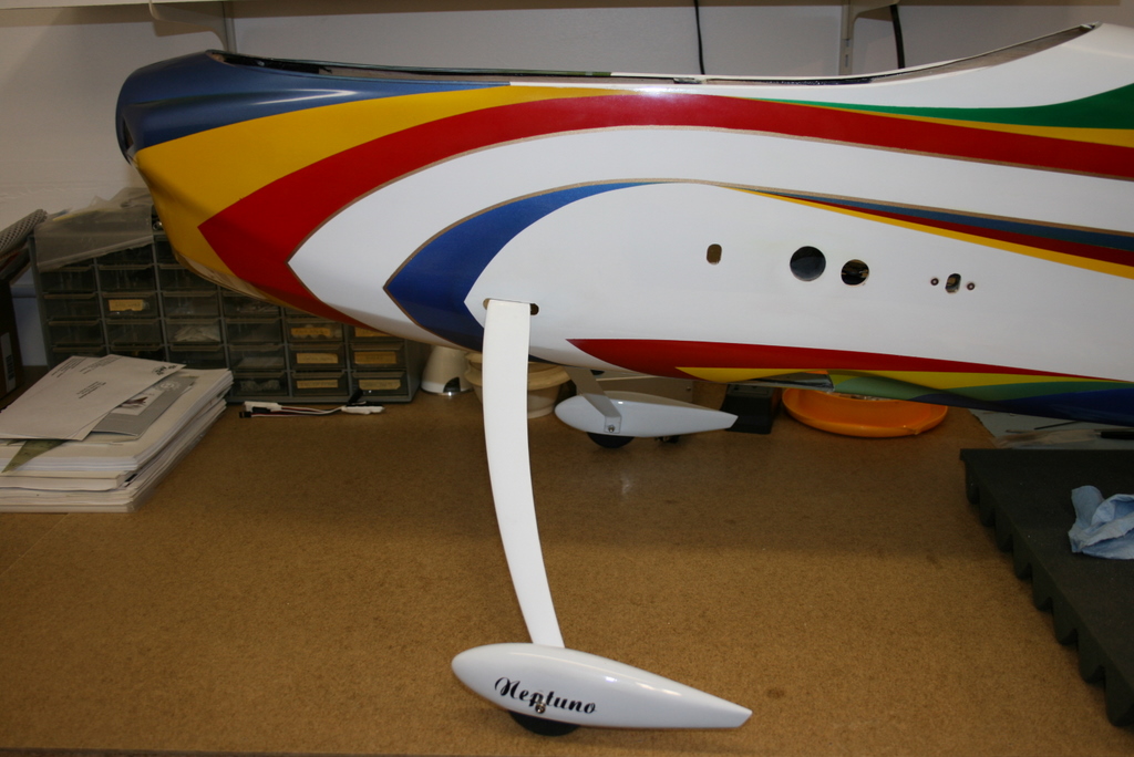

Ok, now where was I? Oh yes... installing the tail wheel, stabs, aileron servos and landing gear. Sorry about not posting for a week or so... but I just got busy in the evening and couldn't find the time to get up here and post. I've actually finished up the EP plane except for the motor and battery tray since I'm just waiting for my motor to arrive.
So here we go...
Installing the tail wheel is a snap... as you can see from the picture the tail wheel post is actually threaded and so it screws into the tail wheel post which is pre-threaded. It's just a matter of taking the tail wheel and turning it until it is almost locked and then connecting up the spring and attaching it to the tail wheel and to a screw that is screwed into the rudder. Next are the stabs - mounting them. I ran extensions down the plastic tube by taking a thin nyrod and feeding it through the hole in the tail toward the front. I used tape to attach the one end of the extension to the rod and then fed the rod through which dragged the extension. I also taped the other elevator extension to the 1st extension about 4" from the top and continued to pull the extensions through until both ends came out the front of the tube. Then I slipped the stab halves together and connected up the elevator servos to the extension leads and tied them together with dental floss to prevent them pulling apart accidentally. Once the stabs were full installed I screwed the bolts into the stab to connect to the stab tubes and to hold the stabs on... done.
Here are some pictures:
1. Tail wheel on the scale
2. Tail wheel mounted
3. The stab end of the elevator extension
4. Both servo extensions coming out of the tube
5. Stab half mounted
6. Underside of the stab half

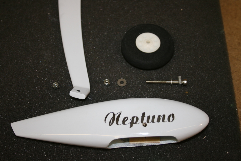

Next is the gear...
Remember all the hardware is supplied. The only change/addition I made was to use a square nut as a spacer in the axle. You'll be able to see this in the pictures. I also lined the wheel pants with a rectangular piece of 1/32nd lite ply to give them some firmness where the axle passes through to ensure that the axle hole doesn't get worn out (bigger) on the fiberglass/carbon cloth. Getting the wheel pants and wheels mounted was a quick and easy process. The longest part was waiting for the Gorilla glue to dry on the lite ply pieces. Next is top bolt the landing gear to the landing gear plate. Everything is pre-drilled so there is no measuring of where the bolts go. Just put the bolts in the washers and then put a little Loctite on away you go...
As you can see from the pictures, everything comes out nice and clean.
1. All the parts for each wheel pant/wheel assembly
2. Completed assembly
3. Axle attached to the strut
4. Inside of assembly - you can see the additional square nut I used on the right hand side of the axle
5. Gear bolts and washers
6. A little dab of Loctite
7. Mounted gear - outside
8. Gear plate and bolts mounted

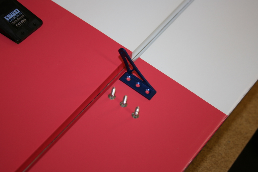

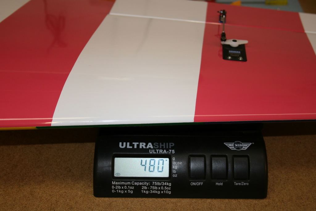

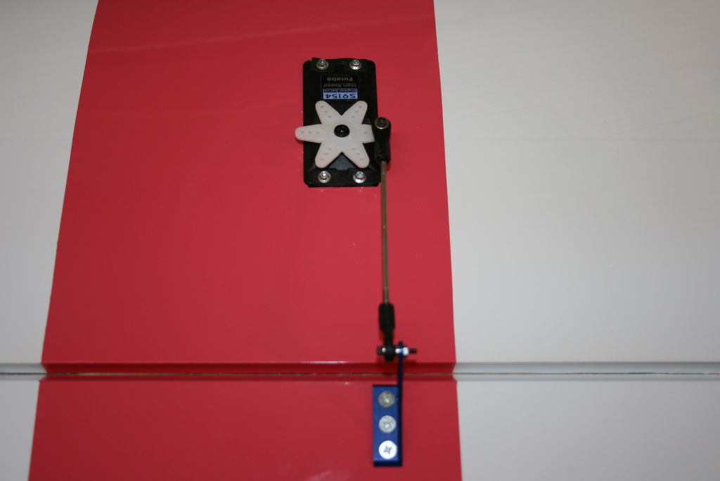

Wings/servos are next...
The aileron servo cutouts are precut for the Futaba 9154 servo... just drop them in after putting a 6" extension on the servo lead (and tying it with dental floss to secure the connectors)... secure them with servo screws and we're ready to install the aileron horn. As you can see the aileron horn comes with the screws. It was just a matter of lining it up with the servo horn and then drilling pilot hole for the screws and then screwing them in. After this came the aileron rod that connects the horn with the servo arm. The rod and connectors are all supplied so its just a matter of screwing the connectors on until they are the correct length and then bolting them to the horn and the arm on the servo. Quick and easy. Aileron connectors and mounting the servos took about 30 minutes total.
Pictures follow:
1. Servo horn and screws
2. Servo mounted
3. Lining up the horn with the arm
4. Horn is mounted
5. Servo rod in place
6. Another shot of the rod
7. Completed weight of the left wing
8. Completed weight of the right wing
As you can see I added 65g on the left wing and 70 grams on the right wing. I'm not sure why one wing was different to the other - perhaps the scale was settling.

I got mine today.. That was really fast! 3 weeks with custom color canopy, and custom aileron servo hole sizing...
Weights
Fuse 966
Rudder 58
L Stab w tubes 149
R Stab 125
L Wing w bolts 417
R Wing w bolts 423
Wheel pants 31
Gear w blind nuts preinstalled 108
The rest is the same as Derek.
DHL was not kind to the box by far, but it survived! What Derek hasn't said about this plane I think, is that the fuse is pretty tall. Cool looking plane.
Back to the garage!
Chris
