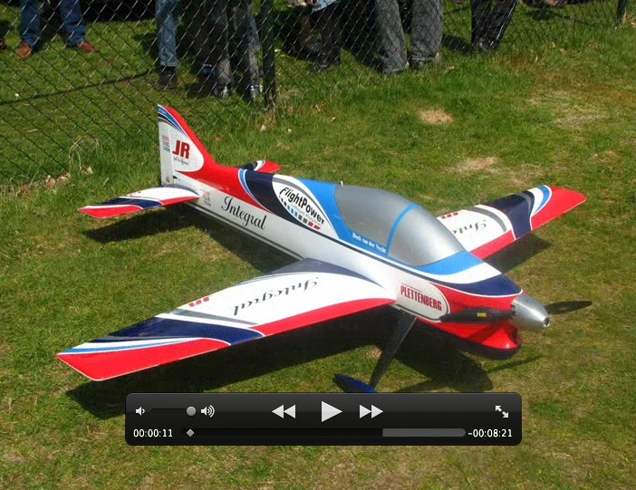

    The Plettenberg nose exists. Anyone in the US tried it?
    So watching the Wind 110 video I was shocked to see a setup that I asked about last year. It strikes me as an incredibly simple way to mount a motor and prop hence my interest.
    So has anyone in the US tried one of these?

    Its more popular in Europe than over here. I have this system on a 50cc model with the Terminator 30-8, its great for cooling! You have to watch because its a longer setup than a conventional spinner so if your fuselage is close to 2m, the extra spinner length could be a problem.
    If you want to use the vector steering (thrust vectoring) then you have to use this setup.

    I fly with the Pletty in the spinner and sofar it has been faultless. Length, as Chad mentions, can be an issue. Also, the nose section has to be strong enough to take this solution. Other then that, I find the concept of having the blades mounted on the engine iso outside the engine, in combination with the folding blades technically a very nice solution which must reduce stress on both the motor (axis) and the airframe. That is also why I decided to take this road, to try. Sofar (200 flights) it works.

    I do not steer with it only adjust the sidethrust. Thats allowed I think.
