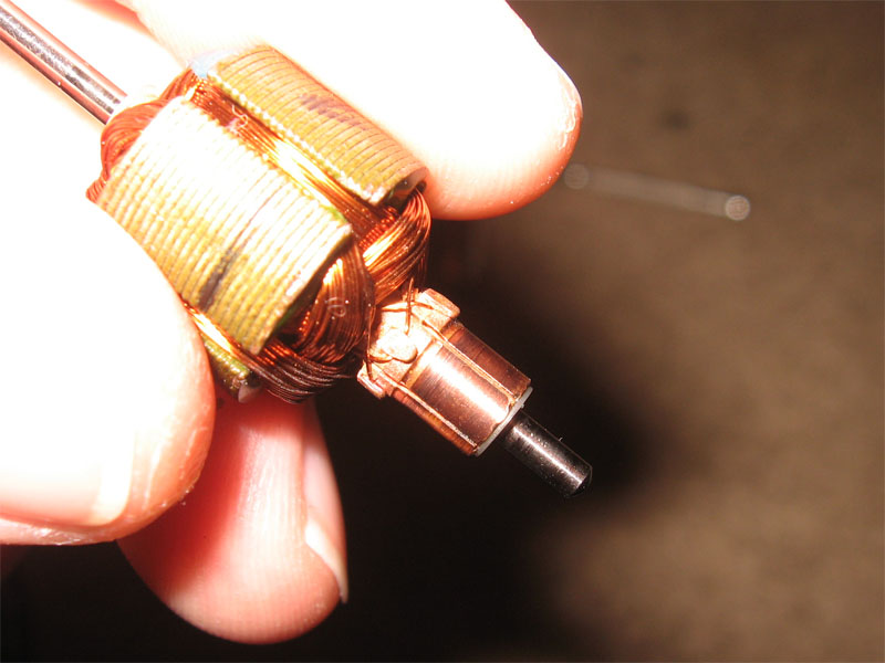

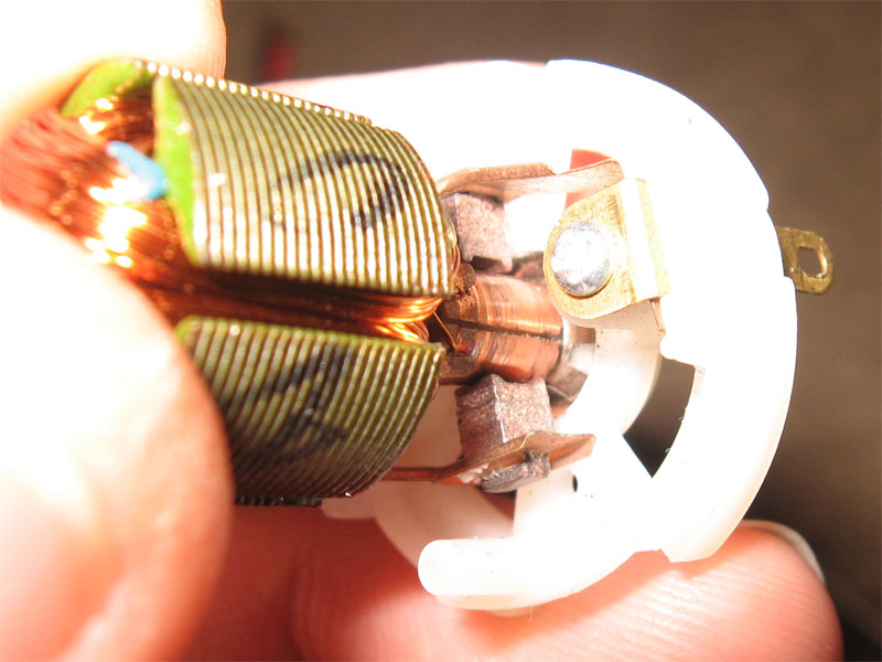

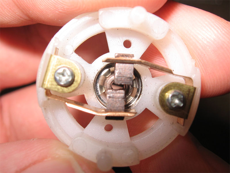

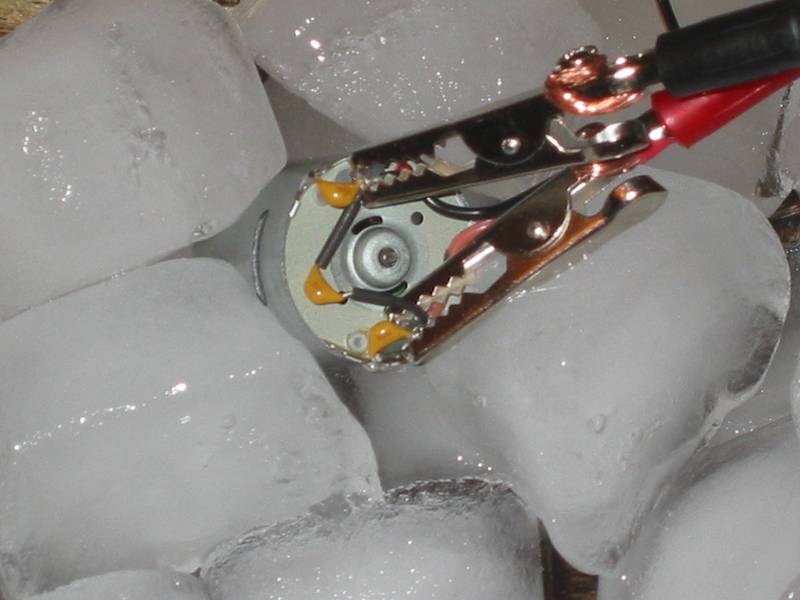

So what is a break-in process anyway?
Looking at the pictures you can see there are brushes (they aren’t really brushes, but actually just carbon blocks), and a commutator. Basically, what we want to do is take the square shape of the brushes and wear it into the round shape of the commutator under a low-voltage, no-load situation. It should also be noted that brushless motors do not really require a break-in because they do not have brushes, and instead work on FM (frequency modulation, a type of a/c power), and brushed motors work on current regulation through voltage (current is directly correlated with voltage, if the resistance stays the same, and the voltage goes up, then the current will go up also). Also some of the high performance RC brushes (like in buggies, cars and trucks) have serrated edges, which are supposed to either reduce or completely eliminate break-in.
How does it help?
What this does is allow the brush to more fully contact the commutator over a wider area (effectively reducing motor resistance consequently increasing motor power), which reduces the amount of electricity that flows through a given piece of the brush. This in turn reduces resistance and arcing between the bushes and the commutator (as the current is transferred to the commutator over a wider contact point), which also alleviates the microscopic pitting, excessive carbon soot buildup, and excessive heat build up. All of this in turn makes the motor last longer, be more reliable, and draw current more predictably and run more efficient (see note at the end), which results in better and longer battery life.
The carbon soot is non conductive, and adds resistance to a motor, which causes it to heat more (where the resistance is, which can cause the brushes to fuse to the commutator), and loose power (because energy is being wasted in resistance (in the form of heat) before it ever even gets to the motor windings). This carbon buildup can also cause shorter flight times, and in more rare, but more serious cases can cause damage/burn-out to your ESC (3 or 4 in 1) by causing current spikes, and it could also damage batteries with the extra current in certain more unlikely situations.
The arcing in the motor over a smaller surface area, such as using a motor that has not been broken in, causes more electricity in a smaller area of the brush, which causes more heat in that particular area, which basically burns the carbon brushes creating the high resistance carbon soot, and also creates microscopic pits in the commutator and brush where the electricity arced from and to. This basically creates microscopic sand paper that also contributes to the early demise of the motor. This is a double drawback because it consumes the brushes faster, and causes pitting and carbon buildup which reduces the power of the motor, the battery life, and causes excessive heating in the motor which can fuse the brushes to the commutator.

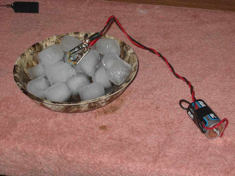

The reason ice can be used is to keep the motor cool during break-in. Most of the time though, in my experience, if you run a motor at 1/3 it’s rated voltage with no load, it will probably not produce enough heat to really even notice, but if you run it at higher voltages it can be useful. If you would like to use this method just make sure to clean the water from the melted ice off of the motor, and out of the inside if any got in there. If you are concerned about motor temps, you can also break-in with your heat-sinks in place.
Alternately you can use a fan to cool off the motor. Try to prop up the motor so the metal isn’t resting on much (like a paper clip stand or a heat-sink or something) and put it in the air flow of the fan so in a way so that the most area you can is exposed to the moving air. This is usually an end on position to the fan, 90 degree’s to the air flow.

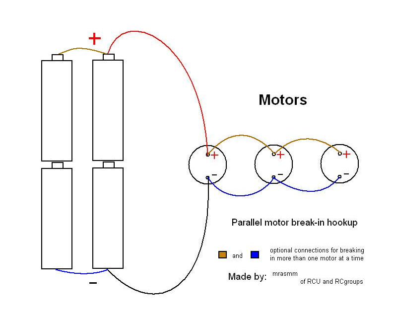

The Break-in Process
Basically what you want to do is take 2 new AA’s for 2 or 3s lipo’s, and 6 to 8 cell NiMH’s and NiCD’s, or 1 new AA for anything smaller. If you have two or more batteries, take them and tape them together so that the + button from one battery contacts the – plate of the other battery. Take two leads and solder them (or some other kind of electrical connection), one to each of the poles on the motors. Make sure the wires can handle the load of the motor. Most motors have a 1 ohm winding on the low end. This means on the high end they will take max 1A for every volt. So 2 AA’s would be 3A max, 1 AA would be 1.5 A max ect. Then test the leads by hooking them to the batteries. If you are picky, note which way the motor is spinning, and note which way it will spin in your RC. If they are the same go ahead and tape the leads. If they are different just swap the leads and then tape them. Let them run as long as you can wait (or until the batteries go dead), but an hour is probably the min recommended. You can also break your motors in with the heat-sinks on them if you would like them to run cooler.
One small note. If you are running small motors like the n20’s or the n30’s used on the tail rotors of 300 sized heli’s, if you run the AA’s till they are dead, it will take about 85 hours. So instead just run them for about 90 min.
If you want to break them in water or alcohol, just follow the above steps; then place only the motor in the liquid (keep the batteries or other power source out). When the hour is up, or the batteries are dead take the motor out of the liquid and blow out all of the liquid that you can on the inside, usually with compressed air, but don’t take the motor apart or otherwise the brushes likely wont seat the same way when you put it back together, and you’ll have to break it in again. Make sure to oil the motor back up. Only get the motor where the shaft touches the bushings or bearings, and use a light sewing machine type oil like 3 in 1. Don’t use WD-40 or anything similar because they are penetrating oils that are supposed to be used for loosening rusty bolts, and the oil just flips off at rpm’s, and can cause extra resistance by getting oil on the commutator (loss of performance). All-in-all these oils are really not made to lube.

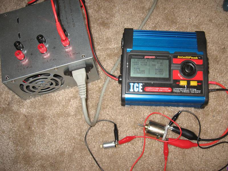

The other option you can do is use a motor break-in device, such as the Intellepeak Ice. To do this you simply go to the motor break-in menu set the volts and the time. What I usually do is start out with low voltage and run that for a while and then step up until I get to the regular break-in voltage. Such as starting at 1.0v or 1.5v running for 30 min, then stepping up 0.5v and running another 30 min until I get to 3.0v. This is definitely on the more sure side, and might be overkill. Ultimately you pick how you break-in, or not break-in your motors =). One other note with the Ice, a lot of times the n30 sized motors do not draw enough current, so you will have to wire up another motor with a higher amp draw in parallel.
Note: After breaking-in, motors become more efficient, and overall draw less power for the amount of work they do compared to motors that don’t have the brushes seated. For example my n30 motors for the rear tail rotor drew 0.07 A when I first started breaking them in. After they were done breaking in they only drew 0.02A, and it’s the same situation with the main 370 motor on a 300 sized heli. No load before break-in they draw about 3 to 4 times the current as no load after break-in. This could also be a good way to tell if a motor has been broken in or not.

Ice Charger Break-in Settings With Parallel Wiring of Two Motors
Ice Method by Choppersrule
Motor Break-in Parallel Hookup

Ok here are the pics. I have not added captioning yet because I have been really busy with alot of things (like out flying in the good weather), and because I need people to take a look at the images and see if they are the right size for other computers.
I have a really big screen, so some pics that might seem small to me, or just the right size are probably hudge to other people. If everyone who is willing could look at them and give me feedback about the size I would appreciate it.
I eventually want to add them into the article to break it up so it doesn't seem quite so long. Hopefully that will come soon =)

Mrasmm,
Great pictures, well written article without getting to technical, and that's good for the noobies. Enough data, plus extra..
You've got all the bases covered.
Hmmm, you're picking on me again,, the two pictures of my ice break in,, the first is good, the second is lost... I know, RCU did it to ya. I've had the same problem with pitures I've taken too.. Just adjust the resolution on your camera to one lesser resolution. It will still look great on the forum, but will all fit in that way.. I'll use the macro function of the camera, stand back 4 feet and zoom in. Works great.. Just experiment with that.. Change flash settings too. Just more to play with...
Great Job,
Dave / Choppersrule

I'm trying to break in a motor from my CX2. I've got the AAs in parallel, and have wired them up using some 12 gauge Wet Noodle wire that the folks at the hobby shop sold me. The wire is thick, but that's OK, right? Better thick than thin?
Anyways, when everything is wired up, the motor turns and the AA batteries instantly start to get REALLY hot. Is that normal? I'm afraid to just let it run, since I'm not sure what those batteries will do if they keep getting hotter.
Old 05-27-2007, 05:14 PM
Junktim
Join Date: Dec 2006
Location: Orange, CA
Posts: 40
Default RE: Brushed Electric Motor Break-In Guide (Not Just For Heli's)
Nevermind. I figured it out. The wires were slightly touching each other on top of the motor.
