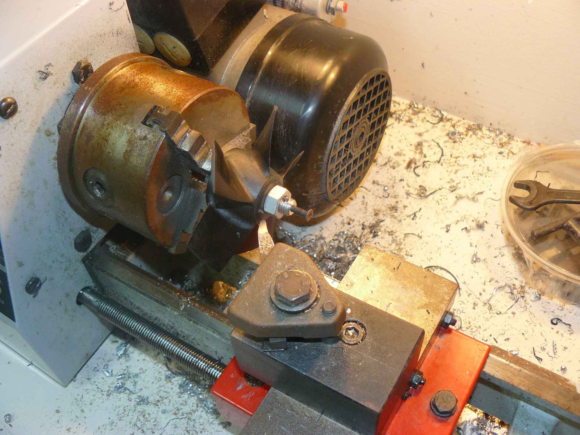

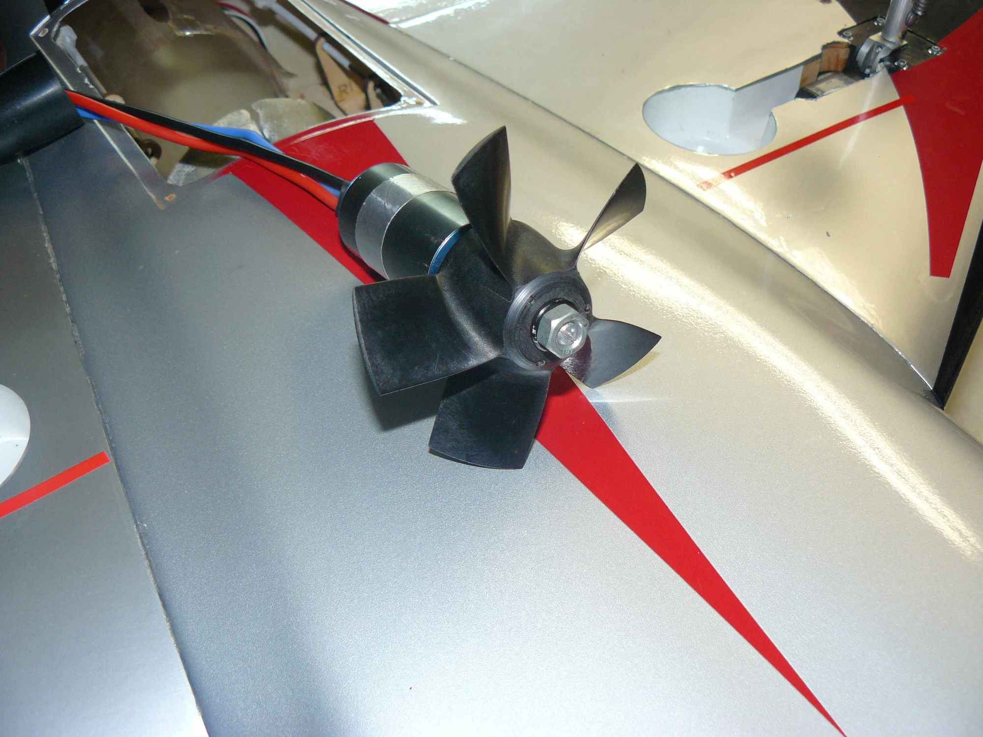

I'm using programmable 120A/ESC, I had to reset it when flew it number of times on 7S just as an experiment. I don't have any overheating issue with my set up but the stock in-runner runs hot just like any. I call hot anything that feels hot to touch as 60-70 deg.C. My model flies so well on 6S/4.25 - 5Ah packs with decent speed so I find no need to push it any further.
After building up my adapter with some Hi-sol, I got now a perfect tight fit of impeller over it so it will be so much easier to balance it. I don't like using the stock conical spinner so minor mod was done again same as on my "F-4" with the use of nut and washer for securing it. Just about ready to put it all back together with the new piece of mind and have more fun with it off the beach. Happy flying.
Slight mod to the rotor for using the nut&washer instead the stock spinner.
Holding slot was cut into the spinner for precise balancing.
