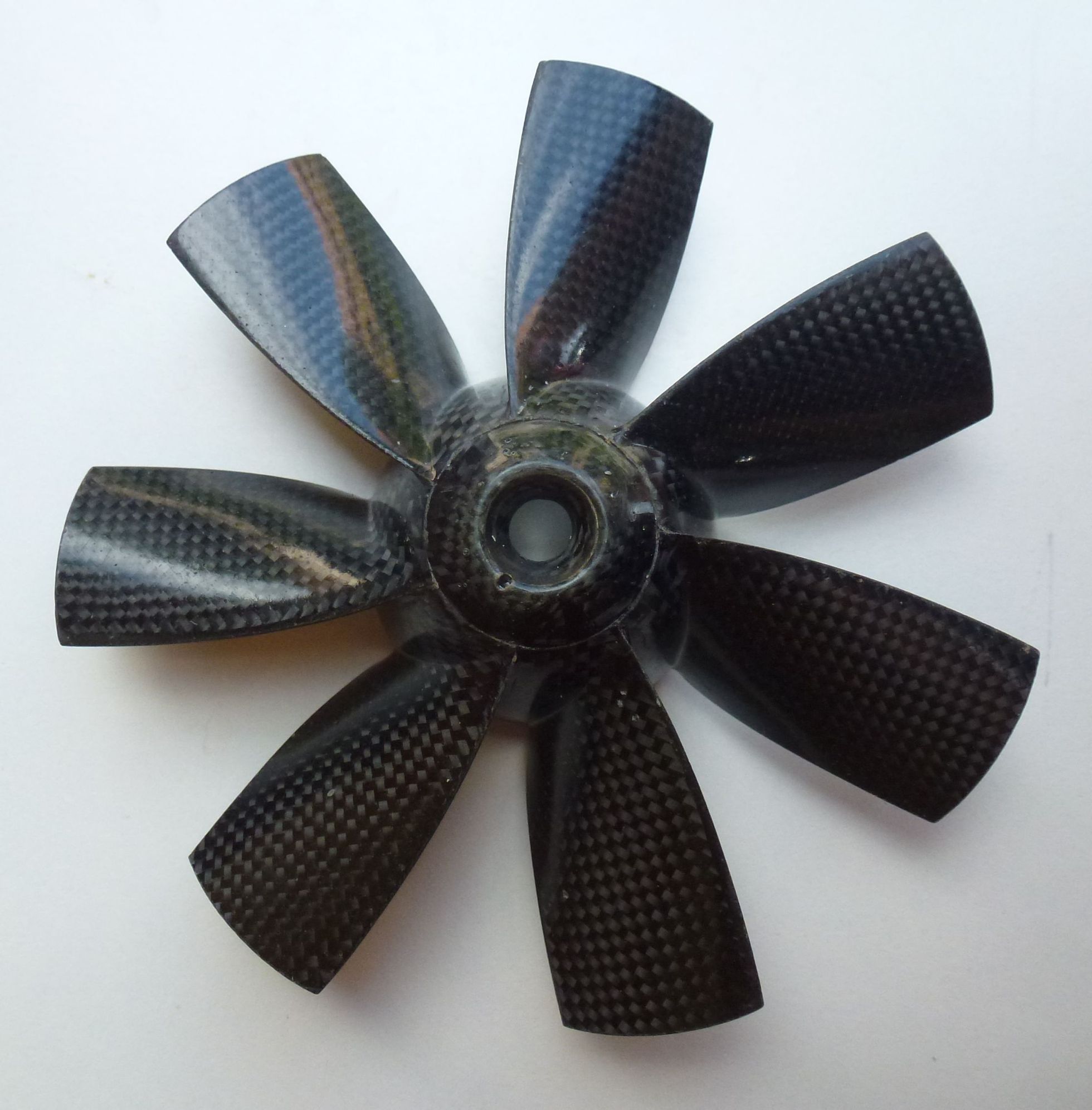

My Feedback
VASAFAN 120mm 7 blades
CASLE PHOENIX EDGE HV 120
12S ZIPPY 5000mAh 45C
MOTOR- HET TYPHOON 700-98-840
I used in this test:
-motor timing : low
-pwm rate .....: 8kHz
-power out ....: 100%
-static thrust .: 57-63N
