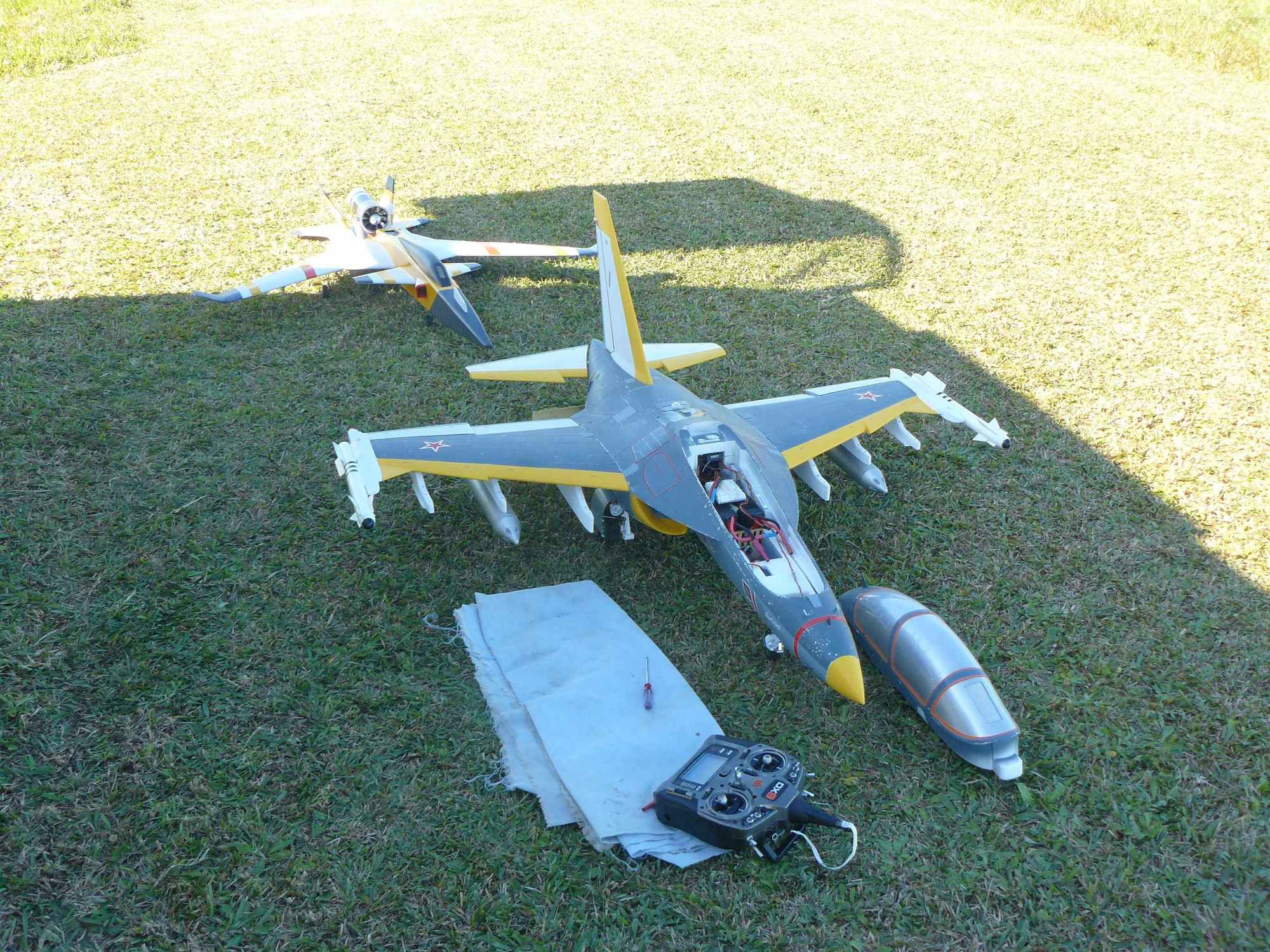

After few fan test runs I'm not happy with the thrust by the stock 6S power unit so pulling it all out and upgrading to 8S by fitting new ESC and rotor to the existing fan.

After number of static thrust tests using the stock and upgraded 8S power set up I have decided to modify the air intakes, resulting in great improvement.

Old 11-16-2016, 12:48 AM
Joseph Frost
Join Date: Nov 2010
Location: Coffs Harbour NSW, AUSTRALIA
Posts: 1,563
Received 71 Likes on 67 Posts
On the stock 6S I was getting only some 2.4kg thrust at very high current draw. I tested 5 different power units but finally decided on 8S Stumax 89-45/NEU1400kv. I'm getting close to 3.5kg thrust which will translate much better in flight after the air intake modification. Just assembled Elev. stabs with the rudder fin today and had to do some surgery foam removal inside the cockpit to accommodate larger capacity batteries. Won't be long now and she'll be in the air.

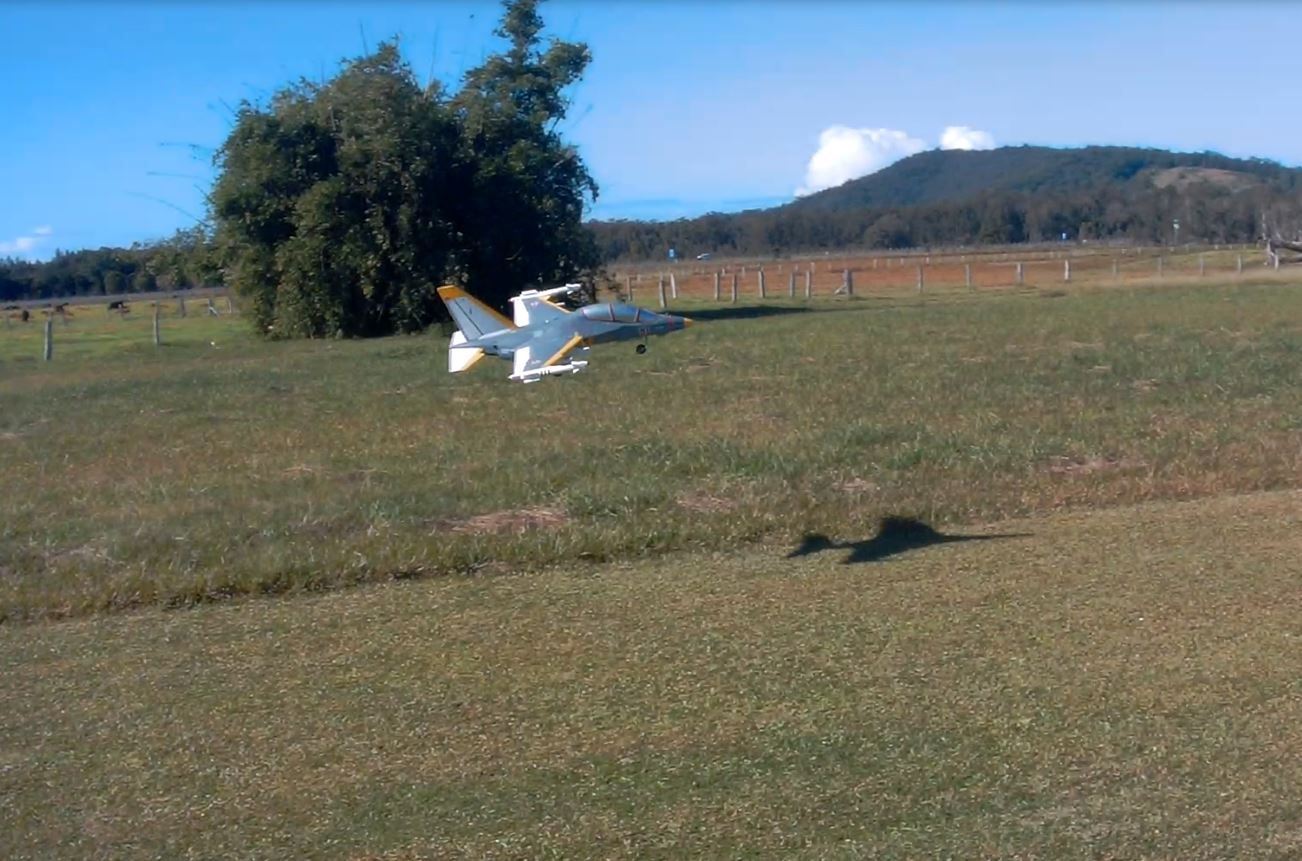

Old 01-11-2017, 12:27 AM
Joseph Frost
Join Date: Nov 2010
Posts: 1,563
Latest video flying in dead calm, not an ideal conditions for this heavy foamy. Each landing getting better but still a handful.
https://youtu.be/9cRodWa3WUE
