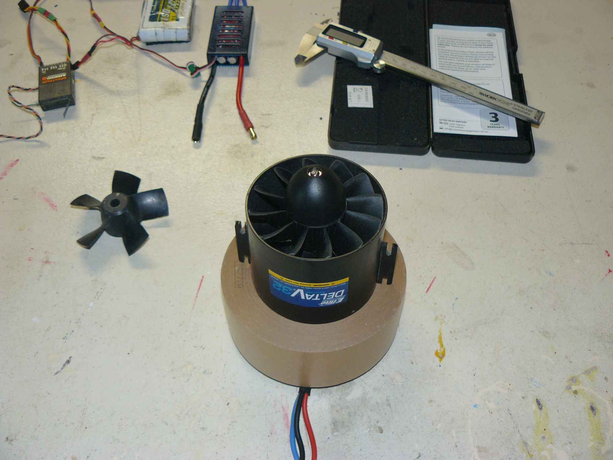

12b/90mm rotor mod.
Multi blade rotor with smooth new sound.
Cooling sink fitted.
Fine tuning of the new power unit.
Instead of spending fortune to upgrade the power unit in this flying brick I decided first to modify the stock fan with the use of 12 blade rotor reduced from 90mm to fit the stock shroud. After couple of test runs I have found a considerable increase in current draw and wattage, (85A/1800+W) with the canopy off and over 100A currents/2150+Watts with the canopy on which limits some air intake as there is air flow cheater inside of the duct to cool ESC.. Further test will be done to compare the static pull/thrust. Might have to upgrade the stock 2852 motor to 2967 to handle it.

I wouldn't rely pushing the stock motor to these new extreme figures (2250+W) with this new multi blade rotor so I have swapped it for longer can one after some shroud casing surgery to fit it in. After more soldering and fine tune/balance, further tests will come up with the truths.

Test runs of the new motor.
Much better results with larger ESC.
After some fine tuning of my modified new rotor the longer can motor seem to run nice while testing couple of speedos, the larger HW120 runs lot cooler than the FW130, which I put more like 100A basket case. Next job will be thrust test to see if there is any difference to my poor 1.55kg using the stock set up.

Fine tuning the power unit on the stand.
Testing all sorts of rotors.
'and batteries.
After bit of home work I have hit my target, over 2.2 kg static pull. 2.4kilo on 7S, @90A/2500W.
