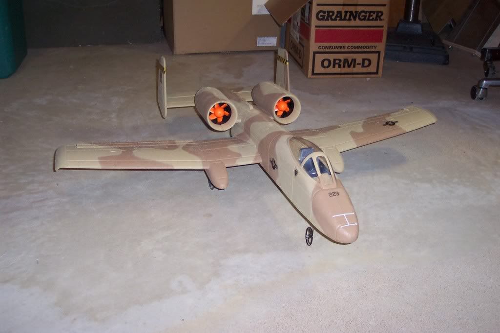

My maiden flight went off with no problems I put some extra up trim just to be safe and it paid off.
I learned quick, if your gonna make the A-10 <<<FAST>>> you got to reinforce her in certain areas like the wings the tail and nose some folks also do the nacelles.
The A-10 is alittle flimsy in these areas.
I used carbon rods to help make the plane stronger.
Only 4 mins of flight time with my setup.
A bigger battery like a 2500mah 20-30c 3s might get it to 5 or 6 mins
But over all I'm super impressed with the A-10.
This pic was taken before the black paint was added to the camouflage.
