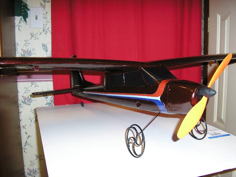

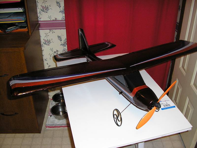

Thanks for the water break in info, if I can get the motor out of the front of the plane I will do that. Problem is it is already glued in!
Servos: I think the Spektrum DX6 comes with sub micro servos. They are S75 servos, 7.5grams
The wing attachment took me a while to work out and after reading a few posts I decided to go with the bamboo and rubber band setup. It seems screwing the wing down can rip out a lot of foam on a bad landing/crash.
I am almost finished, just got to add the landing gear and the radio equipment when I get it.
I did some strengthening by adding clear packing tape top and bottom of the wing and the fuselage. After reading the tail wheel can rip out the tail/rudder when landing I decided to go with a balsa tail skid instead until I am comfortable with landing. I strengthened the ailerons with tape as well as they seemed kind of flimsy, the elevator got a bot of tape as well.
Nice looking plane you made, mine won't look so good as I'll just put on some of the included decals...I fully expect it to look like frankenplane after a few flights
Thanks for the tips AJ1202.

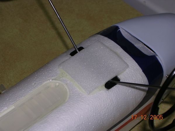

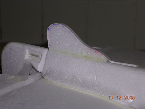

AJ1202, In have uploaded a couple of photos of how I strengthened the landing gear and the tail skid I put on.
For the LG I just epoxied a spare piece of foam across it as I epoxied the base in.
For the tail skid I used some of the left over foam from the wing strut stuff and used the GWS glue to stick 2 pieces together then shaped it. I used the GWS glue to stick a strip of margarine container to the out side of the skid to make it slip better and strengthen it. Then epoxies the skid to the tail after sanding bothareas nice and flat. Seem pretty strong but the proof will come when it flies.

Hi Pox, looks good. I like the tail skid, I might have to do something like that as mine has already come loose and wobbles with just a few landings on it, The only prob I see with the LG is I have to remove mine for traveling, I keep them in a container with the gear and wings off
I think I'm going to make a snap in lock like on my cub. Hey what are you doing back over hear
your part of the gang now, so go back.

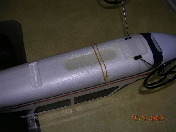

RE: E-Starter prop and power question
I see you've installed the stock battery hatch. Have you secured it in any way? Unless GWS has changed the design, there is a good chance you'll see your batteries leave the plane when the plane encounters some G's.
Never happened to me, but I've read about it and know it happened to a fellow I see at the field.
Not a pretty sight. [X(]

Join Date: Nov 2005
Location: TorontoOntario, CANADA
Posts: 32
It is coming along nicely, can't wait for the radio to come in!
I was thinking about the battery plate as I had read a few posts about it coming out. Then when glueing it in I noticed that epoxy doesn't stick to the hatch plate plastic! Man that is just dumb...the epoxy peels right off it. I tested using a couple of the rubber bands going from the wing support struts on the fuselage, you can see what I mean from the pic. Seems to hold it in quite tightly, especially if I double over the rubber band. The supports are over epoxied in so shouldn't come lose either.

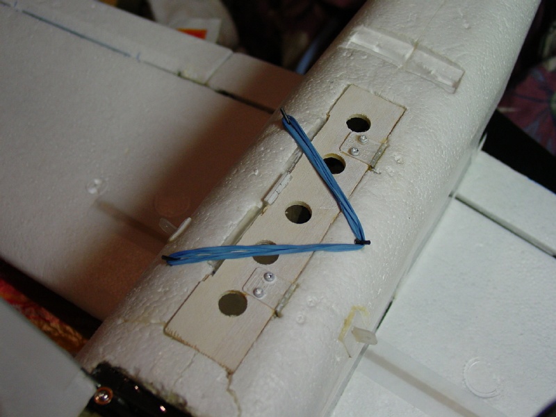

pox67: That's similar to what I ended up with. Although I didn't think to use the wing strut supports to anchor the rubber bands. As long as those stay put, that was a good idea. What I did was to take a couple pieces of carbon rod about 1/2" long, and stab them into the fuse on either sides of the battery area, glued in with epoxy. Then I used those as anchors for my rubber bands. I ran two sets just to be sure, one in the front, one in the back.
Here's a pic when I had three carbon tubes. As mentioned before, I've since changed to four (two sets). You can also see my custom battery door, that was necessary for my 2000mah 3S lipo to fit. It failed by the way! lol Hence the need for the rubber bands. I think, as you mentioned, I had a problem with the epoxy not sticking to the plastic hinge lock (which I re-used) and it opened during flight.

twinturbostang, I might go that way with the battery door if my setup feels to weak. I could pull out the plastic door that is in their now and all the epoxy around it and save a few ounces! Then just make a flat battery cover which is held in by the rubber bands.
I am putting the Hacker E3-49 in the plane now. It seems I have one of the B gear boxes which is 1:4.43, Horizon Hobby is recommending a 6.61 gear box. Does any one know if the 4.43 gear box will be OK and what size prop would be best?
